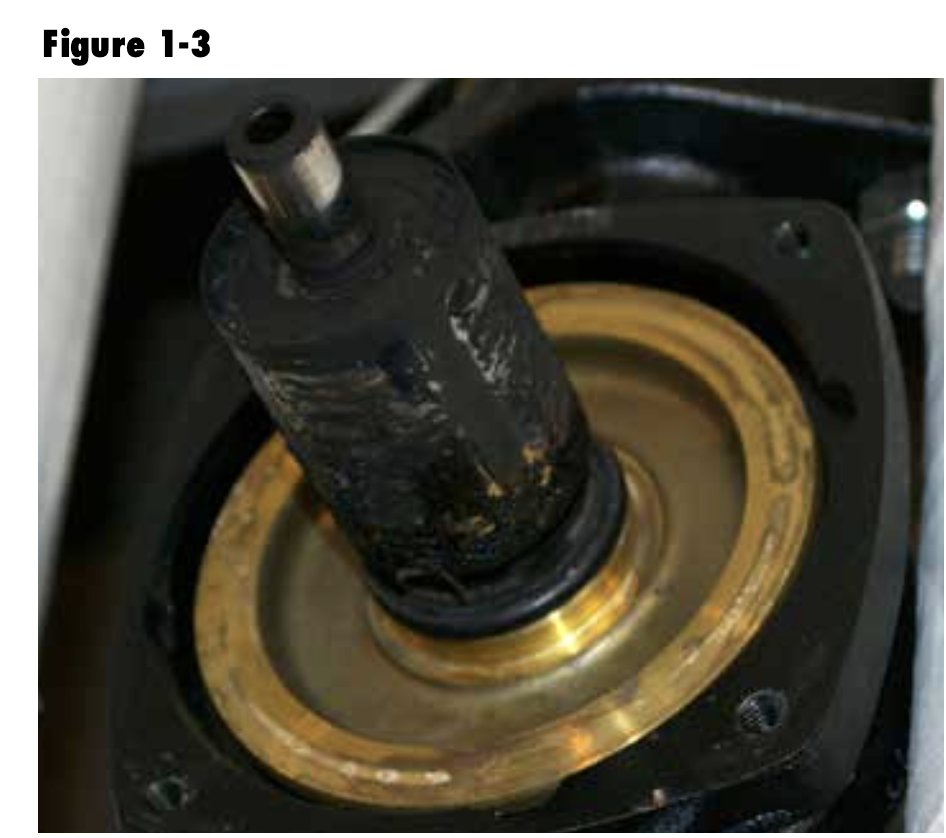

    We call that black water "boiler ink" it looks harmless, let it settle in a glass overnight, stick a magnet in the glass. This identifies it as ferrous metal particles.
    ECM circulators have a permanent magnet rotor in side them. So that black gunk WILL make it's way into you electronic pump. Regardless of what pump manufacturers tell you :)
    Here is an exploded view of that rotor, pulled out of the rotor can that it spins in.
    That part is filled with the system water, so magnetite at a .05 micron size makes it way into.
    Part 2 is to maintain the mag sep. Flush it weekly util you get hardly any particles out.

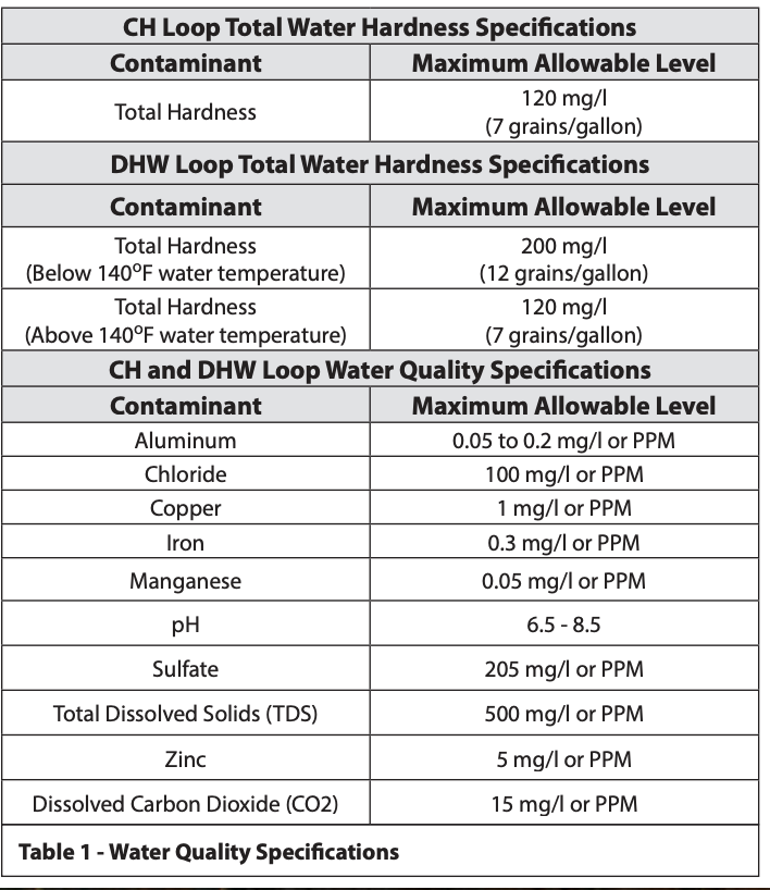

    It's good to know a little about the water you fill with, hardness, TDS, chloride levels.
    Your boiler manual should have a water spec like this.
    Screenshot 2025-11-06 at 8.42.03 AM.png Screenshot 2025-11-06 at 8.30.34 AM.png Screenshot 2025-11-06 at 8.39.28 AM.png

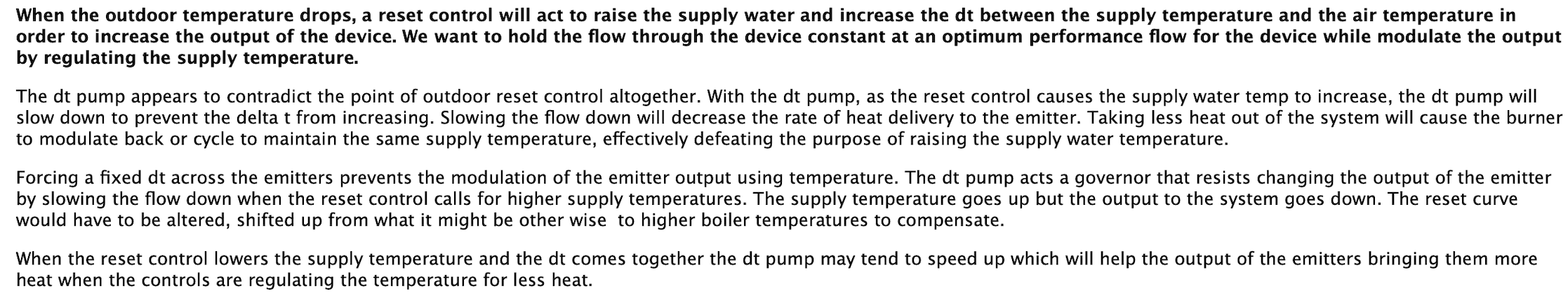

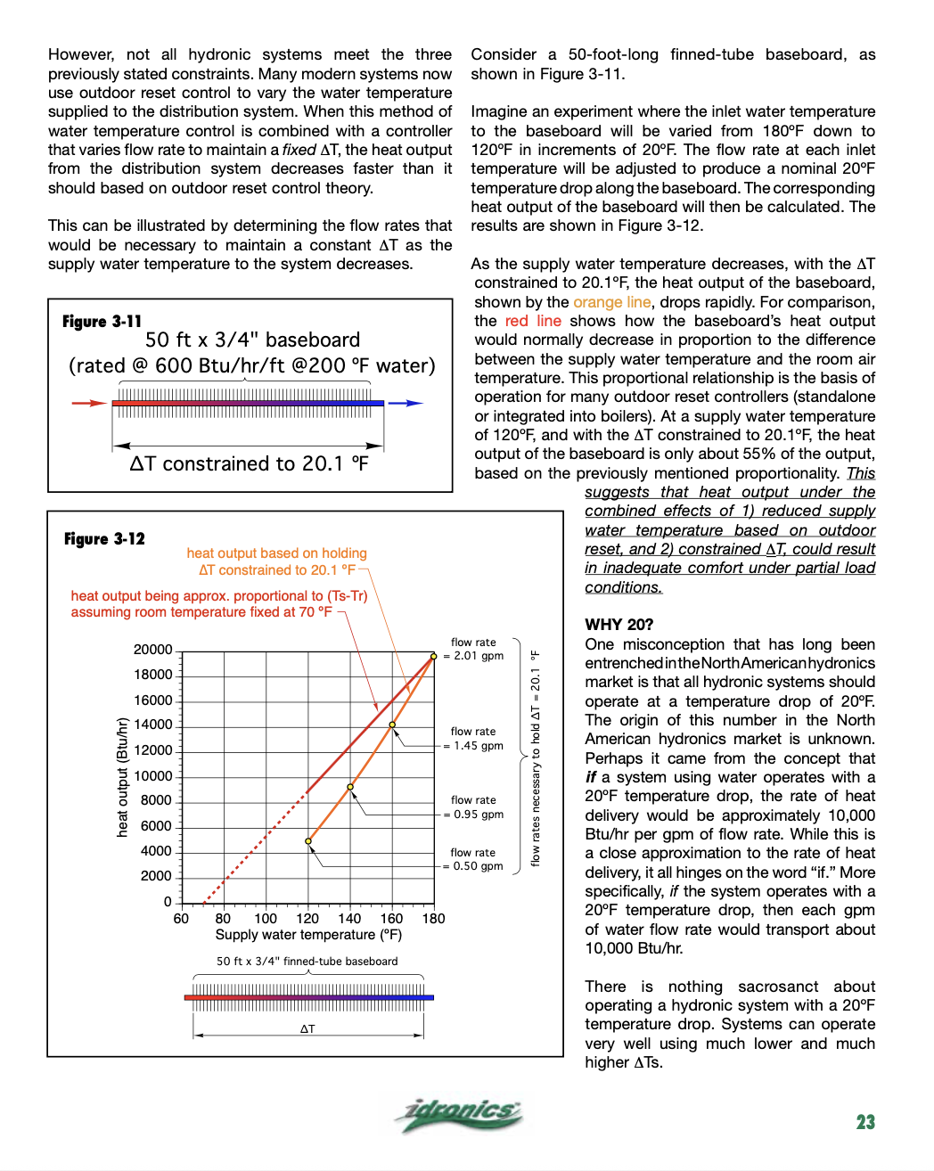

    hot_rod Member Posts: 27,707

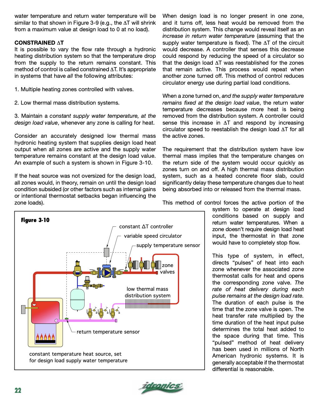

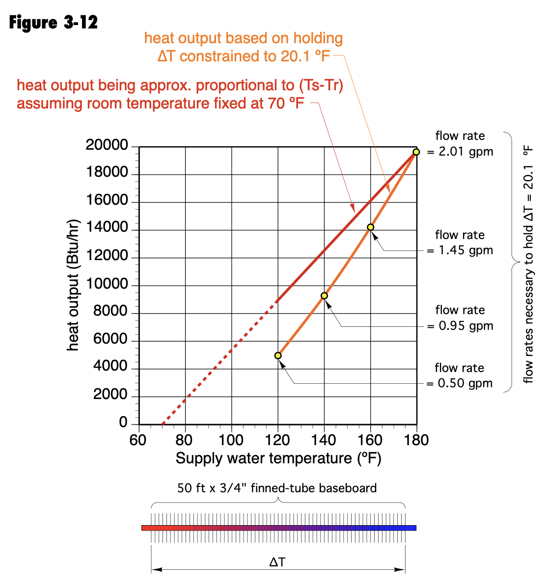

    That ∆T mode of operation is often referred to as constrained ∆T. The pump attempts to maintain a fixed delta. Is that a good or desirable operation method?
    Would you drive a vehicle that was constrained to a fixed rpm range, up, down hill, under heavy load, regardless of changing highway conditions?
    The load on a building constantly changes based on temperature, wind, occupant use, internal gains, etc. So ideally a heating system that could monitor that and change accordingly would be good. Allowing the delta T to move around as loads inevitably change a common way to control.
    The delta T is an indication of how much heat is being transferred at any given point in time.
    Cold start up expect to see a wide delta. As the room warms, load drops, the delta will drop, maybe to a few degrees. If not constrained.
    Heat transfer is related to temperature differences. Output charts for most any heat emitter show that relationship. More reading in the attached link Idronics 23
    Higher flow rates= tighter delta = higher average temperature across the emitter = higher output. That is stated in the Laws of Thermodynamics.
    If you use outdoor reset control, and you should :) then ∆T control logic will fight the ODR function.
    Your high mass radiators will compound the effect of constrained operation.
    Screenshot 2025-11-07 at 8.57.12 AM.png Screenshot 2025-11-07 at 8.57.28 AM.png
    https://www.caleffi.com/en-us/magazine/23-heat-transfer-hydronic-systems

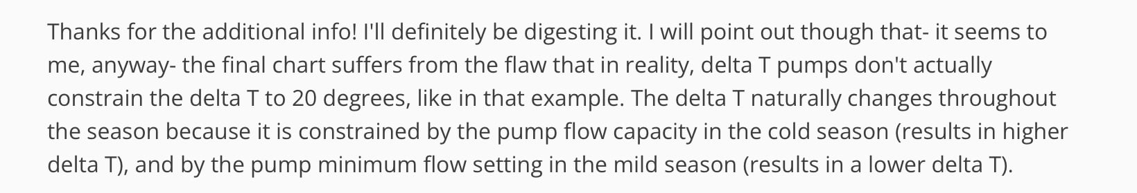

  • RickT
    RickT Member Posts: 87
    Thanks.
    What I'm getting from this is you really have to carefully design your ODR curve, directly taking into account whichever pump you select. It will not be the same for a Delta P pump and a Delta T pump.

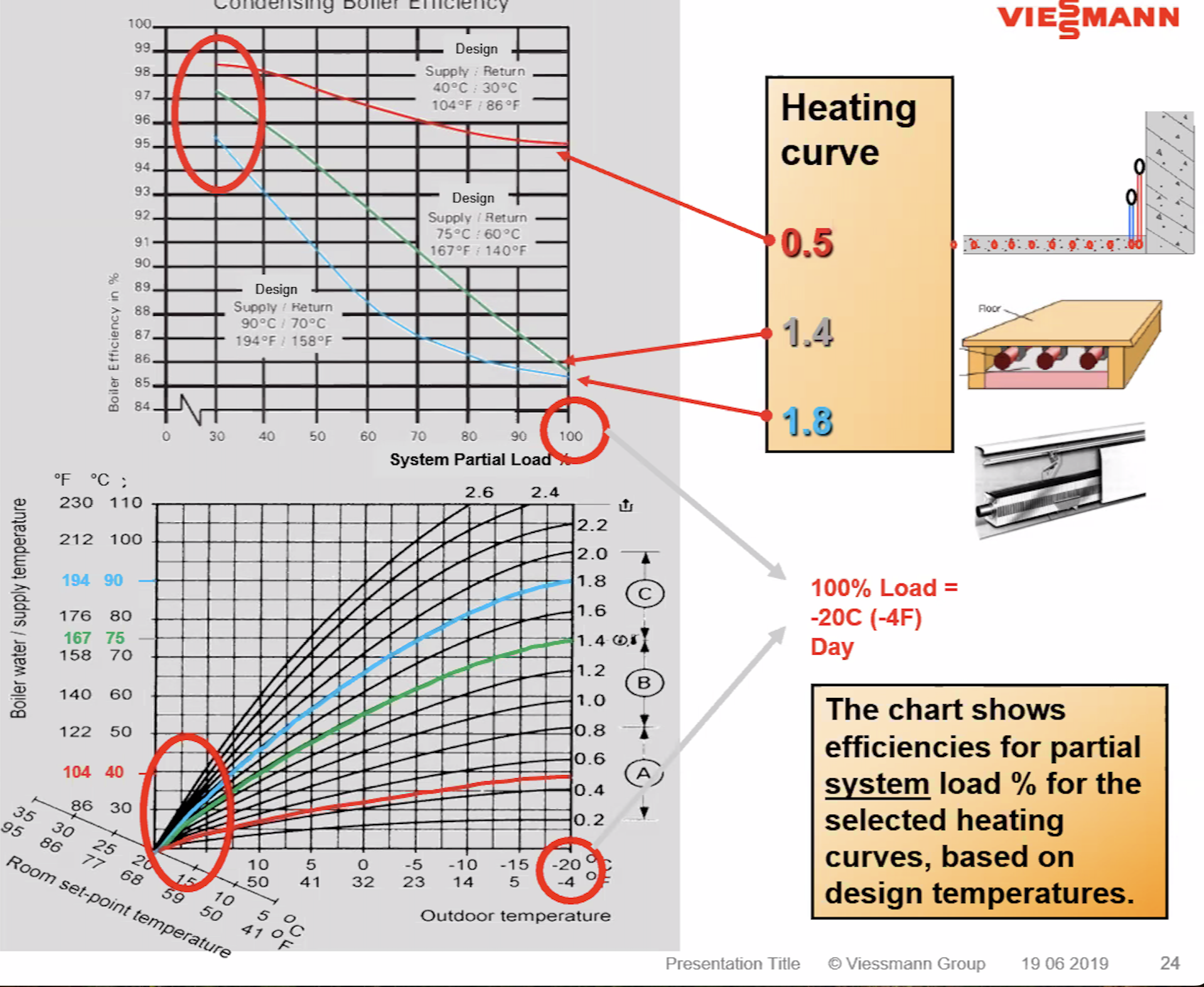

    A perfect or near perfect ODR setting takes some time and practice. It's not a number you can pull out of a book. Every home and homeowners expectations are different. If you get a good quality ODR control, you have endless adjustment opportunties.
    In some cases an indoor feed back helps fine tune even more.
    Just because outdoor temperature is dropping doesn't necessarily mean supply temperature needs to increase.
    Internal gains from people, cooking, laundry, showers, etc all add heat to the space. The tekmar system allows both indoor and outdoor inputs for fine tuning.
    Tekmar has excellent essays explaining how the technologies work together. Search around some a legacy documents
    https://www.watts.com/our-story/brands/tekmar/references/how-outdoor-temperature-reset-controls-save-energy
    If you search around HH you will find contractors first hand experiences with ∆T and ODR. A demo is this simple.
    Two way ro regulate heat output, temperature and flow. Temperature regulation is very linear, which is why ODR can be so useful. Reset graphs tell the story.
    Modulating flow is nowhere near as linear.
    I'm still not following what you mean by BB stratification?
    Good news on the over-sized rads being useable with 135° SWT.

    Thanks for the additional info! I'll definitely be digesting it. I will point out though that- it seems to me, anyway- the final chart suffers from the flaw that in reality, delta T pumps don't actually constrain the delta T to 20 degrees, like in that example. The delta T naturally changes throughout the season because it is constrained by the pump flow capacity in the cold season (results in higher delta T), and by the pump minimum flow setting in the mild season (results in a lower delta T).
    I wonder what that orange curve/line would look like if it were modeled based on a real-world constrained delta T example. Might line up much better with the red line. But I dunno man I'm not a mechanical engineer or HVAC person, I'm just a dude.
    why would you spend $$ on a delta T circ that isn’t actually doing that function. With a standard or delta p you get this same result, variable delta.
    Bottom line the pump attempts to match the load with flow adjustments.
    Matching the changing heat load by varying temperature is an accurate proven technology, very predictable, called ODR outdoor reset. So common that most boilers have some version included. Why make it more complicated?
