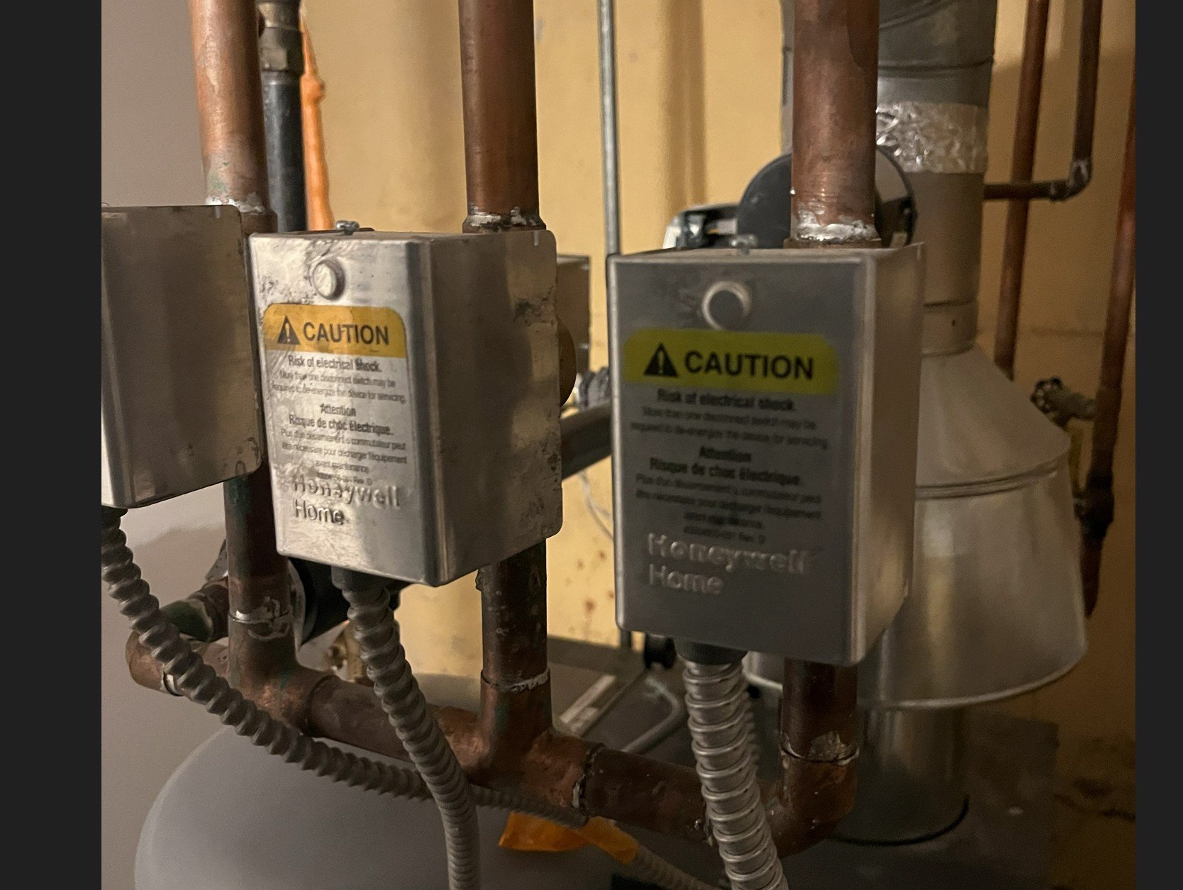

    attached are photos of my setup. also the expansion tank is on the hot side, not sure if this is the reason. Excessive flow does that mean the pressure is too high.

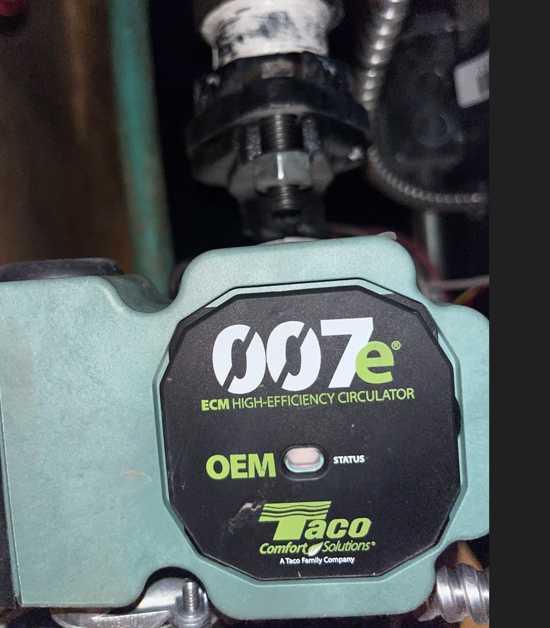

    what mode is the 007e in?
    It was designed to manage zone valved systems, eliminate banging

    It has an orange light and according to documentation it is in normal mode. do you think when it goes into green mode it'll be better?

    No harm in trying the pump in the other mode if it is selectable It sounds like it takes a week to learn and adapt

    hot_rod Posts: 28,705
    Hmmm, that pump should have solves the banging.

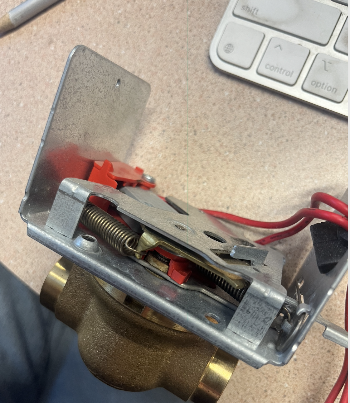

    A work around with most HW valves is to disconnect one of the springs below the cover. This slows the close off speed by a few seconds and that is often just enough. A simple enough hack to try.
    It does reduce the close off pressure a bit, about 3-4 psi, but if that pump is working properly it should not push the valve open.
    Does that pump give you any gpm or W reading as the valves open and close? Or can you hear the speed change?

    thank you for your feedback. I disconnected the spring in the zone valve that is causing the problem and the problem went away. I don't see any reading from the circulator. The circulator seems to be louder when both multiple zones are activated. Is there any negative side effect with this DIY?

    This HW workaround have been used for many years. You may find that is you use the search function here :)
    I don't know that Honeywell corporate has ever acknowledged or even officially suggested it. I have heard of the workaround from HW dealers, reps and contractors.
    From a technical standpoint, you basically slowed the close off speed. It should not cause any harm to the system. Less load on the synchronous motor to open the valve😉

    removing the spring definitely remove the water hammer rattle however I noticed a different sound. It is short of like the swoosh as the valve is being closed.
    Do you think by changing to a taco valve will help? based on my research it is a motorized valve for closing and openning. not sure if there is a way to control the speed.
