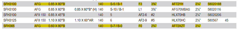

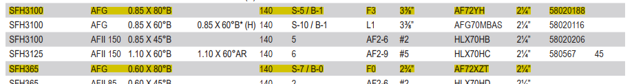

I was firing down a Utica SFH3100 that was short cycling and had high stack temp to a SFH365. The burner is a fixed head AFG.
The OEM guide call for a .85x80B nozzle, an F3 head and a 3-3/8 static plate for the 3100 and an .60 X 80°B nozzle, F0 head and a 2-3/4 static plate for the 365. Both 140 PSI pump pressure.
When I started the swap with a new F0 head and the included static plate I found that it was a 3-3/8 plate. The original (3100) configuration was a 3-3/8 plate matching the spec.
I did not have a 2-3/4 plate but I continued with the conversion leaving the existing plate. I was able to get good combustion, nice run time and dropped the stack temp from 650 to 490.
When I got home and was researching the mismatch I noticed the AF/AFG manual indicates the F0 head should use the 3-3/8 static plate and F3-F22 (higher firing rates) all call for the 2-3/4 static plate. I'm assuming the smaller plate allows more air to pass for the higher firing rates. Then why the swap in size in SFH3100 and SFH365?

    The use of the larger plate with the F0 head is a general rule, but there are always exceptions. An OEM spec like this was put together just for that boiler.
    The Beckett part number for the 2-3/4" plate is 3383. You can probably find one online. I might even have a couple lying around.

    Actually looking deeper in the OEM spec, and table "R.W. Beckett Air Tube Combination Code Listing" I see there plenty of configurations that deviate from Figure 3 in my original post. I think I should get the correct plate and re-tune and see if that provides and improvement in the combustion.
