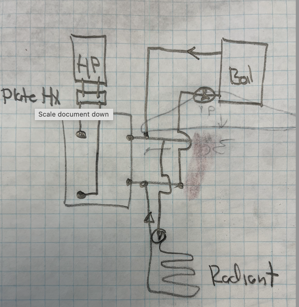

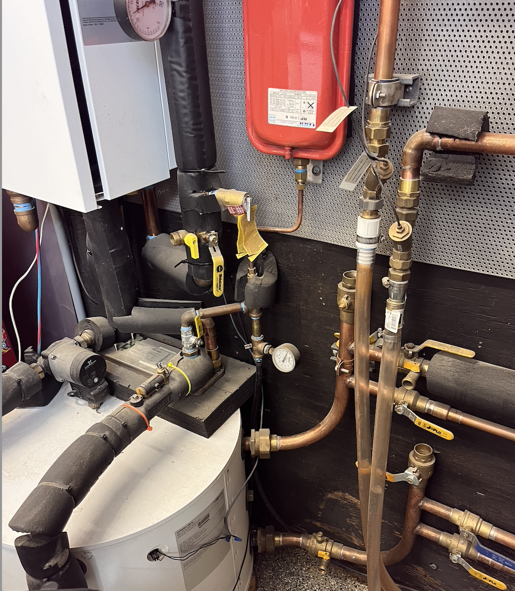

I have that system. My HP has glycol, so I put a plate HX between the HP and tank. To avoid the large amount of glycol.
I had a 4 pipe buffer, the Viessmann Vitocell 100E so from the plate to the tank. then two headers off the tank for boiler feed in, radiant take off.
I'm not sure an indirect is the best match for a HP, I run mine at 120F. But it could work off a 3 way valve in the HP. Or connect into the header so either boiler or HP could heat it
With an indirect you need a lot of coil surface. Ideally both the tank and coil are flowing for best heat transfer. Plate HXers are much more efficient, two pumped flows.
