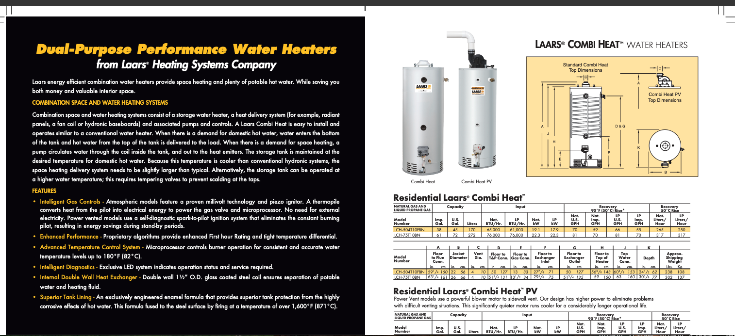

    I put a number of these in early on. Heat and DHW from one tank, legally :) 65,000 BTU input. Side wall venting is sometimes a nice feature.
    They have gotten $$. What hasn't.
