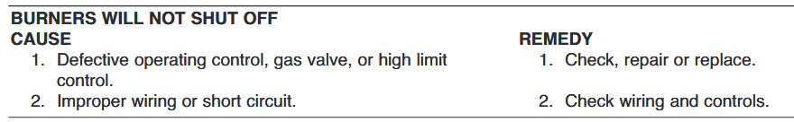

Gas fired for baseboard hot water Slantfin S-90 DP. No heat call. Replaced thermostat, worked fine, but then tenant said ran constantly, would not turn off. Replaced thermostat again, ran fine, turned off appropriately, and within hours, same problem, runs constantly, won't turn off. Any ideas?

    With the system actively not shutting off I would carefully disconnect one of the thermostats wires to see if it shuts off, prove it is or is not the thermostat. There could be a staple shorting the wires out and moving the thermostat to change it changes the symptoms briefly.
    Basically some electrical troubleshooting is needed. Do you have a multimeter ? Sometimes visual and mechanical inspection is all that is needed.
    https://slantfin.com/wp-content/uploads/2015/11/Sentry-Installation-and-Operating-Instructions-119.pdf

    It runs if we short connect the thermostat wires in the basement, to cut out the thermostat. Tech replaced the brain on it, saying that he thought the aquastat was shorting out the thermostats. But when he replaced the brain, and we tried a new thermostat, still not working. Grrrr! I am wondering if we should put in a wireless thermostat.

    That sounds very much like a problem with the wire between the boiler and the thermostat.

    And the final verdict is… 3 crappy new honeywell dial thermostats (most likely).
    The boiler ran appropriately when the wire to the thermostat was jumped by shortcircuiting after it left the boiler and before the thermostat.
    Young tech figured (I think wrongly) that it was the aquastat brain, repeatedly short-circuiting the replacement thermostats. He replaced the aquastat unit, and we then put in yet another new honeywell round thermostat… and it didn't work. Still worked from the short circuit jump near the thermostat.
    So he went out to the truck and got a simple digital honeywell thermostat… and it seems to be working fine now.
    So my kid handyman, who originally thought it was just that we needed a new thermostat appears to have been right. And because of 3 in a row POS honeywell round simple dial thermostats, it cost me what I'm sure is going to be an insanely expensive service call with installation of a new aquastat brain for the furnace.

    @Multiman that's why a real tech would use a meter and test things. Shooting the parts cannon seldom works and gets expensive.
    It would be unlikely to get multiple bad thermostats.
