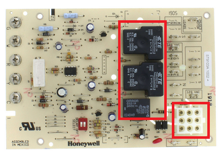

    Does the control look something like this?
    C,Y,G,R,W are the thermostat connections. Then there's R and W that also go to TT on the primary. That is controlled by the heat relay under the cover at the top of the terminal strip. That relay is bad. If that's your setup, you need a new Beckett AC Ready Kit. You can order it with or without the transformer. You dont need the transformer.

    As you surmised , my control card is the ST9103A type. Inspecting the card I noticed a slight discoloration around one resistor/capacitor.
    Jumpering the R/W contacts on the card results immediate initiation of the burner ignition cycle. I then ran four system starts using the thermostat allowing about 5 minutes between each restart. On two attempts the ignition cycle started immediately after I heard the relay click in, on one attempt there was a noticeable 2 to 3 sec delay between the relay click and start of the ignition cycle and one attempt there was no relay click when the thermostat called for heat until I tapped the card to start the cycle,
    The discoloration on the control board suggests it may be the culprit for the intermittent failures. Is there a way to test the 24 volt circuit to and from the thermostat rule it out as the problem

    yes. When you had the one time out of the 5 where there was no click, that is when you would use a very light touch with a jumper wire to connect R and W on the ST9103A to see if the thermostat is the problem (not a tap on the box). If the jumper wire starts the burner, the thermostat is the problem. If the very light touch with the jumper wire does not start the burner, then the problem is the ST9301A control board.

    Same problem with two different thermostats. My guess from here is your ST9103A Electronic Fan Timer has a bad solder joint. Common solder joint failure locations are the relays and the connector for the wiring harness.

    That will place the weak link somewhere in the ST9103 control card. could ber a bad connection on the 9 pin Molex connector or a defective relay in the printed circuit board.
