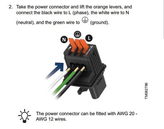

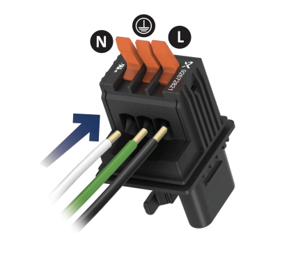

Take your pick. The first one was with the instructions that came with the pump. This one is online. I've heard it makes no difference.
