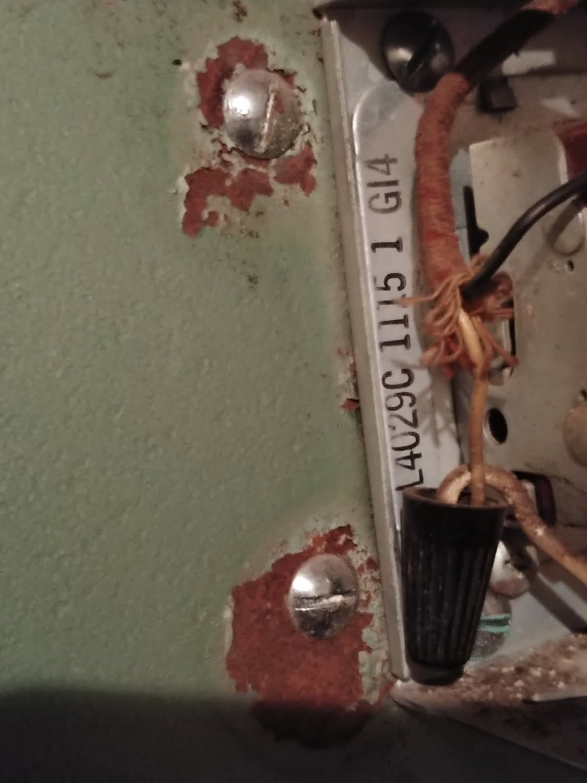

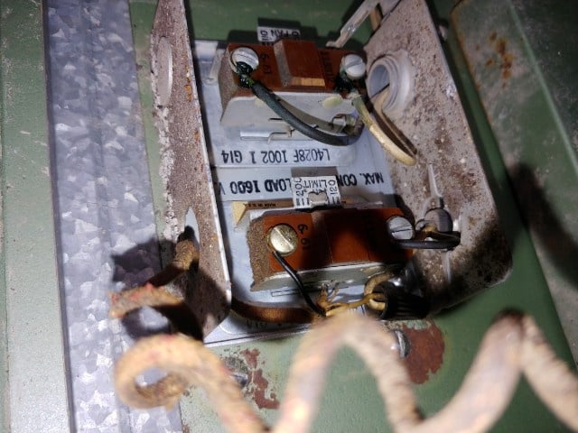

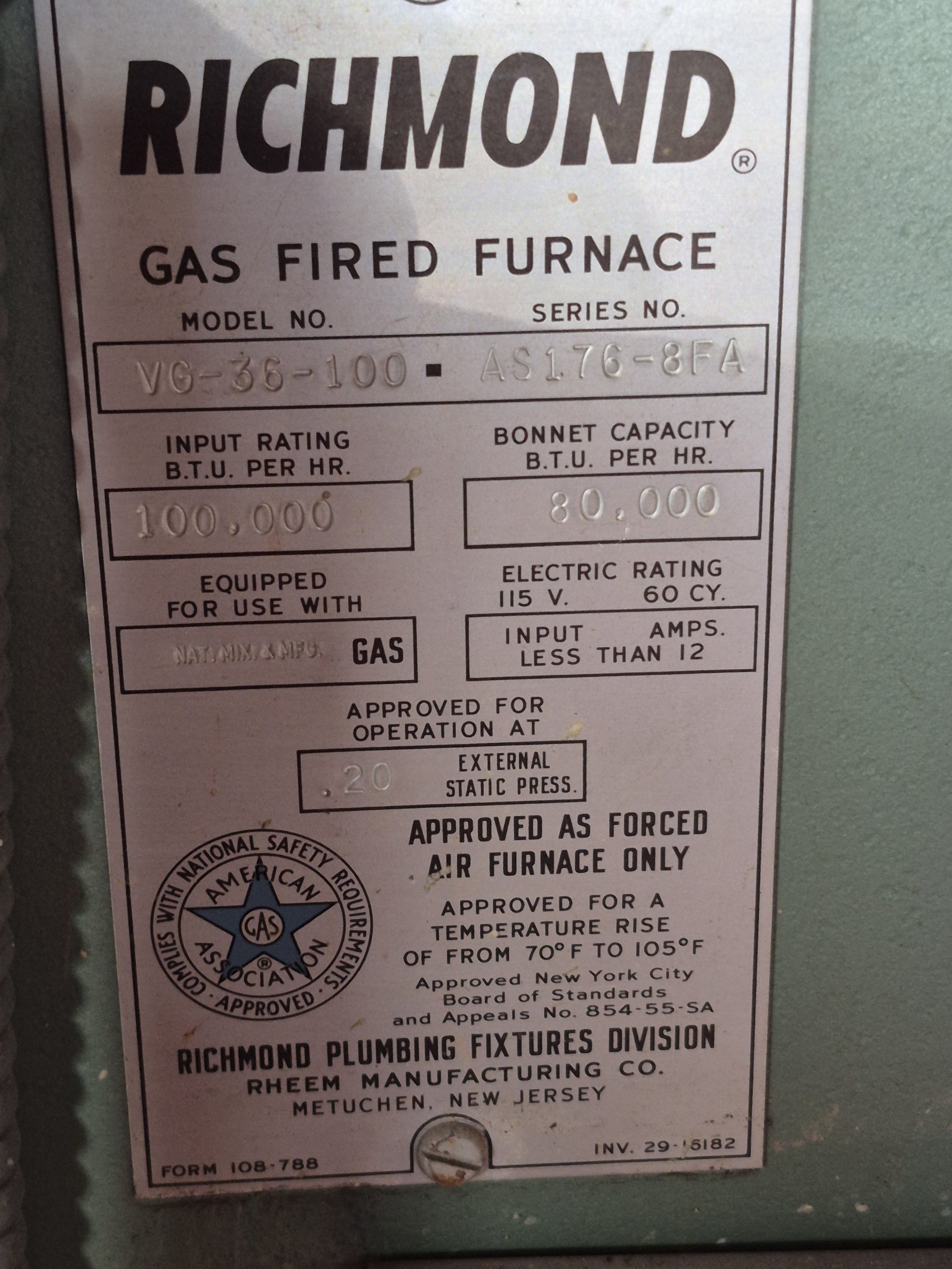

I have a old Richmon Furnace looking to replace combo limit Fan limit switch. Blower Fan comes with call for heat but will not shut off.
14029c 1115 1 G14
14028F 1002 1 G14

    mattmia2 Member Posts: 17,570
    Just need a residio or white rodgers combo fan/limit control with the appropriate probe length.

    HVACNUT Member Posts: 7,539
    Measure the insertion piece. Resideo Fan/Limit. It comes with instructions when there's two different voltages, which you have. You'll have to cut a jumper.

    Insertion piece is 3.5 inches. There is only 4 inches of space in compartment.
    The existing is two separate controls, where the new one will be a combination fan/limit. Some metal fabrication will need to be done so everything is properly sealed.

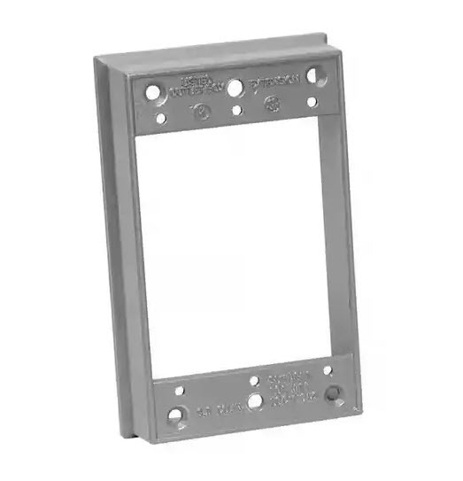

    What if I just mount an 2 metal conduit boxes and offset insertion differnce? or use and extention box pieace?
    You can do that. I would make it as air tight as possible with HT silicone
