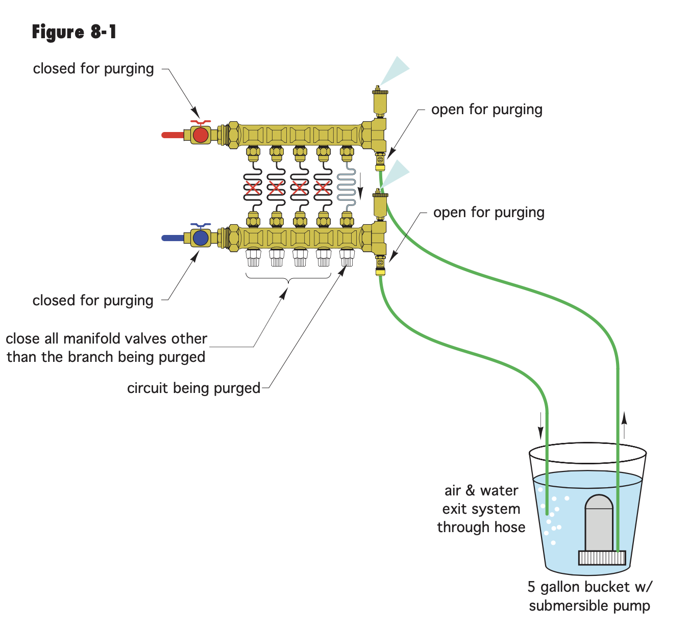

Whats the best way to flush a manifold to clean pipes?
Turn both red and blue ball valve on the manifold off.
Connect a pump, or a hose from you home.
This allows youto flush manifold and loops without disturbing the rest of the piping. If that is your intent?
Do you have actuators on the manifold or white plastic caps? Got a pic.
