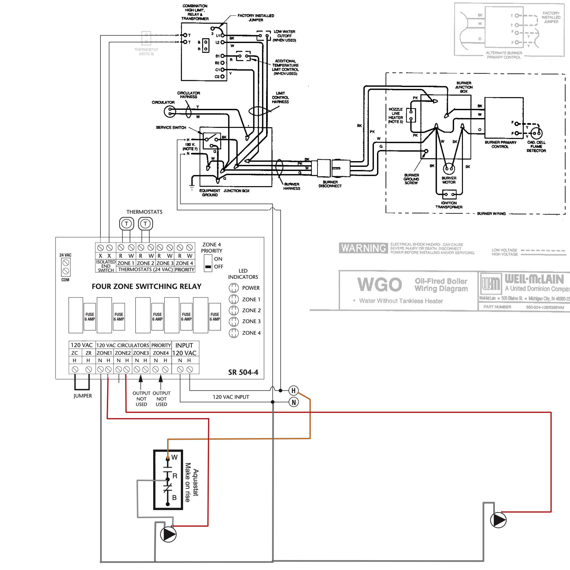

Hello, I am wanting to add thermal purge to my boiler. I have 2 zones - upstairs zone is forced hot air via a heat exchanger and blower in the attic, downstairs zone is baseboards. There are no zone valves, just a circulator for each zone controlled by a TACO SR504 4-zone switching relay. To add the thermal purge function, I have a Honeywell reverse acting strap on aquastat (makes contact on temp rise). I was planning to wire the aquastat to the basement zone circulator (120v HOT to R, B to C1) to purge the heat there. But then I realized that when the upstairs zone is calling for heat, the circulator for the downstairs zone would be running - stealing heat from the upstairs zone (where I really want it). Is there a simple way to interrupt the new purge function while the upstairs zone wants heat? Use the NC contact of a Relay in a Box, I assume? Thanks.

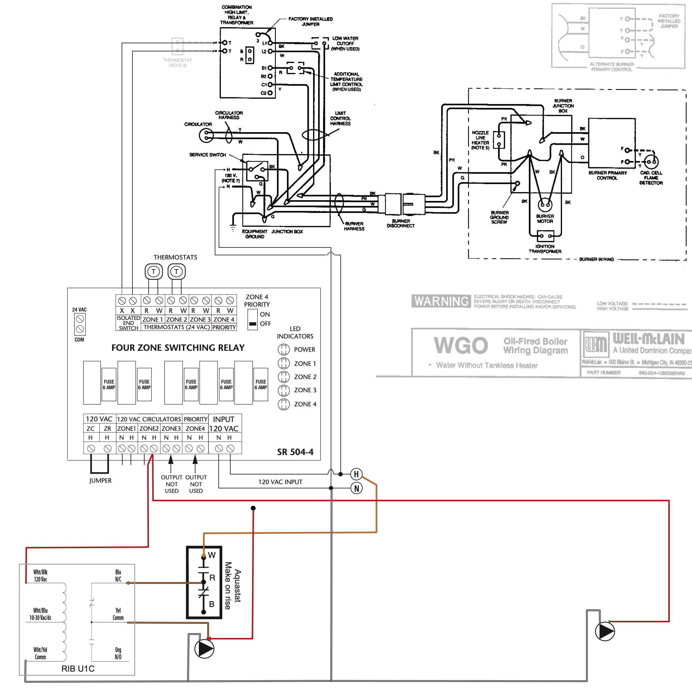

    A parallel circuit to power a circulator switched by an aquastat is not complicated. I just need to interrupt that function when the other zone is calling for heat. It should be as simple as using a Relay In A Box - the NC contact would be wired in-between the aquastat and circulator and activated by the upstairs thermostat (the NC contact would then open).

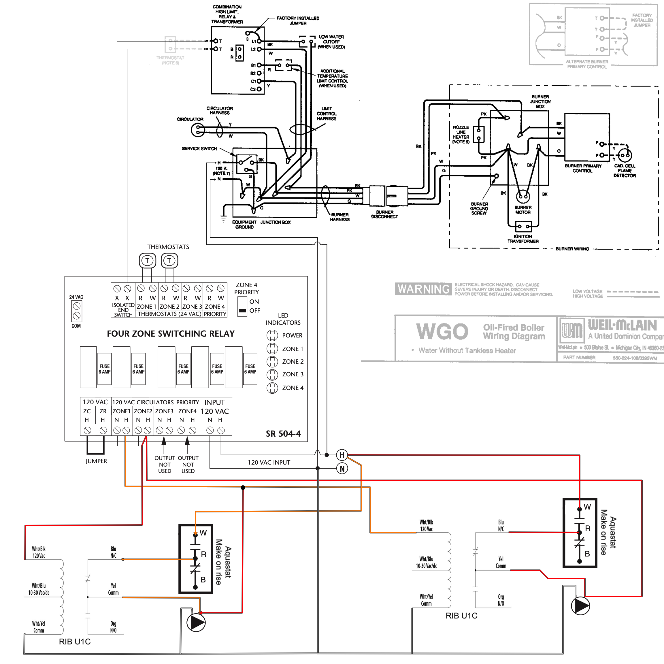

  • Not sure what series your WM boiler is but you can ad lib from the XX on the SR504 to the boiler TT.
    You need a relay to stop the thermal purging circulator if the other zone calls. That way you will stop the boiler heat from being sent to the zone that is no longer calling. I believe this set up will work for you
    Control logic is this
    Start with cold boiler and no call for heat.
    1. Zone 1 calls for heat power goes to the C1 circulator
    2. Power goes to RIB 2 relay (which has no effect since there is no call for heat on Zone 2)
    3. Zone 1 Reverse Aquastat 1 makes on temp rise (makes alternate route for power to C1)
    4. Call for heat is over for zone 1
    5. C1 continues to purge any heat from the boiler until
      1. the thermal purge is finished
      2. Zone 2 calls for heat and opens the RIB 1 relay NO contacts to stop the C1 from operating by way of the thermal purge contacts on Reverse Aquastat 1
    You can do the same on the other zone for thermal purge to the air handler. I like the RIBU1C for the relay in this case.
    If you are only thermal purging the baseboard zone, the RIBU1C gets wired to the Zone 2 with the zone 2 circulator.
  • I have a feeling that this is what you originally thought of
    Add one Reverse Aquastat (make on temp rise) to the baseboard zone. The you realized if there is a call for heat from the other zone, the purging zone pump will keep sending hot water to the zone that is not calling for heat, and that would not be ideal.
    Adding one RIBU1C will fix that

    But why stop there? add the thermal purge to both zones.
  • Yes, you understand Ed, thank you. > > > Add one Reverse Aquastat (make on temp rise) to the baseboard zone. The you realized if there is a call for heat from the other zone, the purging zone pump will keep sending hot water to the zone that is not calling for heat, and that would not be ideal.

  • Run both that way using the diagram I provided. the zone that operates more will use the thermal purge more that the zone that runs less.
