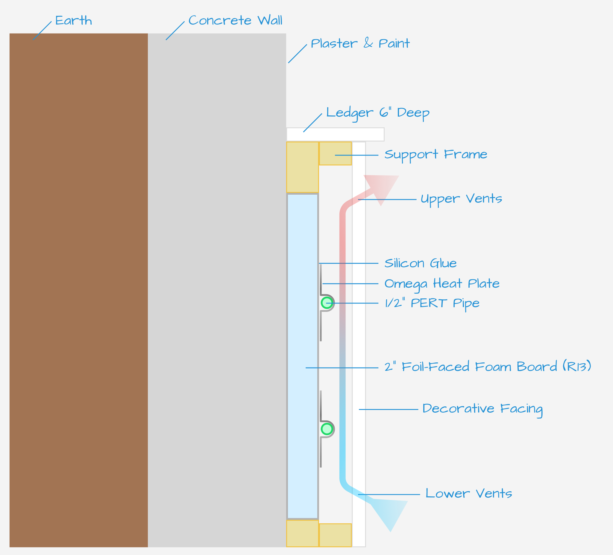

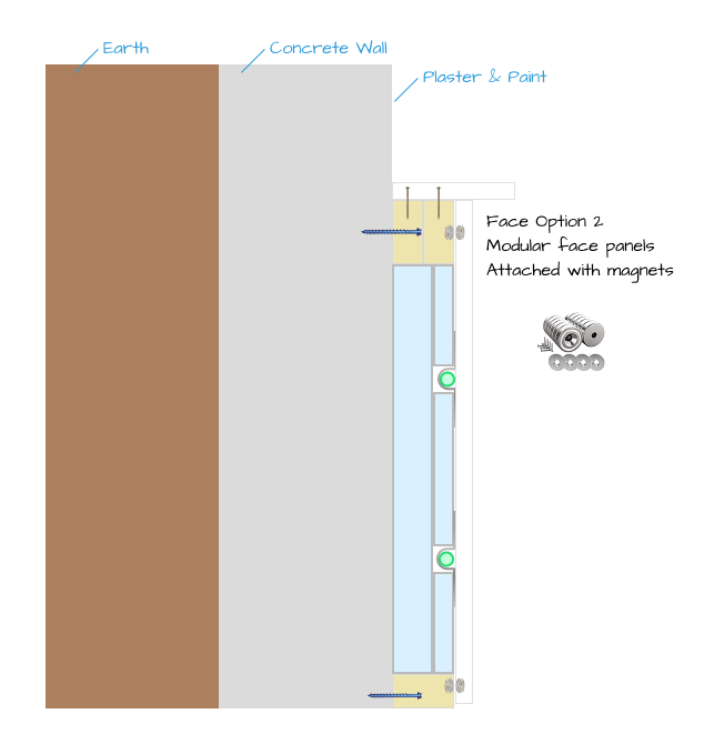

  4. Please see attached cross-section diagram

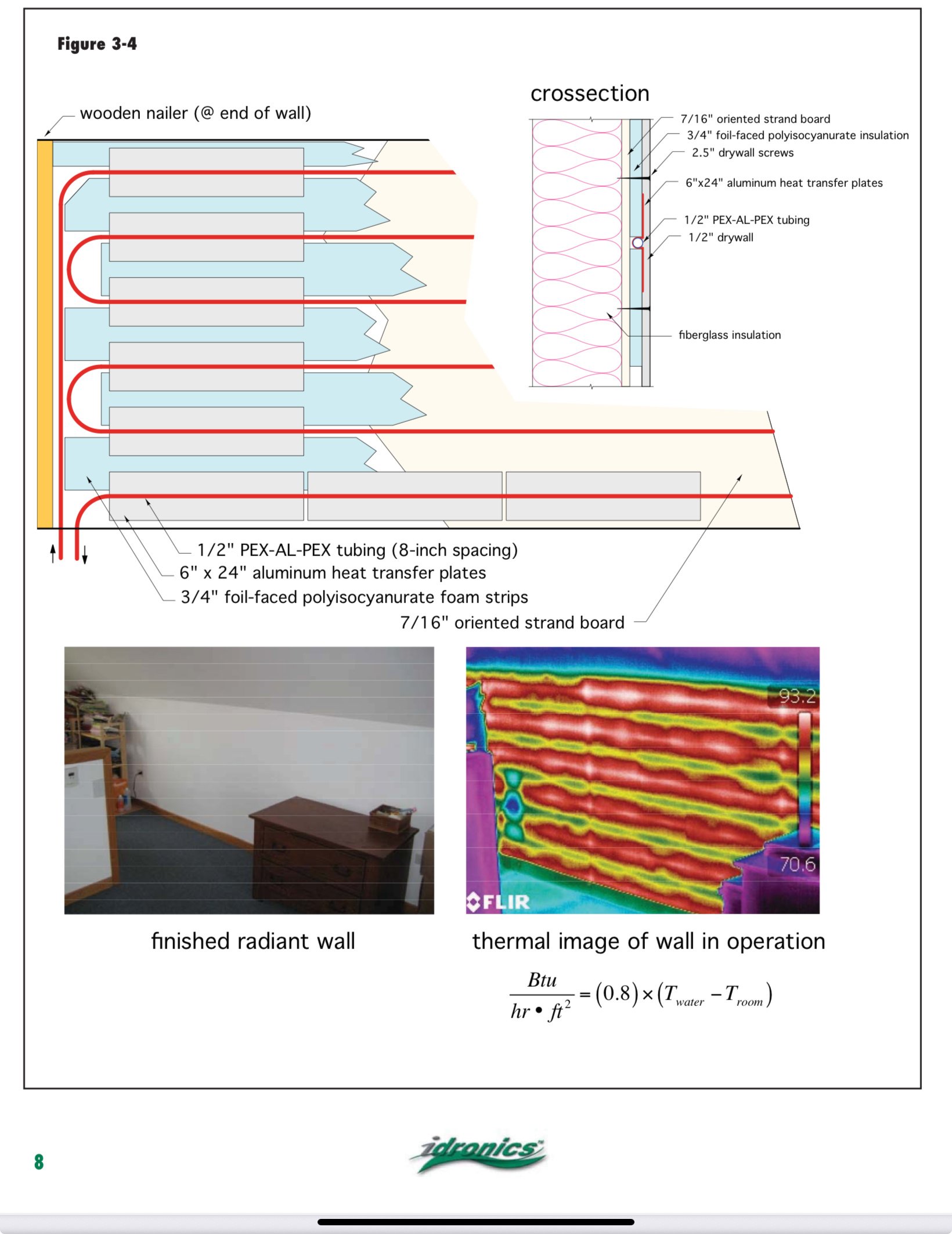

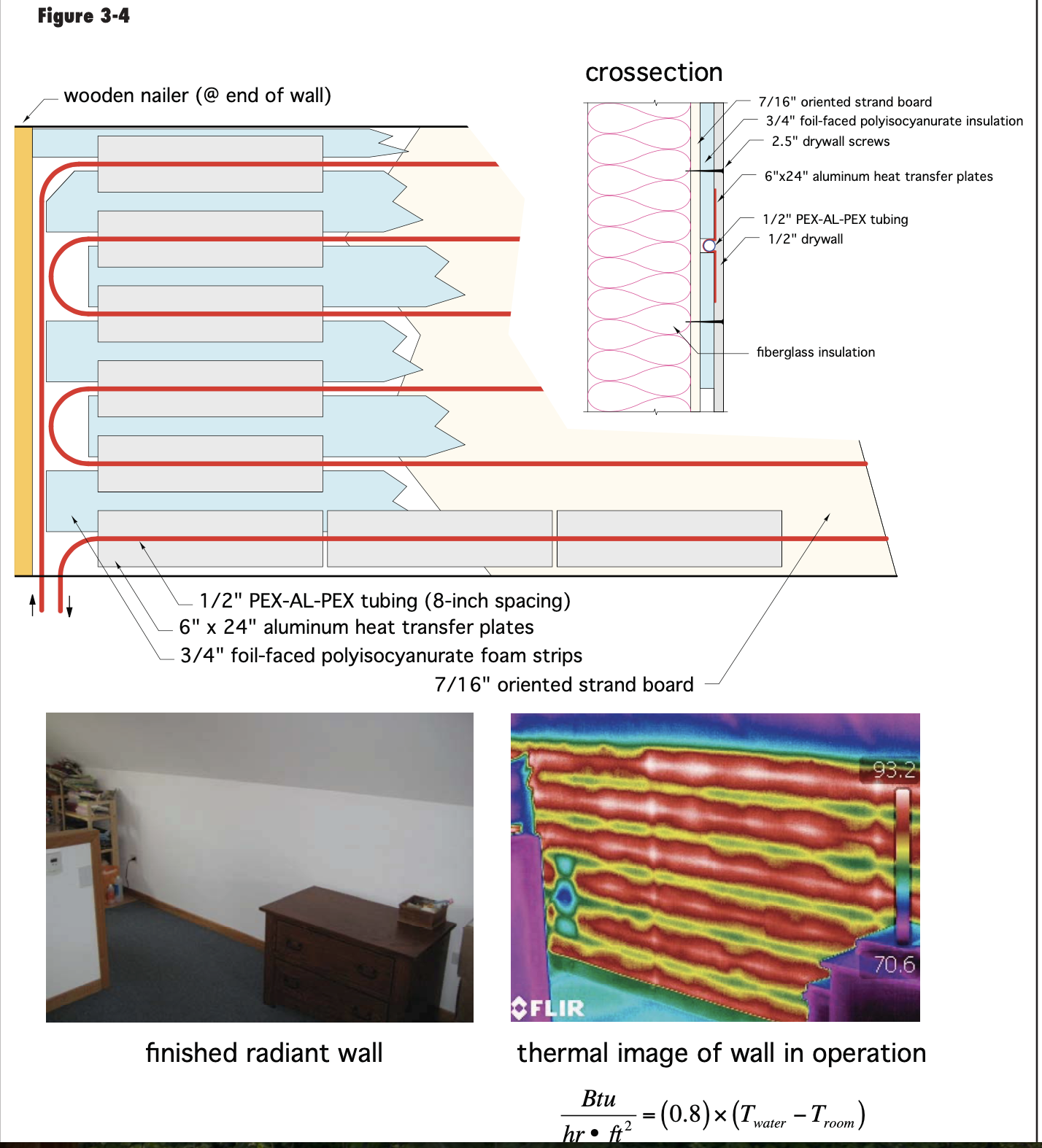

    You kinda have a mix between a radiant wall and a convector wall.
    A radiant wall the fins touch the finished surface and warn it to 80- 90°. The wall becomes a radiant "panel" Generally we go up 3' with wainscoat and a chair rail at top. A radiant panel moves most of the heat by conduction. The warm tube needs to touch the final surface.
    In this example the sheetrock is in contact with the transfer plates.

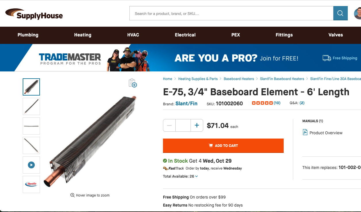

    Your method depends on air currents to move the heat out of the space, so you need a lot of fin surface area and a much higher temperature.
    If you look at a pieces of copper fin tube the design is many fins with a small air gap to start convection currents.
    If you want to stick with that design I think you need more fin surface or a product like UltraFin that works on convection heat transfer. UltraFin from the same people that designed the Cross manifold.
    If you want the convection system, just get some blank fin tube element

    hot_rod Posts: 28,705

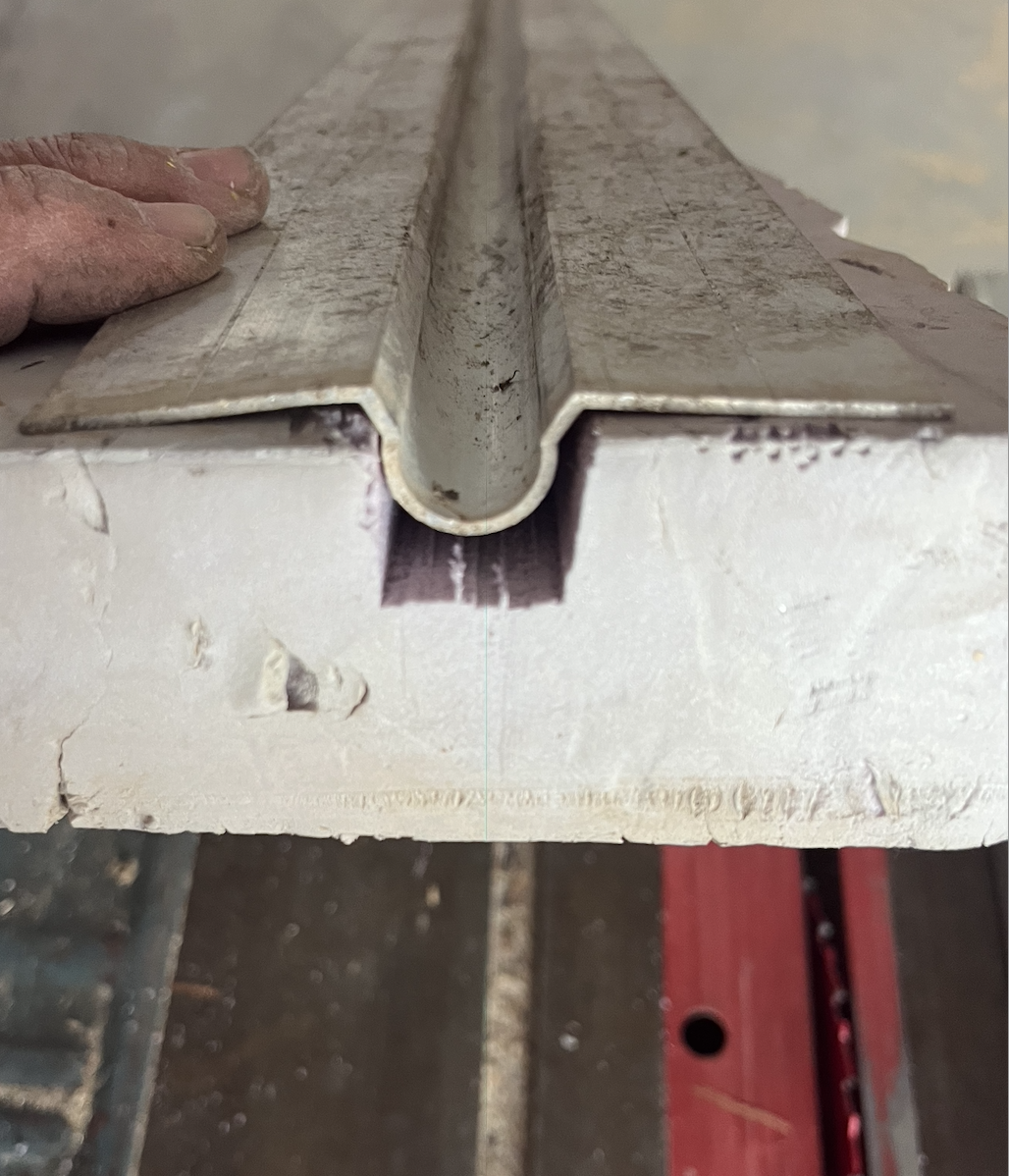

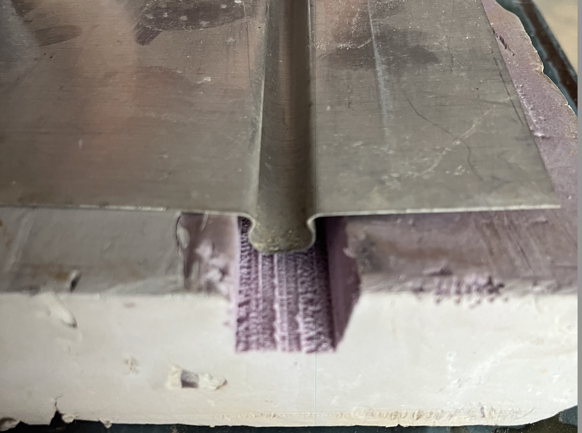

    It's a messy job but you can router or use a saw and groove the foam for the plates to go into. I ran this 2" pink foam through the table saw a few times.
    Wood could mount right onto the foam so the plates are tight against the back of the wood. No need for sheetrock and wood, it's just more to drive heat through.
    Acclimate the wood on the job so it doesn't shrink too much when the heat hits it. T&G or lap wood works best to hide any movement. The key to keeping wood stable is maintaining humidity in the room. It's more about humidity that heat on the wood.
    With tight, 6-8" tube spacing 90- 100 supply should be adequate.
    Map it carefully so you don't nail into the tube!
    3/8 tube is ideal, easy to bend. It can be done with 1/2" also, clip the tube loop ends so it doesn't try and pop out of the plates until the wood is on.
    I prefer the thicker plates like this Radiant Design Omega plate (Bozeman, Montana) This one is bent a little on the end, they should lie flat in the foam channel
    If the tube is not tight in the plate and the plate tight against the wood you may get some "oil canning" noise as it heats up. The thin plates are famous for that ticking noise.
    Use hidden screws for the wood just in case you need to get back into the assembly. T&G with a blind screw in the tongue is ideal.

    My vote is for adding 1" foam strips rather than grooving the Styrofoam. Hot Rod is right, I've done a lot of it, and cutting foam with a table saw or router is really messy business.

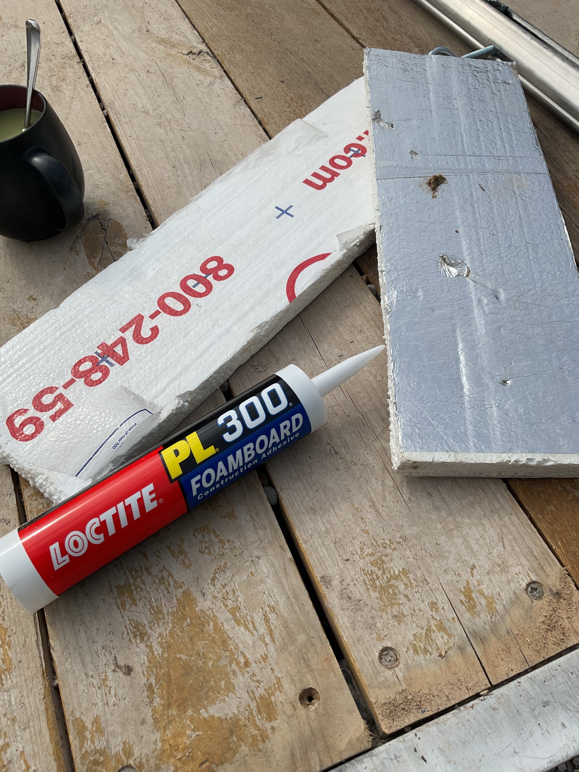

  • Ok thanks guys. I will plan to add strips of 1" foil faced foam board, on top of the 2" foam board, to act as the final backing and create grooves for the fins and piping.
    I'm thinking I want to avoid the addition of furring. Instead I'll use construction adhesive to attach the 2" thick foam board layer to the concrete walls, followed by the 1" thick foam board strips (also glued on), with the aluminum fins glued on top of that. Finally the piping will go in, along with some 100% silicone.
    Which glue and/or silicone product(s) would you recommend for each of these layers?
    no need to use foil backed insulation, either pink, blue board or the white bead board.
    But I think the white breadboard may have foil on one side anyways?
    You need to use foam adhesive, regular construction adhesive will eat into the foam and not hold. Unless it specifically states foam compatibility. I get this Loctite brand from Home Depot
    Expanding spray foam cans work also, but messy to use and you need to keep pressure on the foam or it pushes off the wall

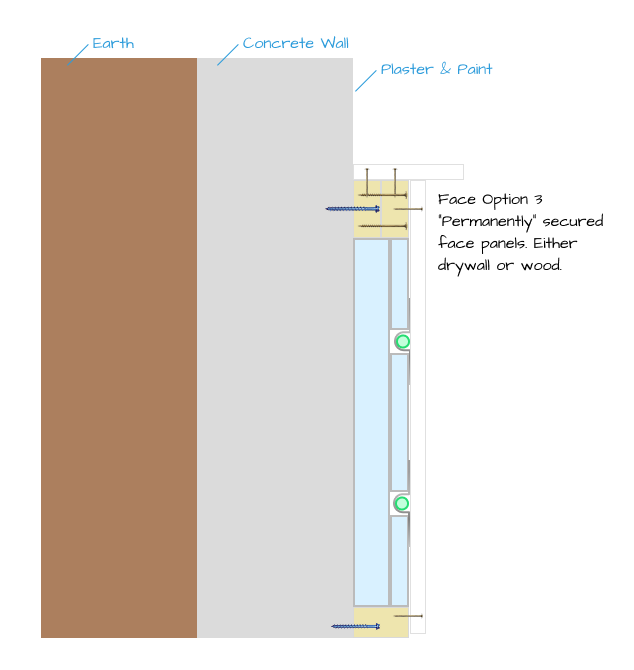

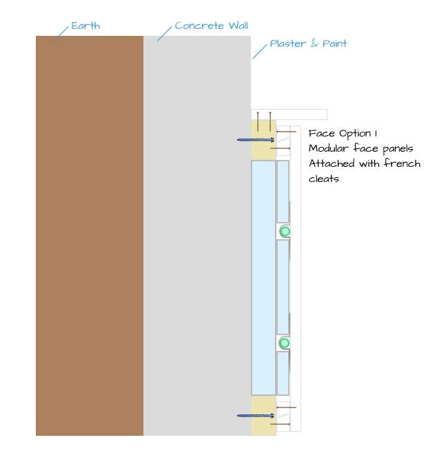

  • Ok, updated plan with 3 options for attaching the faces. Option 1 uses modular panels attached with french cleats. Option 2 is modular, attached with magnets. Option 3 is "fixed".
    it comes down to how much time, energy and $$ you want to throw at it.
    All the wall and ceiling radiant I have installed or worked on is buried in Sheetrock, a tile set, or behind nailed on wood if some sort, option 3
    Even nailed on wood or Sheetrock could be removed😗 Tiled surfaces are a bit more permanent
