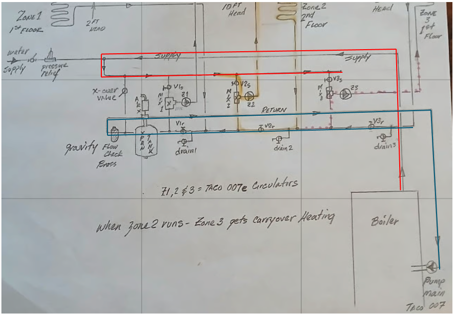

I have a cast iron boiler serving three zones of radiant floor heating loops. The boiler has a feed pump and each zone also has a circulator pump. Two loops are downstairs (main living space) and one in upstairs master bedroom.
The problem: when I run the upstairs zone to a comfortable temp, the system backs up flow into one of the downstairs zones causing severe over heating.
Each zone has a temp mix valve, but at 115°F and unchecked flow thru the non-active loop, it can get 75° in the family room... very uncomfortable.
Any thoughts on a solution?

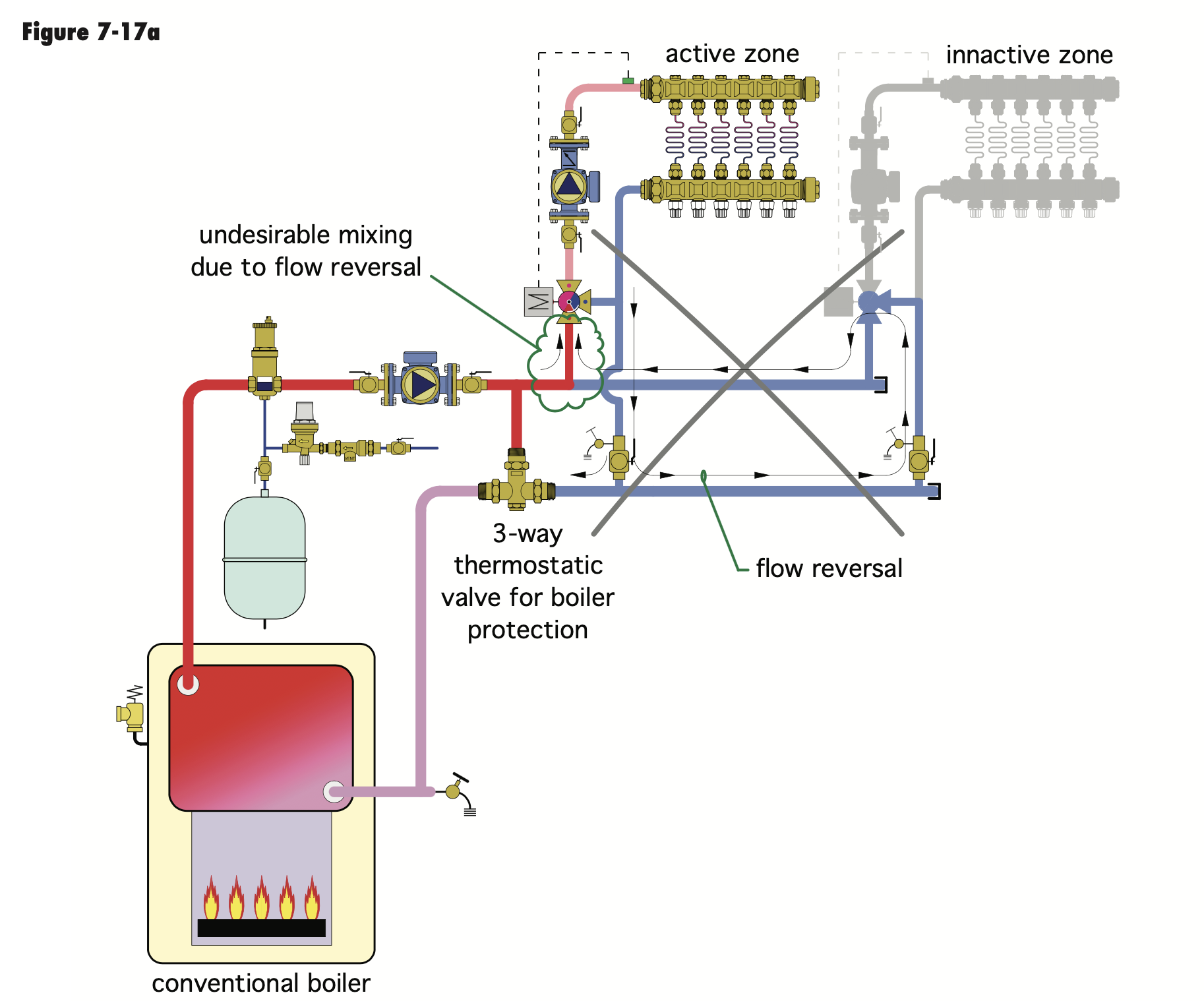

    hot_rod Member Posts: 27,904
    Spring checks used in hydronics have a spring with a 1/2 psi "pop" opening. Weak enough for even a small circ to push open.
    That is enough to prevent gravity or ghost flow induced by the buoyancy difference between hot and cold fluid. Which is the concept the the old gravity systems operated under.
    Older style cast iron flo checks had a tapered weight inside that acted as the spring does,
    Screenshot 2025-10-28 at 10.11.00 PM.png Screenshot 2025-10-28 at 10.12.16 PM.png

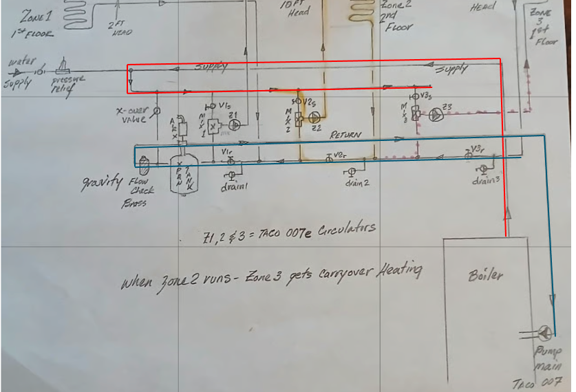

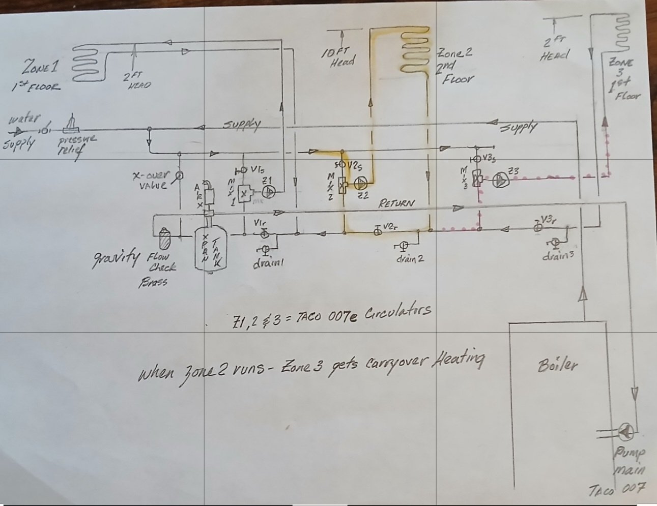

    So here's the system schematic (attch) the reason I was skeptical about the check valves was because I had the circulator out this summer and cleaned them all, so them being stuck open didn't seem to make sense. Also, to be honest, I hadn't heard of this ghost flow issue previously, but understand it now.
    So, assuming that it isn't the check valves, is there anything else that could make sense? The last submission talks about other flow controls, but not sure where i would add them.
    Would it be better to have zone valves instead of zone circulator pumps?

    Looks like an attempt at a primary secondary piping. As it looks your boiler pump is pushing flow through what should be secondaries. Looks like a cross over valve to mitigate the unwanted flow?
    A very common mis-understanding of P/S
    Follow the flow out of the boiler. Anytime the boiler pump is running it can push some flow through mix valve 1, 2 and 3 without those zone pumps running.
    Additionally you can get reverse flow through inactive zones when another zone is running.

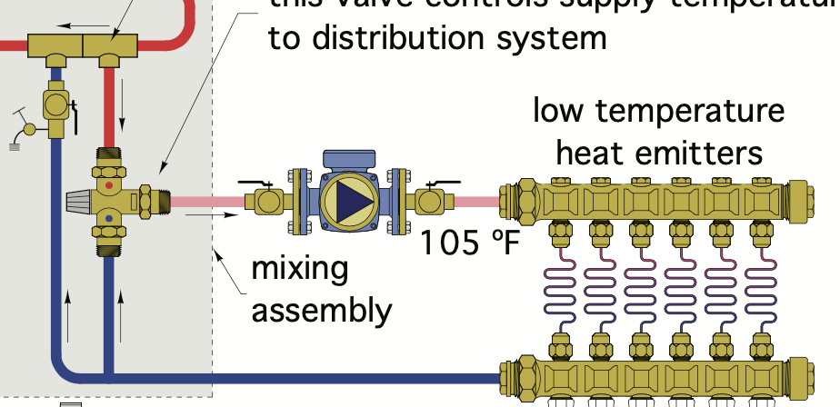

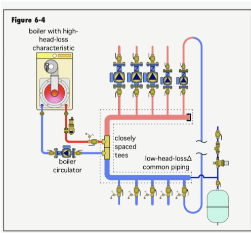

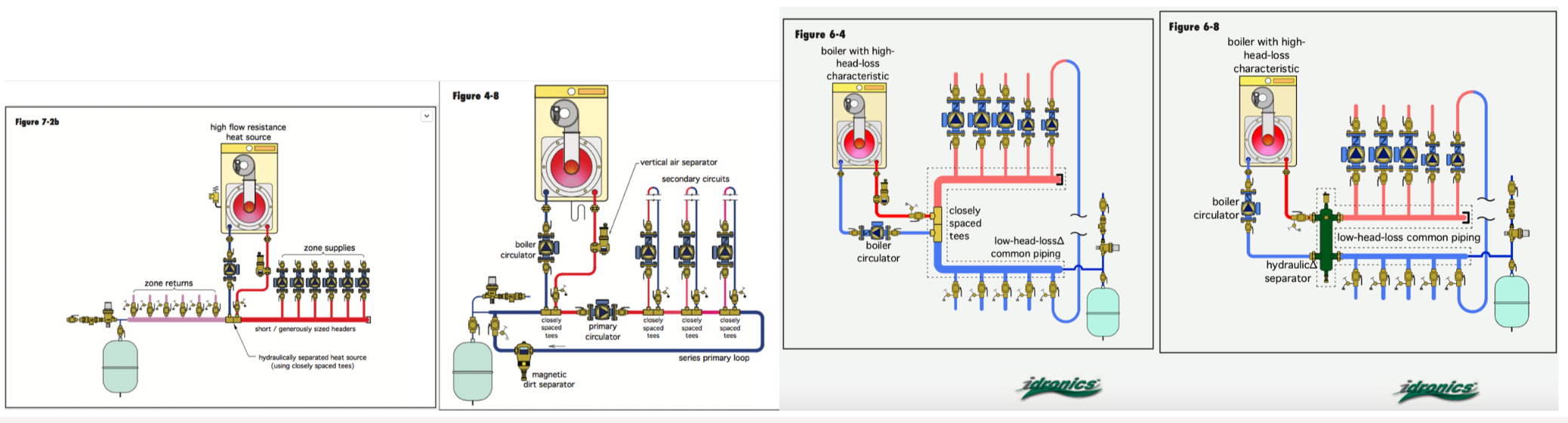

    Here are the most common primary secondary piping arrangements. I think they were shooting for #2? Or a pipig where the boiler is the primary loop. But secondaries need to come off closely spaced tees, if the loop is complete.
    4 P:S options.png
    This is a primary secondary with the boiler within the primary loop. Secondaries vis close spaced tees.

    A couple of questions.
    Why are you regulating flow with ball valves? Why not use balancing valves made for that purpose? The flow thru 3/4" copper pipe should be about 4 GPM max. Ball valves must be 90%+ closed before regulating.
    Why are some of the ball valves fully open on Zone 3 and partially open on one 1 &2?
    Is it possible that Zone 3 mixing valve is installed backward (H to C or C to H)? Mixing valves are directional and there must be a temperature differential between the H & C inputs for it to function properly.
    The EX-tank should have been installed on the supply instead of the return to the boiler. There is more efficient air removal in that position and pumps run better being on the output of the EX-tank.
    Your diagram shows a good chance for ghost flows because of a lack of check valves on the returns from the heating loops.
    I don't see a need of a gravity flow check in that position. I would put one in the volute of the boiler pump, tho.
    Is it possible that both pumps run when Zone 2 is running?
    I would close the ball valve going to the mixing valve on Zone 3 and run Zone 2 and see if Zone 3 still over heats. Tell us what happens.

    The 4 images of boiler setups above, ⁶all show the exp tank in the return line?

    Ps... Anyone think a hydraulic separator would help? Image 4 in the above set of 4 boiler layouts.

    Here is some color added. For flow from the boiler to get back to the boiler it has to go through either a zone or the cross over valve, whatever it's intent is.
    Also the boiler pump gets put in series with the zone pumps, if both run. I assume the boiler pump runs with any heat call.
    Also the 3 way valve wants the return from the zone back at the C port in addition to the return to the boiler. It tempers the mix with the cooler return from the radiant loop. I'd like to see the return tied right at the 3 way. An example of

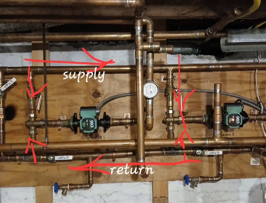

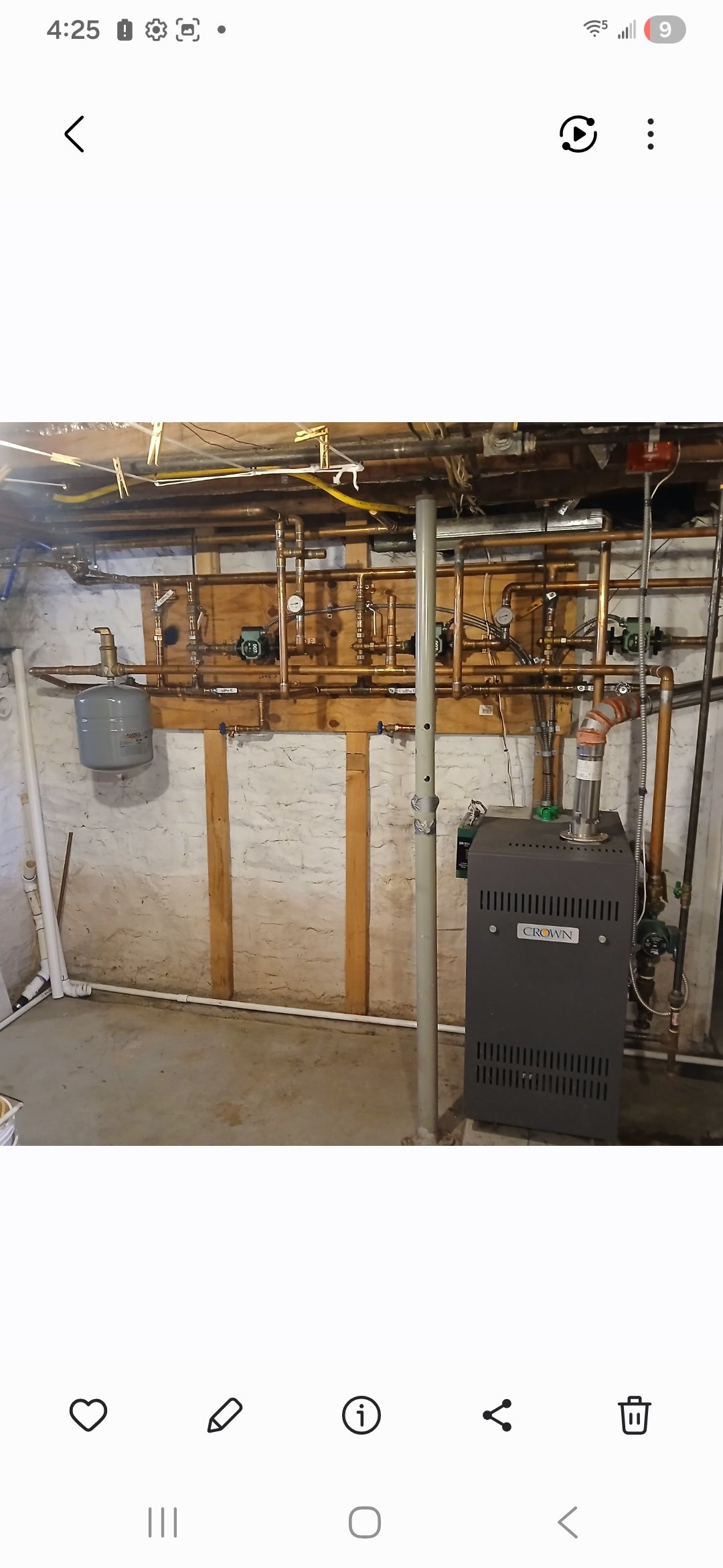

    Here's a picture of the system, kinda difficult to make everything out which is why I drew the schematic.

    Also finding it interesting that these layouts with " closely spaced tees" are putting the return back into the supply line??? Won't that dilute the supply heat to the next zone?

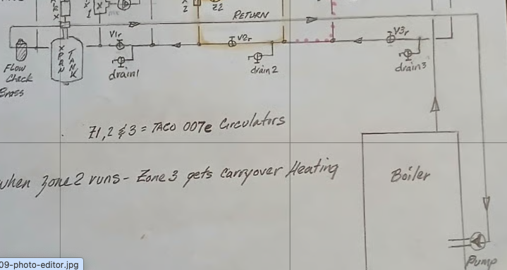

    Looks like some work was done here? A check added to the bypass?? Someone shooting the parts cannon at it?
    Think of a primary loop as a conveyer belt on your system.
    The boiler loads heat into that conveyer. To take a portion of heat out you tap into the conveyer belt.
    By using two tees close together you create a hydraulic separation between the conveyer and the zone. So the individual zones just pull off the conveyer what they need. And yes, in your example each set of tees down the line receives lower water temperature.
    With low temperature zones that is not a concern. You have mixing valves to adjust the temperature you need.

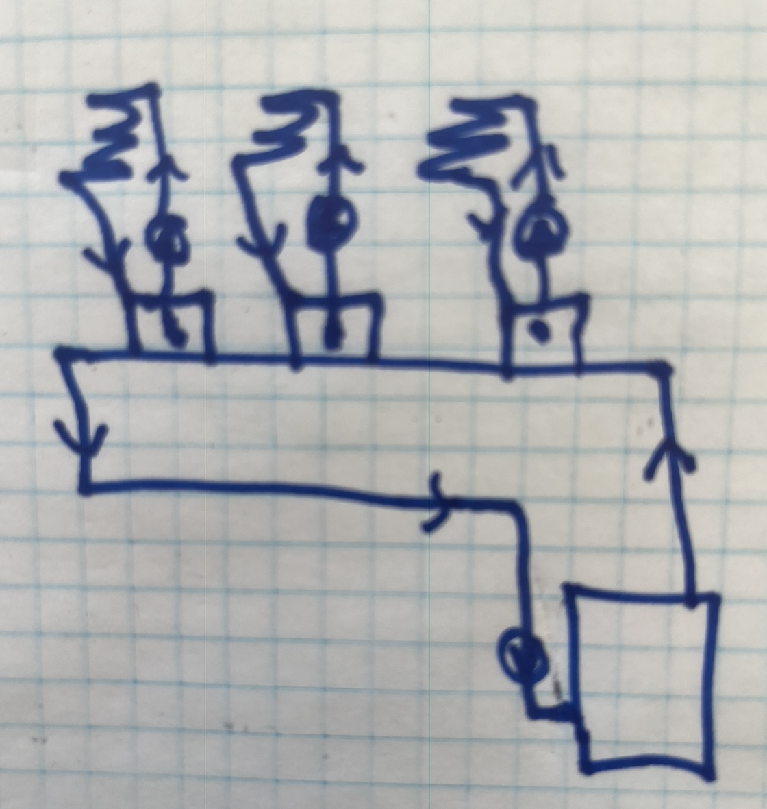

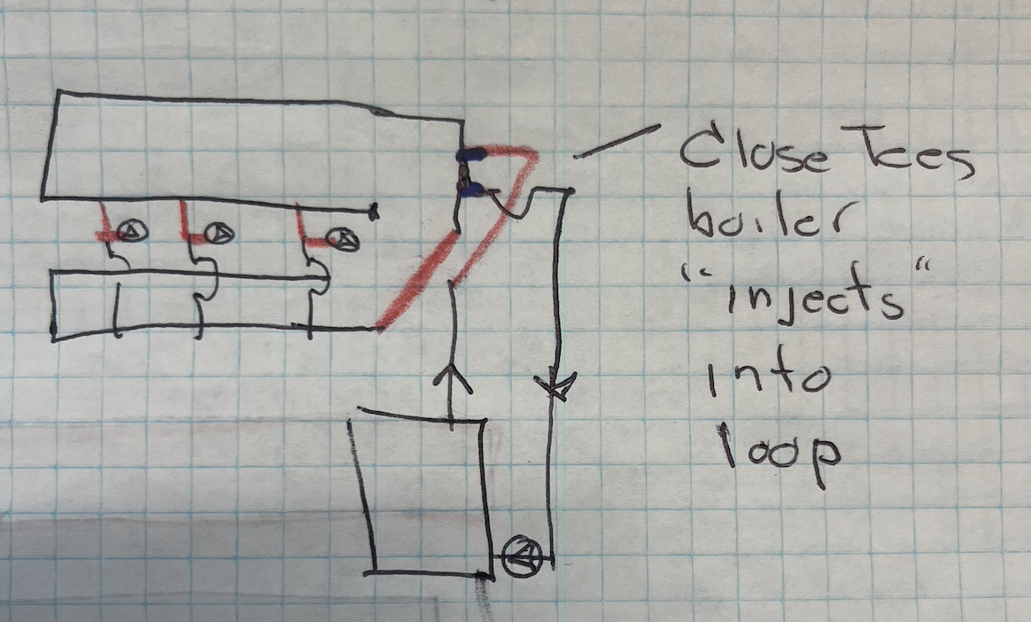

    Here is a way. hand sketch, I think you could correct this with the least amount of repiping.
    Connect the upper red line with the lower blue line, red line shown. Now you have you zone loop.
    Next the boiler needs to feed a supply of hot into that loop, but also a return back. Closely spaced tees MAKE a primary secondary piping system.
    Now system and pumps are isolated from one another. Boiler pump no longer interferes with the zone flow, they are isolated, hydraulically speaking.
    Screenshot 2025-11-07 at 3.02.16 PM.png Screenshot 2025-11-07 at 3.06.13 PM.png
    It will be a messy version of this "horseshoe" piping method.

  • Wfrcrownbwf
    Wfrcrownbwf Member Posts: 13
    HomerJS... OMG! you asked if Z3 mix was installed backwards and I said no, but was just down looking at what it would take to implement the changes to the new proposal and noticed that indeed Z3 mix valves is upside-down. Cold to Hot and Hot to Cold...
    Gonna have to straighten out tomorrow and see result... i had leaks with the original Taco mixers and a few of the shutoff & had a service guy replace the bad ones last heating season. I guess that must be when that happened...
    Sukhoi29SU
  • HomerJSmith
    HomerJSmith Member Posts: 2,795
    Hope that is your solution. That would be nice.
