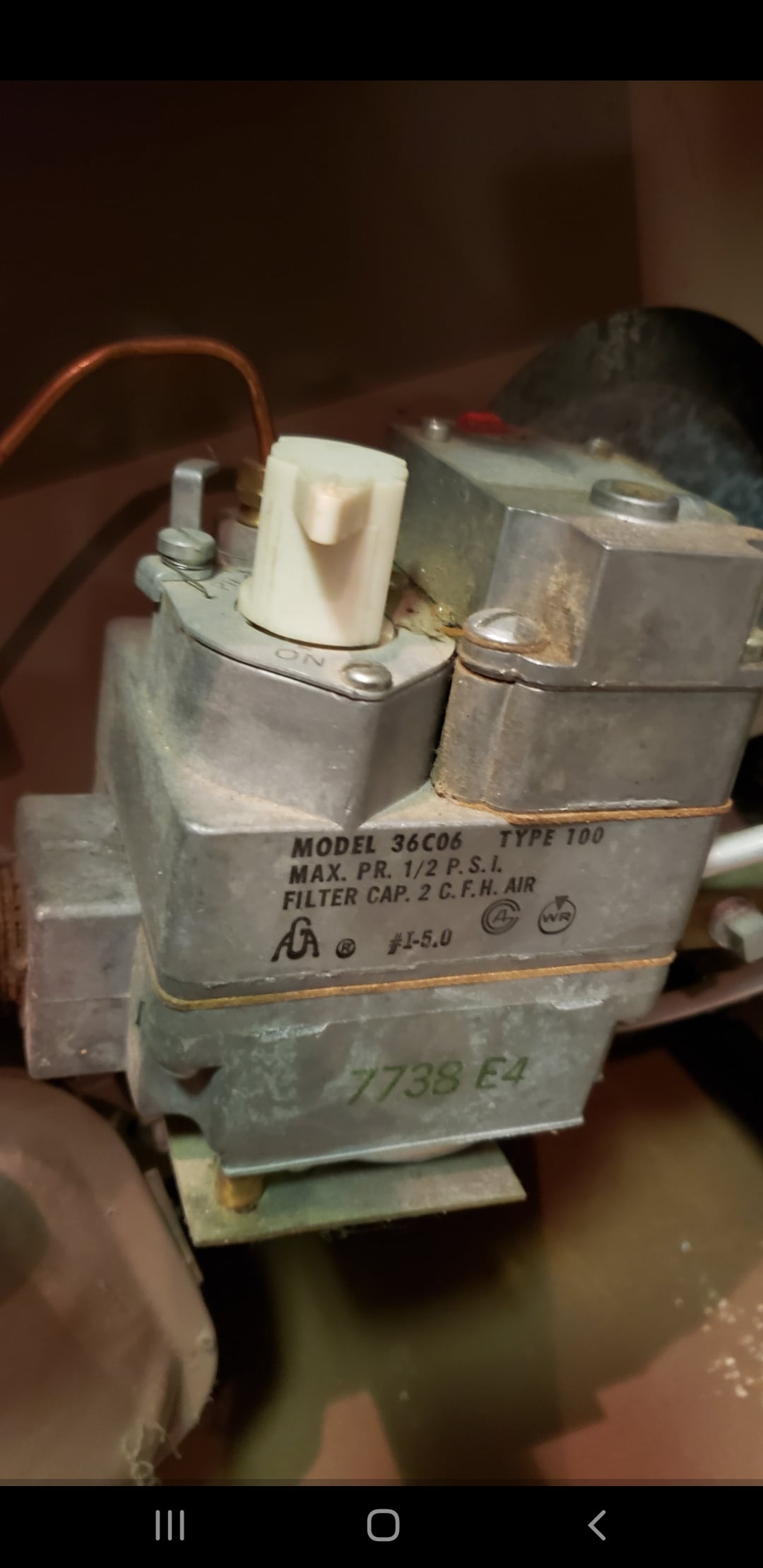

    The gas valve is a Model 36C06,,from my research today , I believe it looks pretty easy to convert the valve over and parts look available. Any recommendations on working on the gas valve would be great…

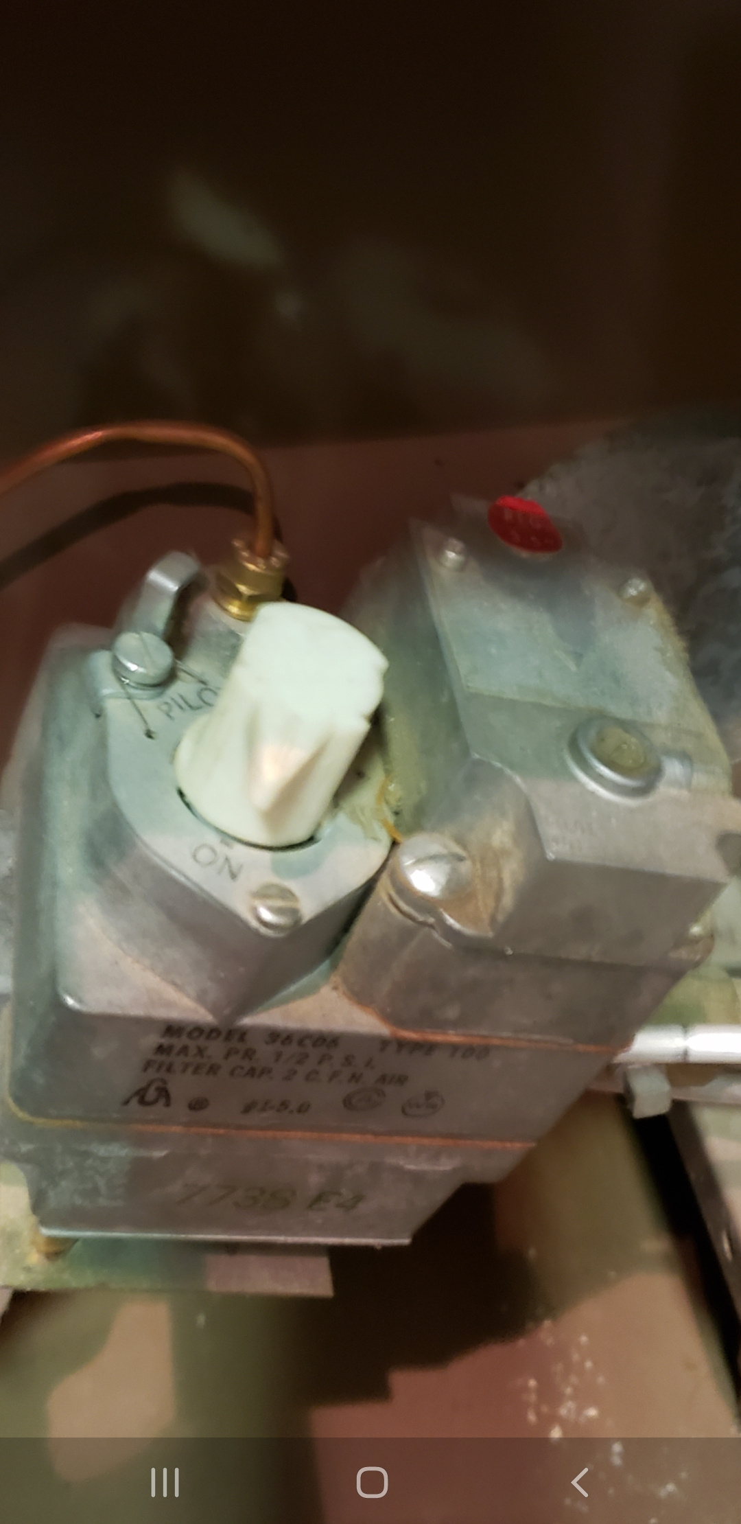

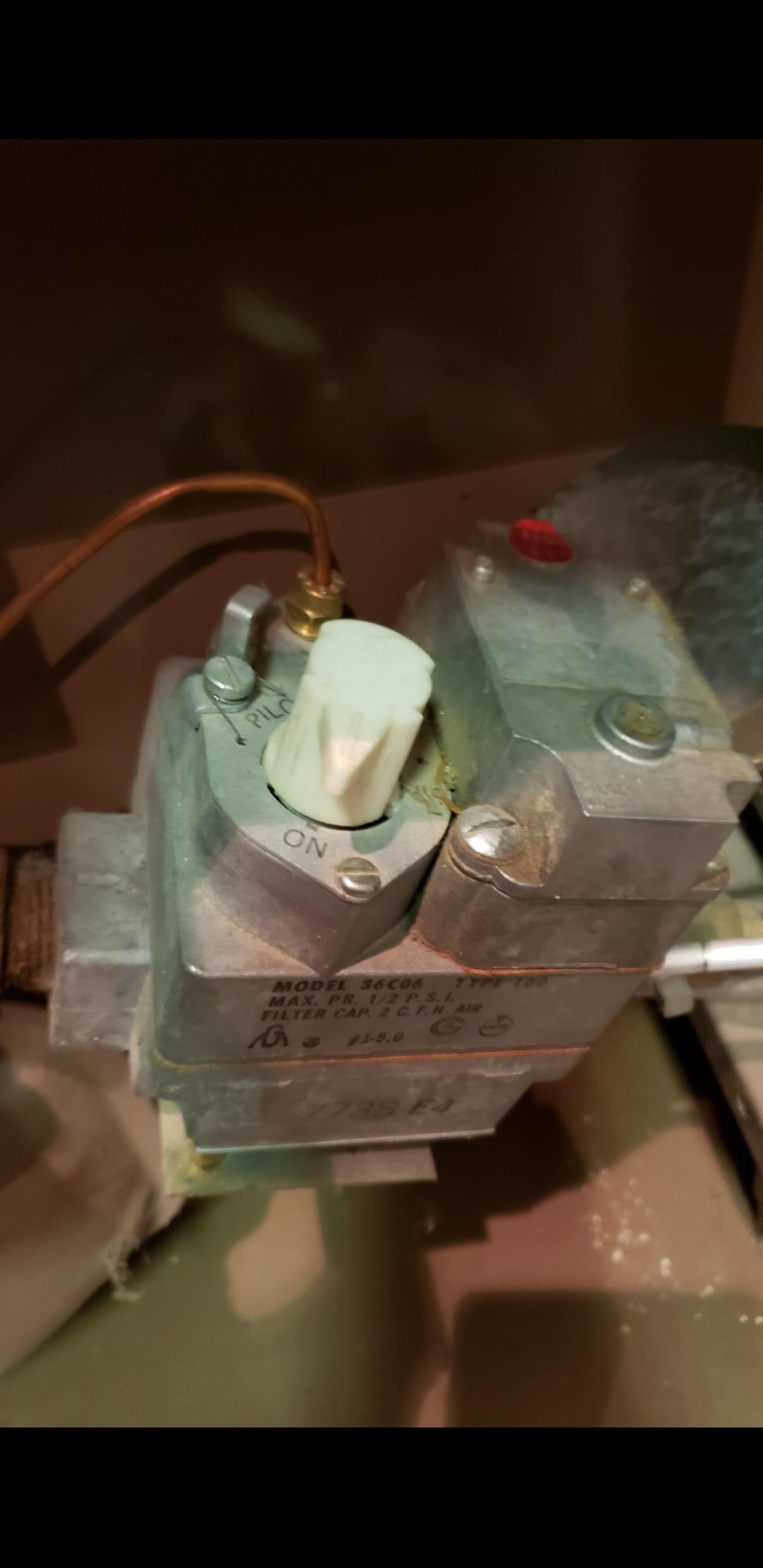

    Can anyone tell by these pics,,if this valve is natural gas only and I won't be able to convert it???

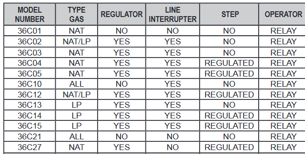

    109A_5 Member Posts: 4,228
    Sadly the only data I can find so far skips your gas valve.
    https://media.copeland.com/9483cfb3-af75-45f4-9aa2-b16b00f94e2f/R-4360_36_series_gas_valve_ref_9_12.pdf
