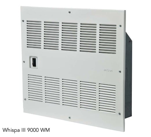

Original plan was to use (3) Myson Whispa III 9000 WM fan convectors as needed in the room, setup as a reverse return series with a remote TRV to control the trio. These are flush mount units that recess into the wall (framing already adjusted).
I've been using some of these same fan convectors in another area of the garage, and they are a lot louder than expected (the 30 year old FCU's were actually much quieter).

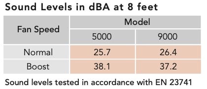

    Here's what Myson says are the sound pressure levels for the Whispa III 9000. They don't seem to make them anymore, which may be telling.
    NO WAY! Misleading - those numbers would have been fine, and are closer to the vintage models. They're not connected (in another space) at the moment b/c I currently am replacing some PEX, which serves this room too, hence sorting out this room's plan. Gauging off a vocal test and a phone app, I'd guess they are 40+ dBA on low and 50+ dBA on high at 8'. Basically, standing within 6', they're slightly to moderately competing with conversation on low and significantly competing with conversation on high. That's probably OK, but not ideal in a garage/shop setting. This area is probably best suited for noise about half way between garage/shop tolerance and standard indoor tolerance. So, probably something a bit less than a typical ceramic space heater.

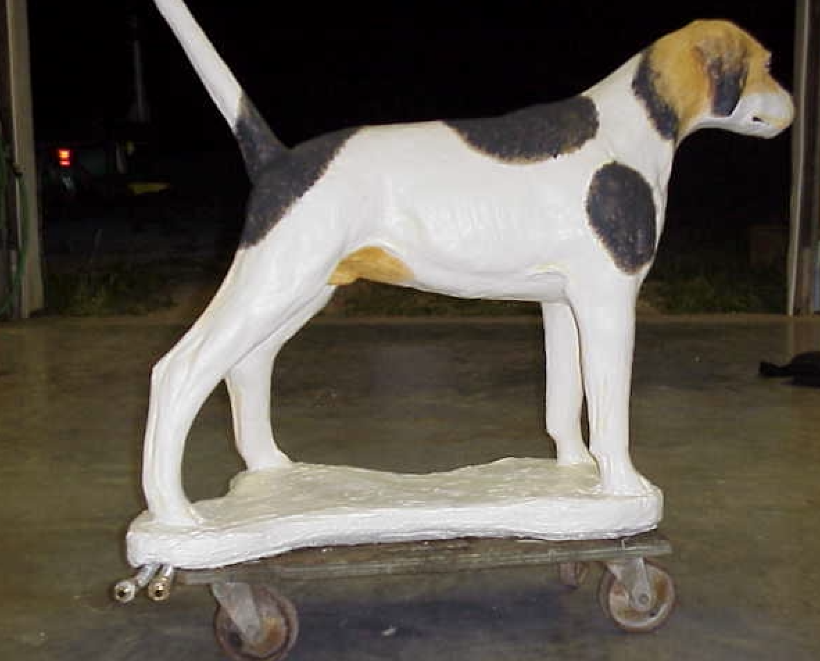

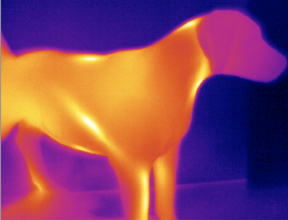

    I've built radiators out of copper, steel, even concrete. This 400 lb dog heated our bathroom and towels.
    Radiant heat is a line of site, the energy travels at the speed of light, not unlike the heat energy from the sun. Radiant ceilings will also warm the floor that it can see.
    Screenshot 2025-10-24 at 9.59.35 AM.png Screenshot 2025-10-24 at 9.59.56 AM.png

    Love the dog, Bob!! Edit: curious - modeled after a former dog of yours?
