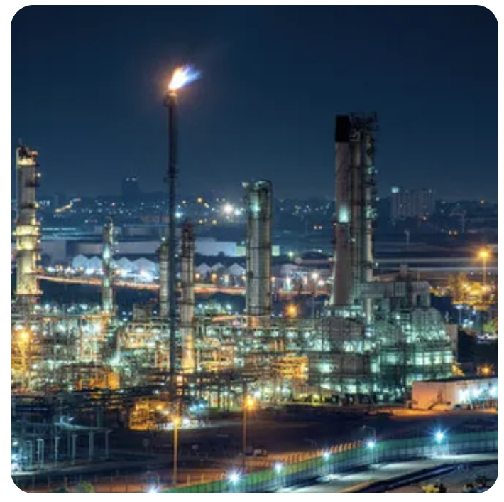

    If you ever drive past a refinery and see a flame at the top of a very tall stack,  that is LP Gas.
    When they make other fuels LP Gas is a byproduct of the refining process and when they run out of storage space, they just throw it away through that stack.  So in my opinion LP Gas doesn't really cost anything if the oil companies are just throwing it away.   Where the actual cost for LP Gas comes from is the insurance and the transportation costs.
