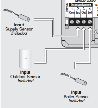

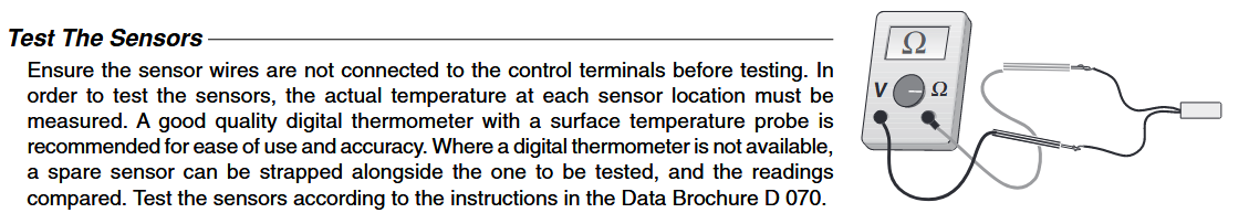

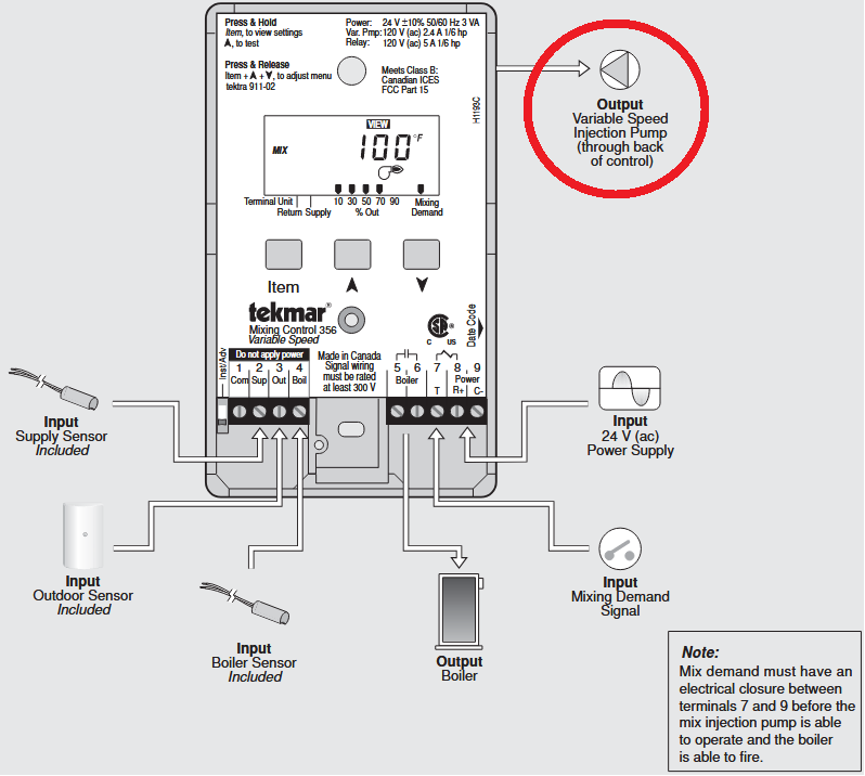

    The manual is attached. You have to identify the sensors you have (some are optional) to figure out how the control operates. There instructions and troubleshooting in the manual are pretty good.
    Follow that and come back with more information. It also tells you how to check the sensors.

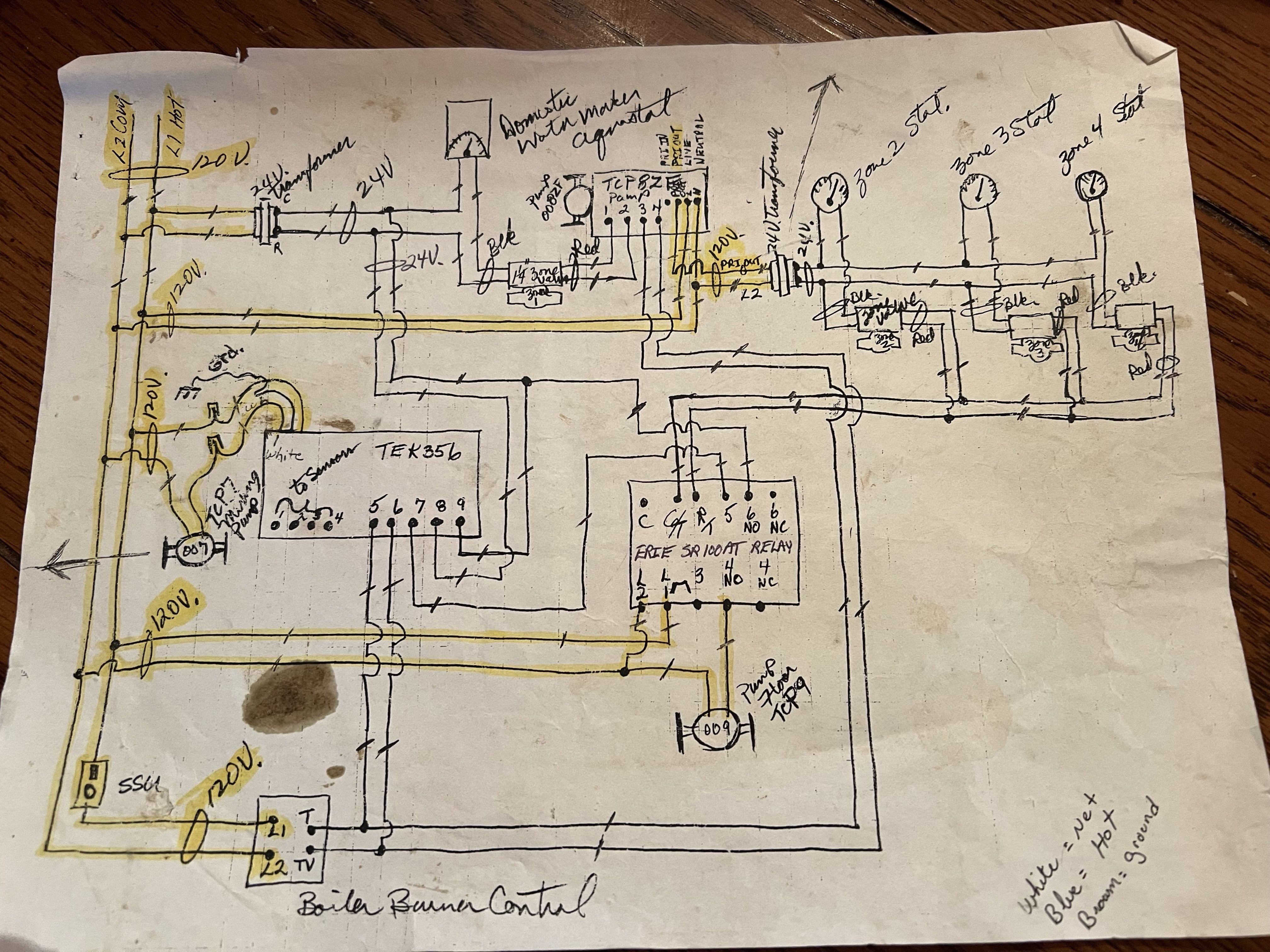

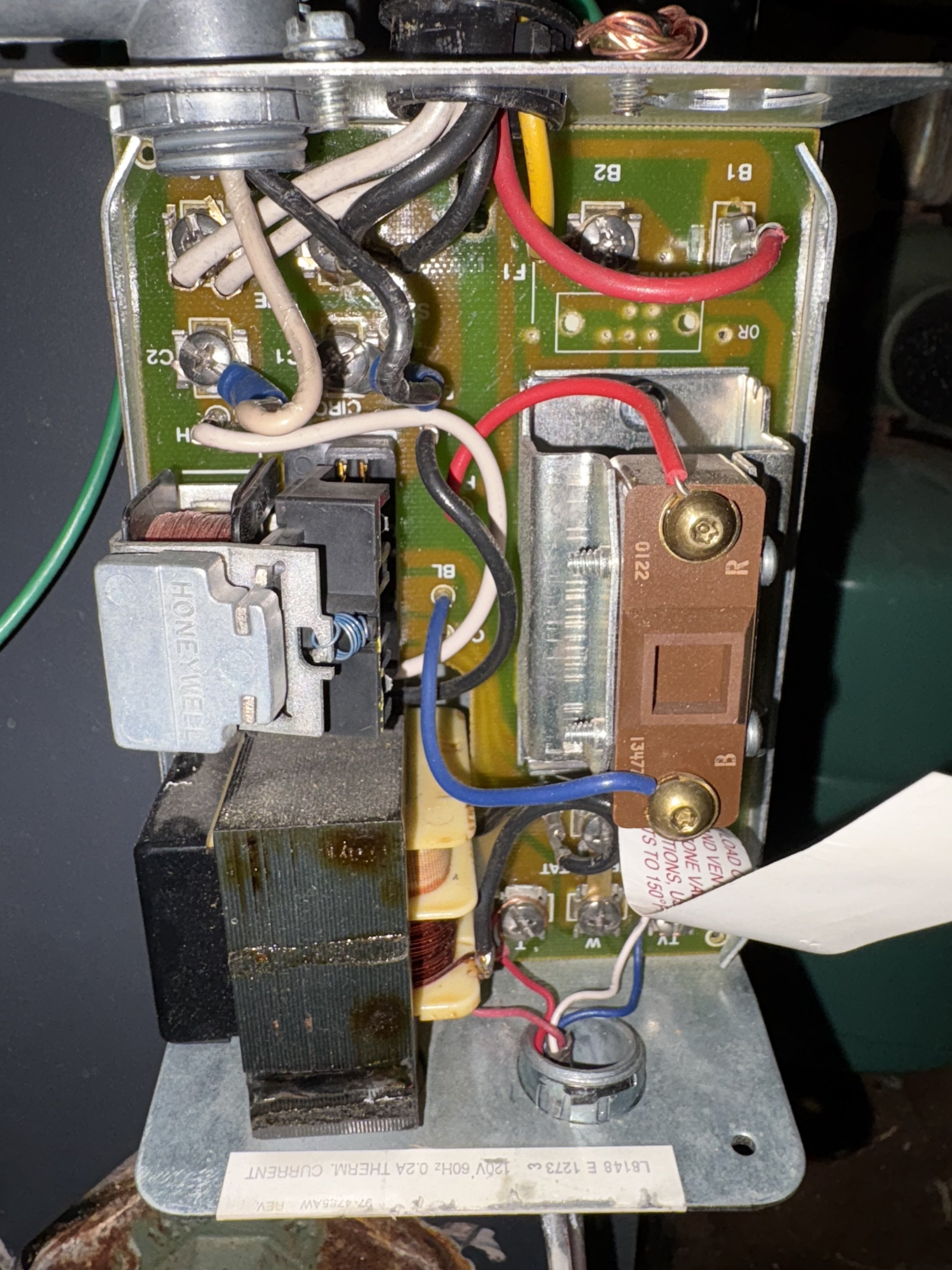

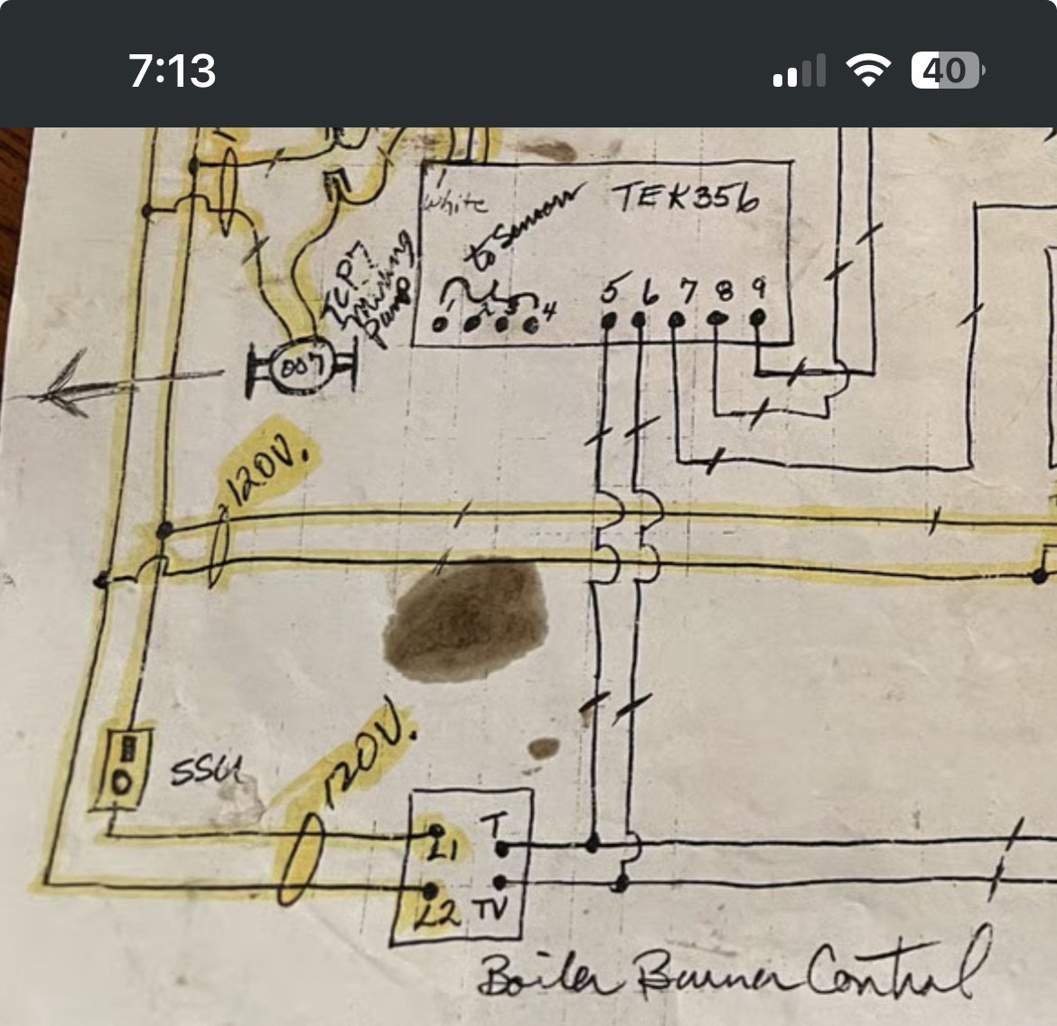

  • It has worked for 21 years. The model is a Slant Fin VHS90 direct vent. Here’s some layout pictures. All voltage checked out as it should but when the burner turns off it won’t keep the contacts in on the aquastat which turns off the boiler pump.
    when there is no call for heat, terminals 5 & 6 have 25.1 volts. Terminal 7(T) to 9(C-) 26.3 volts until the burner ignites at boiler minimum. 5 & 6, 7 & 9 all go to zero volts and boiler pump turns on and burner turns on. Burner ran to 146 degrees, turned off which turns off boiler pump. The 356 still shows demand and mix out, but the boiler pump is not running. Terminals 5 & 6 are at 25.1 volts, terminal 7(T) & 9(C-) are at 26.3 volts. Thermostat is turned clear up and this all happens within 5 minutes.

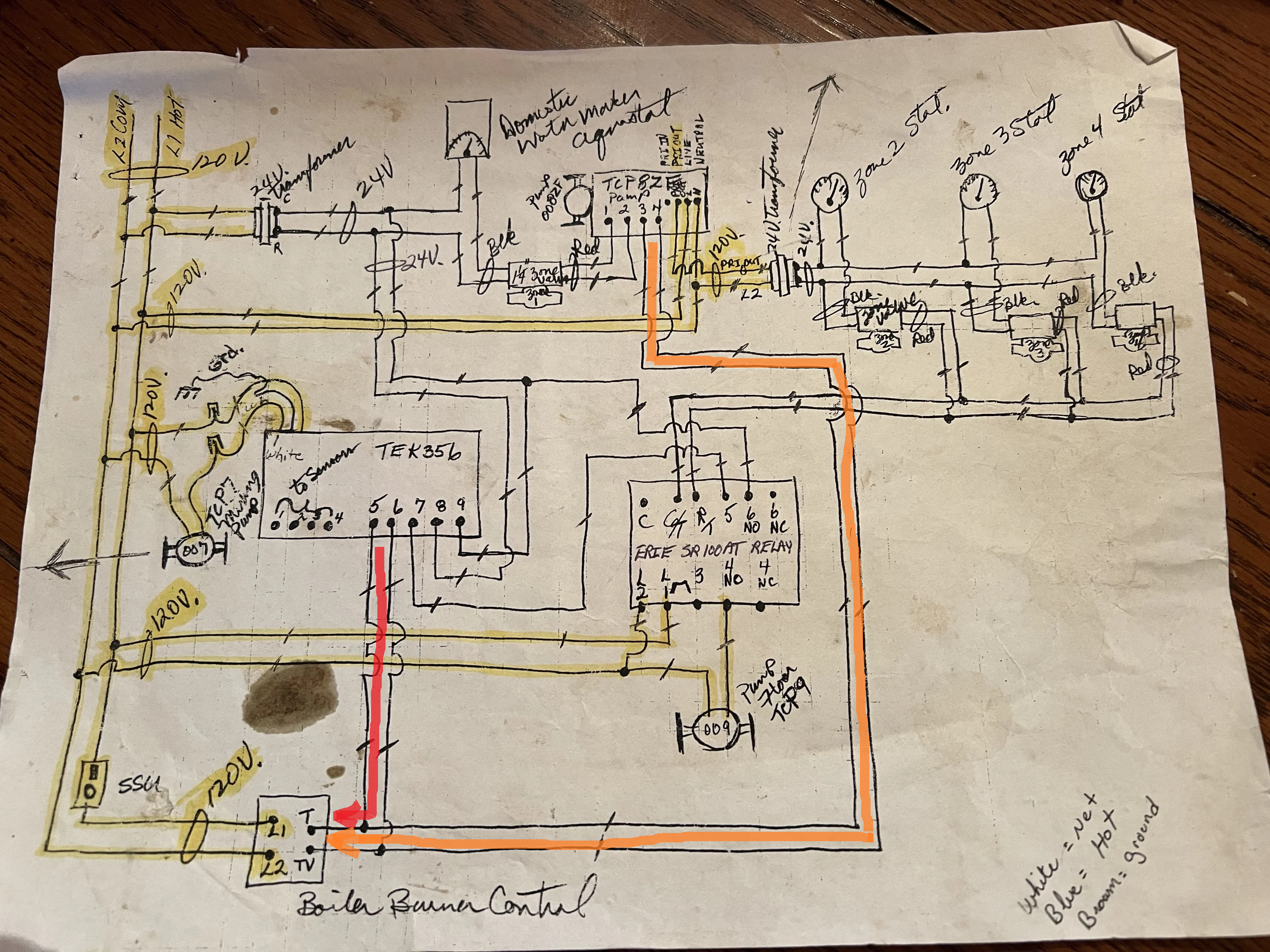

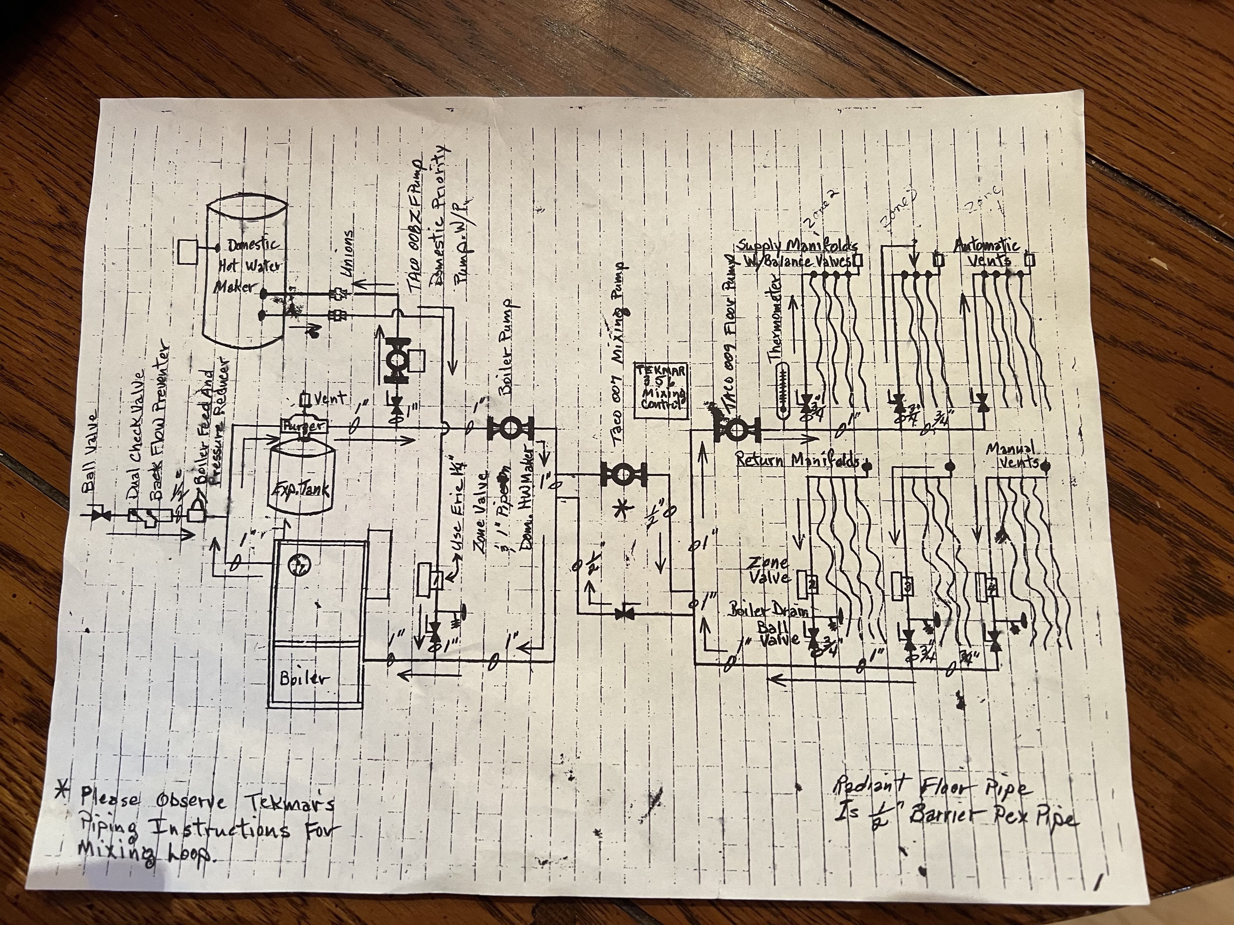

    You have 4 pumps
    Mixing
    Boiler
    DHW
    Floor
    Is the boiler pump the one shutting off?
    I don't see the boiler pump on the wiring diagram.

    As drawn you have 4 circulators, assuming the DHW one is not a problem. For the floor to get heat the 3 need to run. Are all 3 not running or other. If other which run and which do not ?
  • Thanks for all your responses! 8 & 9 are power in from transformer. 5 & 7 go to the aquastat burner control on the bottom of the wiring diagram then on to taco007 boiler pump just left of the control on the diagram. Yes, all pumps are running except taco007 which circulates water through the boiler so when it’s off my mix is not getting heated water.

    I presently see no control provision for the Boiler's circulator on your wiring diagram, I will check the boiler's manual if I can find one.
    109A_5 Posts: 4,759
    I see no provision for the boiler's circulator to run without the boiler's burner running. The Orange annotation is the DHW control of the boiler's burner, the Red annotation is the Tekmar 356 burner control. I would expect when the Tekmar 356 contact closure 5 & 6 opens the boiler and its circulator would shut down.

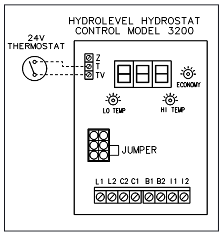

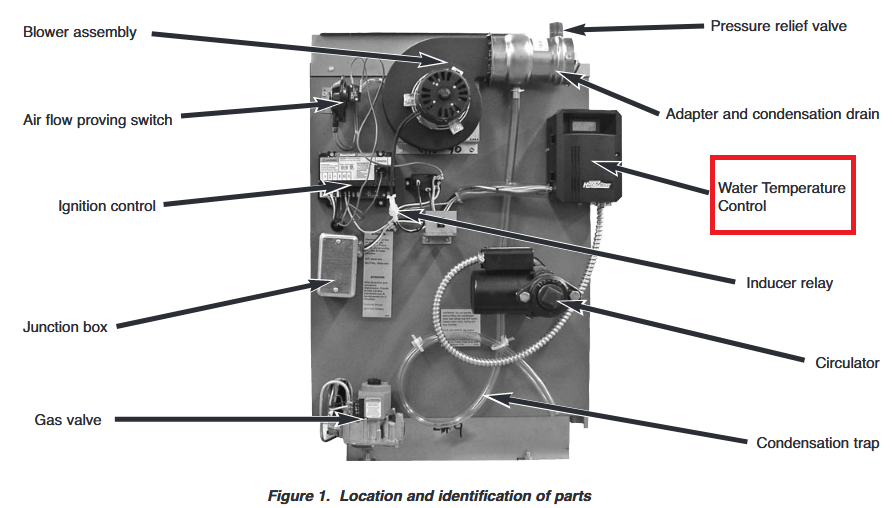

    Do you have the Hydrolevel Hydrostat 3200 ?
    109A_5 Posts: 4,759
    edited October 2025
    If your system uses the Hydrolevel Hydrostat 3200, I would think your system would control it with separate inputs to the Hydrolevel Hydrostat 3200. Gives the DHW priority. It would not solve the present issue of having the boiler's circulator running with the burner off.
    If you have a Hydrolevel Hydrostat 3200, did it use 'Outdoor Reset' feature ? Maybe the 'Outdoor Reset' sensor has failed. Which may explain the situation.
    One input for DHW and the other for the floor zone heating. An example;

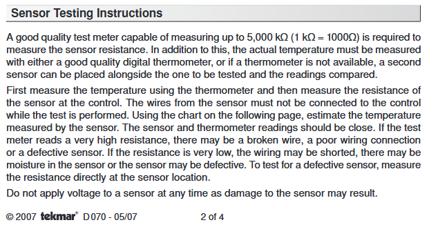

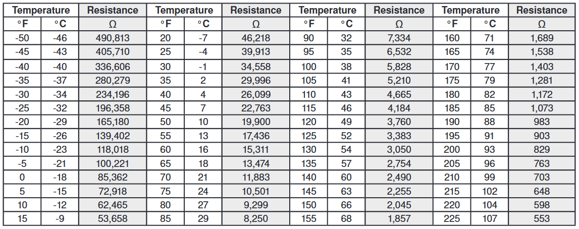

    Was the resistance of the Tekmar 356 sensors tested ?

    " when there is no call for heat, terminals 5 & 6 have 25.1 volts. Terminal 7(T) to 9(C-) 26.3 volts until the burner ignites at boiler minimum. 5 & 6, 7 & 9 all go to zero volts and boiler pump turns on and burner turns on. Burner ran to 146 degrees, turned off which turns off boiler pump. The 356 still shows demand and mix out, but the boiler pump is not running. Terminals 5 & 6 are at 25.1 volts, terminal 7(T) & 9(C-) are at 26.3 volts. Thermostat is turned clear up and this all happens within 5 minutes. "
    EDIT: Actually this makes no sense;
    " Terminals 5 & 6 are at 25.1 volts, terminal 7(T) & 9(C-) are at 26.3 volts. "
    If this is true you have lost your call for heat, since the Erie SR100AT relay contacts 5 & 6NO are now open. Terminals 7(T) & 9(C-) are controlled by the Erie SR100AT relay contacts 5 & 6NO.
    I suspect the Tekmar 356 terminals 5 & 6 are at 25.1 volts, terminal 7(T) & 9(C-) are at 0.0 volts. Still a call for heat from a zone call energizing the Erie SR100AT relay closing contacts 5 & 6NO but the Tekmar 356 shuts the boiler down by opening its contacts 5 & 6.
    Basically using your data above; I suspect the Boiler reaching 146 degrees and that satisfies the Tekmar 356, so it opens 5 & 6. Which shuts down the boiler and the boiler's circulator. However a zone thermostat is still calling for heat. It won't get the heat since the boiler's circulator is now off.
    If the Hydrolevel Hydrostat 3200 settings or the 'Outdoor Reset' curve functionality is configured to limit the boiler to say 140 degrees then the Tekmar 356 would not open 5 & 6 terminating the call for heat to the boiler. Since the Tekmar 356 will never see 146 degrees.
    If the boiler reaches 140 degrees and the Hydrolevel Hydrostat 3200 shuts off the burner it may keep the circulator running since the the Tekmar 356 would still keep 5 & 6 closed calling for heat.
    I'd check the Hydrolevel Hydrostat 3200 settings and if it is set up for 'Outdoor Reset' operation. If the Outdoor Reset is in use but not functioning check the Outdoor Reset sensor for the proper connections and resistance. Sadly I could not find much information on testing the Hydrolevel Hydrostat 3200 Outdoor Reset functionality. Apparently when the sensor it connected and the ratio is set it just magically works with no way to verify it.
    If any of the sensors (Hydrolevel Hydrostat 3200 and / or Tekmar 356) are not reading correctly it is hard to expect the system to operate correctly.
    Another thing I noticed is according to your piping diagram the DHW does not need the boiler pump for DHW, it has its own pump, but it appears the space heat and the DHW both use the T & TV terminals to fire the boiler. So the boiler pump may be unnecessarily running when actually not needed.

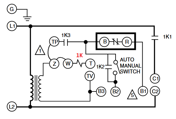

    I'll re-read your post today, but if you are using a L8148 and either the DHW or a floor zone call for heat is by the L8148 T & TV terminals, the boiler's burner and the circulator are commanded on & off at the same time, simultaneously.
    Only the L8148's high limit would shut the burner off with the circulator still running. If however the Tekmar 356 is cutting off the boiler at 146 degrees, the boiler will never get to the L8148's high limit if set above 146 degrees.

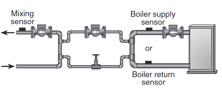

    Looks like the Tekmar 356 settings are certainly able to go above 146 degrees. Are the sensors in the correct place ?

  • The sensors are in the correct place. When I turn up thermostat 7 and 9 go to 0 Volt. 5 and 6 do not unless boiler is at minimum and fires burner. 7 and 9 are still at 0 volt as well as 5 and 6 until burner shuts off. When burner turns off 7 and 9 are still at 0 Volt but 5 and 6 go to 25 Volts. 356 is still calling for heat. Mixing pump and floor pump are running, but don’t get hot water because 5 and 6 are not at 0 volt to run boiler pump. If I remove 5 and 6 from 356 and jump them together boiler pump and burner run. Do you have any other suggestions?

    proves to me the zone(s) still have demand BUT the Tekmar 356 is no longer calling for heat. I suspect this is probably because the boiler temperature at the supply sensor has satisfied a setting parameter in the Tekmar 356, so the Tekmar 356 discontinues its call for heat. With the call for heat discontinued the boiler water is stagnant (boiler's circulator is off) and may take a while for its temperature at that sensor location to lower to the point where the Tekmar 356 decides to call for heat again.
    It appears to me in your opinion something changed to get to this present behavior. I am having a hard time with the system logic. There seems to be a control path missing which would keep the boiler's circulator active as long as there was demand from a zone. Which is kind of where you started.
    Seems to me the relay (presently the Taco SR 501-5, formally the Erie SR100AT) should control the Floor circulator and the Boiler's circulator. (DHW is a different circulator) The wires going to C1 & C2 in the Honeywell aquastat relay type L8148E should be removed from the Honeywell aquastat relay type L8148E and connected in parallel with the Floor pump. So as long as there is zone demand the Taco SR 501-5 relay energizes both the Floor and the Boiler circulator.
    This seems to me as a design error and not a recent change or defect.

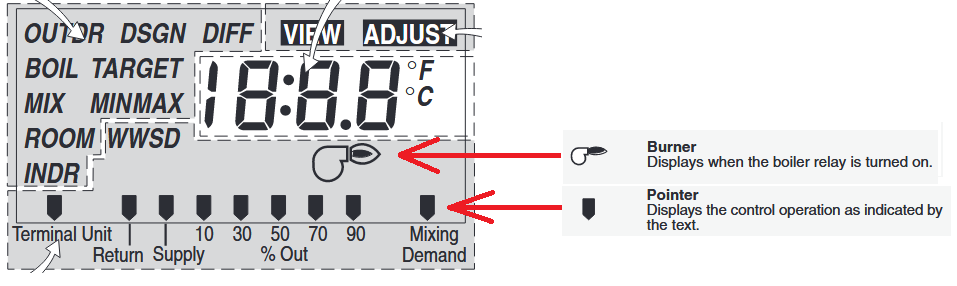

    Just to be clear when the burner turns off and the Tekmar 356 terminals 5 and 6 go to 25 Volts the Burner icon is gone and the Mixing demand is still present ?
    109A_5 Posts: 4,759
    As I wrote before;
    " Another thing I noticed is according to your piping diagram the DHW does not need the boiler pump for DHW, it has its own pump, but it appears the space heat and the DHW both use the T & TV terminals to fire the boiler. So the boiler pump may be unnecessarily running when actually not needed. "
    Moving the Boiler's circulator's control to the same control as the Floor circulator's control would also eliminate this situation.
  • @109A_5 thank you so much for your help and helping me solve my issue! You were correct, I wired the boiler pump parallel to the floor pump and everything works as it should! Apparently it has been wired wrong all this time and I never noticed. This should be a much more efficient use of the boiler’s heat! Thank you so much for your attention to detail and discovering the problem! I was so close to giving up and calling a repair HVAC guy.
