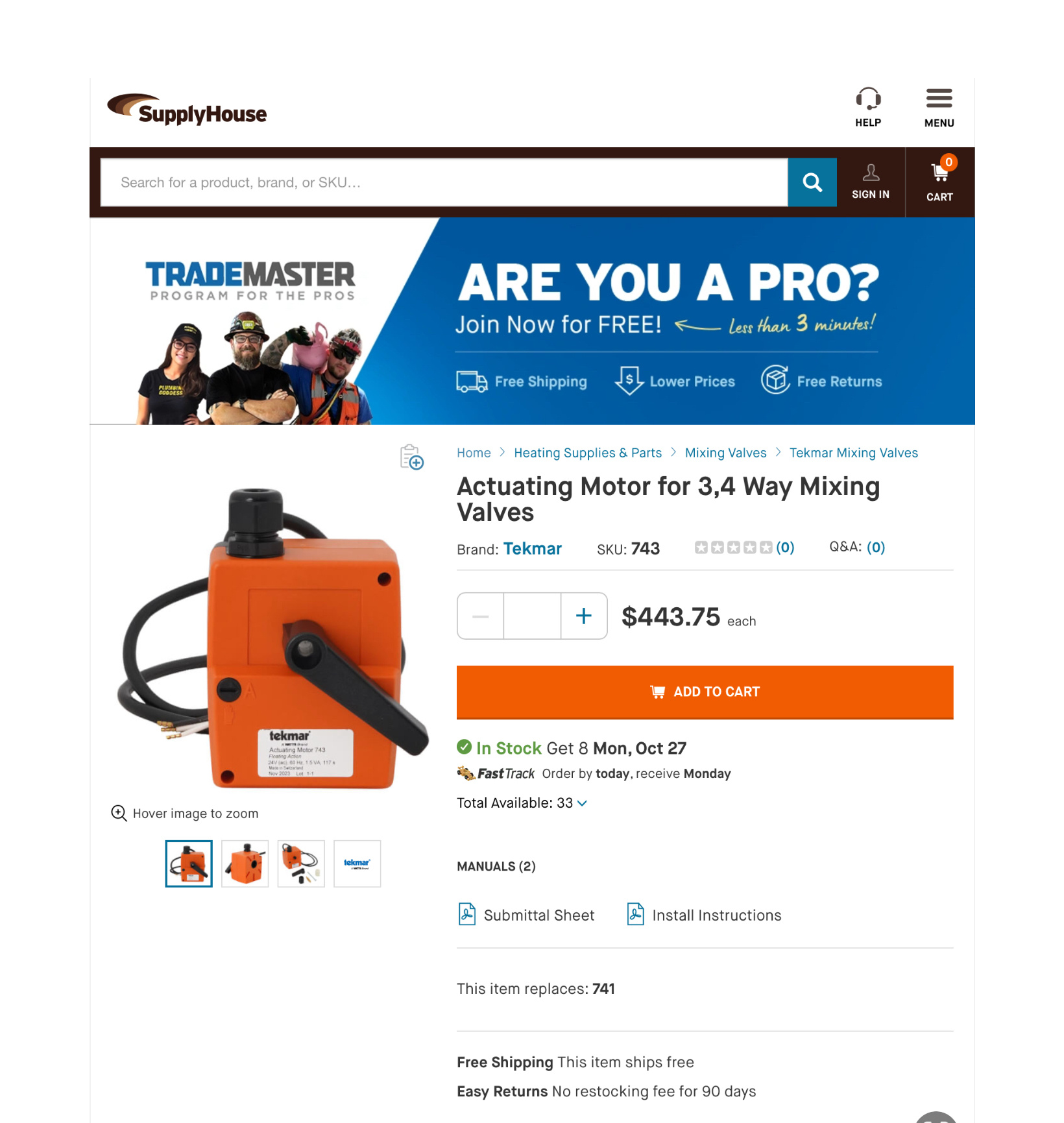

    From what I can tell (and from what its installation instructions say), the Tekmar 743 is "compatible with tekmar brass mixing valves 710 to 724." What I have is a tekmar cast iron valve, model 017. So I am not sure if it is compatible?
    "The internet" / AI thinks that to work with my 017 valve I'll need an M3061 adaptor kit and a GMB240-3 or Tekmar M3062 actuator. Is that true?
  • MasterC
    MasterC Posts: 46
    Cost wise…
    It looks like the 743 would run me about $450. The M3061 + GMB240-3 close to $400 + $150 (if really available…seems iffy; or even more for tekmar M3062).
    I had been thinking I would need a Tekmar 360 control, ~$650. If the System 450 C450CBN-4C for ~$200 will work about as well, that would be nice.

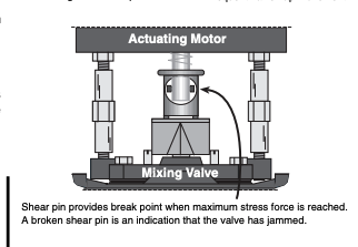

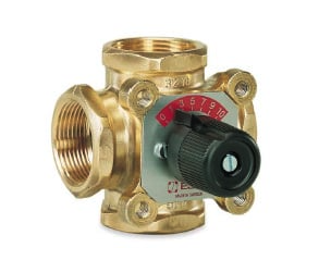

    The bolt pattern from brand to brand are fairly consistent. Actuator manufacturers have the adapter kits to mount. Shown is a Danfoss/ Esbe, and tekmar mounting instructions
    HBX, Danfoss, Belimo, tekmar are other options for controls.

    Below is what Tekmar said…emphasis added in bold. Basically they say no-go on using the 743 to actuate the 017 mixing valve. :( For reference, even if it would mount on the valve (and they say it won't), the 743 has 88 in-lbs of torque, whereas the recommended M3062 (aka GMB24-3) has 360 in-lbs. So I guess that's what I am left with, unless an old Actuating Motor 011 (now discontinued) can be found somewhere.
    Tekmar Support says: "The 743 will not work on the 017, it is meant for our newer brass mixing valves. It has different mounting and would likely not have enough torque to turn the 017. Our solution for the older steel valves is a mounting kit M3061 and a Belimo GMB24-3 Actuator M3062…. I don’t know anything about the Johnson Controls device but the Belimo is what’s referred to as a floating action actuator. It has electrical connections for forward and reverse so controls would pulse it once to open then check temperature then pulse it open or closed as needed to maintain the controls desired supply temperature."

    its getting complicated. You would need to shop an adapter kit, newer actuator, and the control

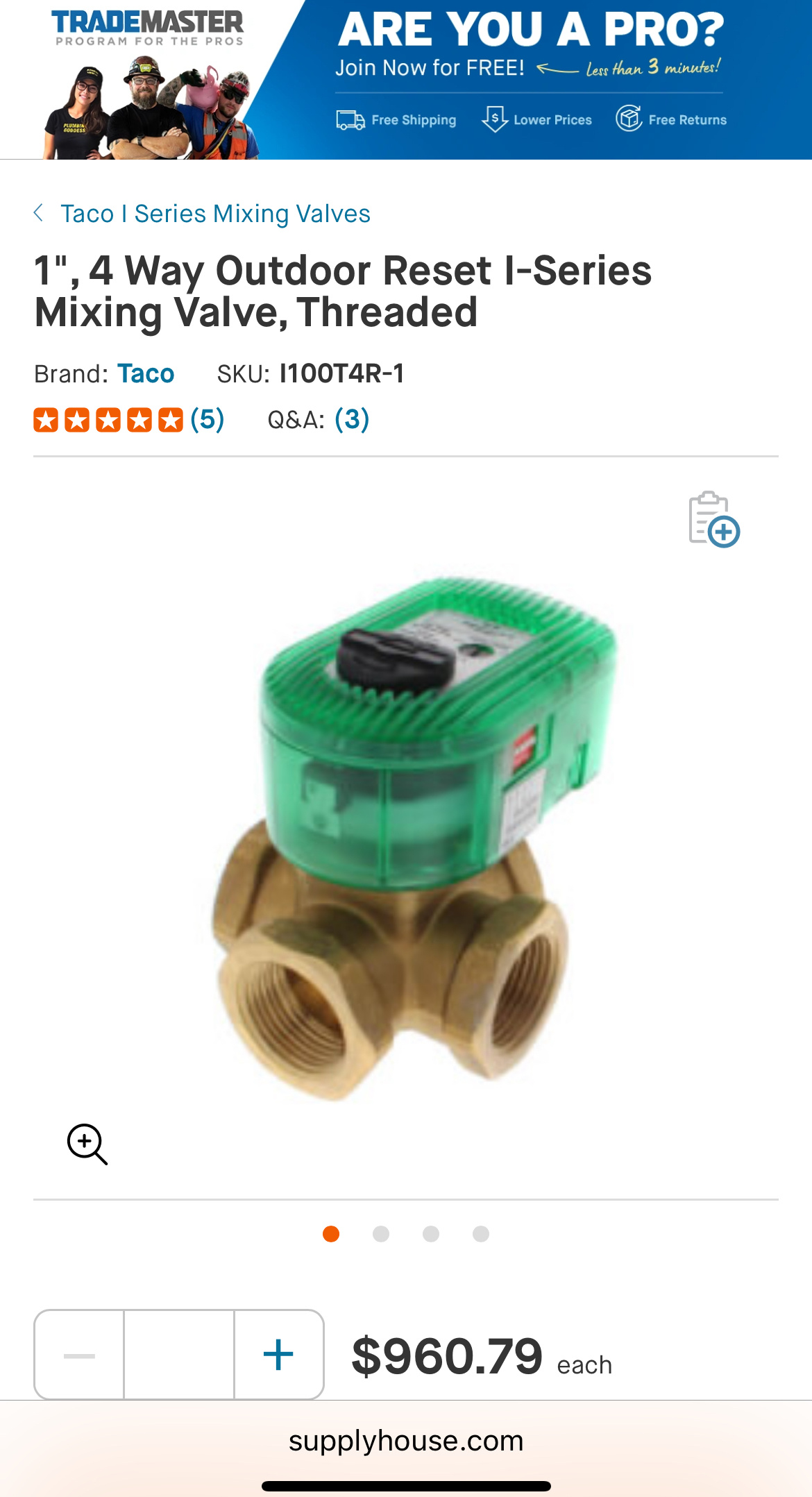

    Might look at the Taco valve that has the control built in. Probably a tekmar brain in it🤔
    I don’t think it has as much adjustability as the 360 but it may be enough

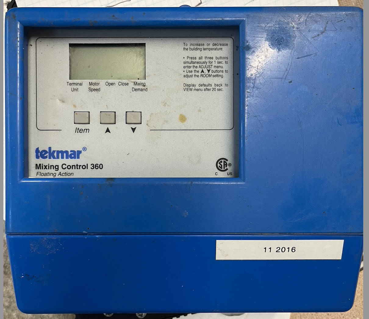

    I have a 360, been in a drawer for years. I'll power it up and check it. You are welcomed to it for freight cost. Maybe shop around for the 011 first?

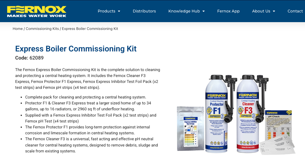

    For sure clean and flush that black water. Bad fluid makes those old style 4 way hard to turn and can breal the coupler or actuator. It should rotate freely, stiff but free.
    This kit works well, run the cleaner for a few days, hot. Flush, refill and squirt in the conditioner.

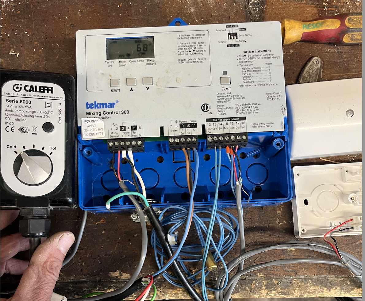

    The control works fine, motors the actuator open and closed.
    I have an outdoor sensor and two of the strap on universal.
    One note, you need to send power to this control #1 &2 to get it to turn on. 20- 240V. That gets missed a lot so they added these white stickers :)
    AND 120V power to 3&4 to power the control and any pumps or devices you wire to it. 5&6 will be that switched 120V that the radiant pump typically wires to. #1-6 are the only place line voltage connects!
    9,10 & 11 is where the actuator wires, the actuator wires will be marked open, close, and common
    Sensors go on 13-17, and yes you are short one common, I never understood why that is? No issue with two wires under one com. If you use stranded wire make sure strands don't touch, the terminals are very close together
    PM me your ship to address

    Unless the valve is seized up, you should not have to get to the water side of the valve. Two or 4 bolts hold the motor onto the valve body.
    Once removed the valve should rotate somewhat easily.
    The older vane type were a bit stiff, probably need a pliers to turn that type
