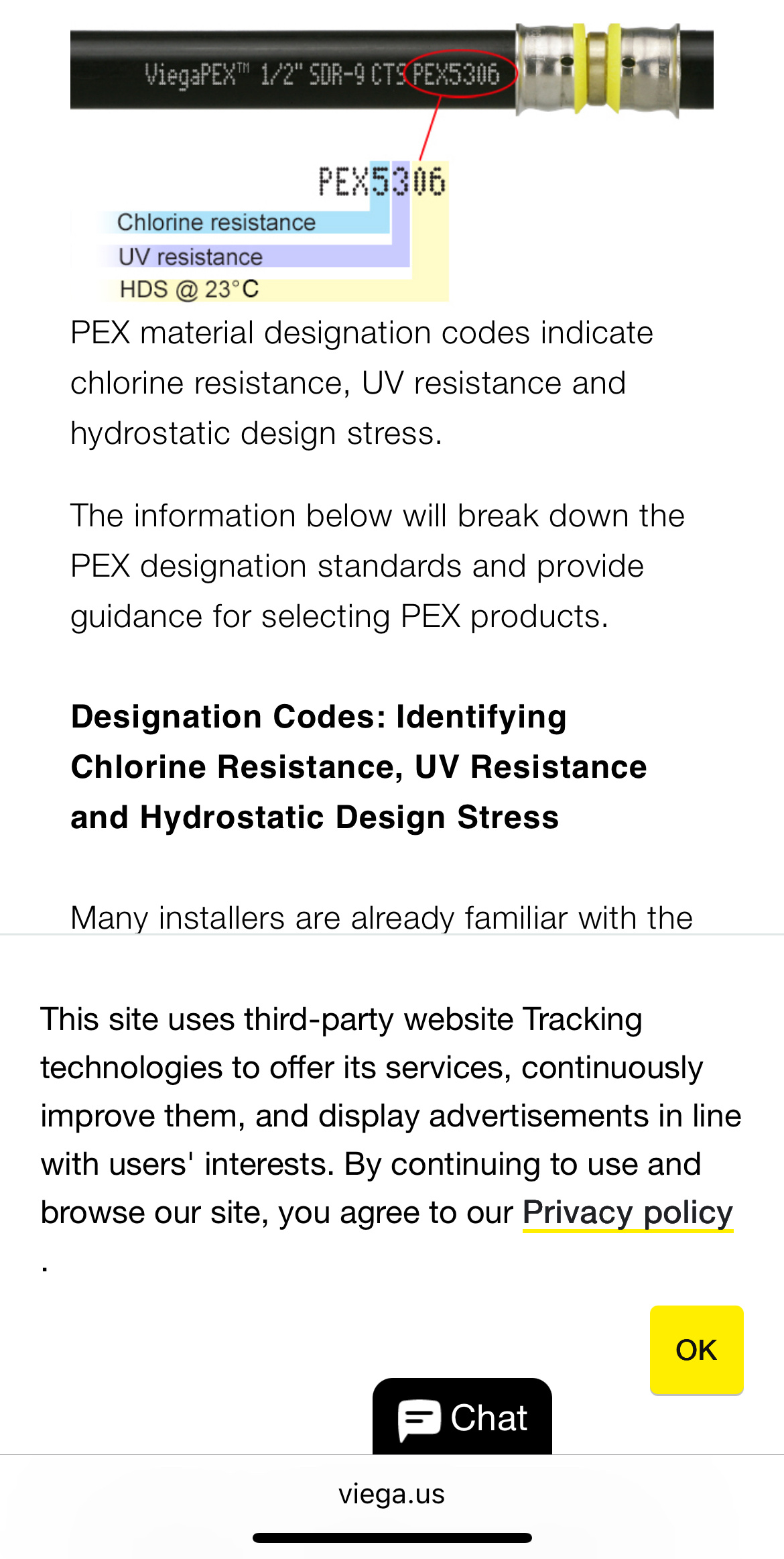

    Original question is pex as a return line vs. copper?
  • ChrisJ
    ChrisJ Posts: 17,763
    Pex has an r value all by it self.
    Add some insulation to it and it's even better.
    hot_rod Posts: 28,705
    less heat loss, smaller inside diameter with pex
    Use a good brand of pex with a high chlorine rating
