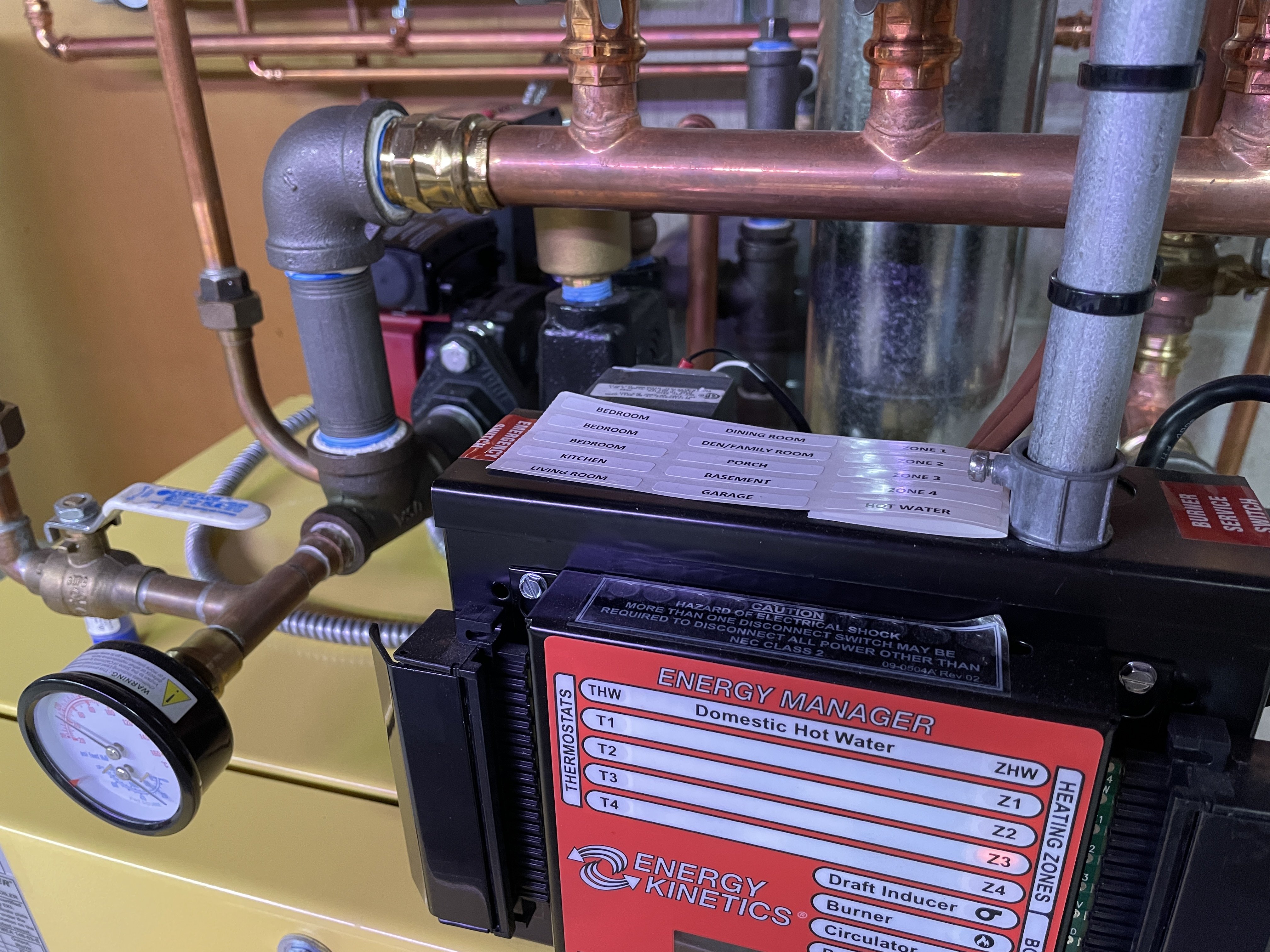

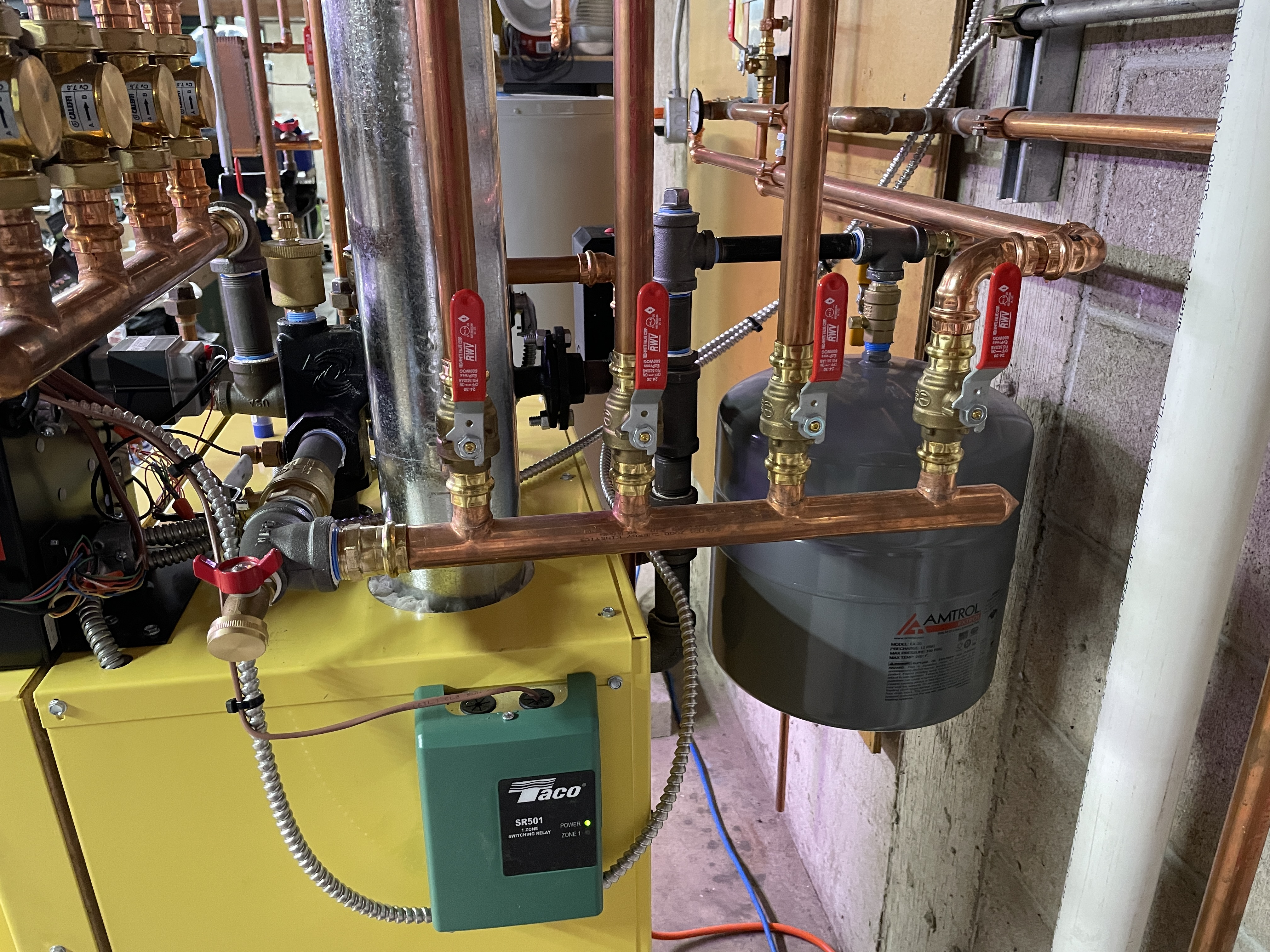

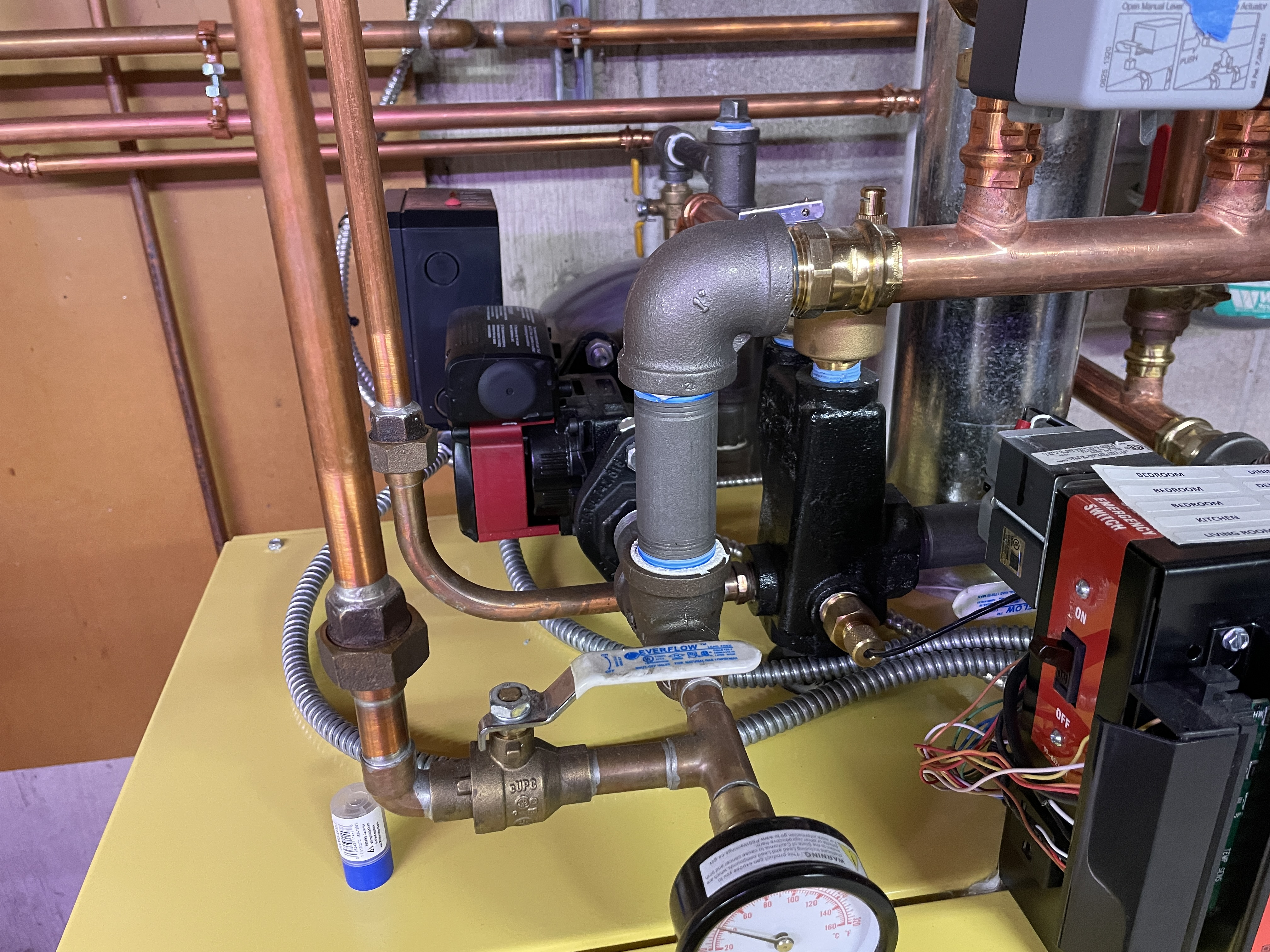

New Energy Kinetics EK-1 boiler/hot water heater installed in June. Up until a week or so ago, the system was called upon to provide domestic hot water only: all of our thermostats were turned to cooling mode. System ran fine, produced prodigious amounts of hot water, and was very quiet.
Heating season begins last week. We have thermostats in 3 heating zones calling for heat off and on to take the chill out of the early Fall mornings. We are now experiencing a phenomenon called kettling: sound of boiling water emanating from the boiler itself.
This sound is only heard when the oil burner is firing: once the demand for heat is satisfied, the burner shuts down and the noise immediately stops.
A few things to note:
-Its a 4 month old system
-It worked just fine until we started opening zone valves in the heating circuits.
-Noise starts about 30 seconds or so after burner firing begins.
-Water chemistry: we are on well water, although we don’t have a water softening system: never needed it. Out water test shows slighlty/moderately hard water. We do use a 1 micron whole house water filter.
The most popular answer I’ve encountered online in regard to this issue is: its scale buildup on the boiler wall. Not sure I am convinced that this is the culprit, given the system has only been in service for 4 months, and given that this problem did not exist prior to opening the heating circuit zone valves.
FWIW: I’ve never observed/heard the air vent bleeding any air from the system. There is just a single vent just above the main boiler return connection. I suspect air in the system may be a contributing factor but my contractor has dismissed this as a possible cause.
Contractor plans on doing an acid flush of boiler, per the manufacturer’s recommendation so we will be trying that next week. Given everything I’ve stated above, I have strong doubts that this cleaning will resolve the problem.
Any thought on what could be happening and possible remedies?

    Steamhead Member Posts: 18,735
    Check the burner's firing rate, also whether the correct type nozzle was installed. If that's a Carlin burner it should be a 60° hollow one.

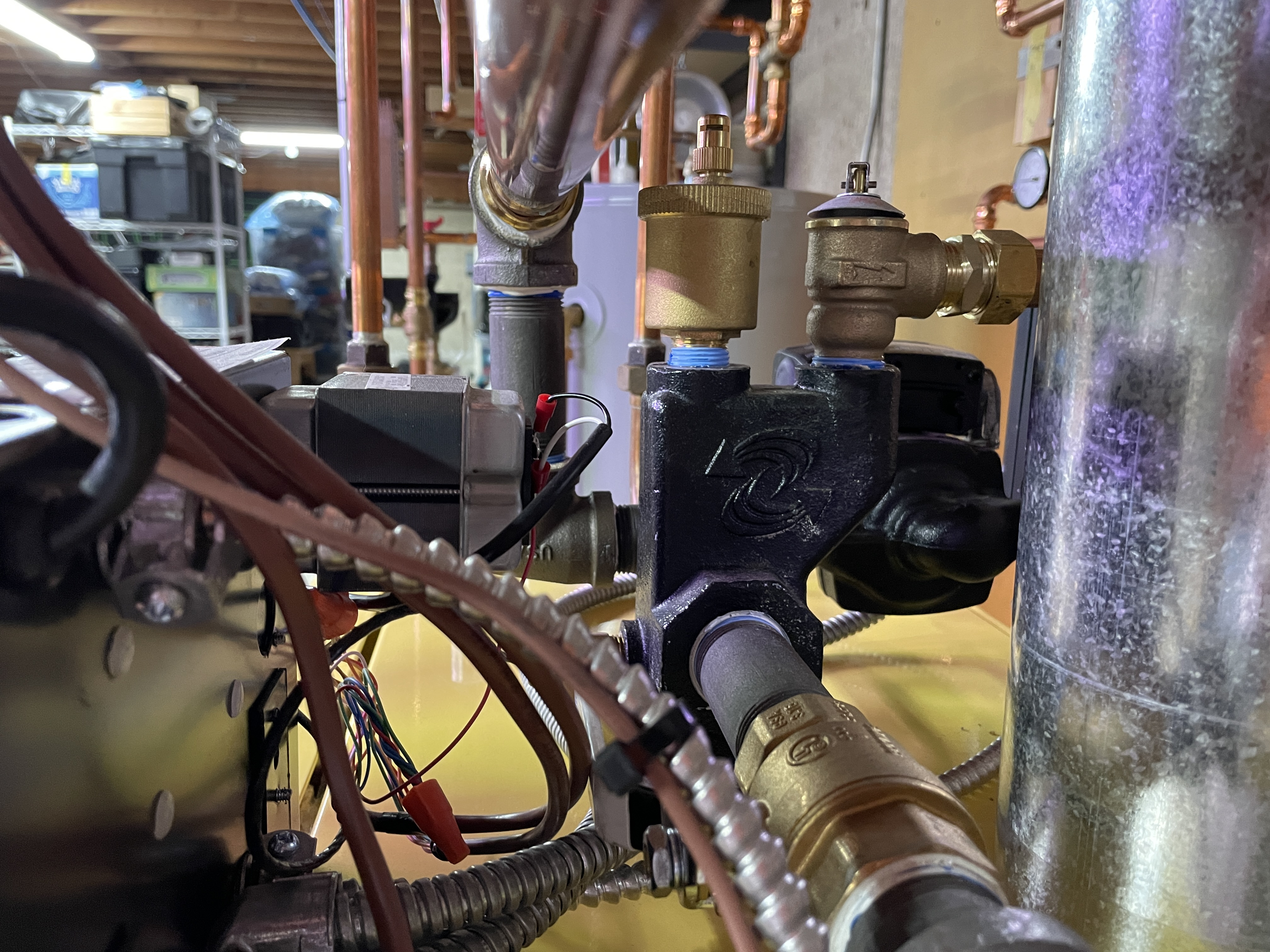

    hot_rod Member Posts: 27,904
    is there an air purger on the piping?
    I don’t recognize that black component with the air vent attached
    Make sure the cap is loose on the vent
    It takes heating and circulating the system for a few hours to drive all the air out. Seems it is related to the piping loops throughout the home?

    HOT ROD: Yes, a Califfi air vent (hygroscopic no less) comes mounted on the boiler return manifold (the black thing) that is factory supplied by EK. Since it's hygroscopic, the vent can be loose or tight: cap has opening for air in either condition.
    The logo on that black air/ relief manifold looks like Thrush? I suspect the boiler is doing most of the air separation through that device since.
    I don't see an air purger on the supply side, before the beautiful zone valves.
    Kettling is usually a sound from an old scaled boiler, water on the boiler metal surface is flashing to steam under that layer of scale.
    I think maybe you are just hearing some microbubble entrained air. How long has it been running? It should clear itself of air. Crank it up to 180 or so, if you can, that drives entrained air out quickly
    It is a really nice piping job.

    HOT ROD: the black manifold is marked Energy Kinetics and I suspect acts like a standard Watts or Taco Air Scoop. Yes, the air vent you see in the picture is the only one in the system: it comes from factory this way.

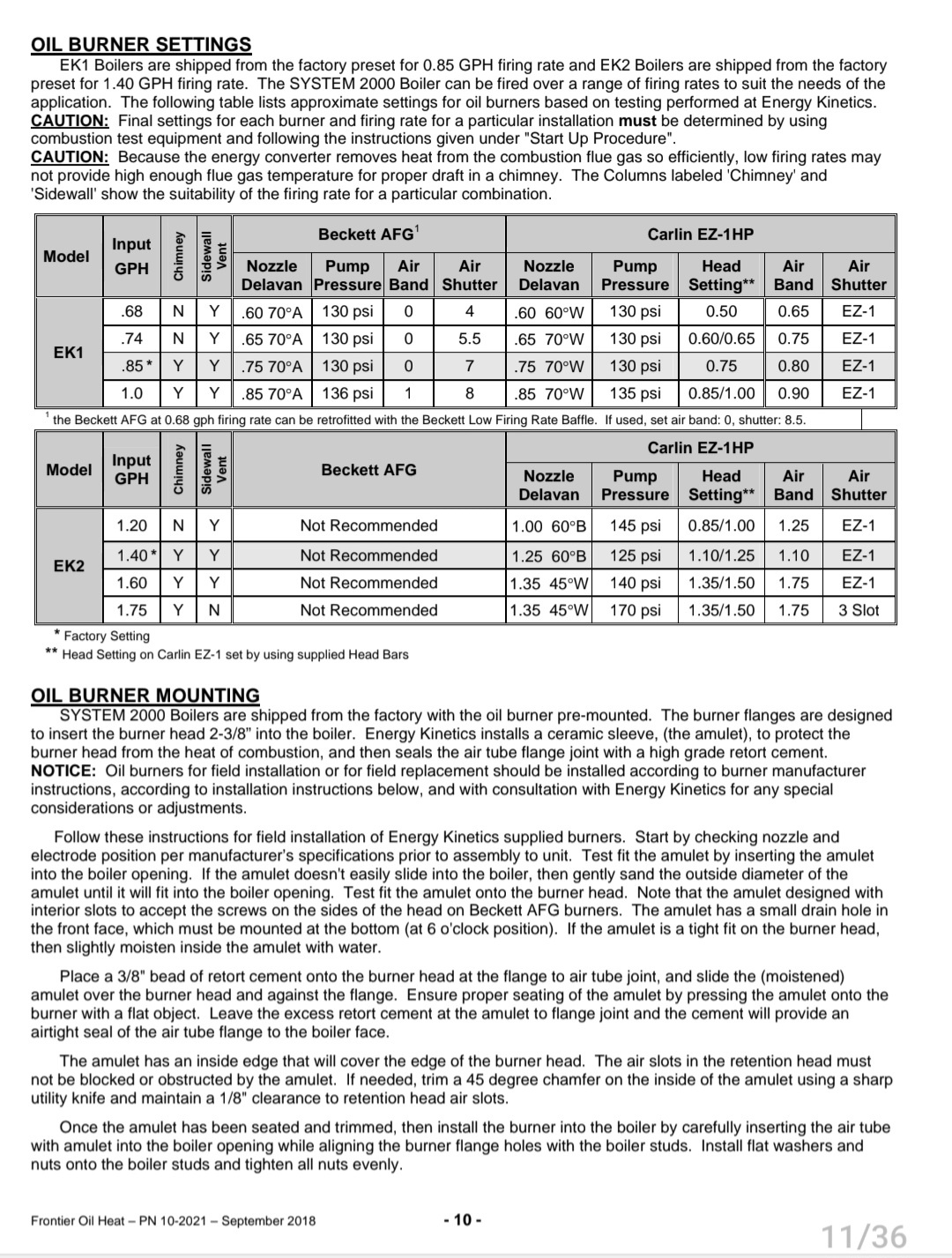

    We still need to check it. In the first two pics above, we can see a nozzle container sitting on top of the boiler. The end cap on it is blue- which is the color Delavan used for solid nozzles. Hollow nozzle containers have red end caps.

    Checked the nozzle that was in that plastic case on top of the boiler. This was the original nozzle that was changed out a few days after initial system commissioning due to burner lock-out issue. The nozzle indicates 60 degrees and .65 GPH, so I misspoke above. Not sure how to distinguish a solid nozzle: this nozzle is not smooth: looks has sort of a rough surface: perhaps it atomizes through this???
    edited October 2025
    That would be a 0.65x60. The letter following denotes the spray pattern: A for hollow, B for solid, W for in-between.
    The installation manual is here:
    https://energykinetics.com/wp-content/documents/system2000/installer-manual-ek1-ek2-oil.pdf
    On page 11 of the pdf, it shows that your boiler with the Carlin burner uses hollow nozzles. The containers for Delavan hollow nozzles have red caps, rather than blue ones as shown in your pics. Recheck what's actually installed in the burner. If it's not a Delavan A, replace it with an A and retune it.
    The 0.65 nozzle in that burner runs at 130 PSI, for a firing rate of 0.74 GPH. This is by design.

    Steamhead: double checked: it's got a B marked on it, so it's apparently solid. So would wrong nozzle result in hotter or more concentrated flame that could cause the kettling? I wonder how the system worked with no problem prior to opening of the heating zone valves for the season? Same nozzle in use during both scenarios.
    HVACNUT Member Posts: 7,539
    I checked my manual to see about chimney venting when the burner is down fired to a .65 nozzle.
    I know I've been using a .75 60°A with the EZ-1 burner on the EK-1, so maybe I need a new manual.
    Anyway, my manual states sidewall venting only at that firing rate. How is your boiler vented, @CTYankee?
    That's wrong. Change it to a 60° A and retune the burner. If that solves the problem, you don't need to do any more.

    @Steamhead is correct. 60° A is the proper nozzle with 130 psi pump pressure.

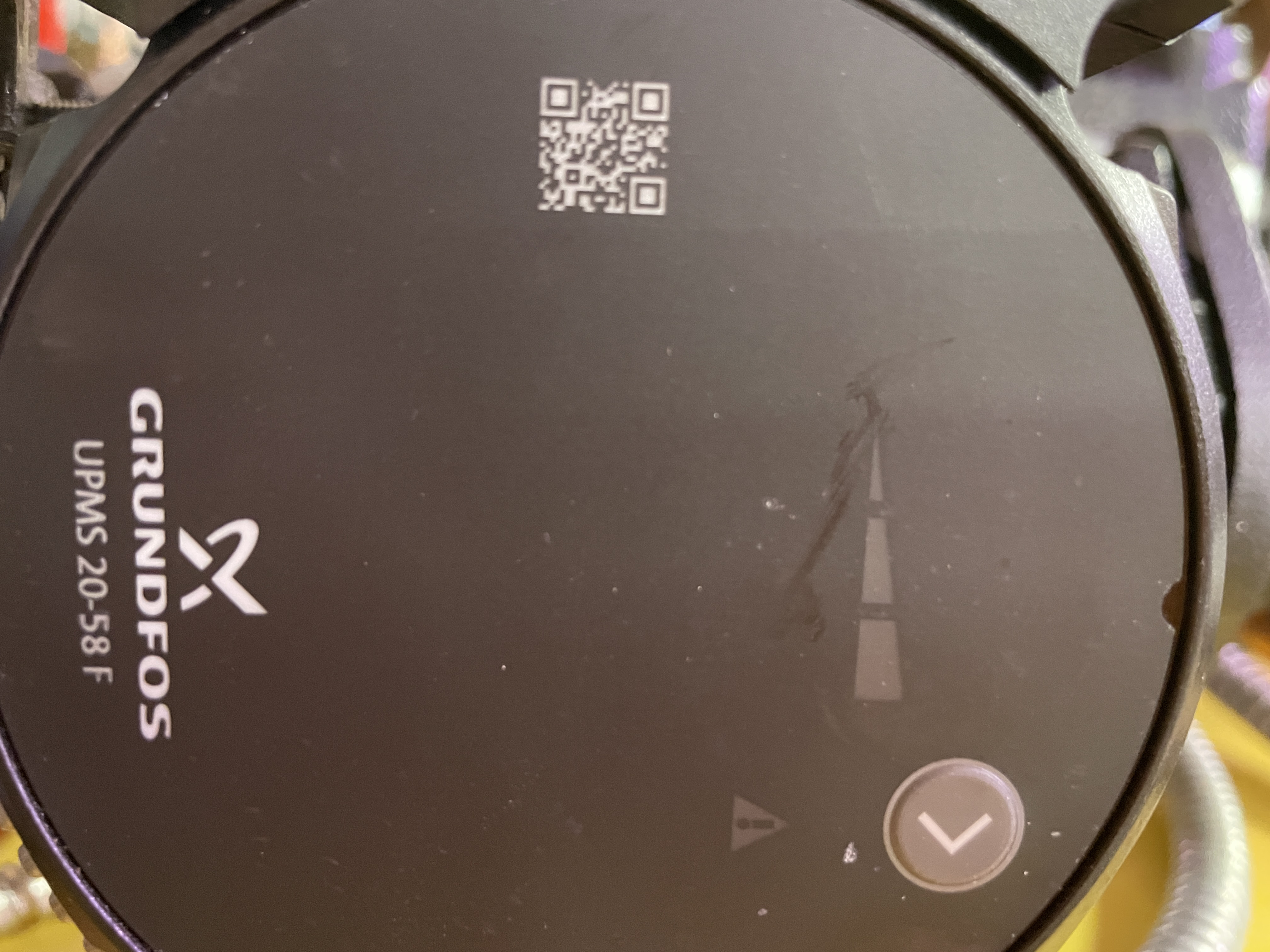

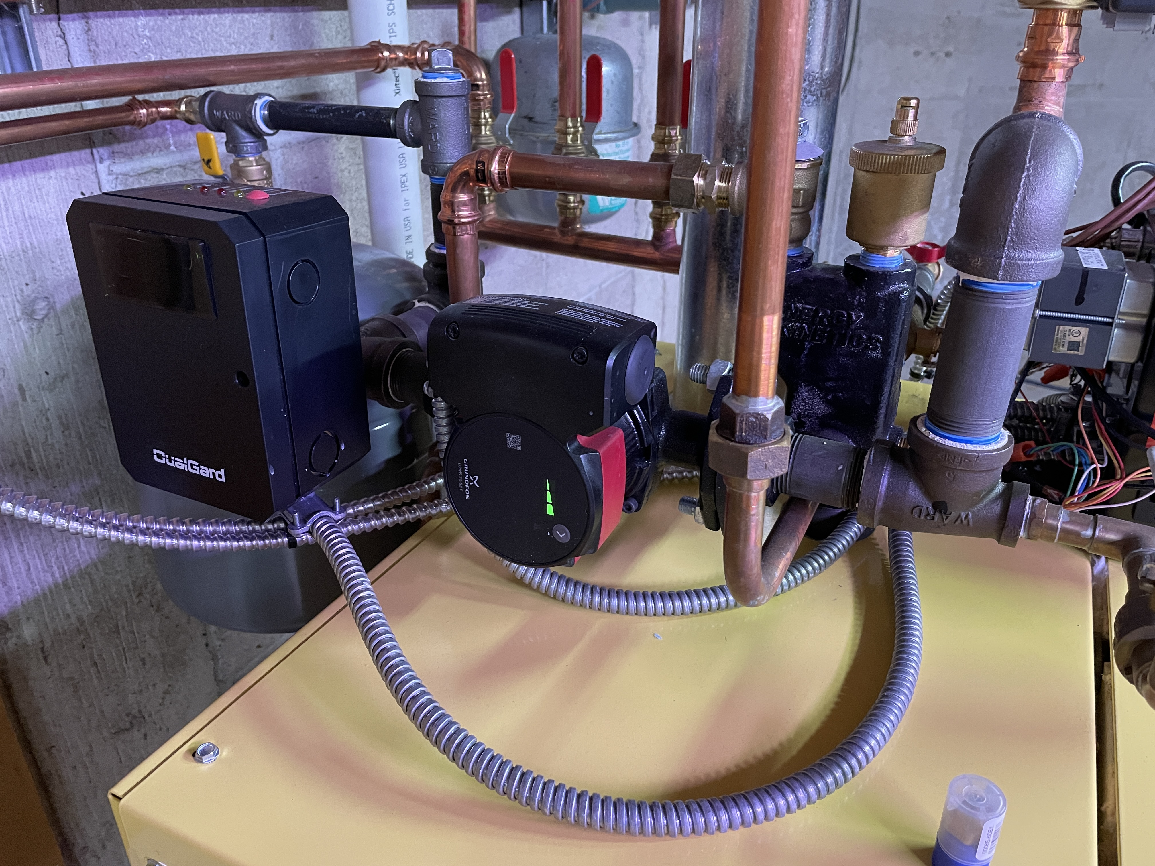

    I wanted to update everyone on the status of this issue.
    The contractor did a purge of the system and an acid flush of the boiler. The kettling seems to have gone away. No way to know if it was the purging or the acid flush that actually fixed the problem, unfortunately.
    However, we now have another problem: water hammer. We are hearing intermittent banging of the pipes supplying hot water to the baseboard emitters. Four heating loops, all with zone valves. Our old system never had this problem (it had a circulator for each zone). FWIW: the old system had Taco 007 circulators on each zone. This new system has a Grundfos UPMS 20-58F. It would appear that the speed of this pump is selectable: no idea what speed it is supposed to set to. Elevation from pump location to baseboard location is roughly 5 ft.
    Any thoughts on what might be happening?

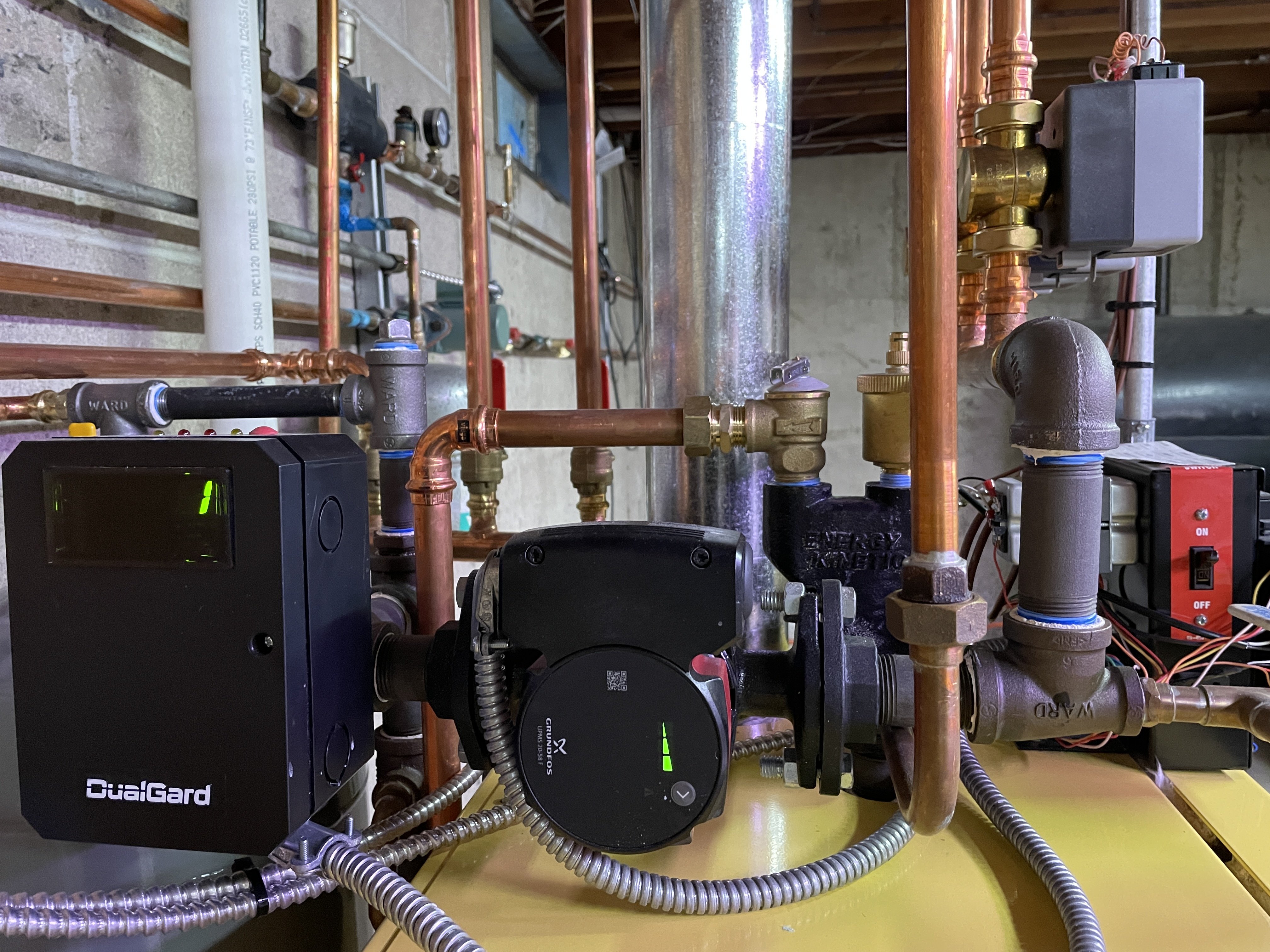

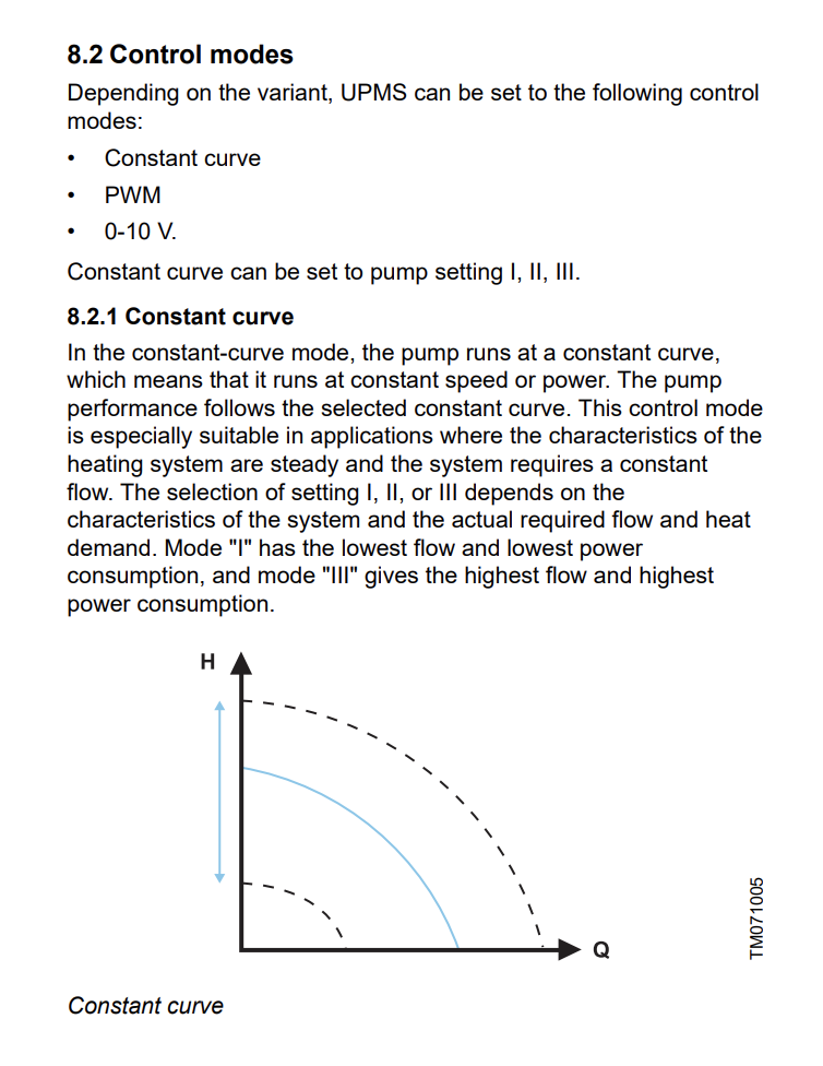

    Odd pump, it's s an OEM model, did it come with the boiler? That model is often controlled by an external control signal.
    If the noise happens when a zone valve loses you may be over-pumped a bit.
    For zone valves you want it in constant curve mode. It may take a day of so for the pump to calculate and adjust as valves open and close. Try constant curve Mode1 to start.
    Search and download the I&O manual at Grundfos if you don't have one.
    Are the valves open to the HX or bypass?

    @CTYankee , I’m glad the kettling noise is resolved. What you described was very likely cleared up from the cleaning that was performed as water side contamination is by far the most common cause of that type of noise. The boiler has exceptional air removal with the dynamic air eliminator that comes with the boiler, so it’s very rare that an Energy Kinetics boiler would have an air related kettling issue. An exception would be if the air vent were plugged or not working and air could no longer be purged.
    What type of zone valves do you have? This can help us identify what steps may need to be taken to stop hydronic water hammer.
    You should set the Grundfos circulator to medium speed as the low setting will not provide adequate flow through the boiler.

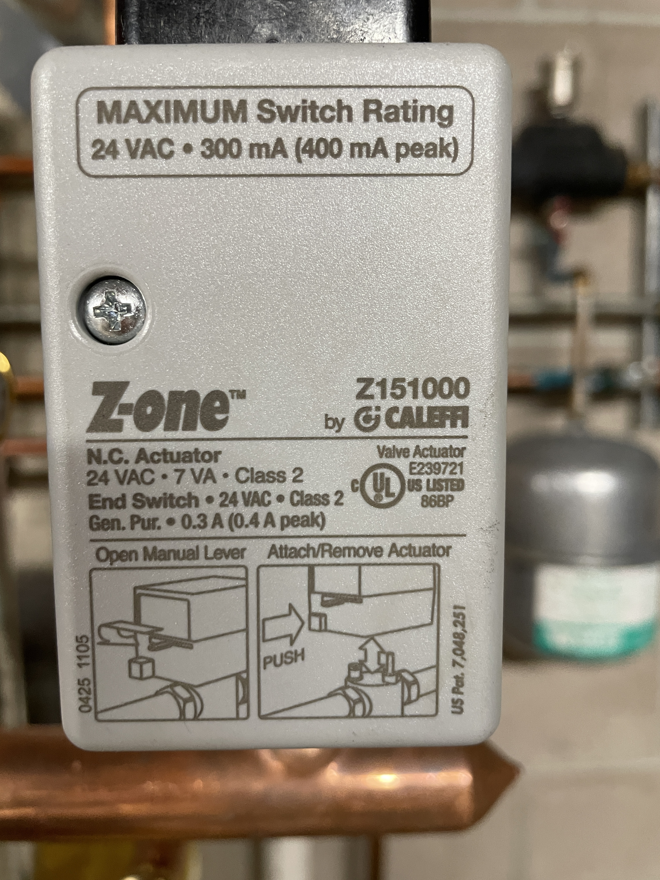

    Roger: I believe the zone valves came as part of a boiler package from EK. They are Caleffi Z-One model 151000. These are installed coming off the supply header, just downstream of the circulator.
    The circulator had been set to the high speed setting. I changed it to the medium setting over a week ago and observed no change regarding the water hammer issue. It remains at the medium setting. Phil

    Looking at the specs on these valves, they are designed to take around a minute to go from full closed to full open, and around six seconds to close at end of call for heat. They even mention in their literature that they are specifically designed to avoid water hammer. What is it about these valves that causes them to sometimes experience water hammer?
    I am also wondering about the circulator: is this a delta-p circulator? Is the EK controller actually controlling the speed of this pump? Is it possible that the circulator is contributing to the water hammer issue and is it possible that a different circulator could also fix this problem?

  • Roger
    Roger Member Posts: 484
    Your circulator is a good match for the system, which has a built-in bypass. It is very unlikely that changing your heating circulator would fix the specific issue you described.
