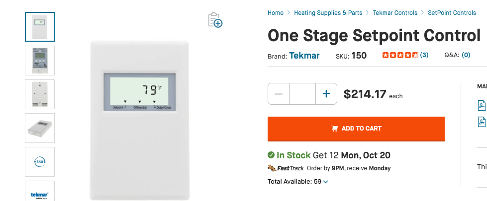

    You need those slab sensor to be the main control if you plan on idling above slab freezing temperature? So you need the two sensors, two 170 control.
    Actually all you need is the 150 setpoint controls, save some bucks. Unless you want the WiFi fuction?

    The setpoint controls just call on the boiler. The 170 or 150 needs power from a 24V source, then S1 and com for the sensor. XX goes to the boiler
    Did the boilers come with outdoor sensors? If so maybe that function to shut off the boiler above 38° If it has that range of adjustability. If not you need a sensor in the bay to know when it is above 38. Although the air could be 38 and the slab still cold enough to ice over?
    I'd just try setting the differential on the 150 on at say 34-35°, Off at 38 or so.

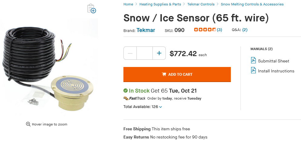

    hot_rod Posts: 28,705
    to use the tekmar snow control you would want the snow sensors in the slab
    It is an expensive sensor
    It is an expensive control, sensor, cup, and control. And you need two?

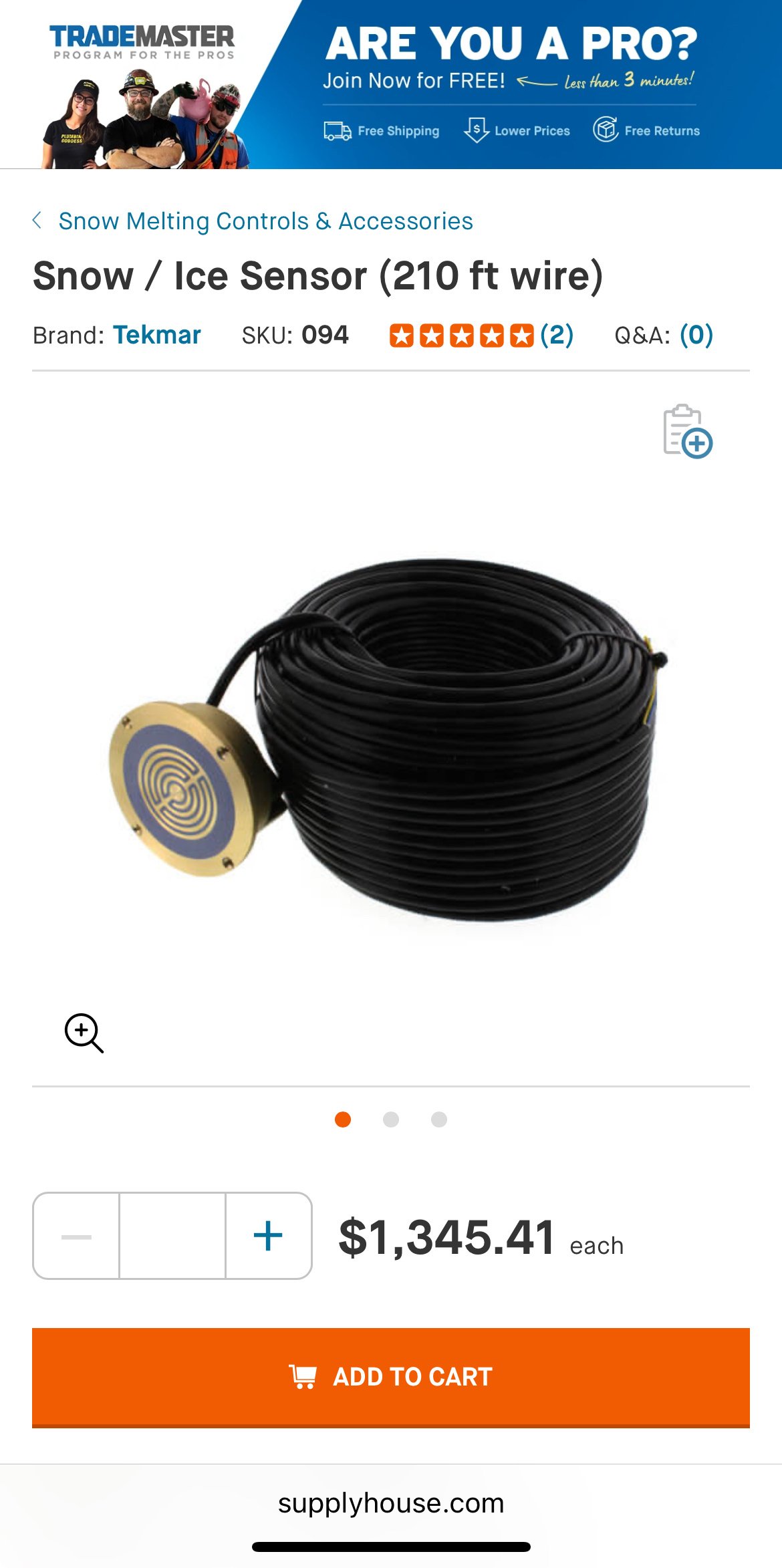

    109A_5 Posts: 4,759
    That's expensive wire, $3.95 / ft. more for the longer version. I wonder how that sensor would hold up in that car wash environment.

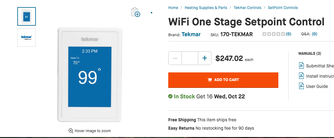

  • I was thinking to get the 170 for the wifi function. Might be overkill but would be nice for some alerts.

    That snow sensor is expensive, probably wouldn’t last very well in a car wash though.
  • "That snow sensor is expensive, probably wouldn’t last very well in a car wash though. "
    I don't believe the actual sensor would be a problem in a car wash. it is made to be outside in the weather so placing it inside a car wash at one end or the other where the soap and other cleaning agents are not present would be the preferred design.
    Do you know if the tekmar 170 is capable of that as well?
    I do not believe the Tekmar 170 does all that the Tekmar 654 can do.
  • Here is the info from:
    The Wi-Fi Setpoint Control 170 provides precise temperature control of a one-stage heating or cooling system. When connected to the Internet, the Watts® Home mobile app allows the setpoint control to be controlled remotely. An Away mode is quickly and easily accessed to provide energy savings when the heating or cooling system is unoccupied. The setpoint control can be used to control the heat for an indirect domestic hot water tank, a pool, a hot tub, or small outdoor patio, as well as provide cooling for a wine cellar.
    The Snow Melting Control 654 is designed to operate electric or hydronic equipment to melt snow or ice from any surface including driveways, walkways, patios, business entrances, parking ramps, loading docks, hospital entrances, helipads or car wash bays. The surface temperature for snow melting is controlled automatically to reduce operating energy costs. The 654 has an automatic start and stop function when used with the Snow/Ice Sensor 090 or 094. Automatic start with a timed stop is available when used with the Snow Sensor 095. The 654 can operate a dedicated hydronic boiler or a mixing device. Isolation relays are required to operate line voltage pumps. Electric systems require a separate GFCI and electrical relay contactor
    Looking at the two different controls I see that the 170 is basically a WiFi thermostat that you can check the status of an on/off system over the internet, based only on temperature. This will require constant monitoring to do the job you need it to do.  If the outdoor temperature is such that the slab that you do not want ice to accumulate on is at the set point you select, then the 170 will operate the boiler even if there is no need for boiler operation.  It will only operate based on the temperature you select and the sampling of the temperature by whatever sensor you attach to it.
    The 654 will measure not only temperature of the slab, but will also make a decision on boiler operation based on the presence of ice or snow when using a 5 wire sensor placed in the wash bay slab. If there is no ice at the selected temperature, then the boiler will not operate.  So, the 090 sensor that does all the savings by keeping the boiler off if there is no ice, does not connect to the 170.    It does connect to the 654.    There is a less expensive 095 aerial control that may or may not work for your application.  The aerial snow sensor will not operate the boiler if there is no precipitation (SNOW). The car wash always has water on the floor during operation even if there is no precipitation otherwise.

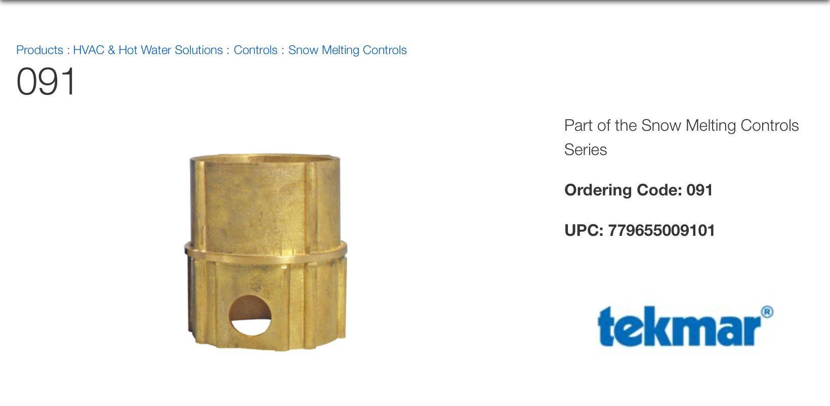

    unless you put the sensor cup 091, in the slab along with a conduit, the snow and ice sensor may not be an option.
