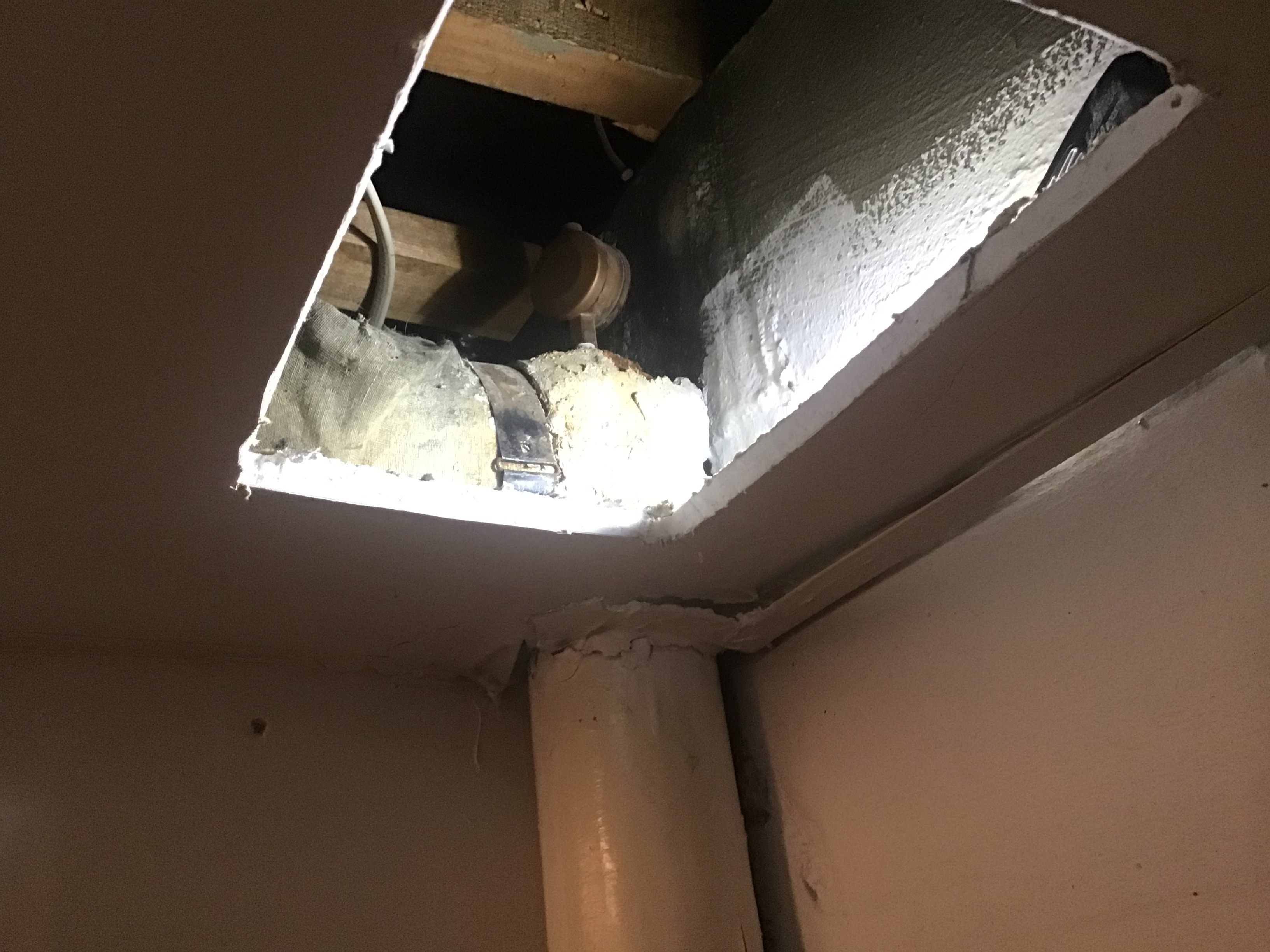

Reading some of the messages regarding main line venting, I’ve taken a look to see what arrangements I have. Took me a while to find the vent as some of my basement is finished. I had to cut an access port in a closet to locate it. Appears I have, at the far end of the main lines, a Gorton vapor equalizing valve No. D. Surprised that it has such a small 1/8 inch port at the base of the vent. It seems as if it’s working correctly, but after being in my house 20 years I’m wondering if it’s time to replace it, or even upgrade to a different arrangement to vent the main lines. For starters, looking to understand how to check its operation during a cold start. It does get hot after a few minutes after a cold start, I have to actually time it so I have a reference point.

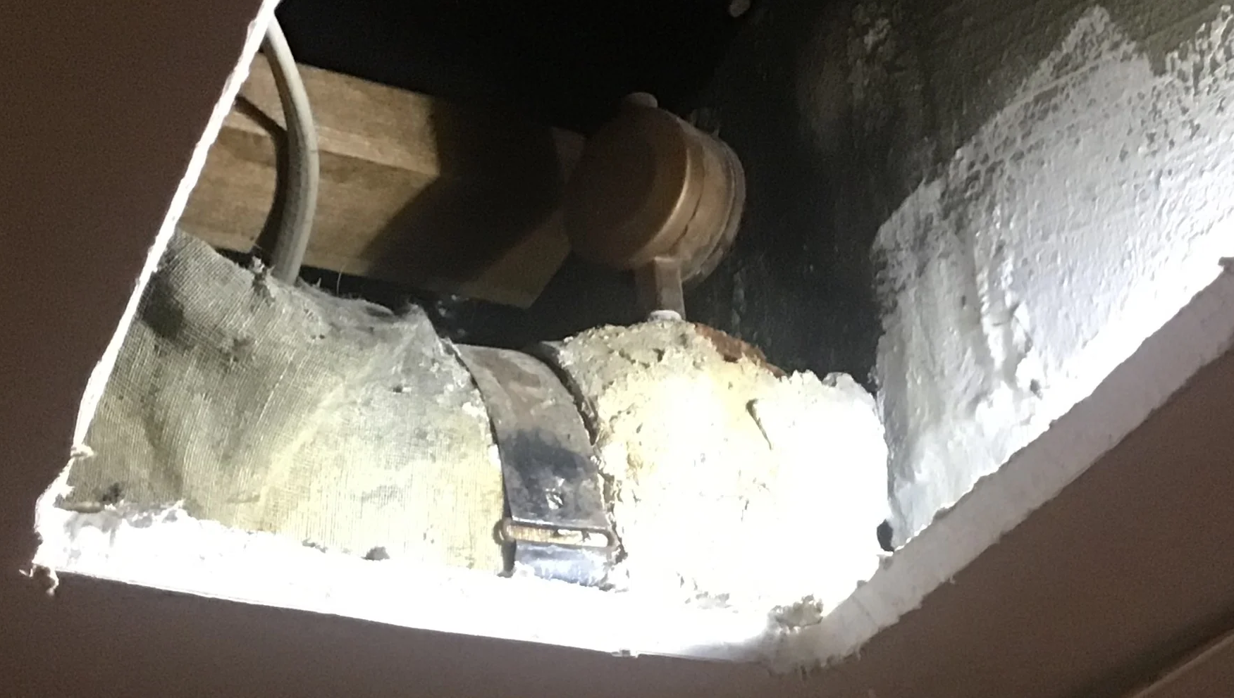

    Adding in a picture of the vent and its location….
    109A_5 Posts: 4,761
    edited October 2025

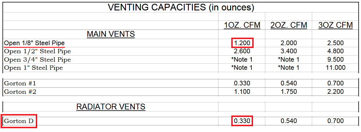

    Looks like you could do better. Even if you still just use the 1/8 Inch pipe. I would see it there is a pipe reducer bushing below the present vent that can be removed to upgrade to a larger vent pipe / vent. Dealing with old pipe in a confined space may also be a challenge. Also if you do upgrade I would offset it from the main a bit, that current position may invite damage.
    From:
    https://heatinghelp.com/assets/documents/Balancing-Steam-Systems-Using-a-Vent-Capacity-Chart-1.pdf

    @109 5 - understand that aspect of it, was curious as to how to determine the amount of time it should take to start releasing vapor/steam, and eventually close. Understand that there are many factors in determining the time in this situation. AFA the base of the vent, yes there is a reducer screwed into the main pipe. I do have reasonable access to it, but it being X amount of years old and it being October, I’m a little reluctant to try to remove the reducer. Something I should have looked into in July. I do have some room above and to the side of the current set up, so if there was an alternate method that requires off setting possibly a pair of vents using the existing 1/8 inch port I’m willing to attempt that.

    I believe he stated a "Gorton vapor equalizing valve No. D." which I believe is the same venting rate as a Gorton #1 just with a 1/8 inch pipe thread.
    Steamhead Posts: 19,007
    Right. I'd start by removing the bushing the vent is in- or if that can't be done without disturbing the asbestos, I'd drill it and tap it for 1/2" pipe thread. Then I'd install a Gorton #2, and see how it does.

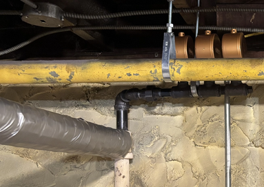

    109A_5 Posts: 4,761
    Ultimately since you a have a working Gorton D, I'd do a build out that resembles this with a Gorton #2 and the Gorton D.
