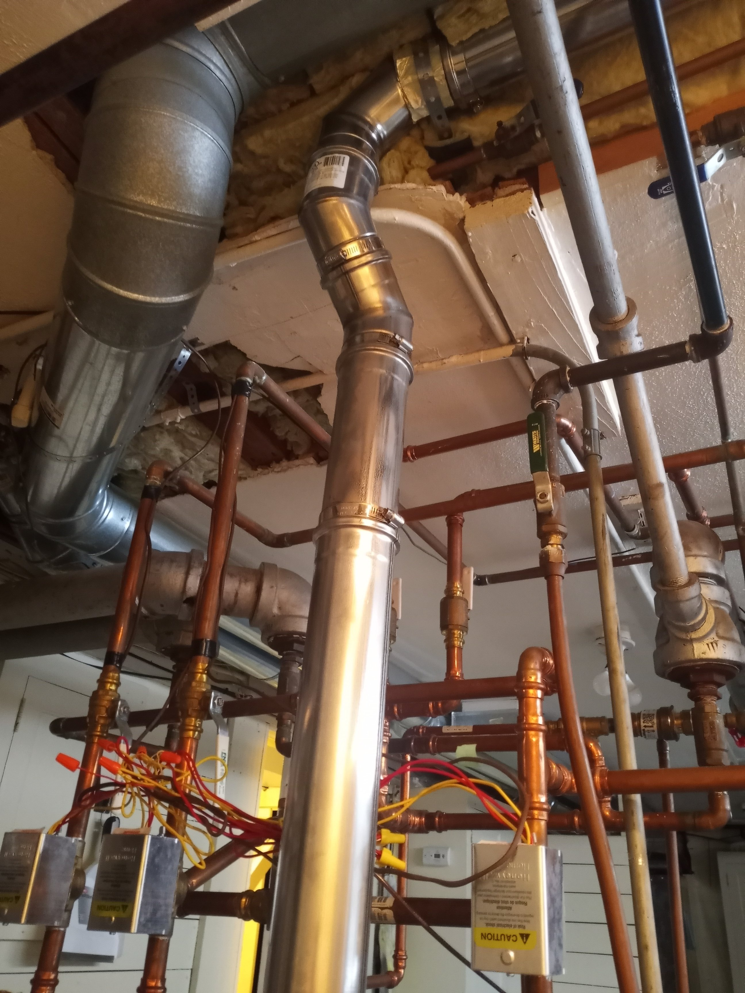

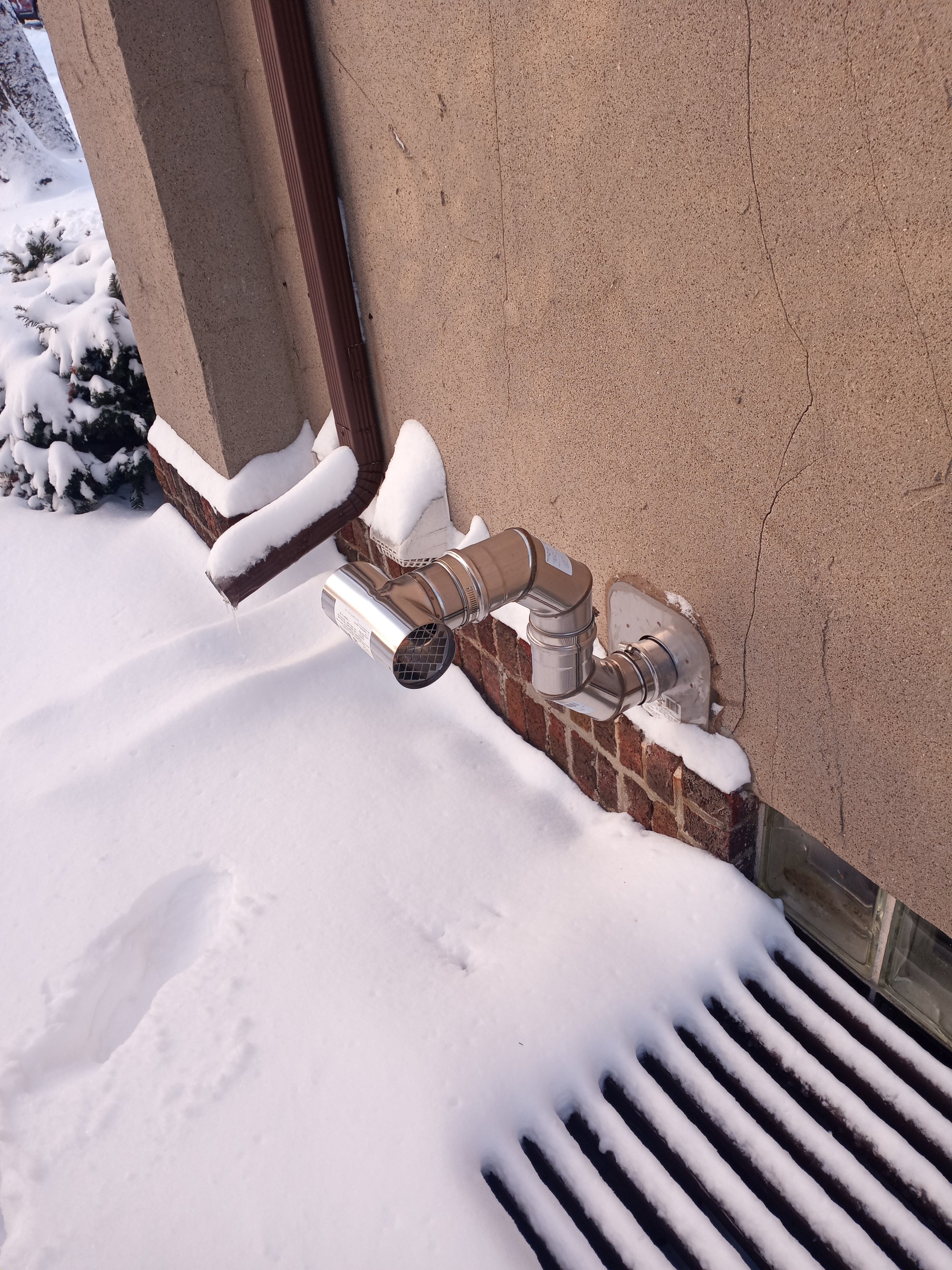

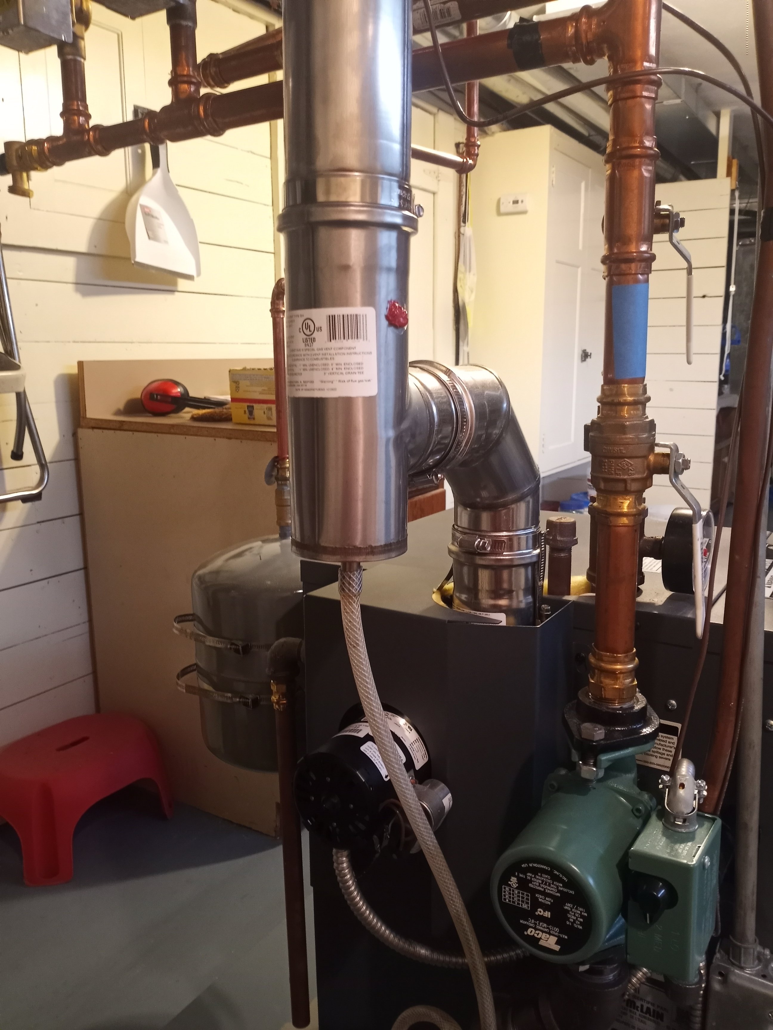

  • Thanks for your input. It is combustion gas. The gas pressure at the boiler has been checked and a combustion analysis has been done. The is no combustion gas odor while the boiler is running, or during the 15 second post-purge. The odor leaves the boiler for about 3-4 minutes after the post-purge is complete, slowly diminishing. The boiler was installed almost 3 years ago. I first noticed the odor about 1 year ago. I've noticed that the inducer motor vibrates some but the installer said that's normal. Attached are pictures. The venting is 4' up and 8' out.

    @Bridgestone
    2 things.
    Check the manual. I don't think the tee outside the house is installed properly it need to be vertical. Also, too low to the ground
    The hose coming off the tee indoors for the condensate does it have a water trap on it? It needs one.
