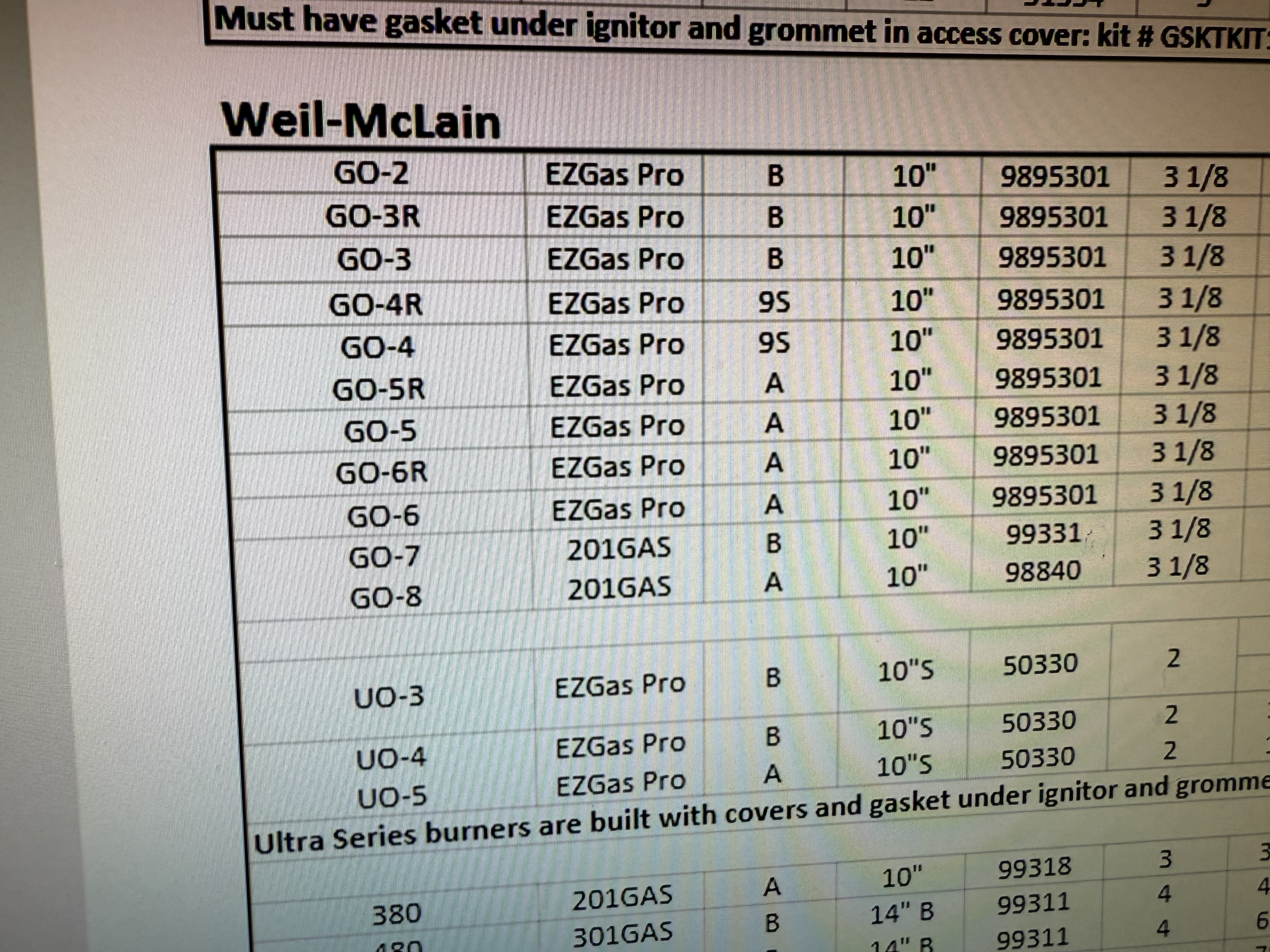

Steam Dudes thanks for the help on my pick up question, now I'm hunting for a boiler.
Pros/Cons with w/m SGO-7 vs the Peerless EC-05?
Gonna stick a gas gun on it
I can't find water content on the SGO. EC seems to pack a good amount of water
EC pipes off the taps with 2", that saves a few bucks.
EC is a bit lighter, Taller (easier to handle)
EC can handle several firing rates.
W/M seems to be a little less dough
Question, i haven't split a new block in all my days, is it a pain to put back together (expect a leak)? What is the gasket material and would i want new gaskets? I'm guessing just one split would be fine, the access has some stairs but we have the Lectrotruck

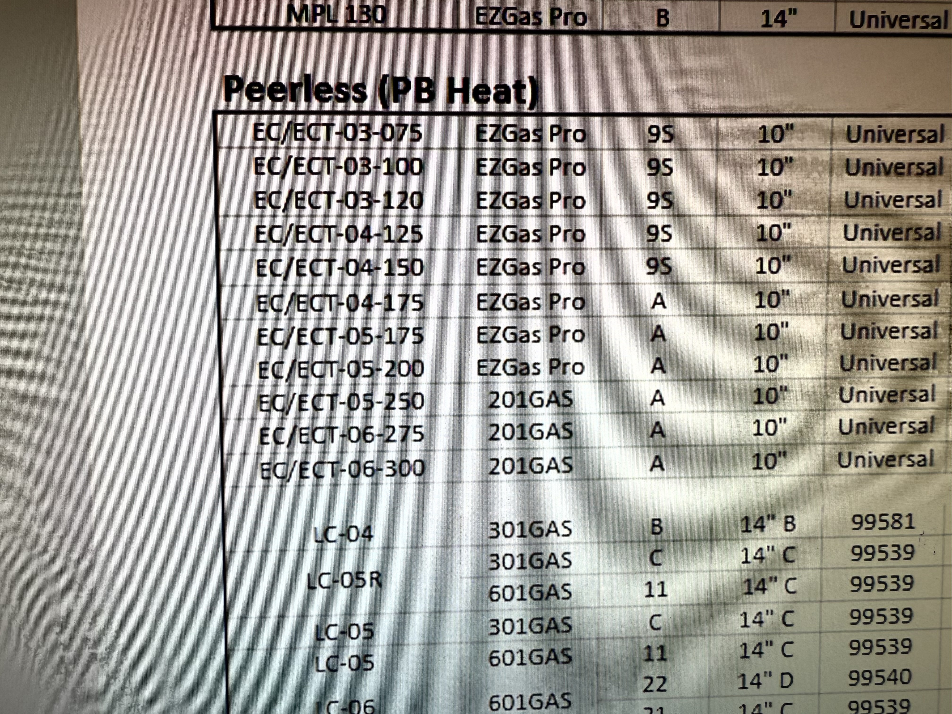

    GW Member Posts: 5,211
    another factor, Carlin is OK with the small EZ burner on the EC 05 but for the SGO seven section they 201gas, which is not readily available

    I never split one but have assembled many larger boilers that you can't buy in block form. Never had an issue.
    They should give you a gasket kit. I know the Weil Mclain is rubber gaskets. I don't know about the Peerless, but I think they use CI push nipples I could not verify this online. It's pretty much just 3 gaskets (Weil) or 3 Push nipples (Peerless) and some ceramic rope. Maybe some adhesive
    So the Weil may be a bit easier to split and reassemble. You May be able to find a supplier or Carlin that has the larger burner available
