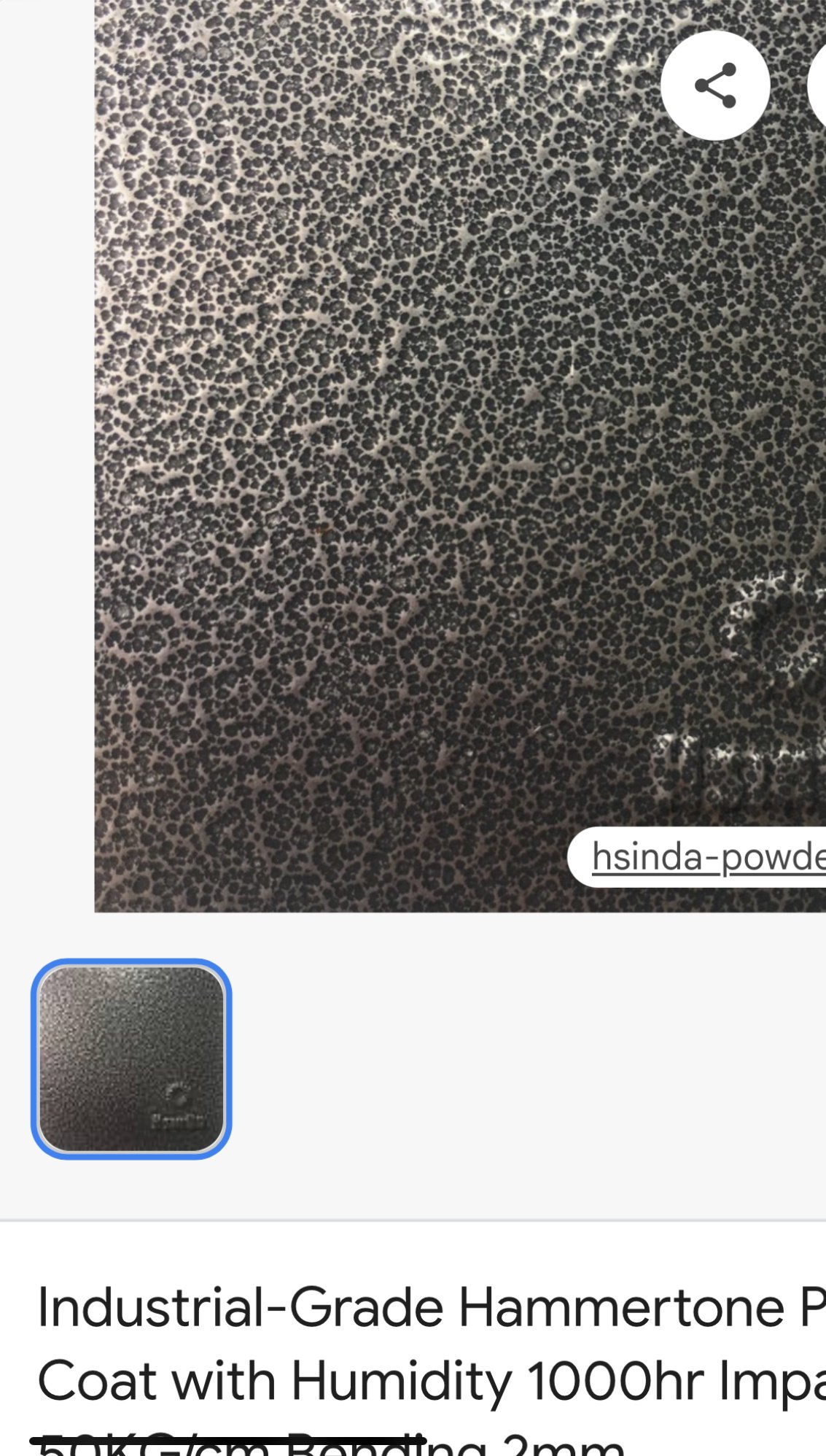

    I had a customer use a hammertone powder coat on a bunch of radiators. I thought it looked a lot like a bare cast iron, a bit of a texture yet a hard durable finish for cleaning
    Or maybe a clear powder coat
