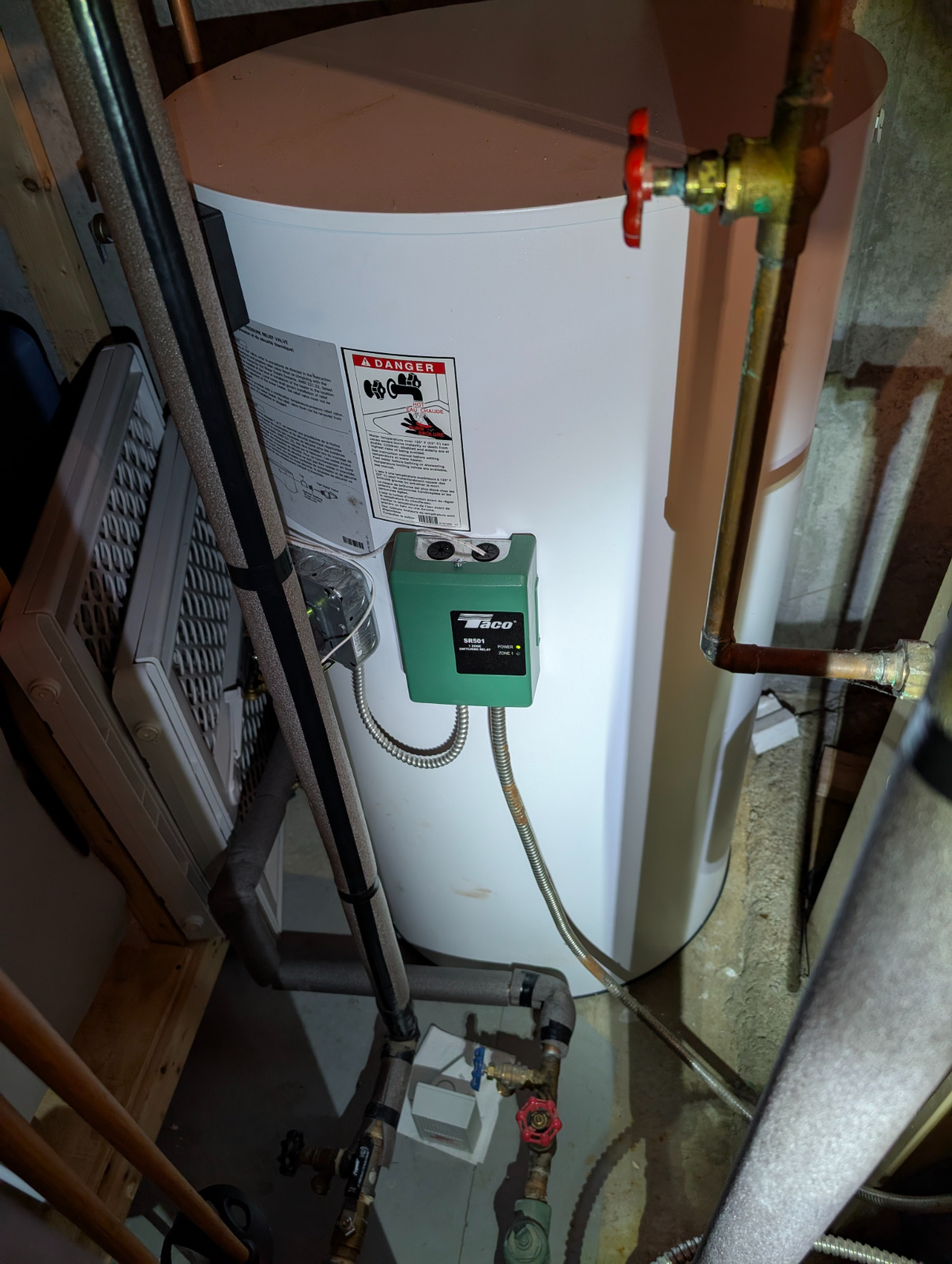

Weil McClain TGO-4 with Viessman Vitocell 300 indirect (42g)

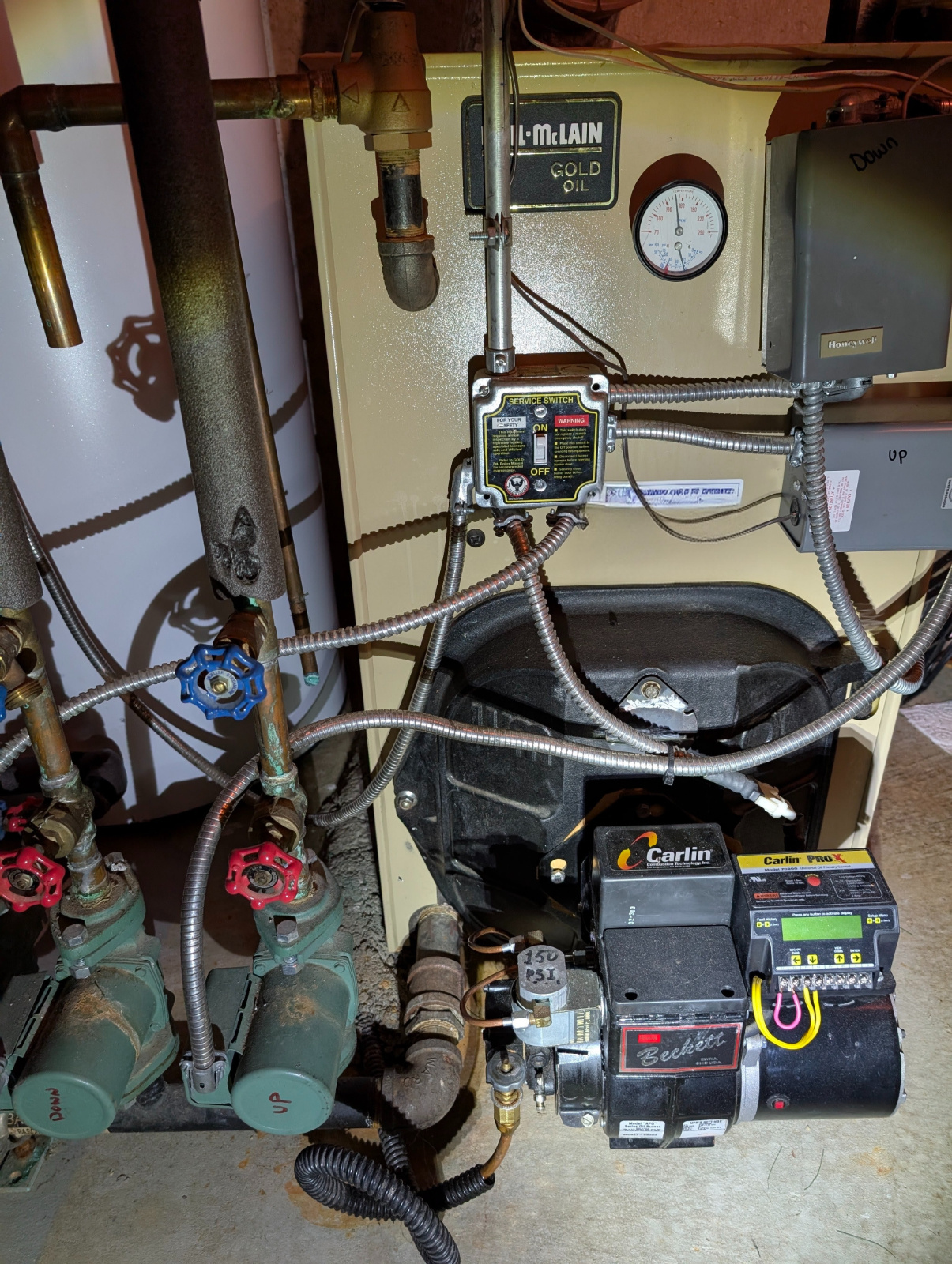

Yes…the TGO-4 was WILDLY oversized. Years ago when I was doing a short zone of FHW in finished basement the installers for that zone "fixed" the system for me as it never made it between annual visits without requiring a reset on a cold morning. They installed a .75 nozzle (currently a .75 80B), Carlin ignitor and Carlin controller (which was replaced a few years ago when the boiler wouldn't start with the current contoller in pic) and cranked the pump pressure up to 150 psi with a delayed start oil valve…I have pre/post purge from the carlin. Since then it has been running great.

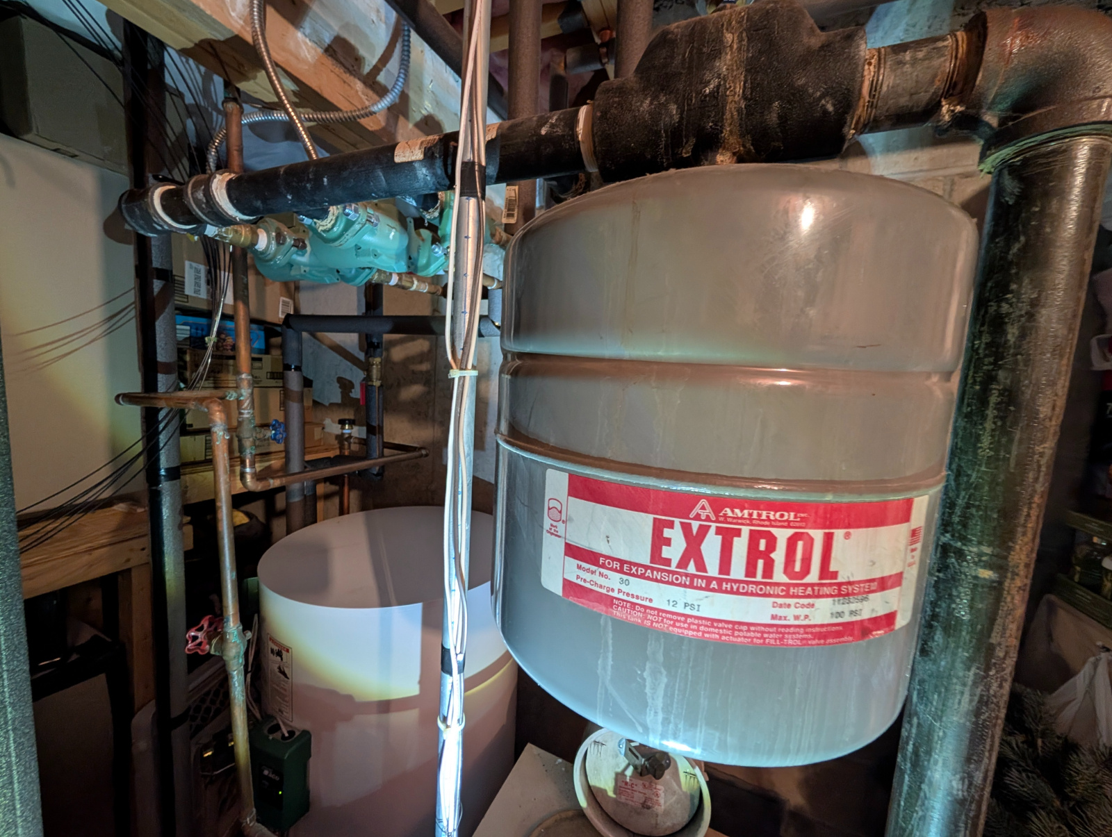

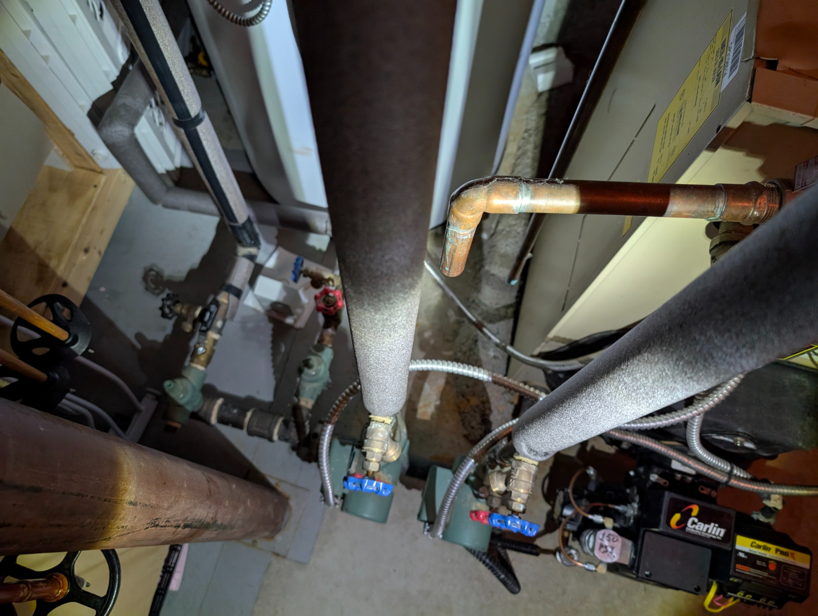

So…4 Taco 007s (and yes…2 are push and 2 are pull…I guess it made sense to someone at the time)…first floor approx 47' of Slantfin, second floor approx 62' of Slantfin, basement approx 14' of Slantfin…and the Vitocell indirect.
The rust on the floor….thank you 2010 14" of rain in a month and groundwater…basement got some water, otherwise I have seen no signs of any issues with the boiler…or burner…the vitocell was last summer after the Amtrol Hotwater Maker from 1997 decided it was time.

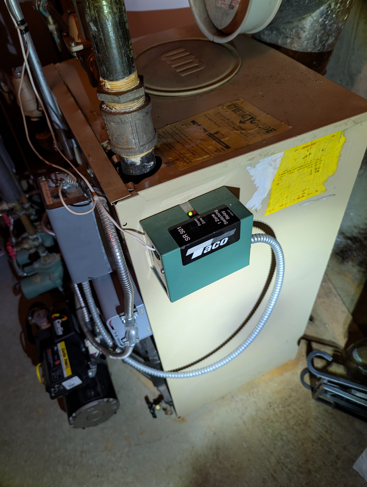

    You have a WGO. And as long as the boiler can be downfired somewhat, you should probably keep it
    EBEBRATT-Ed Member Posts: 20,716
    I would keep it. There is no need to replace it as a replacement won't save you any money
  • TwoDogNight
    TwoDogNight Member Posts: 2
    Thanks for the replies. I was leaning to keep it. So how long might I expect to get out of the WGO? My in-laws boiler is circa 1985 and still runs, but probably not even as efficiently as mine.
    Steamhead Member Posts: 18,771
    That WGO is cleaned from the top. Do they have to remove the draft regulator to take off the top cover? Or do they just skip that part? If the latter, relocating the regulator is in order.
