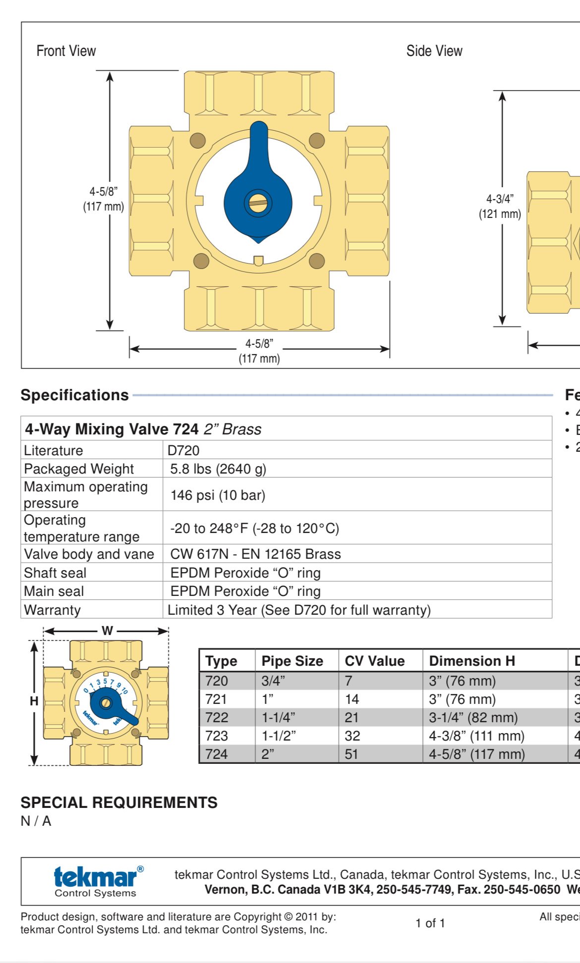

So here is a question. Yesterday we were looking at the setup and as will need a 4 way mixing valve I mentioned that I would get a Tekmar. He wasn't overly thrilled. So I was wondering what alternatives I have?
It needs to be 1.25",I want outdoor reset also.
I started looking at Taco but 1.25" doesn't seem available.

    the valves and actuators are all about the same. Its the control that drives the actuator that is key. Tekmar is probably the most common, been around for 25 years or more
    The rep in Denver for tekmar is one of the best.
    Are you sure you need an 1-1/4?
    You size a valve by the Cv number not the connection size.
    The 1” tekmar is a 14 Cv so14- 18 gpm without a problem. That would be a 140,000 btu/ hr boiler, what size do you have?

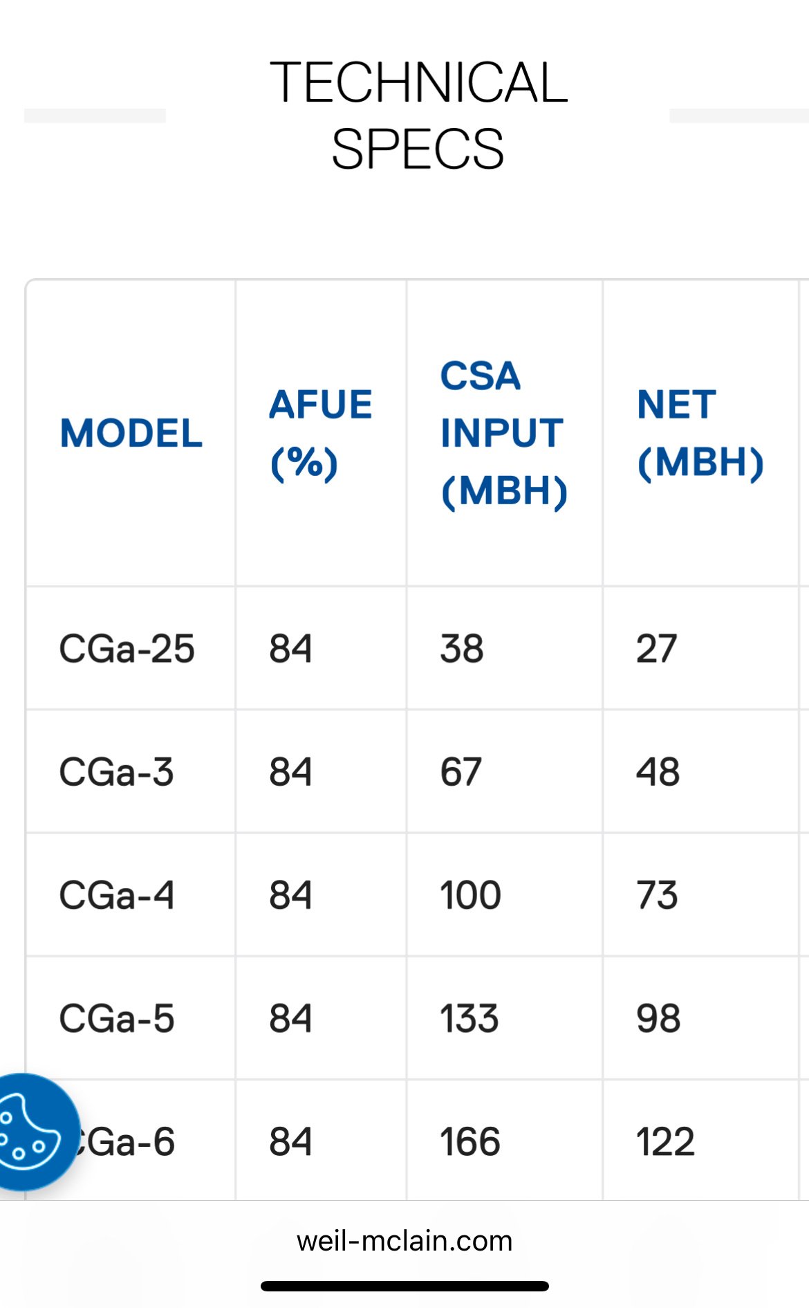

    Thanks for your reply. The Weil-McClain CGa3 is 67,000btu. The reason I was thinking 11/4" is the old 3 way is/was 11/4" and the copper piping is also 11/4".
    So it appears I can go down in size even though the piping is 11/4"?
    Tom
    is 67,000 btu/hr input or output? you need about 1 gpm per 10,000 btu/hr so if that is output of the boiler you'd need a valve with a Cv of about 7.
  • Cyclist77
    Cyclist77 Posts: 269
    It is 67,000 input.
    hot_rod Posts: 28,705

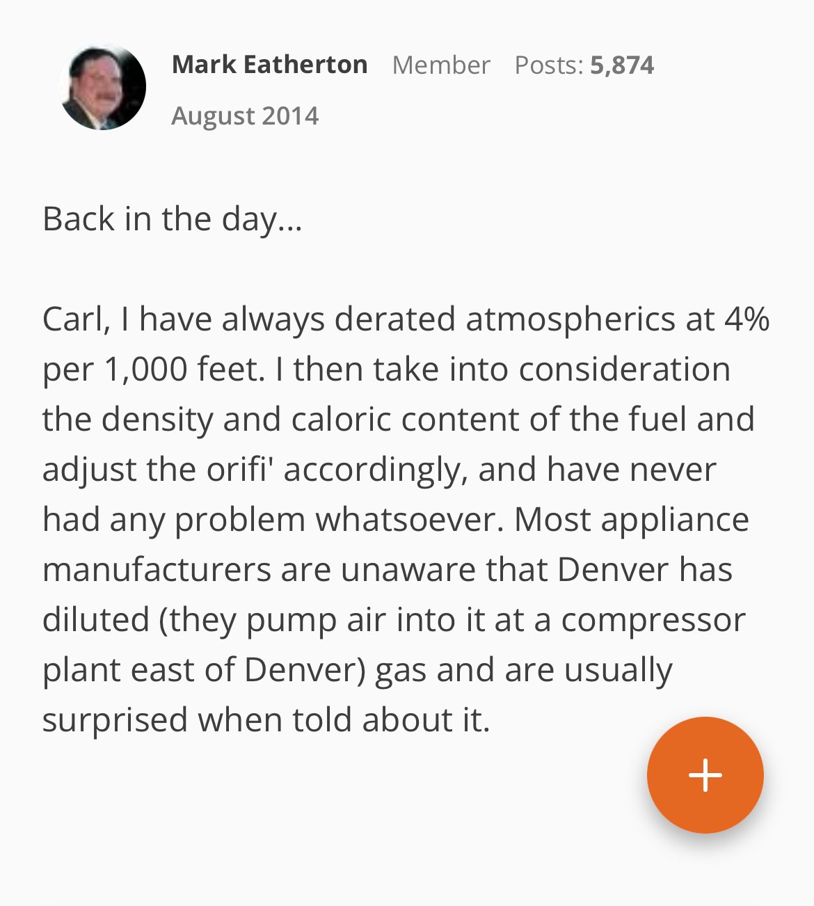

    look at the output number on the boiler and then take the altitude derate. I think you are in the mountains above Denver?
    48,000 is the net output taking into account the 84% efficiency
    Then derate 4% for every 1000’ altitude above 2,000’
    I’m not sure the calorific content of NG is out there these days, if you are on NG?
    Actually a 3/4 valve has a 7 Cv
    4 gpm may move all that boiler will give you

    You always want to size any control valve close to the gpm load. If not the valve hunts around loses it's resolution.
    It may seem silly, but a 3/4 tekmar 720 is the correct valve for a 5-6 gpm load. They are a pretty wide open valve, not much flow resistance.

    So it is reasonable to use a smaller 4 way mixing valve even if the piping is a larger diameter?
    yes, everything in the system, pipes, fittings, valves, pumps should size to the load, defined in gpm
    Cast boilers often have large connection as those sections get used in larger output boilers
