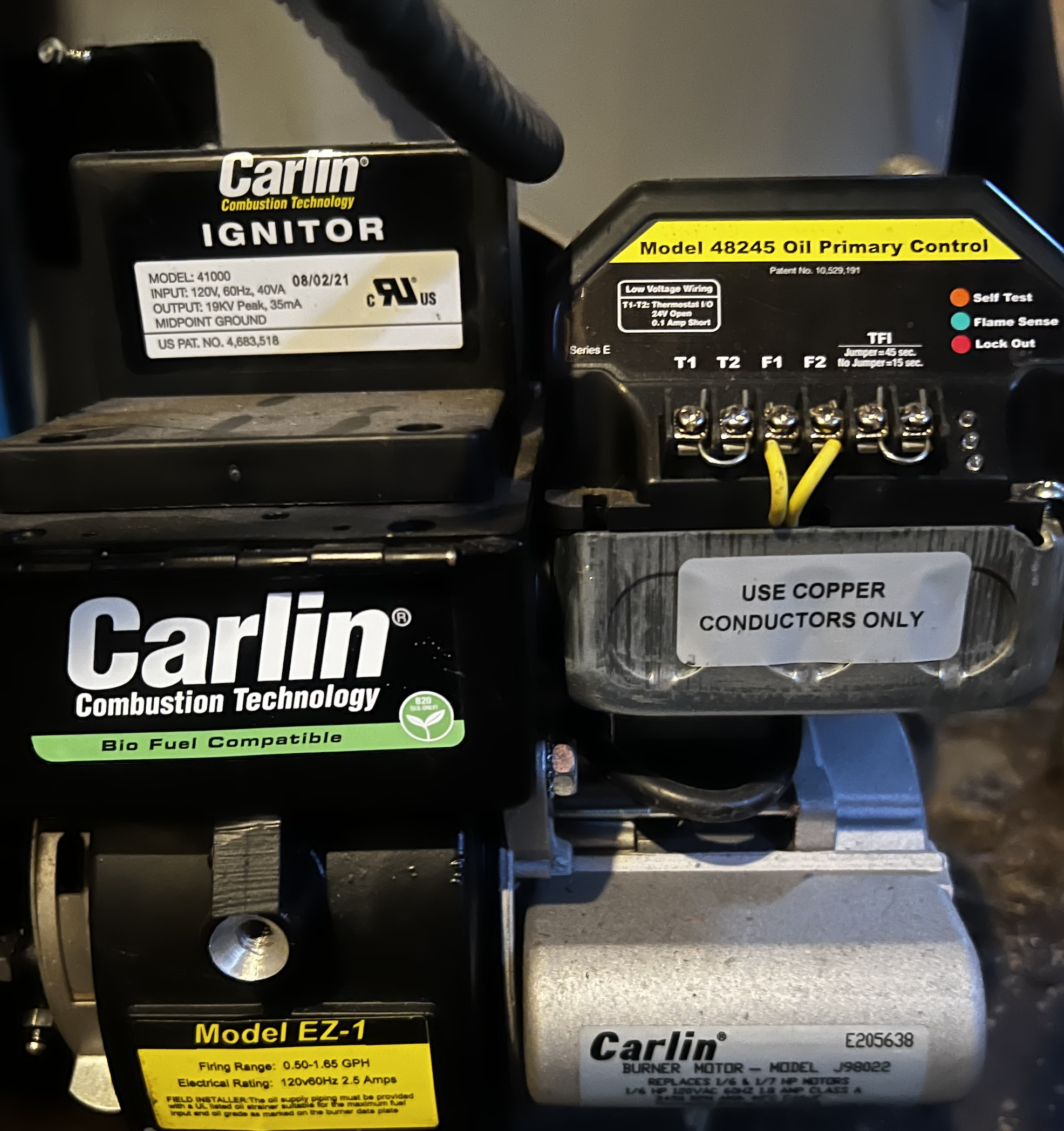

Carlin Hot water heater, Model EZ-1 Has been acting up recently since last oil delivery. I did not go dry, Regular scheduled delivery. The Water heater unit keeps putting me into lock out mode. I bleed the system and reset it, it'll start back up with a green blinking light. The light hasn't gone solid green. But it works for a few hours and then shuts down and puts itself back into lock out mode. When it works, there are no lights. I can't figure this out. It's getting extremely
annoying to have to keep restarting it every few house. Any ideas?

    Photo of the unit above ^

    EdTheHeaterMan Member Posts: 12,543
    edited October 2025
    Those numbers are found using the combustion analyzer that your Tech should have used on the most recent service. If your Tech does not have one of these Combustion Analyzer things along with a Smoke tester for oil heating work, then I would fire him and hire someone that knows how oil burners actually work.
    There are several reasons for a primary control to go off by the safety lockout. …and did you know that you are only supposed to RESET ONLY ONCE. That is taught in every technical school when the students are learning about oil heat primary controls. I'm just saying that it sounds like your Tech does not subscribe to that well known rule of the trade. If the control locks out after you have reset it once, then the knowledgeable tech would take the burner apart and find the cause.
