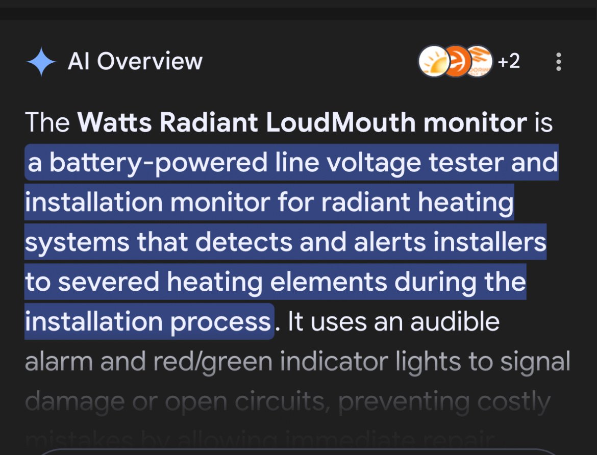

    I have heard of many electric cable or mat system failing. Then your done. They finally started sending “loud mouths” with the Watts Radiant electric systems to alert you if a damaged cable durning tile application.
    If the radiant tube in your bathroom freezes you probably have bigger problems to worry about😮

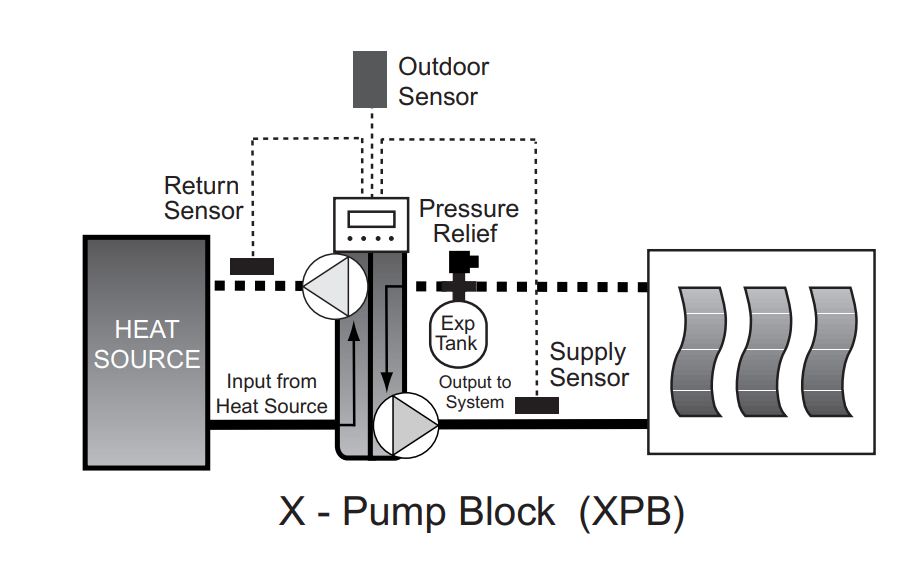

    For a small load and there is not already a boiler installed, I would look at a small electric boiler to get the size you need.
    Here is one option https://electromn.com/electric-mini-boiler/
    If there is a tank water heater, here is another option https://www.tacocomfort.com/product/x-pump-block/
    Dave Holdorf
    Taco, Inc
