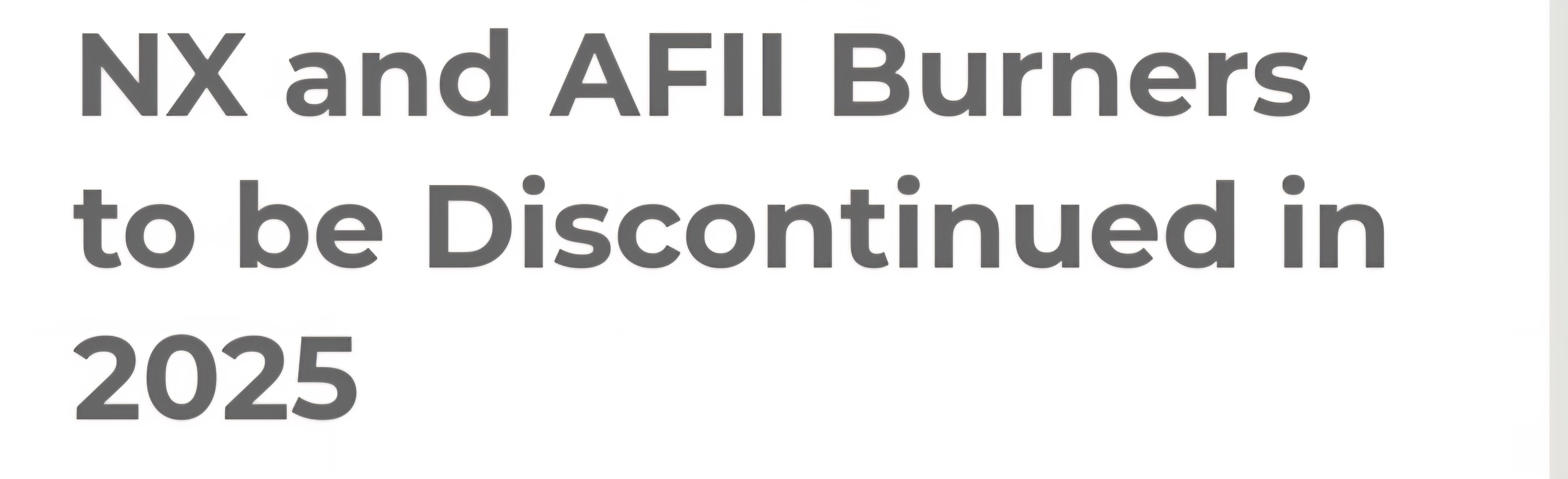

Anyone running a MPO189DV with the NX? Those Hagos are gold and Beckett seems to be scalping them.

    Dose Beckett have them? Yes. Beckett is scalping them, Through the roof special order. Buderus LoNox territory and then some.
    Steamhead Posts: 19,007
    Danfoss bought Hago some time ago and discontinued a bunch of their product lines.
    If that were my customer and I couldn't get the Hago, I'd try a 1.00x60B Delavan. This sounds screwy, but as I understand it, for an advertised spray angle Hagos were actually a bit wider than Delavans. Of course I'd verify it with a combustion test, as I always do.
