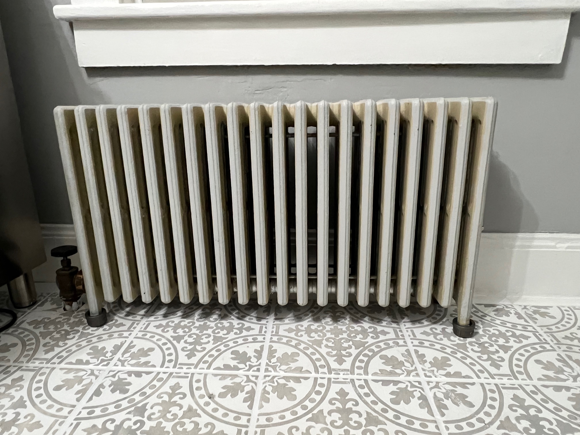

Recently we needed to move the radiator to get to the wall behind it as we were removing all of the Zbrick in the kitchen placed in the 1970s. At the time the radiator sat on a stack of 4 tiles each foot in order to bring to the height of the valve. Now that we've completed the Zbrick removal, wall is finished, we want to reinstall the radiator, but this time without the stack of tiles. There is actually about a 1/4 inch difference between the valve and the radiator (valve is higher than the radiator). I was looking for advice from this crew to see what may be the best approach. Here's what I was thinking:
  1. Removing the valve, use a die to add more threads, and cut the upper threads so the valve would seat lower.
  2. Remove the 1.5" pipe, replace it with a shorter length(not sure if possible not knowing how long this pipe has been in service and likely rusted to elbow below).
  3. Find a valve that has a lower bottom to center dimension (current one is about 1.5", would need about 1.25").
  4. Find a radiator that sits higher, and the input would possibly be higher (like some of my other radiators in the house).
The first picture is the old with the stacked tiles. The second and third are current conditions without the tiles. Radiator is 34x 19 x 7.

    are you sure the runout didn't fall when you disconnected it? you might need a shorter than just 1/4" riser to get good pitch back to the main. can you access it from underneath? a shorter nipple for the riser is the answer but depending on access and your skill that may or may not be a good idea.

    I would still want a buffer between the radiator and the tile floor. Maybe find a more aesthetically pleasing way to raise the radiator to where it was before. And not mess with the pipes which could be more of a project than anticipated.

    A marble door threshold would shim the radiator to the height you need and be aesthetically pleasing. Use cabinet jacks to lift the radiator and slide it in.

  • I thought I'd follow up, and thank you all for your suggestions and comments. After long thought, I decided not to try unbolting everything, nor attempting to cut and re-thread the pipe (making it lower to the floor).
    While looking at the local hardware store, I bought four 1" end caps with a bunch of washers. They were flat on the bottom, and the washers could be used to stabilize, level from to back, and create slope towards the valve. I was pretty happy with the end result, and better yet - so was my bride!!

    Smart move. its not worth cutting and re threading etc.
