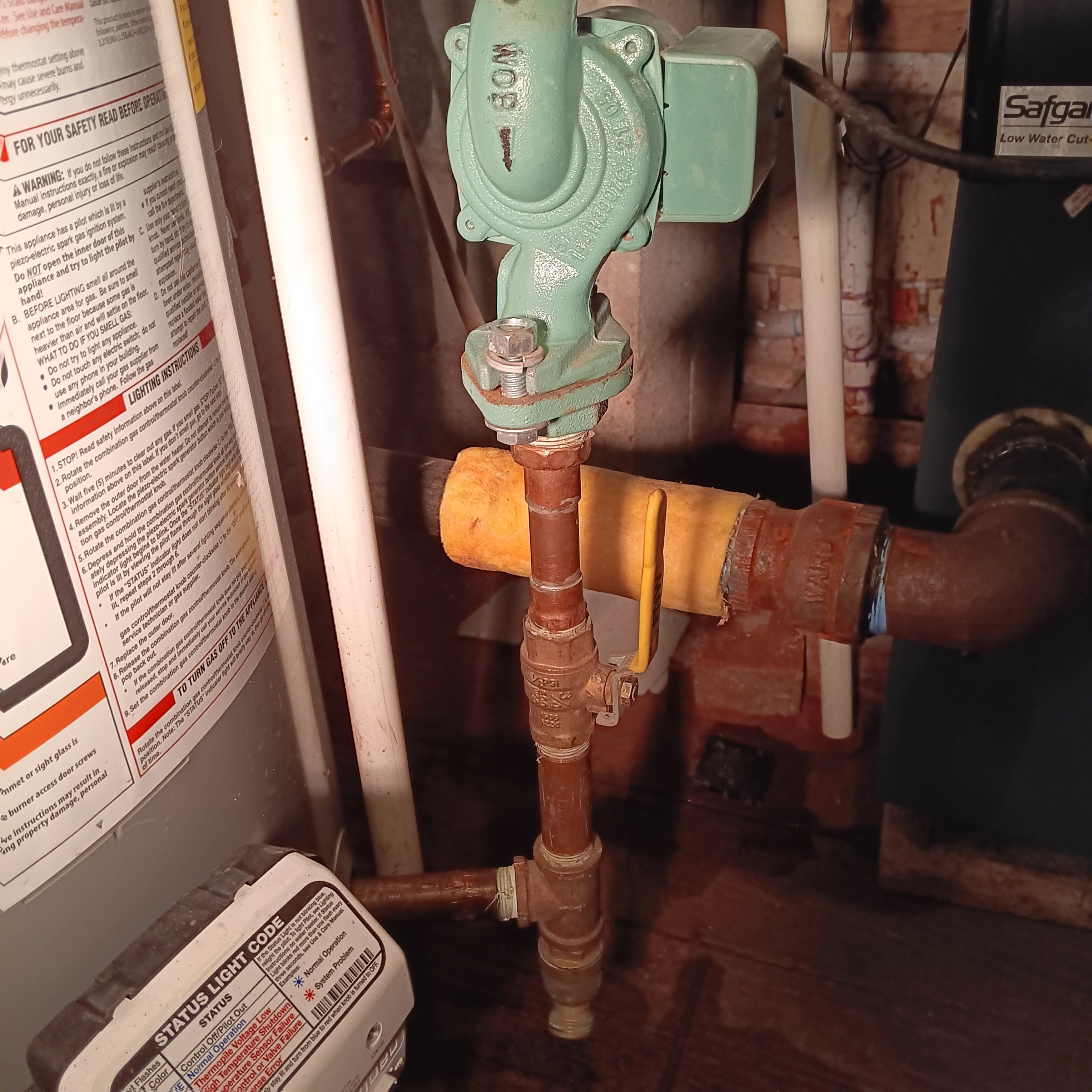

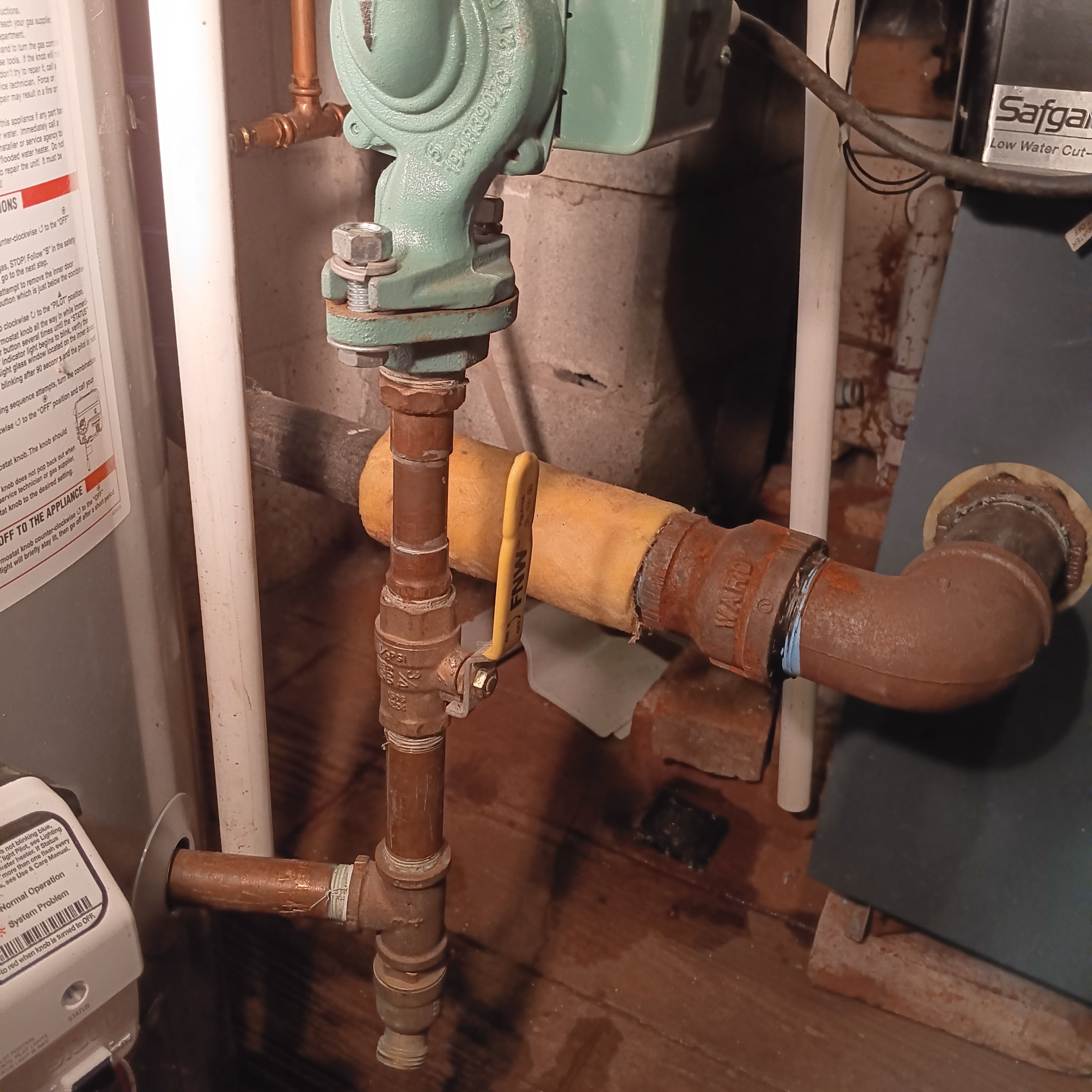

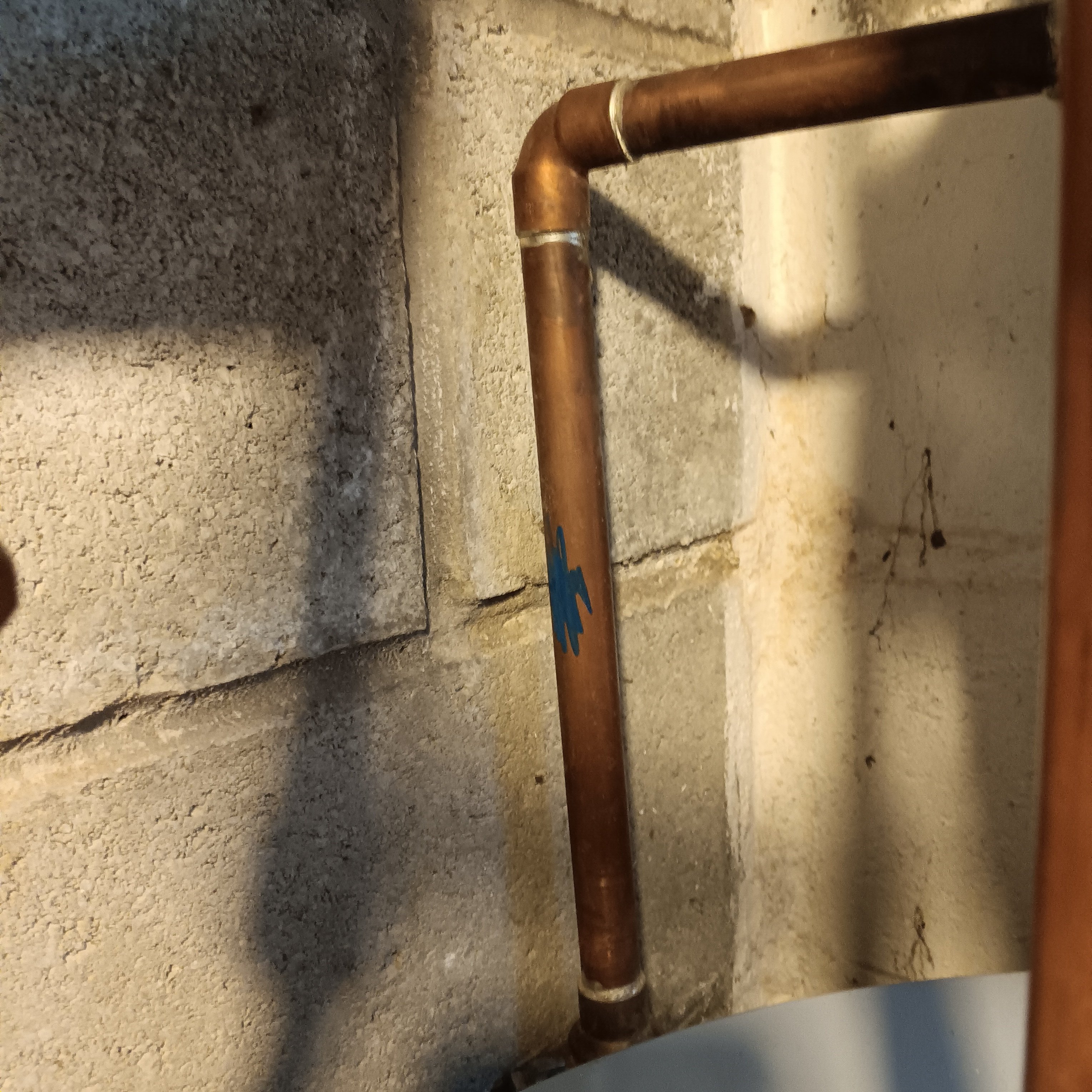

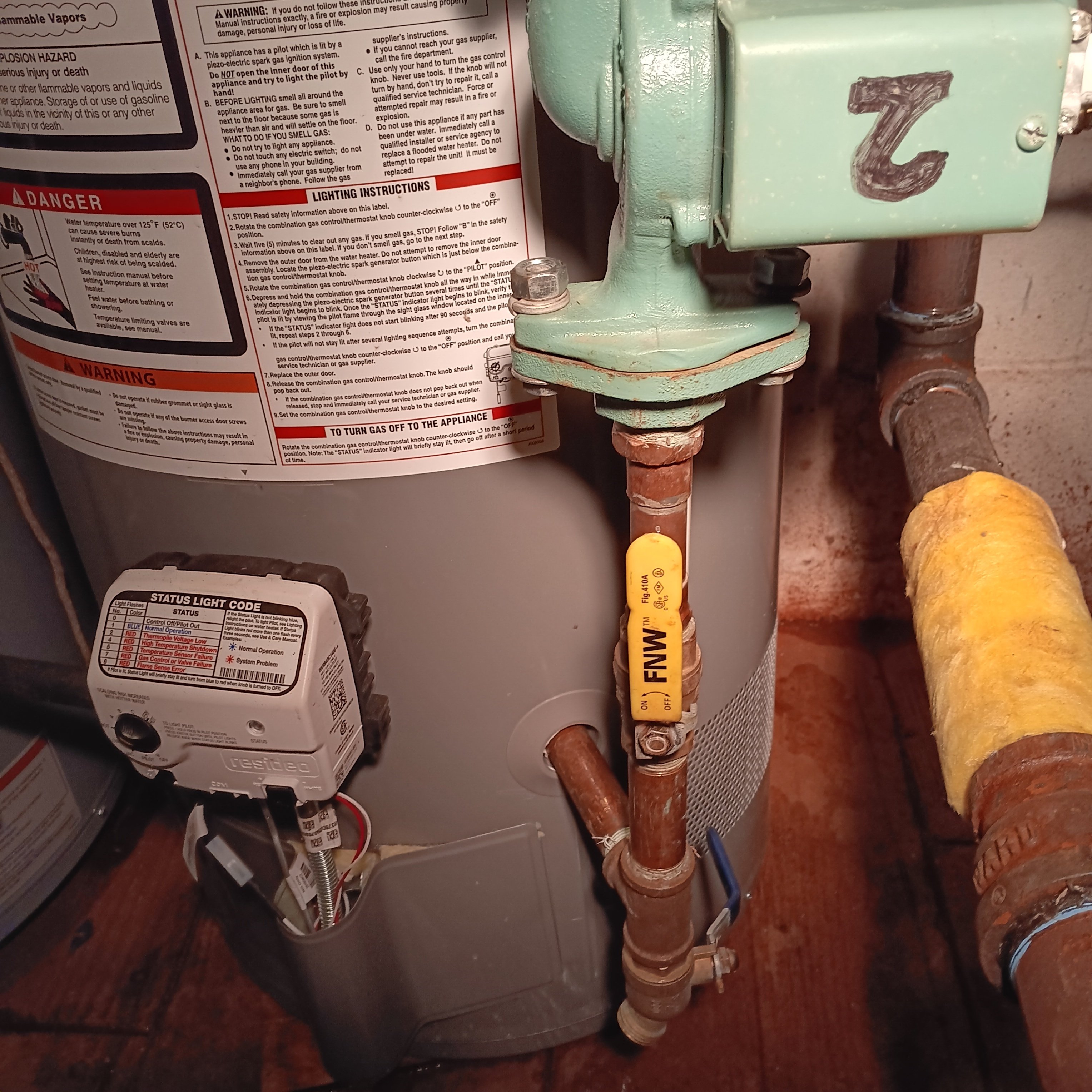

Question; My Taco pump is noisy the way it is currently installed.The out flow from the pump goes into the water heater drain port. Does anyone know if the drain could be a one way out that cannot flow in? I purged with water thru the system, and the pump is quiet. When I close the water flow, the pump makes a surging noise. Should I use the water heater hot and cold for the closed hydronic loop setup? This I replaced in system that worked well until I had to replace the water heater.

  • Hi, If there were a valve in the horizontal line at the heater drain, you could close that and really flush the lines, removing all of the air. Without that valve, it's hit and miss. 😐️
    Yours, Larry

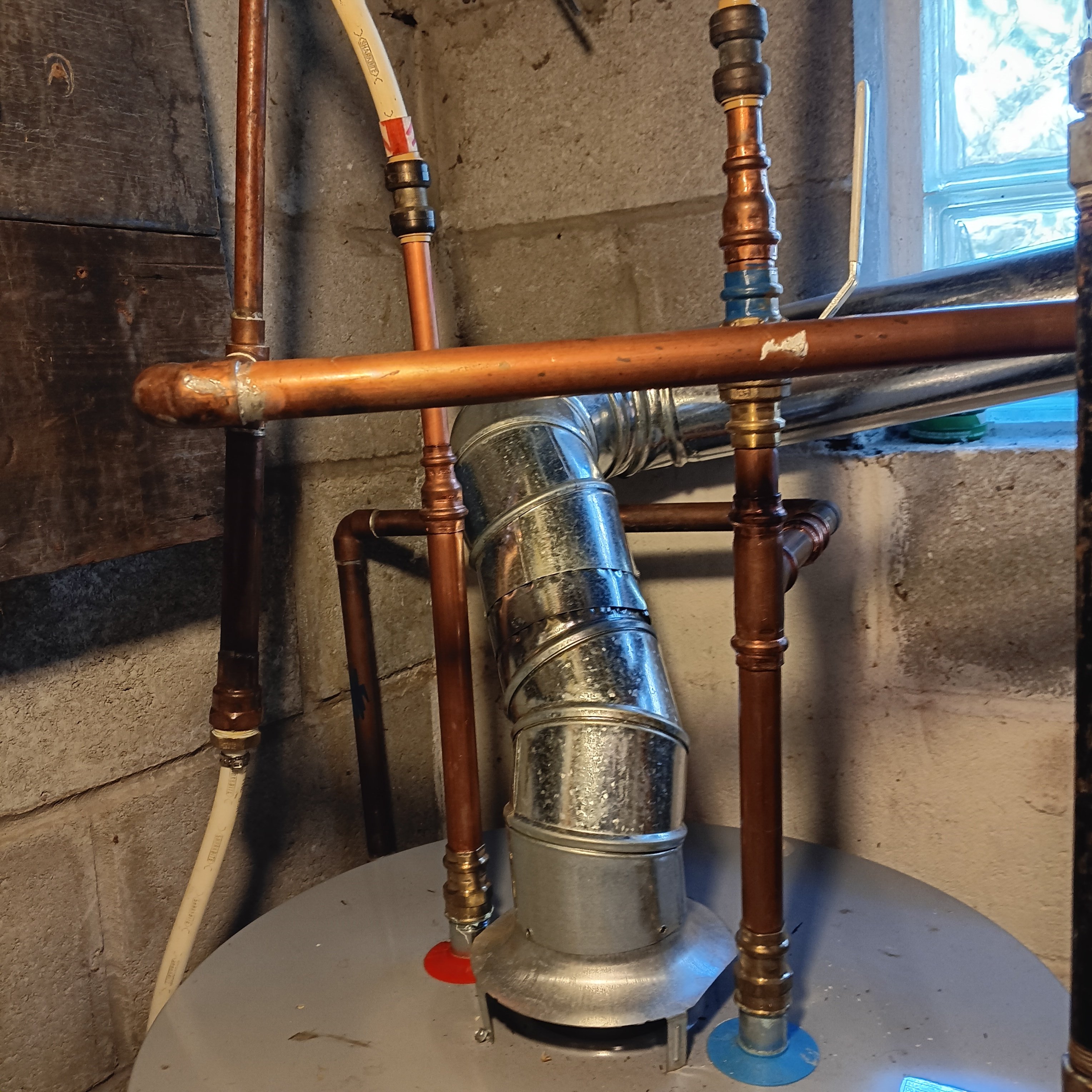

    does it do the hot water also? Seems like a lot of lines connected to the tank? T Wed o on top one on bottom
    Usually hydronics has a supply and return.

    Larry, there are isolation valves on each side of the pump. When I ran the water thru the system, I ran the pump also. The pump flow is thru the water heater drain, and out thru the hot inlet of the water heater. Should these be reversed?

    The home's hot water and the underfloor hydronic system are two separate water heaters.

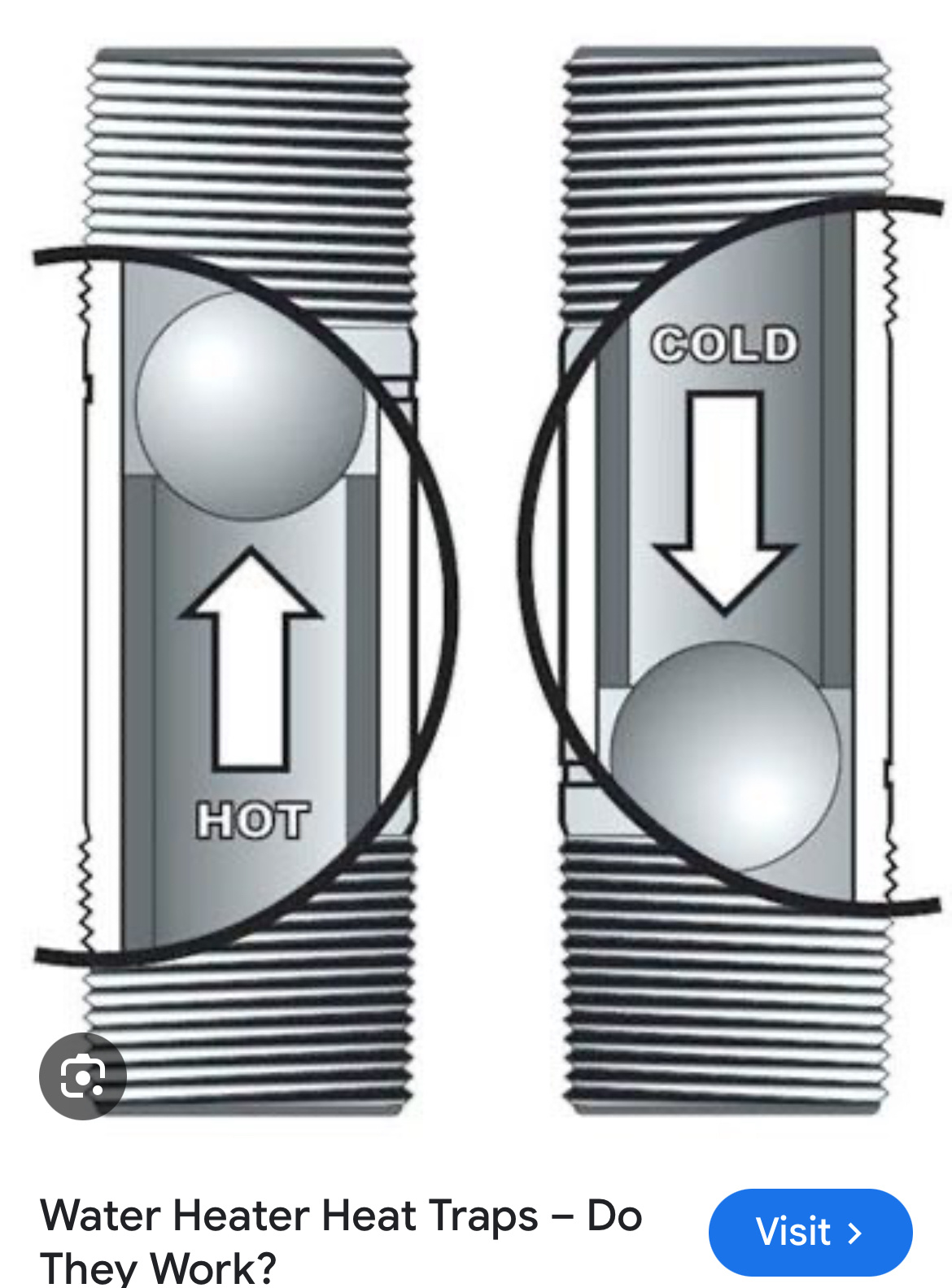

    Most water heaters now have “heat trapper” nipples on top. Basically a small flapper or ball inside the nipple to eliminate gravity flow. It acts as a weak check valve .
    It may be enough obstruction to starve the pump.
  • "Larry, there are isolation valves on each side of the pump. When I ran the water thru the system, I ran the pump also. The pump flow is thru the water heater drain, and out thru the hot inlet of the water heater. Should these be reversed? " … Hi, It looks like the heater drain can get water both through the pump and from the tank. It's simpler for water to flow from the tank. If water could flow only from the return line and pump, household pressure could be the driver, rather than just the small pressure the pump can create. This will remove any air from the lines. You may be surprised to get discolored water as well as it scrub the lines that have only seen slow flow. I've been in this position many times and adding the valve has always worked.
    Yours, Larry

    Ɓob, there are these on̈ both hot and cold inlet ripples. So, this would restrict the flow? Can I remove these, or just replace the ripples? Sounds like this is the problem.
    hot_rod Posts: 28,705
    depending on which type you have, the black rubber flapper pulls out with a pliers
    Im not sure about the ball type , but someone put the ball in there🤔
    I have ripped the plastic flappers out easily with a needle nose.

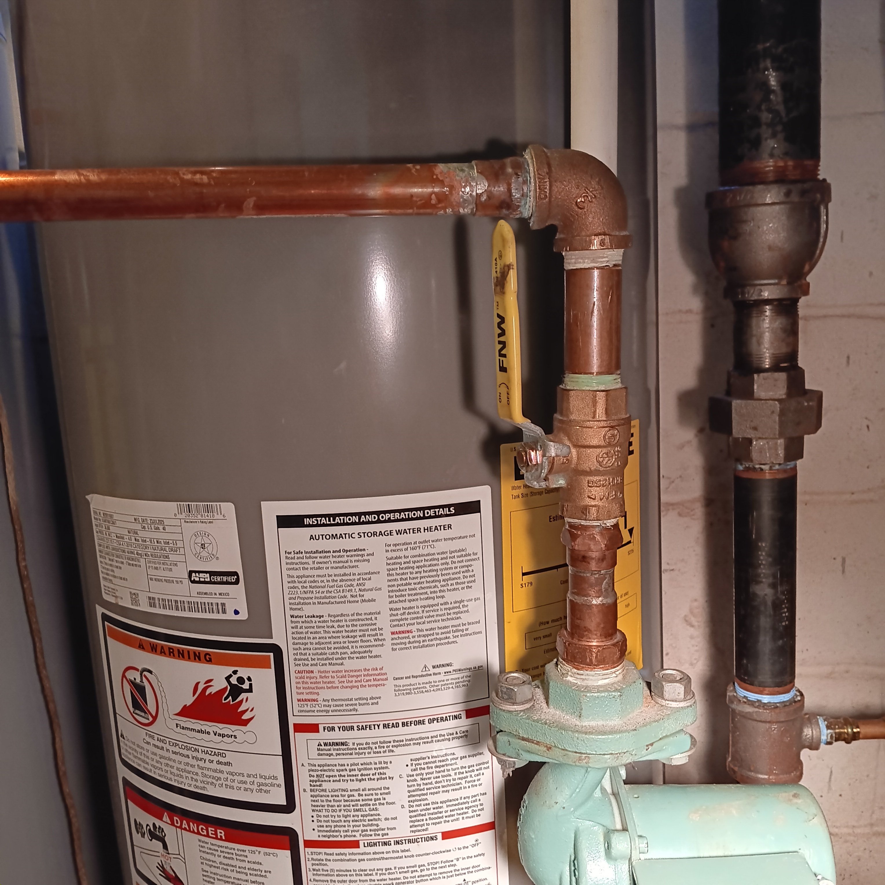

    I took out the plastic pex from inside the hot side water heater nipple, and this has lessened the noise alot, and I can hear the flow of water through the piping near the pump. This has definitely helped, as the outlet to the underfloor is getting hot, which didn't happen before! Thanks for the tip!
    on a closed loop system you should be fine
    The plastic inside is what makes it a dielectric nipple to be used between dissimilar metals
