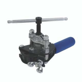

    I have some older version of this tool though i wouldn't recommend going this cheap. I've used it on smaller steel tubing and 1/2 / 5/8 copper.
    https://www.harborfreight.com/plumbing/plumbing-tools/pipe-threaders-cutters-benders/tube-flaring/7-piece-tube-flaring-kit-5969.html

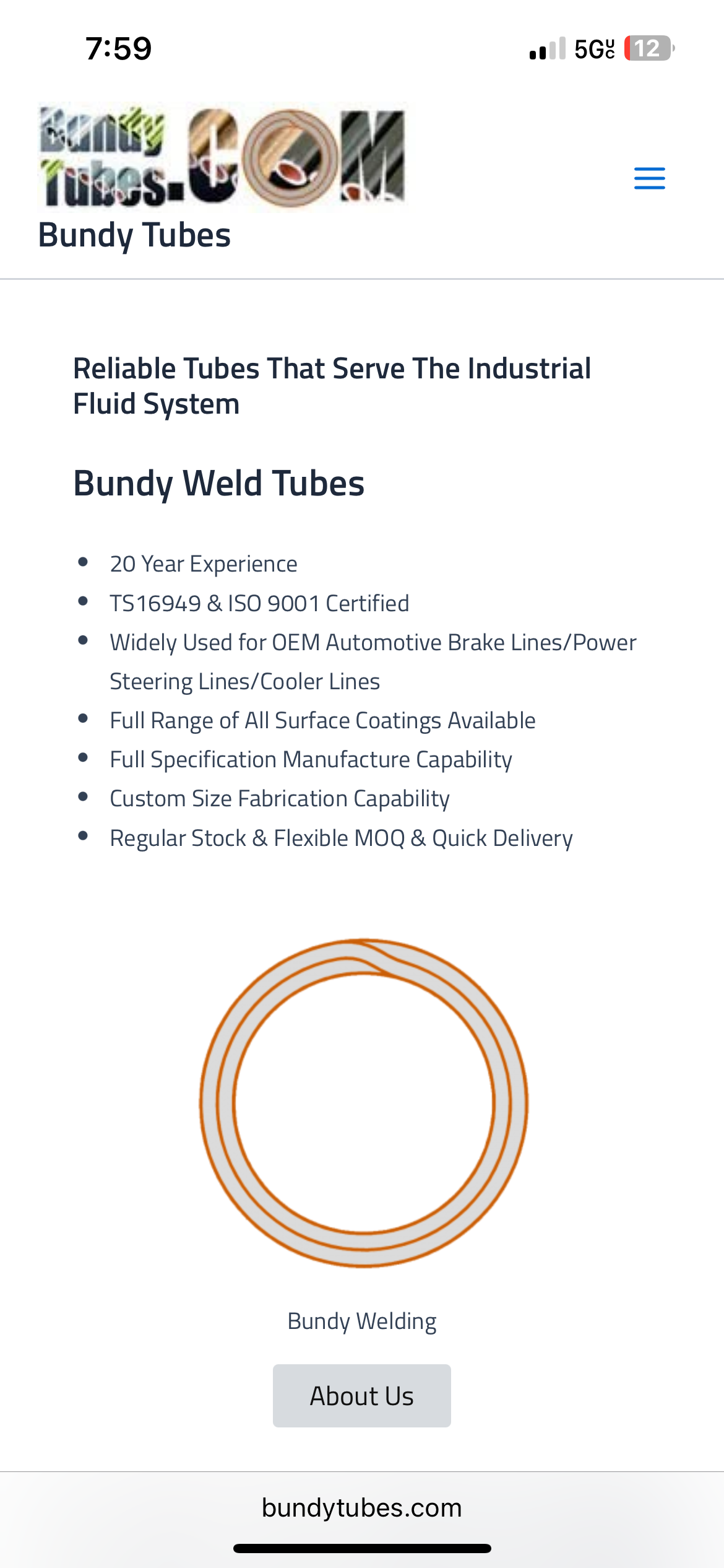

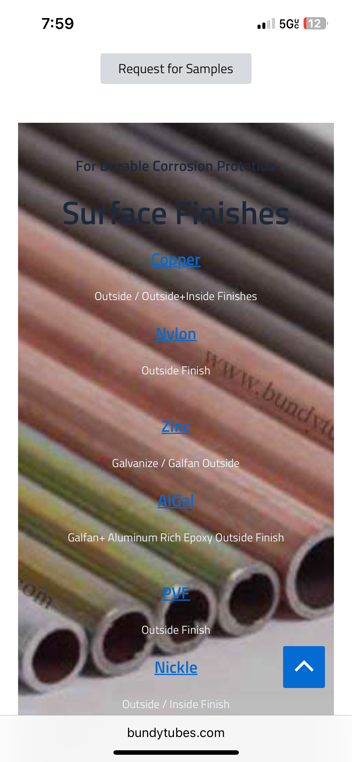

    looks like Bundy Tube is still a thing. Your choice of outer coatings
