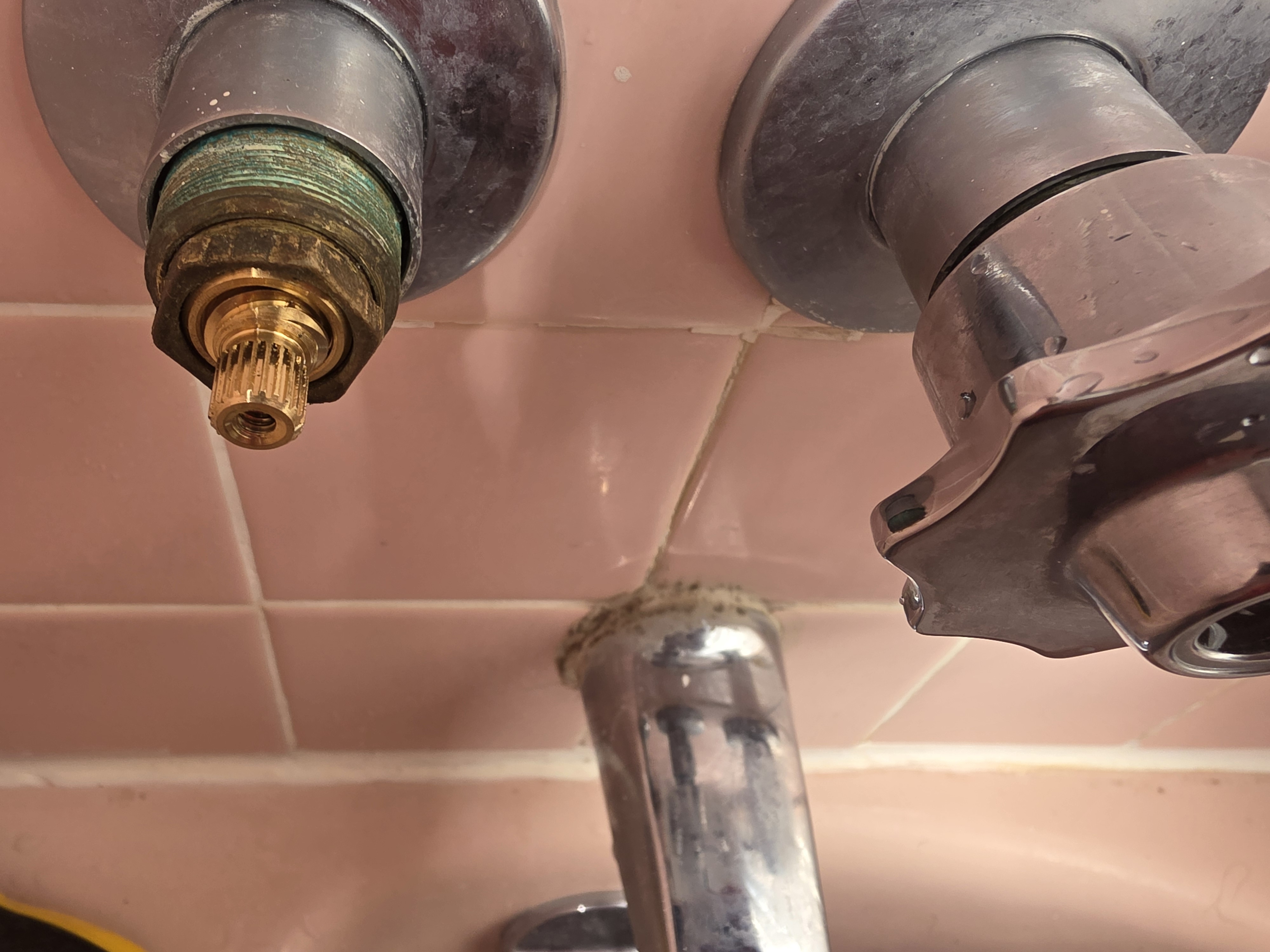

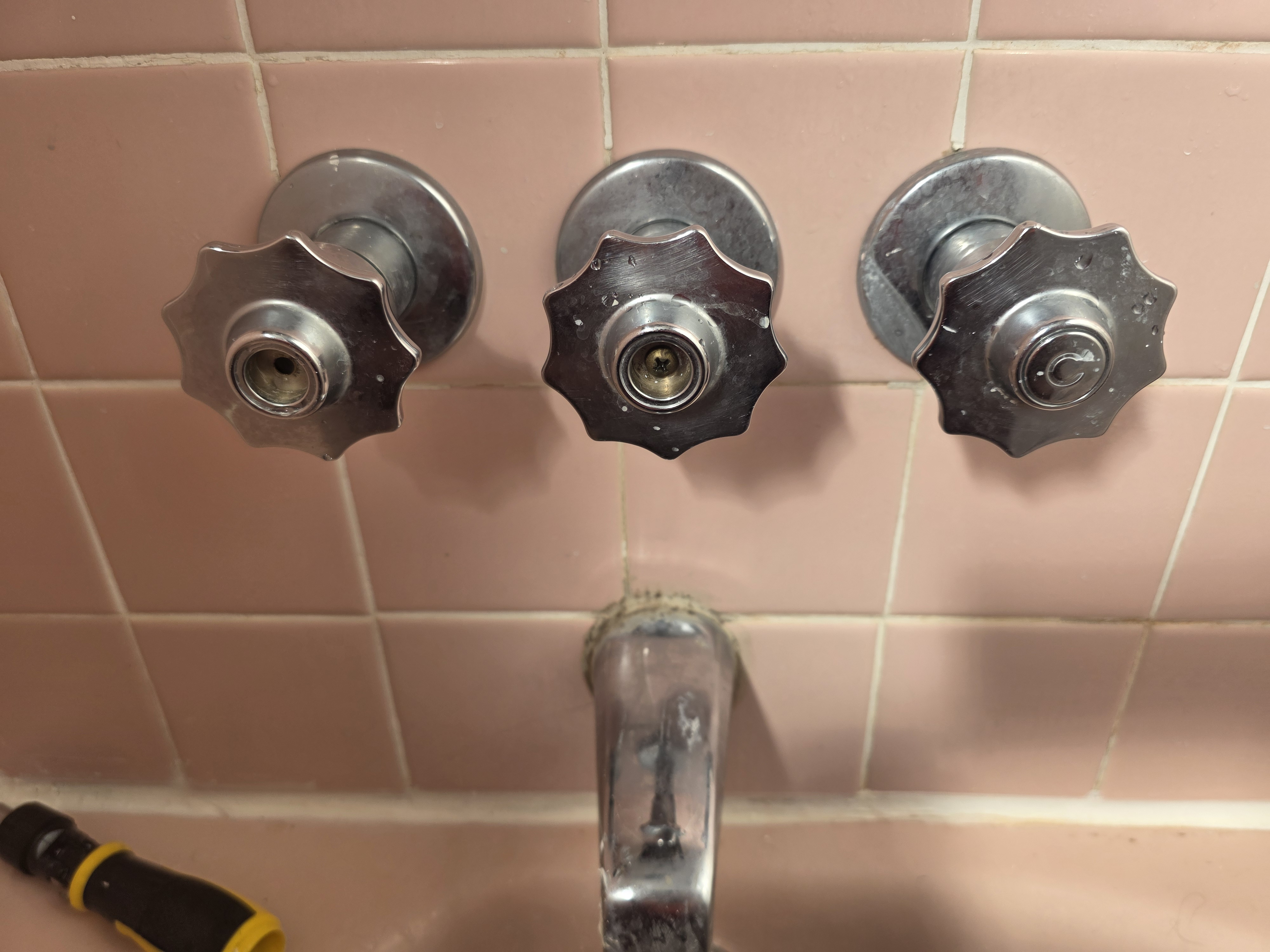

Hello all, I am writing this post to see if any can advise and provide some guidance.
Recently one of our American standard faucet started to leak. After a few calls we had a few plumbers stop by and they all had different opinions and suggestions.
Two plumbers suggested that it would be better to replace the old faucet and install new ones. One even went as far as stating that the faucet are old and locating parts would be hard and not worth the time. In addition if the parts were found and replaced, rhe fix wont last and the leak would return in matters of days weeks. They both provided quotes suggesting delta faucet at a price cost for the work.
Another plumber stated that they were worth keeping but the part would take some time to order. He was going to use a conversion kit to fix the faucet but it would take some time to order the kit. The quote was close to the delta replacement of the first two plumbers.
The last plumber arrived and explained that these are American Standard aqua seal. The part that are hard to find are the top hat but luckily he has a few. Shortly after the work was done and he was done.
Two Weeks later the leak is back. My questions
  1. Was the two plumbers from the start telling the truth. These faucet should be replaced rather than fixed? If so what faucet would anyone recommend? I noticed delta cartridges are plastic.
  2. Should have the plumber replaced more parts other than the washer top hat? Or are these faucet done?
  3. I noticed some parts can be purchased from Amazon, what parts to buy if I was to try fixing this my self. Is there a conversion kit like the 3rd plumber mentioned (even do I was not able to find it).
  4. I am guessing the diverter is the same story of just replacing parts.
  5. Any Suggestions would be greatly appreciated. 20251006_094314.jpg 20251006_094337.jpg
Thank you in advance.
    Where is it leaking? Is it dripping from the spout or is the packing/o-ring around the steam leaking? Anyone with a little experience should know where to get parts for it. Once the parts are replaced properly it should be good for another 5 years to couple decades depending on your water and usage.
    HeatingN00b
    in most cases you probably can just regasket it without replacing the whole cartridge or seat.
    hot_rod Posts: 28,708
    It is always wise to replace the complete stems and the seats when you rebuild old faucets. Then every seal is new.
    That is a nice design stem and seal, properly rebuilt it should work fine.

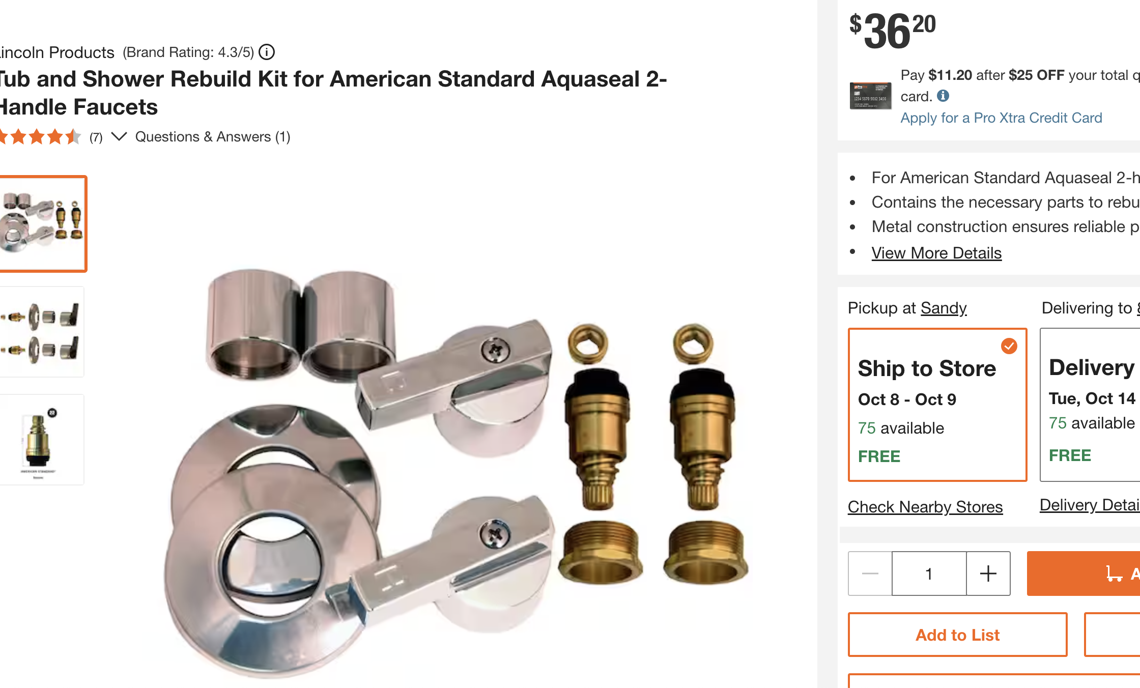

    Home Depot has the kits also. Available without new handles.

  • I did try my local hardware store and they did not have anything for this model according to them.
    The leak is coming from the hot water knob when fully closed. I also get water coming from the steam of the diverter when its set for the spout but when its set for the top no leak.

  • Not a bad price, they also have the 3 set. Thank you.
    Quick question, for the brass Bibb what tool would I need to remove the old one and install the new one?
  • Ye I saw that homedepo has the kit but was unsure if it was the correct model since I have the 3 faucet set.
    Was planning to take a gamble on the homedepo set or the amazon one but the supply house has the full set for the 3 faucet. Will order from them thank you.

    If they replaced the cartridge, make sure it is the same size as the old cartridge. I don't know that produce specifically but they usually had different length stems for different trim packages. Also put a little teflon pipe dope or anti seize on the threads of the bonnet and the broach of the stem so it doesn't fuse together for the next time it needs service. People still have lots of tub and shower valves of similar design that are 80 or 100 years old that still work fine with occasional maintenance.
    It is also possible that some part of the escutcheon or extension tube isn't adjusted right so the knob bottoms on that before closing the valve fully.

    I generally just replace the top hat and the seat if needed. As long as the top hat doesn't leak into the stem, the brass parts should be fine.
    The nice thing about the AquaSeal is it was designed to fit existing A-S washer-type faucets from about 1955 on. My house had those and I updated them decades ago, and I've only had to replace a couple top hats since then.

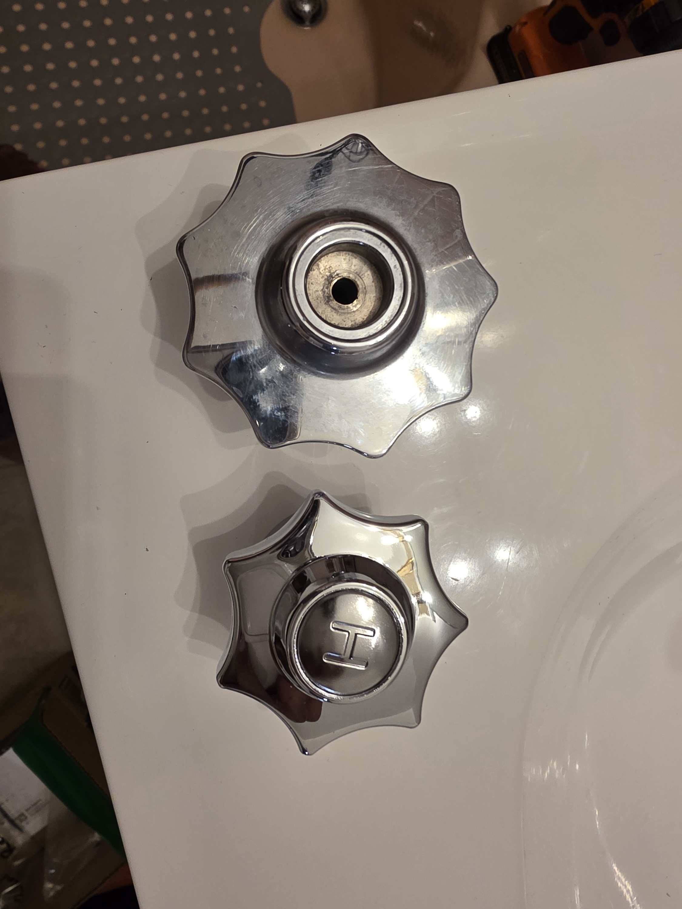

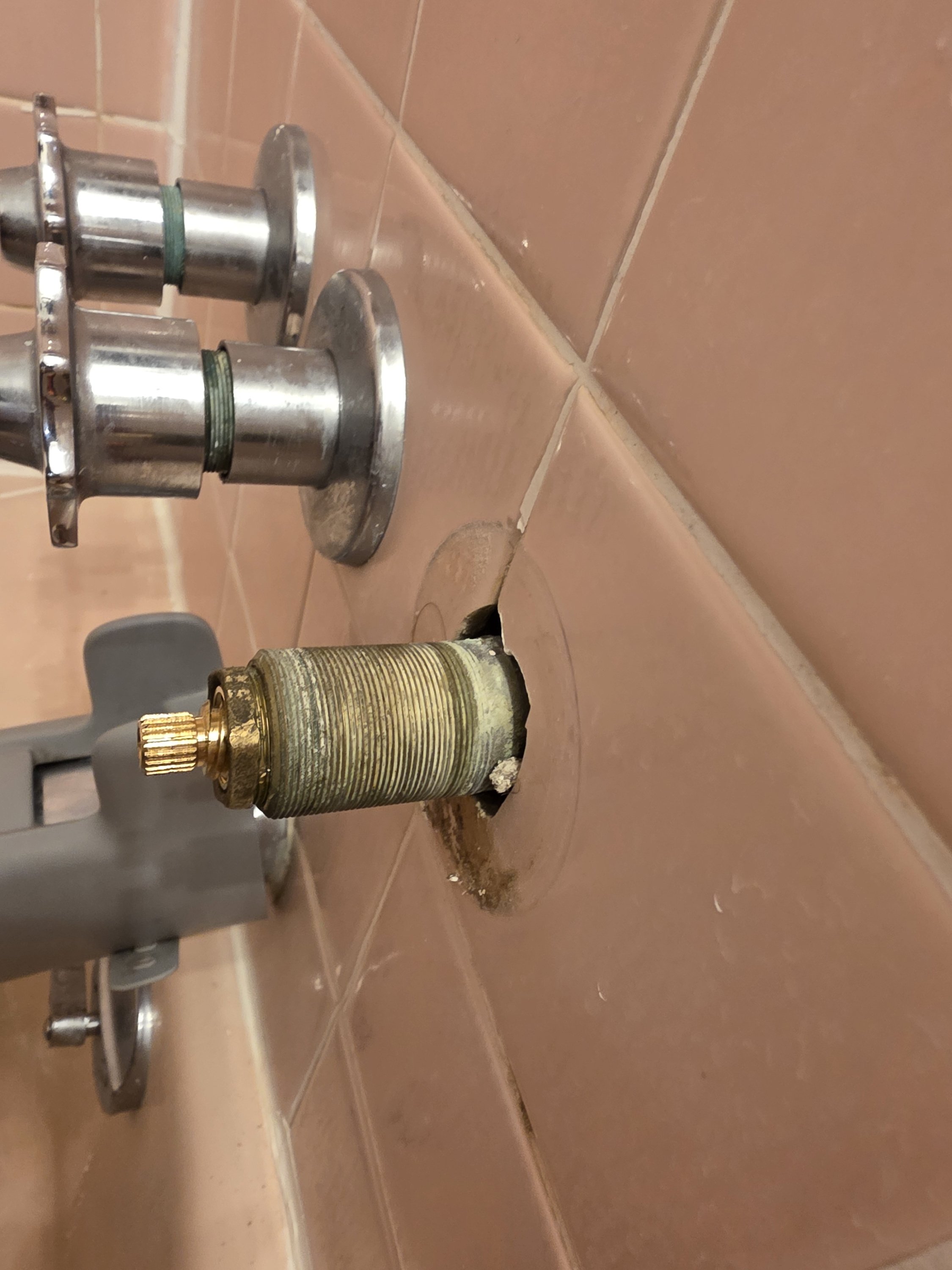

  • Might be a stupid question but....
    1. Aesthetically ..... is there rings / sleave extension to fully cover the threads? Cant find any if there are. Or is there any way to move the threads to fit better?
    2. Just noticed the kit that arrived the knobs are smaller (should this be a concerned)?
    3. Took off the knob and wiggle the cartridge while shutting off the water and it stopped dripping. Could this mean there is something loose? Should have free time this weekend (unless kids have practice these week ).
    edited October 2025
    I think the sleeve threads on different amounts to account for different wall thicknesses/rough in depths. Does the sleeve hold the escutcheon on or does the escutcheon just slide over the sleeve to cover the hole in the wall? I think there might be different lengths of sleeves available
    If you put the knob on without the screw and turn it a bit toward closed does it stop dripping? when you turn it off with the knob screwed on does it feel like it is still tightening against something soft or does it feel like it is bottoming metal to metal and stops abruptly? It looks like the stem might be too short for the disc to seal tightly to the seat.

    That faucet was roughed in too far out. I know they make deep rough extensions, never seen a shallow rough fix.

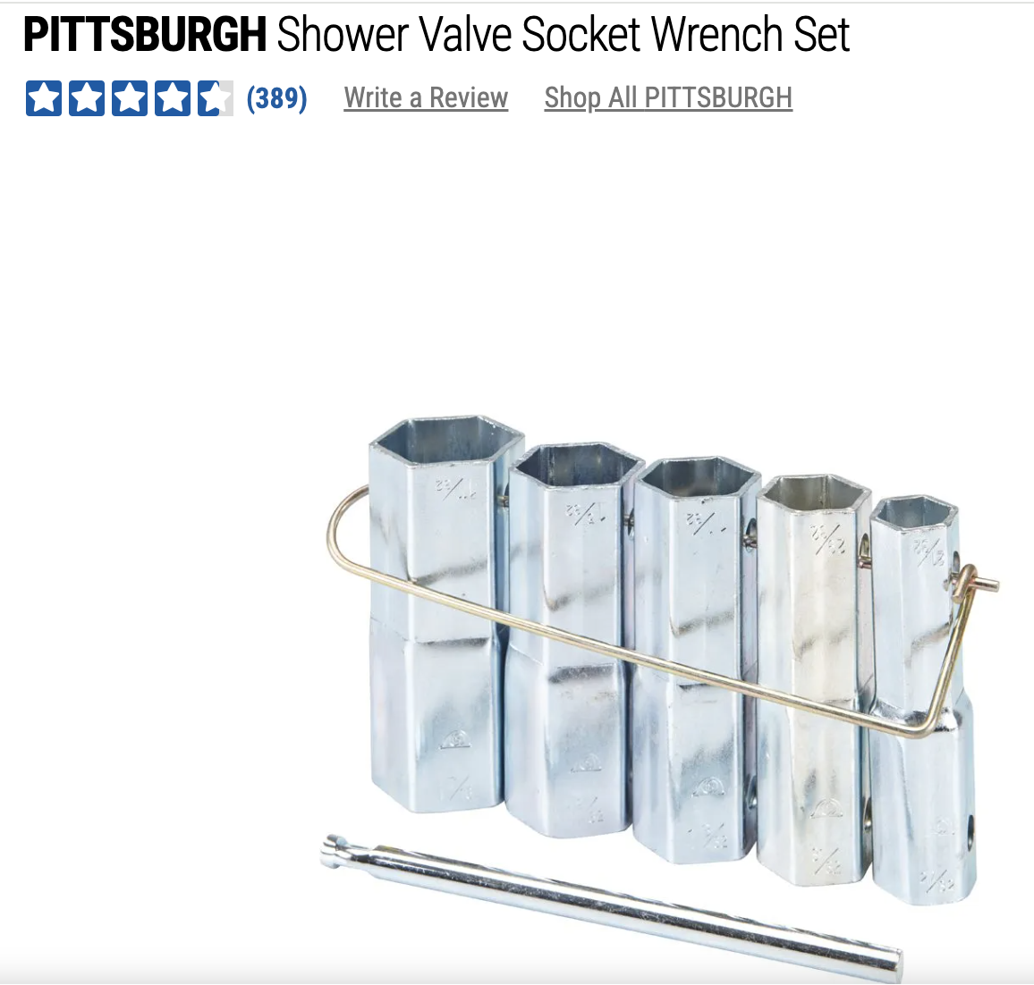

    A set of faucet sockets is nice to use to prevent damaging the brass assembly nut.
    The correct tools in the correct hands should make that a fairly simple 30 minute task.

    I bought a set of those shower valve sockets from HD. I am sure the same China stuff HF sells and they were worthless. Sloppy fit.
    On those the nut is far enough out that you can use an open end wrench or good adjustable wrench.
    The shower valve sockets were never really meant to be a great fit, they were meant to be cheap and close enough. If you really want a good socket, buy a 6 pt deep well socket. That retainer nut should be just snug, it shouldn't really be cranked down, it is hollow so it can break if you really wrench on it.

    the sleave holds the escutcheon on if i dont screw on the sleave all the way the escutcheon has play to move front and back.
    When i turn it with the knob on without screwing it in it feels like its pushing on the rubber part not the metal. Is it sopost to feel metal on metal?
    You should use anti seize or teflon pipe dope on the threads and on the broach and screw to form a barrier so the metal doesn't fuse together.
    Will do. Just order the lubricant. Thank you.
  • Wow, you are great!!!
    Thank You amillion times. Will order the sleeves extension.
    I will see if i can polish the old knobs and make them look new if not I will order the new ones.
    TThank You once again.
    It should not be metal to metal, it should stop as it compresses the resilient "top hat" seal. It looks like there are long stem cartridges for it, you may need those.
  • How would I know if need the long stem?
    Originally it had the short stem.
    it had the short stem when you got it, you don't know what it had originally, right?
    if the handle bottoms on the trim or the bonnet before the seal seals then you need the long stem.
    take a look at the seat, both feel it and look at it with a light or try to take a picture of it. usually the seat doesn't get damaged unless it was left with a big leak for a long time but it could be part of the problem.
    those AmStd faucets had a nice soft close to them, those top hat washers were softer then a flat disc type
    you should not need to force them off, two finger close
    Old brass gets brittle and can chip off the seat face. That is why a resurfacing tool rarely works on old brass seats, they keep chipping away
