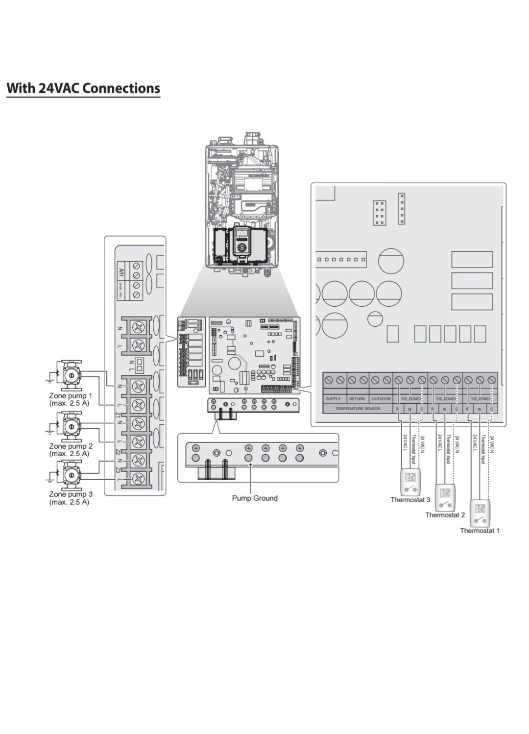

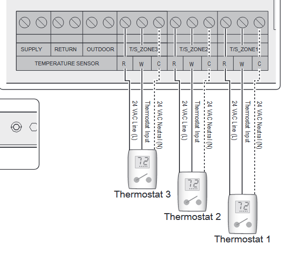

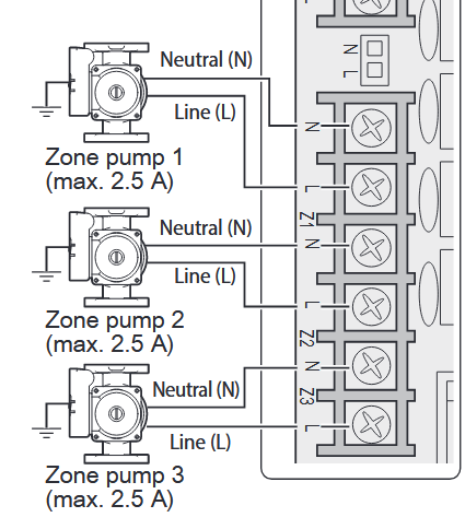

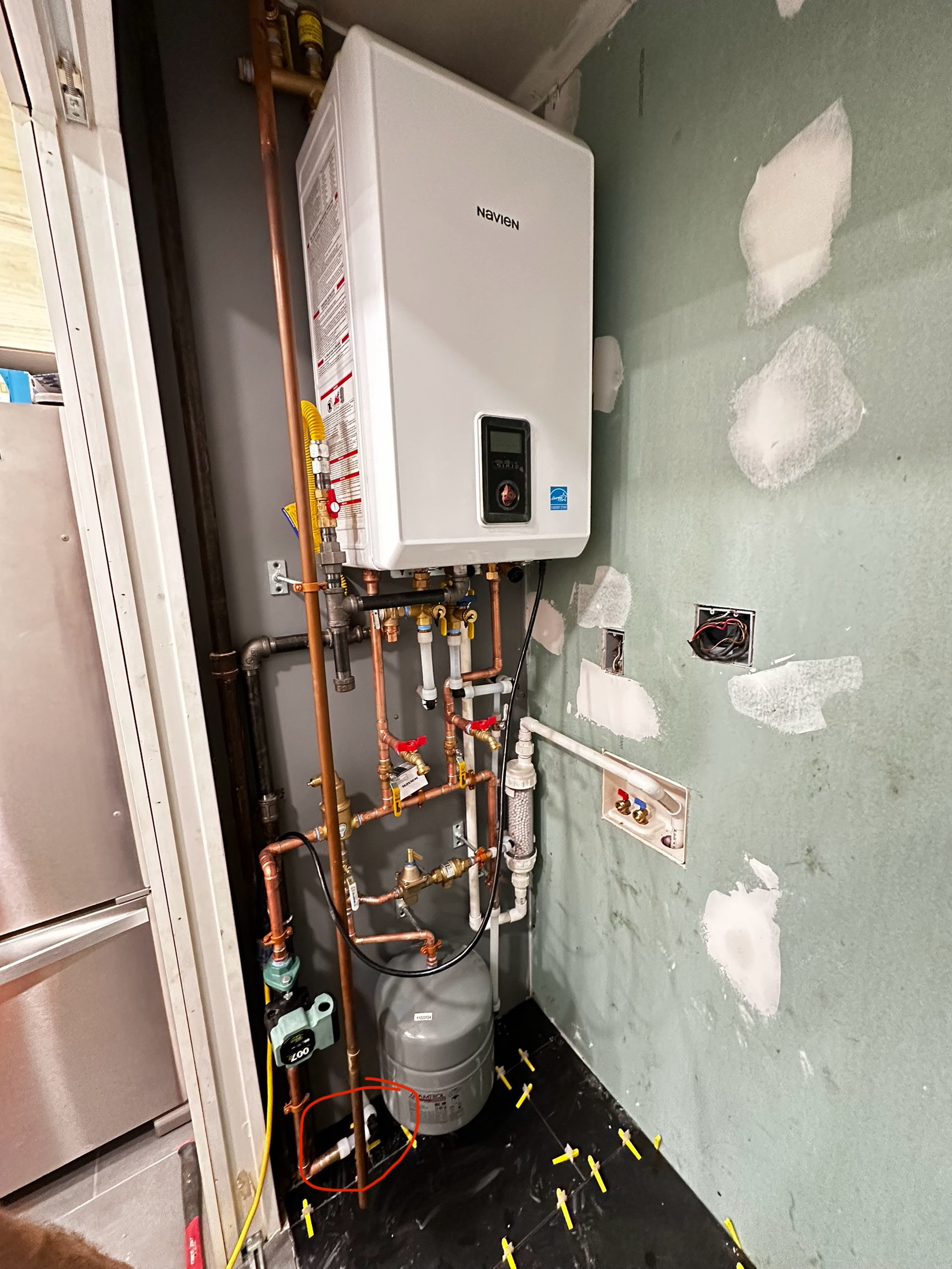

Plumber installed navien ncb-h 240-110h combi boiler and I’m trying to figure out how to connect taco 007e pump to combi boiler and connect ecobee thermostat essential so I can turn on the baseboard heating. I don’t have any split zones, it’s just one pump that circulates around a small house. I also have nest thermostat, but reading online that it is difficult to connect two together, but people say ecobee is much easier. Please help me to figure it out.
Lost the install manual already? That's not good. There are on-line copies.
There are also wiring diagrams in the Appendix
Page 43. Thermostat all three wires (Ecobee or NEST) I would probably use Zone 1.
Page 43. Circulator
Has this all been done ?
One Pipe System2 -
thanks for the confirmation, I have the manual, just wanted to hear from the pros that this is what I was thinking on how to connect the wires to prevent any issues.
