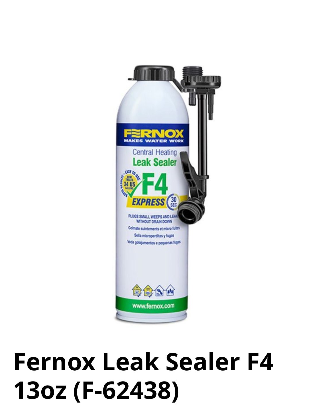

My boiler seems to have a small leak somewhere, no water is coming out, but I have to periodically add water, it's an old Burnham boiler and hot water baseboard system, no rads/no steam so should not be losing water. Honestly not sure if the boiler itself is leaking or if there is a leak in the pipes under the house (no crawlspace, the house sits on a concrete foundation and the boiler pipes go into it so I would even know if it's leaking there... So, I want to try adding a couple quarts of Hercules boiler liquid to see if it helps. Per instructions it says the boiler must be hot when product is added. So I am thinking, I'll have to run it up to temp, then drain enough to remove safety valve and add the product, reinstall the valve and refill with fresh water. The problem is that I will be adding cold fresh water as the boiler is not hooked up to a hot water feed, but cold water. I'm worried if I do that on a hot boiler, I will crack it... Any thoughts on this? Also I read some people add the product by injecting through the drain hose using a pump. How would I do that, I don't mind buying a pump if that will make the job easier and less likely to cause a cracked boiler... Thank you all.

    you might look at the squirt cans, screw it onto a hose connection tightly before you pull the trigger
