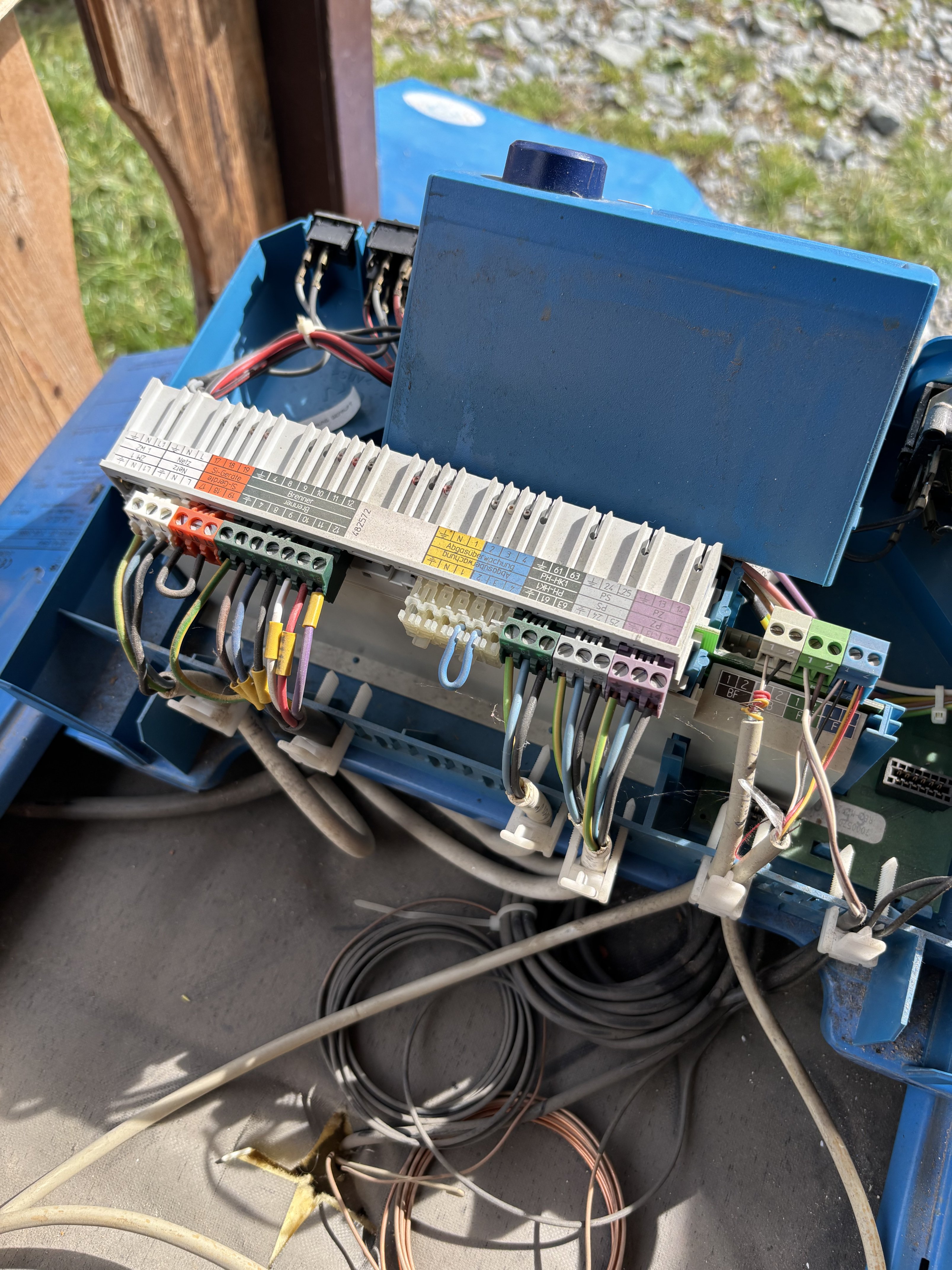

i have a oil heater duderus g115 and i dont have the book and the wire thermostate diagram … someone can help me ?

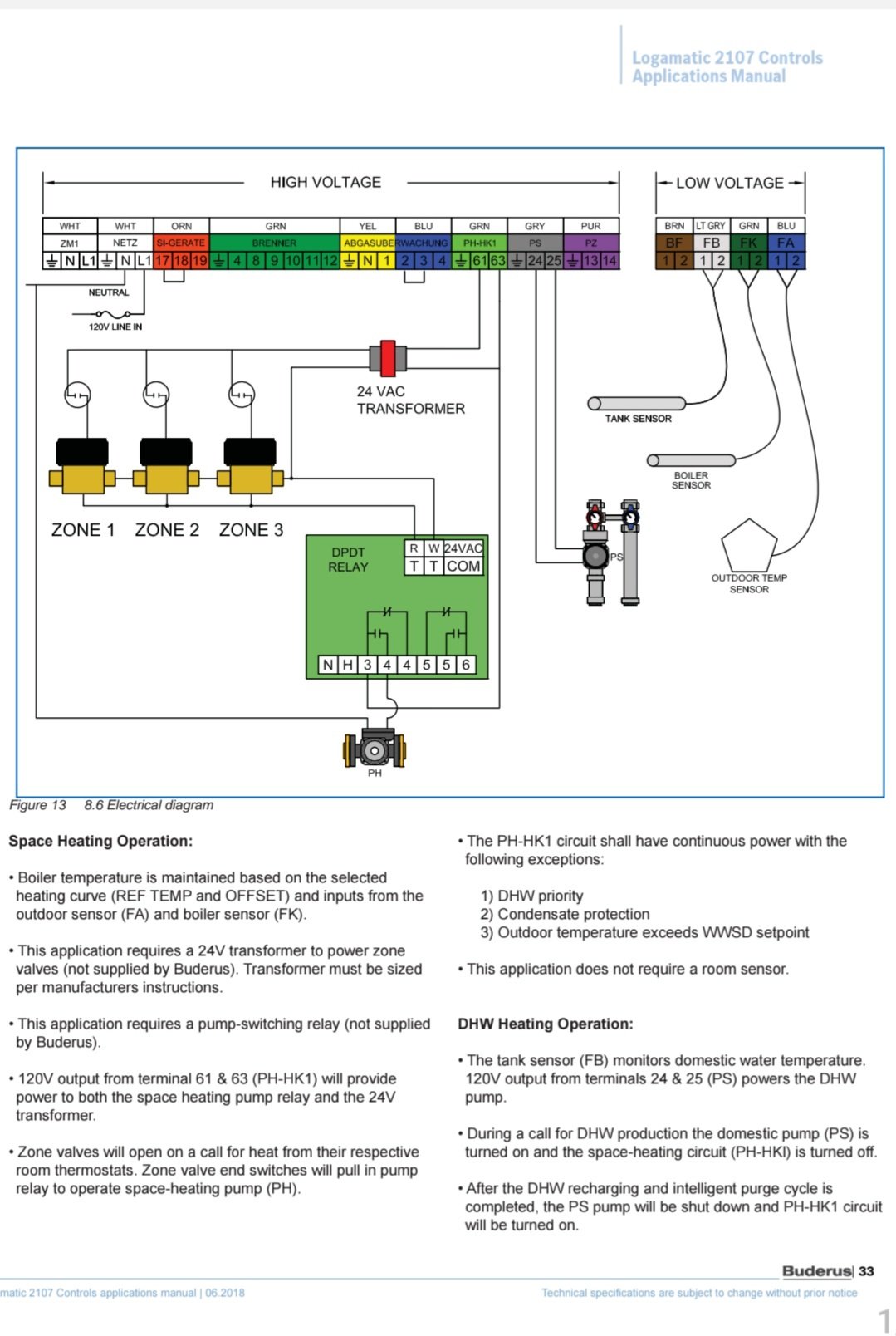

What is PH-HK1 connected to? 63 is 120v. 61 is neutral. As long as its not a 230v European Logomatic. But that terminal block is for the space heating control circuit. These systems were designed for constant circulation.
This is one example.
Download the 2107 Installation and Service manual. You're going to need it.
Don't get confused with a Buderus room sensor ,which connects to that wiring block .. Normally the thermostat is run to a circulator relay ..
