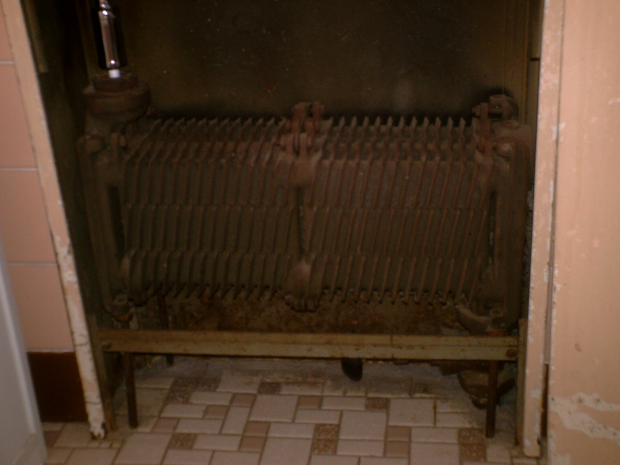

    Can’t find one small enough to fit in the closet the original radiator is in, mattmia2.

    Have a picture of the old radiator?

    Horse stall heater?
    mattmia2 Member Posts: 17,906
    that's a convector cabinet. you could put a modern convector element in there although it will heat and cool faster than the original element so it may not balance well with the rest of the system. someone that deals in used radiators probably has a similar convector element. You could probably stack several pieces of baseray in there.
  • bburd
    bburd Member Posts: 1,324
    edited November 2025
    That is a cast-iron convector element. @mattmia2 is correct about the balance problem if you replace it with a much lighter weight copper or steel fin tube element.
    You might be able to find something similar used, or replace the whole thing with something like a Sunrad recessed cast-iron radiator/ convector.
