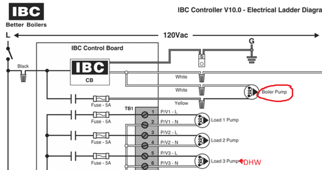

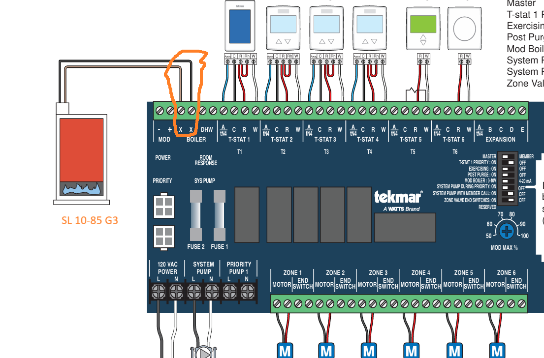

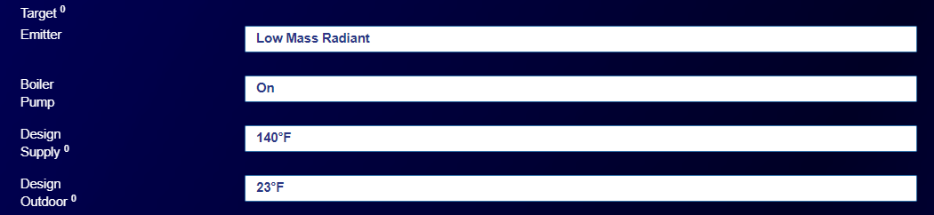

    Our house is seven-zoned with only 2700sq ft. Two are less than 200sqft each. OR is in use always.
    2-piped buffer has actually been installed, but never explored the option of letting buffer's water temp dictate boiler's firing (which I think is a better approach as hot_rod alluded and not by room thermostats that we are doing).
    I realize this IBC can do that since I can view buffer's temp. as well as with this setup. Just not sure if I need to disconnect Tekmar's XX terminal to the boiler or doesn't hurt to leave it?

    If the buffer tank does not have its own temperature sensor (or aquastat) in the tank and you disconnect the XX there is nothing to activate the boiler. You could try and see what happens. Just shut off the power when working with the wires, don't want any accidents.
    I suspect presently the XX to the boiler stimulates the boiler's water circulation so the boiler's sensors see the water temperatures of the buffer tank since the water is moving. By disconnecting the XX there is no demand to start the boiler or the boiler's circulator.
    I don't believe the boiler will randomly or even a scheduled event of turning on the circulator to sample water temperatures away from the boiler with the boiler's temperature sensors.
    I assume your system has two circulators but you never know.
    If this is the only circulator in the system then you presently need demand from a zone to run the circulator and start the boiler with the XX.

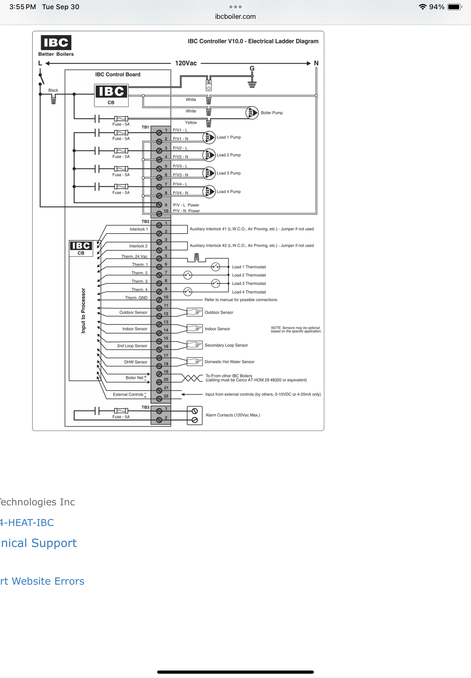

    I can trace back to where the Tekmar's XX wire connects to the boiler as shown above.

  • Great! Thanks very much for your response hot_rod and everyone's feedbacks, I understand it now, and in my case I do not have to use XX end switch on the Tekmar.

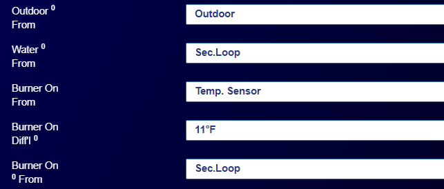

    The sensor is in the buffer which the boiler looks at and it shows the water temp in it on the portal. I hope the IBC setup I have posted earlier should do it on the buffer control side.
    I need to run the buffer temp a bit higher due to the type of emitter we have.

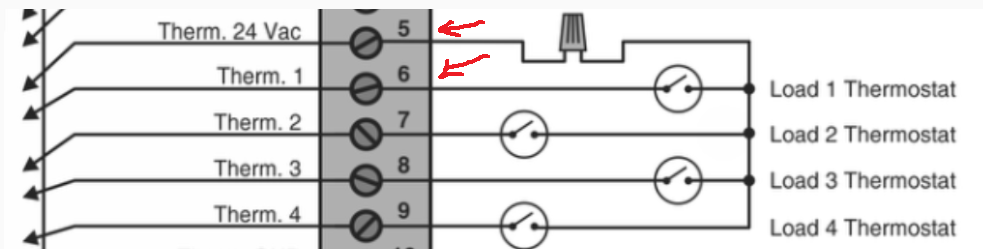

    109A_5 Posts: 4,759
    This is wrong and makes no sense, trace it again.

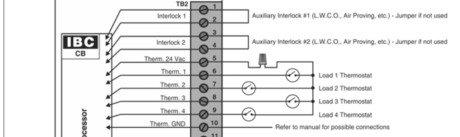

    If I had to guess, the terminals 9 &10 probably supplies the 120 VAC power to the Tekmar 306V. It is not connected to the XX.
    I would expect the XX to be connected to one of the Thermostat inputs, Load 1 through Load 4 .
    I'd venture to say with the system wired the way it presently is, if you disconnect the XX you will have no heat. DHW would probably still work.

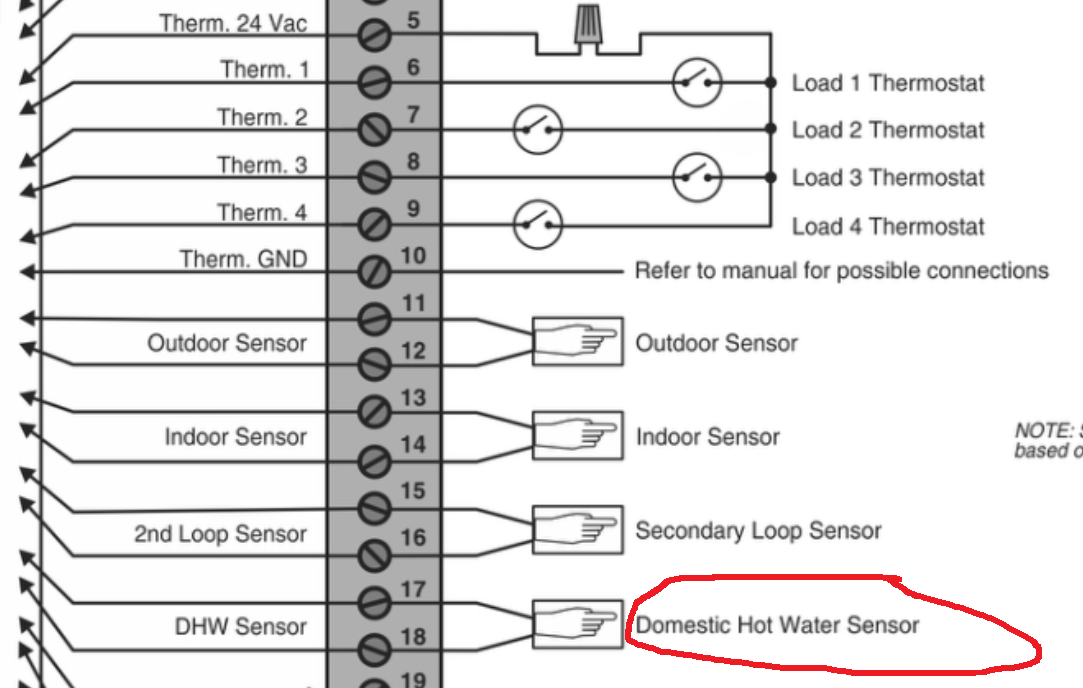

    How is your DHW managed ?
    What controls the DHW circulator ?
  • 109A_5, the dedicated DHW circulator is wired here as a separate Load #3 under priority and all set up in the boiler's control on this DHW load

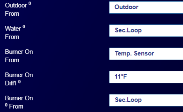

    Since you say the sensor is in the buffer tank, if the boiler can be configured so that sensor can be the demand stimulus it should work with the XX disconnected.
    I find the manual very vague in this situation maybe there is another manual or I did not find the right paragraph.
  • Agree, 109A_5, there is actually nothing about third-party control option in the manual when you have more than 4 zones with 4 thermostats than what's allowed on the connection/wiring board in the boiler.
    This should be the demand stimulus upon IBC's setup on its controller on buffer tank. They refer it as the "Secondary Loop". And "Temp. Sensor" is the buffer's temp sensor.

    I also could not find the association between the DHW sensor and in your case 'Load 3 Pump' or any circulator. Other than the boiler "runs a smart DHW routine". So it may search for a temperature change and electronically store the Pump that stimulated the DHW sensor appropriately.

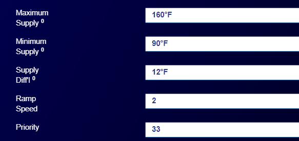

    Five years after installation, just wanted to change the control logic to let the buffer controls the burner and not the room thermostats to turn on the boiler whenever there is a call.
    I think boiler control is all set up to do that as posted and wired the system pump to 306V but don't want to pull the trigger by setting the Summer Shutdown (SS) real low and boiler not running until I understand how the XX connection works without damaging anything.
    But I can risk it to increase the SS temp to try and let the XX connect as currently is.

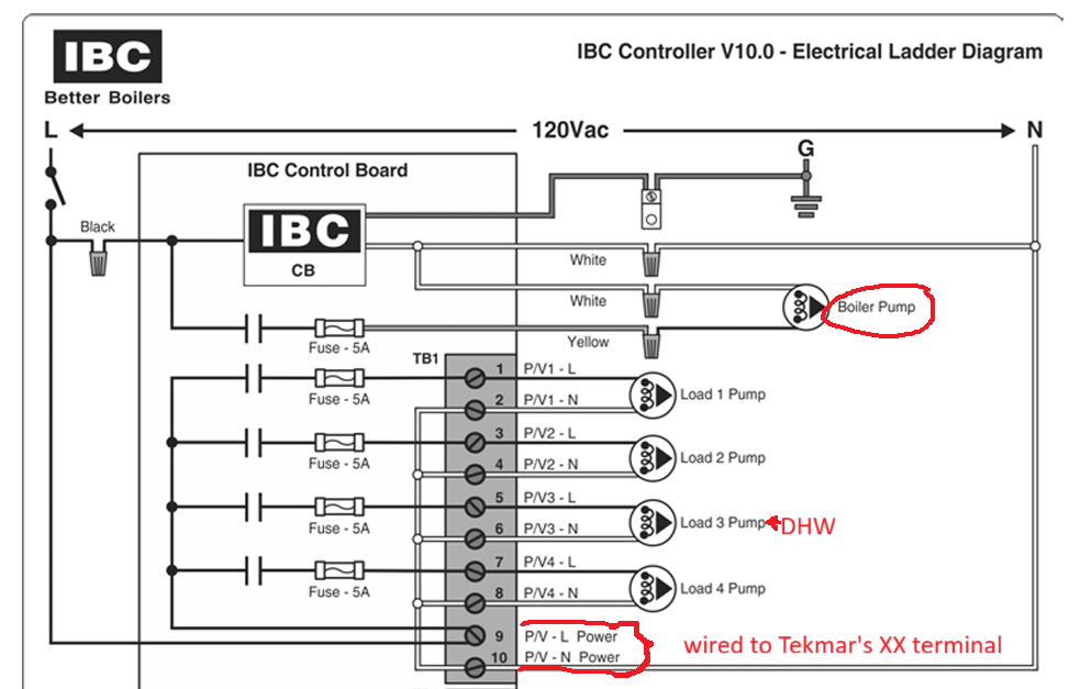

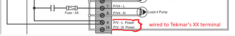

    Yes I believe that, which is why I believe your annotation of the place the XX wires are connected to the boiler is incorrect. I would think they (the XX) would go to one of the Thermostat input connections.
    hot_rod
  • Bingo! 109A_5 . You are right on! Ran down to the crawlspace last night and retraced the XX wires from Tekmar 306V and indeed the wires are connecting in the boiler here off the control board:
    Didn't do anything then, but after work today, I am going to disconnect off either here or off 306V and watch how the buffer tank controls the boiler.
