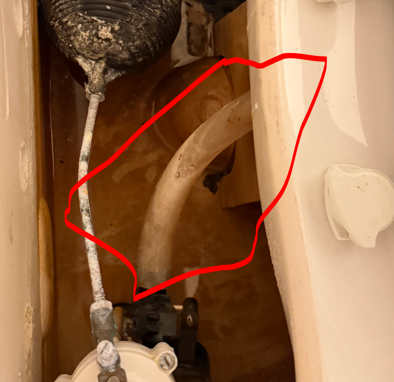

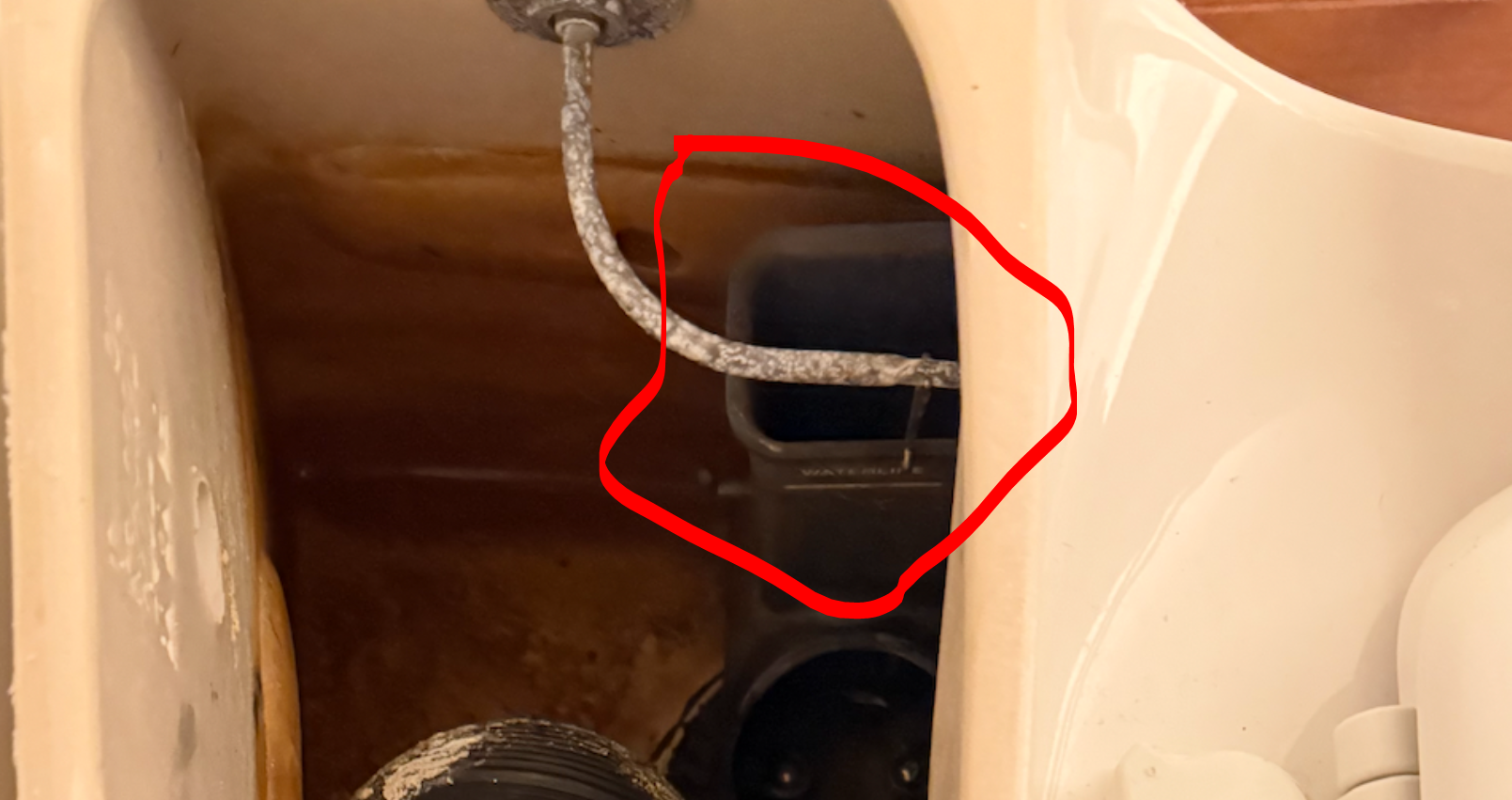

  • I attached a pic of another angle I took a couple days ago. actually I don't know where the overflow tube is in this pic?

    Doesn't look like the water is up to the top of the overflow. Replace the flapper first. If that doesn't solve the problem, it's the flush valve gasket.

    Was it running in to the bowl when that picture was taken? If it isn't an anti syphon ballcock it will syphon water from the tank in to the bowl if the refill tube is jammed too far in to the overflow tube(or it looks like it goes in to a notch in the china on this model).
    This is the overflow
    this is the bowl refill tube
    if the flush valve gasket is leaking it will still leak after you turn the water off and flush it because the gasket will be under that inch or so of water in the bottom of the tank. That does not look like it is fun to replace. looks like it involves a spud wrench under essentially where the seat is mounted.

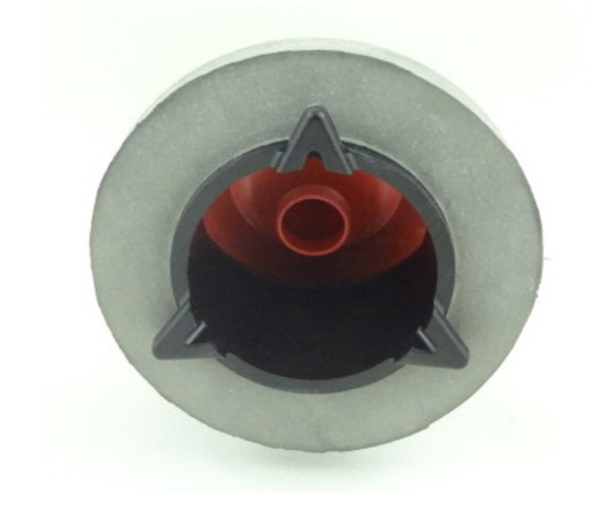

    you could hire a plumber to replace the flush valve assembly too although you'd have to make sure they do know how to work on one piece toilets, that they don't get confused by what they see. i'd replace the fill valve while i was in there too.(if it was one of the coast brass ones i'd definitely rebuild it, but the plastic ones are nothing special).
    the flush valve is at least plastic so it won't be all frozen together or you can break it apart if it is.

    It looks like either there are some screws in through the flapper seat or it just snaps in
    this is the bottom of it. looks pretty easy to replace. if it is screws get an 18" ling screwdriver
    that gasket looks soft and spongy and prone to rotting out after a decade or 2.

    they said if they turn the water off the tank drains on its own to below the level of the seat of the flush valve. that means that big fluffy foam gasket under the flush valve is leaking
