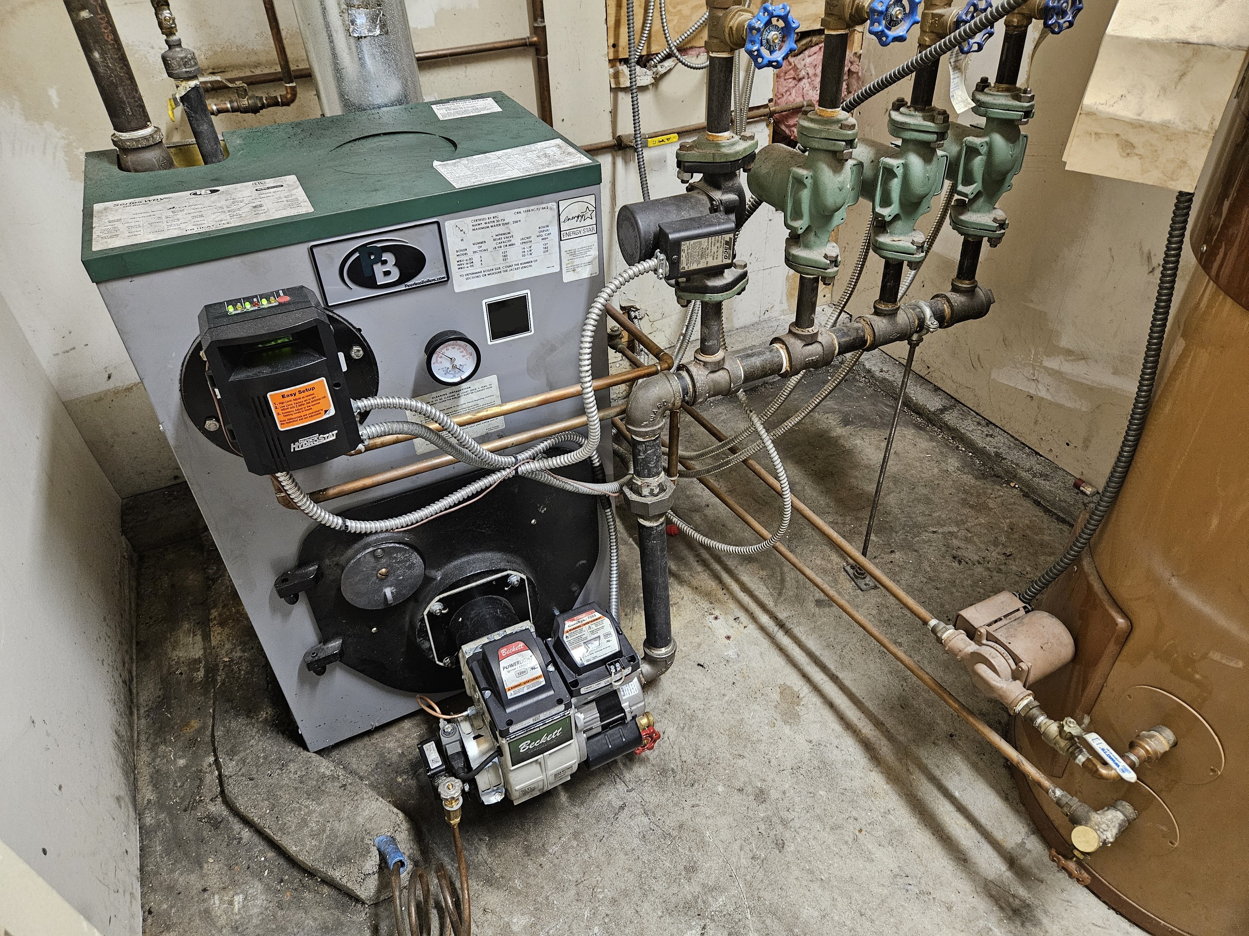

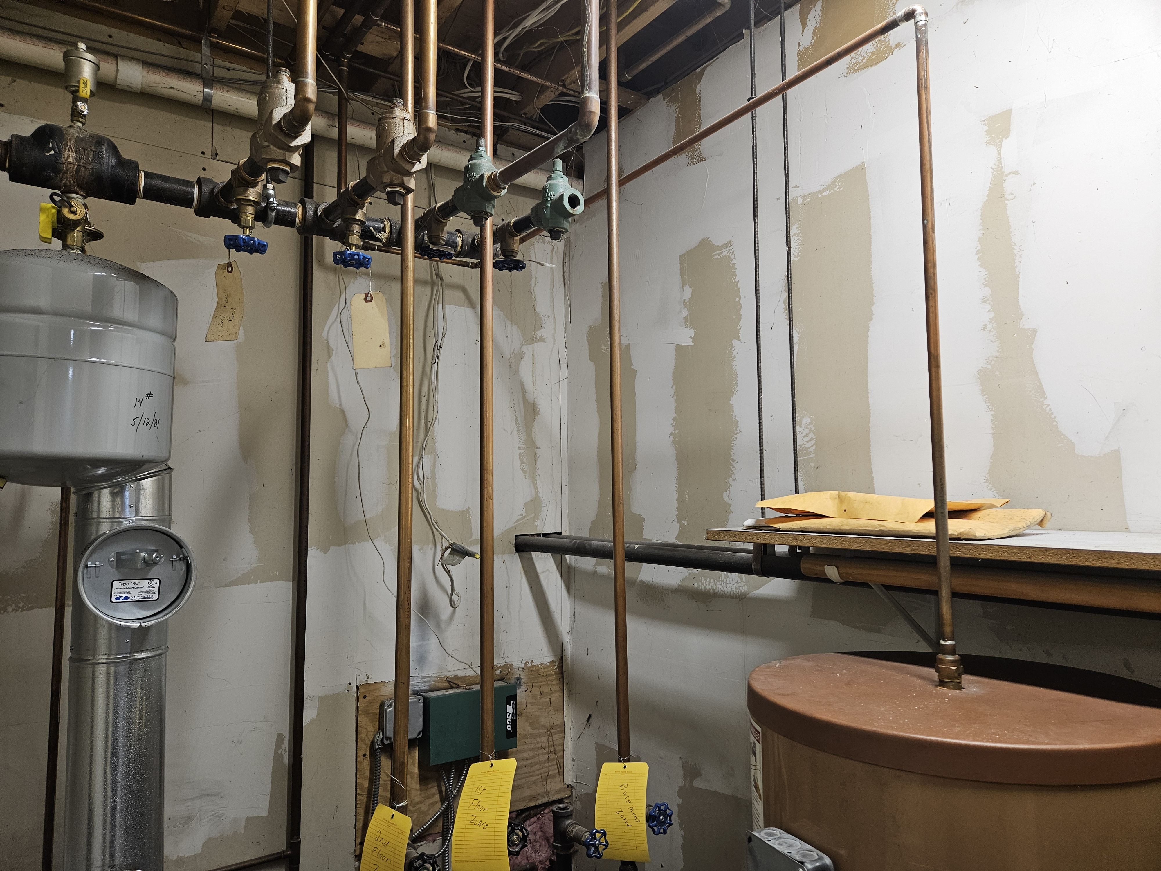

Just moved into a new place, and have a question about this setup. It looks they've got a coil feeding a storage tank, and my question is why? We had a tankless coil in my last house, and it provided limitless hot water, so I'm curious what the need for a tank is?

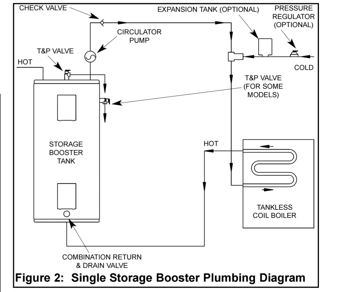

    Aquabooster is the name of your hot water system . It's a step up from just running a coil . The coil will deliver constant hot water if the flow rate though the coil is under a certain rate with the same incoming temperature of fresh water . The water that heats up the coil is also used for heating the home. Durning the winter the water enters the house is cooler and boiler water is sent out to heat the home . The tank will give you storage for good even temperature hot water and volume for a shower..

  • Some tankless coils are less efficient, depending on the water quality, the older they get. You may have a coil that needs a cleaning.

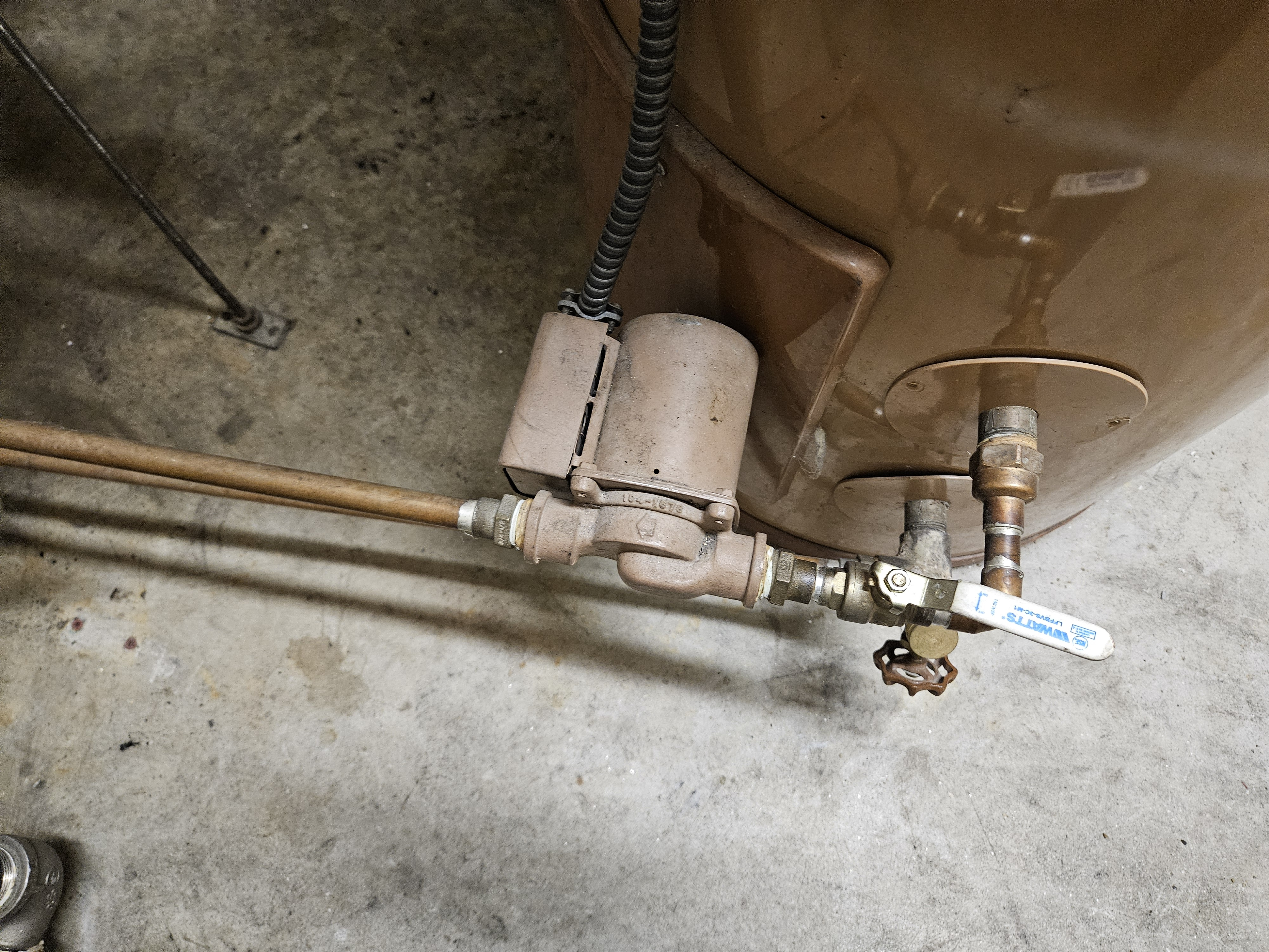

    2nd question... Why does my tank only have 3 connections and not 4?

  • I piped the from the tankless coil to the cold water inlet then from the drain valve port I put a brass Tee fitting so I could put the drain valve back and have a place to pipe to the circulator and from the circulator to the cold inlet of the tankless coil. That way the heat from the boiler entered at about 6" from the bottom and exited to the bottom drain valve opening. this put all the hot water at the bottom. That way gravity would do the job of letting the hot water rise to the top. I'm not sure that is the best way to pipe that design, but it worked for my customer.
    The reason for only three tappings on your tank is that you have something we used to call a "range boiler". they would be piped to a coil that was installed in a coal furnace or coal steam boiler and would absorb heat from the coal then thermo-syphon to the tank. The center taping is for a control well in the event you might have a circulator pump moving the water.

    There are a few different way to pipe an aqua booster , with pros and cons .
    Three pipes yes , the third ..(middle) pipe with the circulator, pumps out toward the coil and the return heated water is using the cold water pipe back to the tank. From what I can see…

    HVACNUT Posts: 7,784
    This...
    is why only 3 ports on the Aquabooster. Better than a tankless by itself. Worse than an indirect with cold start, or another more efficient means of DHW.

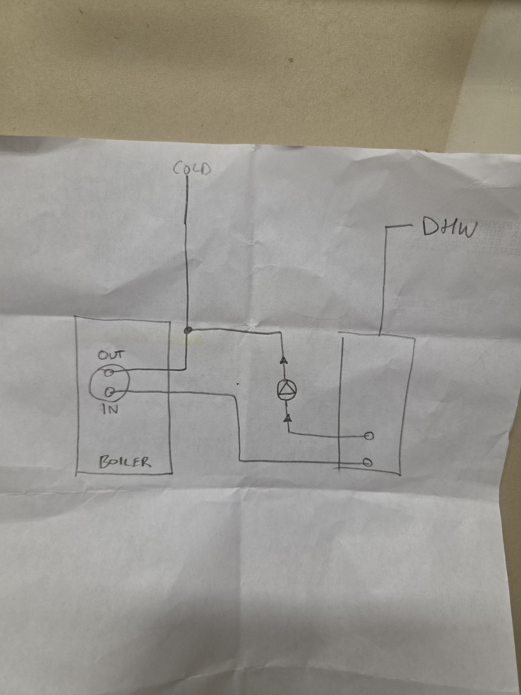

  • Just noticed that the plumbing is backwards on the coil. The coil is stamped with IN and OUT, and it's hooked up wrong. Does this matter for the copper loop that is the coil?
    Also, I'm going to be re-doing this piping to clean up the floor area a bit. I want the coil / DHW loop as short as possible (for heat loss reasons), yes?

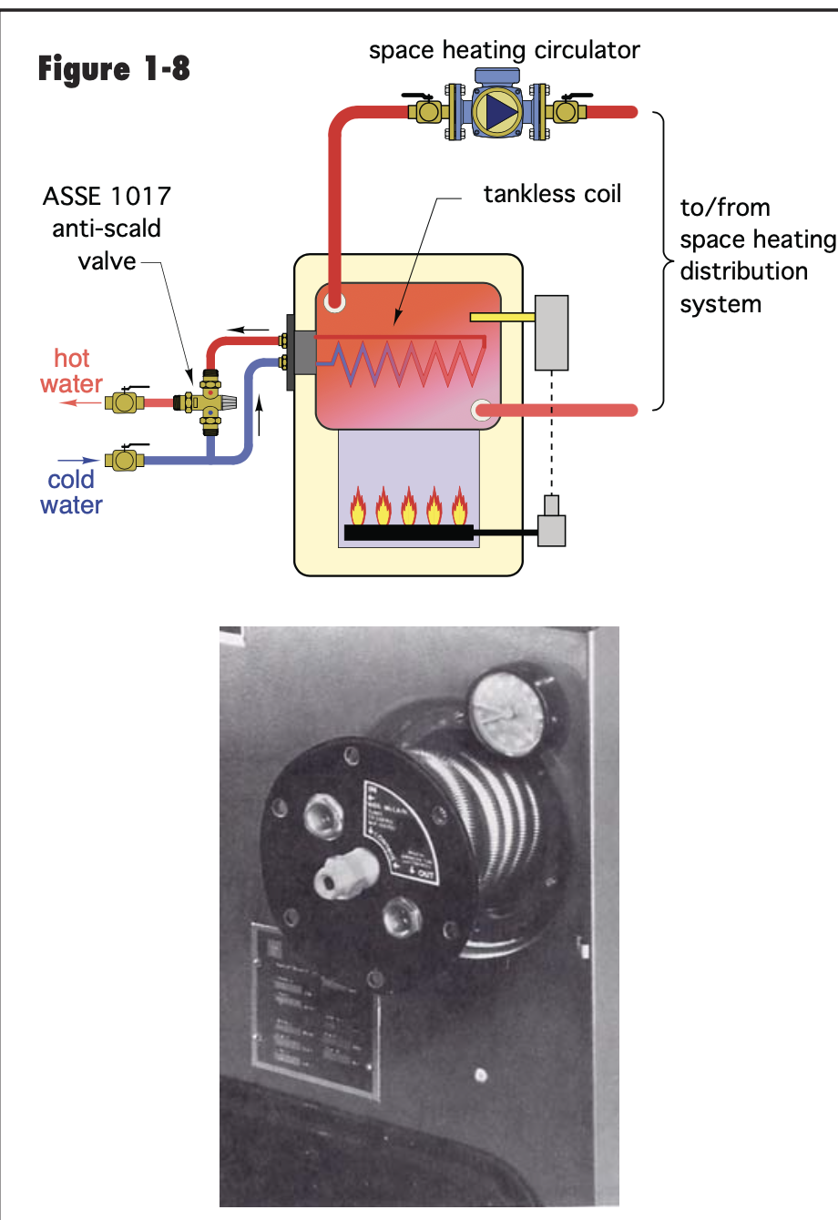

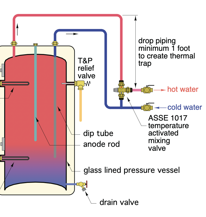

    hot_rod Posts: 28,699
    Them options for using a mix valve, first pic shows a mix valve right at the tankless coil, use only a listed ASSE 1017 valve.
    If you are heating a tank, install the mix valve at the tank outlet, let the tank temperature be controlled by an aquastat. If you want or need more DHW, raise the tank temperature. The mix valve will regulate the DHW regardless of how hot you run the tank.
    If the thermostatic valve you use is supplied with check valves, no need for the thermal drop. And add a thermal expansion tank on the cold supply.
    Add isolation valves at the mix valve, it will need to be de-limed ocassionally depending on your waters hardness.
