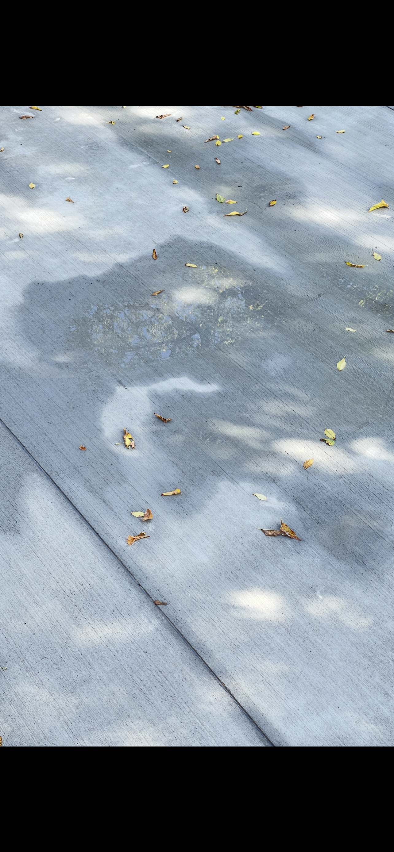

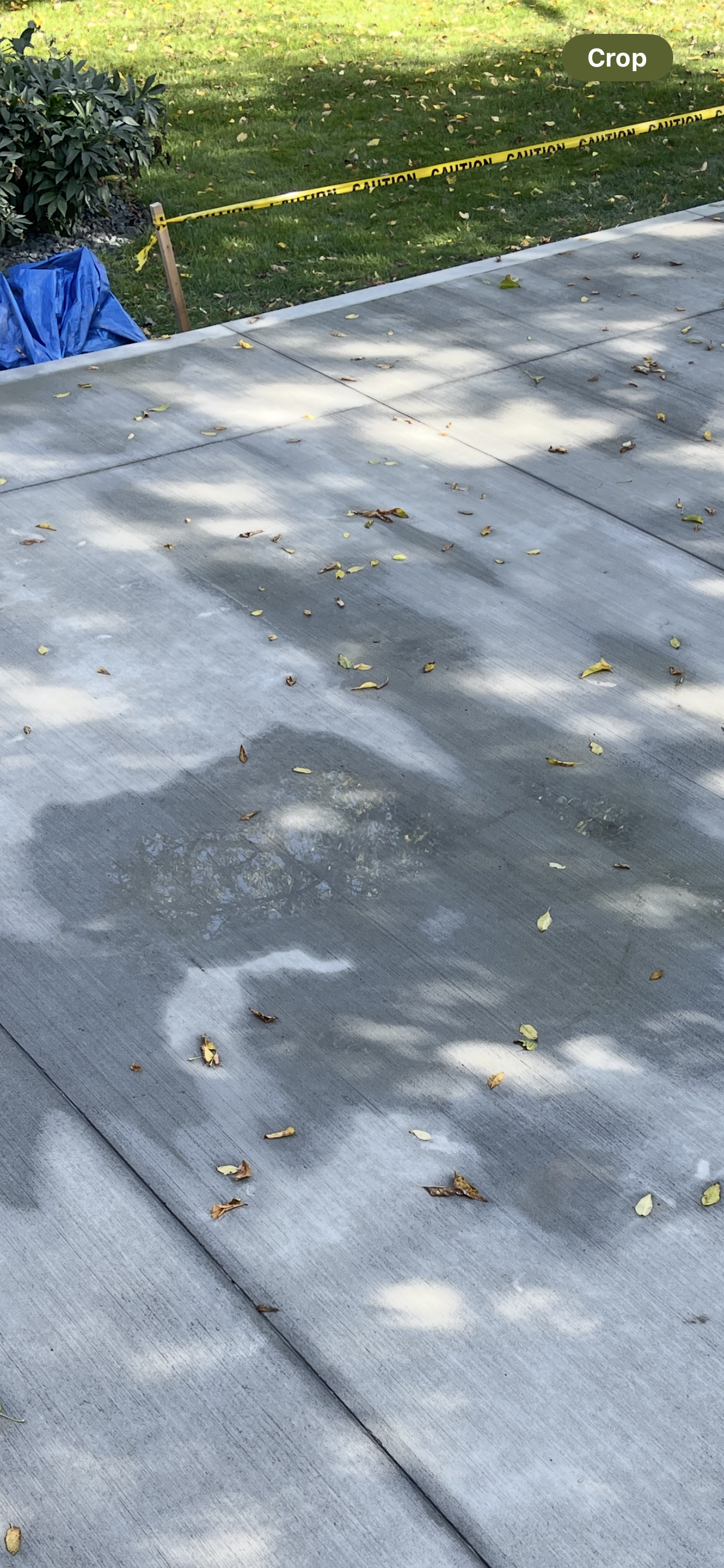

Hi there,
I am a home owner who hired the most expensive contractor with the best rating in my city. The project was for him to prep for the driveway/pour/finish and for me to install insulation/PEX tubing for a heated driveway. Roughly 1200sqft
Today, while they were watering the saw cuts dust away, I started seen water pooling on a low spot towards the middle of the driveway. It is between 1/8 and 1/4 deep.
The heated system won’t be running all the time and unless I let it run for much longer, the water will stay there and refreeze again.
Will that low spot be an issue and could damage the driveway with the heat/freezing cycles? Should this be fixed? Any ideas on how to fix it?
Contractor looked at the pictures and says it not a lot of water…he still needs to come have a look at it in person.
Thanks
Oops
someone didn't do a good job screeding that first time.
yes it takes additional energy to evaporate that pool of water. And yes any puddle not drained or evaporated will freeze
A 1/4” low spot across a 10’ wide pour?
Unfortunately there is not an easy fix with tube in the slab
