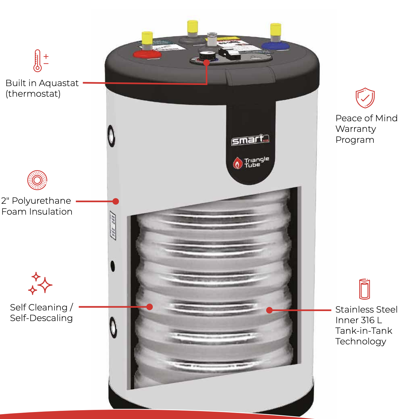

got a triangle tube phase three smart40 that I got off a job so it doesn't owe me anything. it purportedly leaked although I never saw the leaking installation, but I put it in as a heatexchanger next to an old snowman with straight high low connections to the boiler water external 'tank' that is carbon steel (as opposed to inner tank stainless steel) that has high and low side taps. so it circulates boiler water thermally and i've got infloor radiant running off the interior stainless tank (that radiant is from before the daze of oxygen barrier, indeed some of it is from before the days of pex, its polybeautiful).
so ten years to my installation I noticed leaking around the upper nipple from the boiler last year. the connection is above the low water level for the boiler and it was minor so I just let it be til the end of the season but getting ready for next season. I was worried that the black nipple right attached to the top tank tapping that showed the most corrosion might have rotter through; but upon disassembly it still had enough integrity to back out of the pipe threads in the tank in one piece, can't really tell if it has a leaking path through the corrosion. guess I could set up a test but I'm going to replace it anyway. at first blush i'm tempted to stainless or brass but that would potentially force corrosion toward the tank which might itself have the pinhole near this tapping already, or toward the steel nipples in the short run to the boiler.
hindsight being 50/50 i'm thinking an annode would have been smart but because the entry is tangent to the tank from the side there is only maybe 3/4 of an inch before you would hit the stainless inner tank so i'm wondering if there is annode style that I could use in this case, perhaps in/as the first pipe nipple? i see various powered annodes as well but they mostly seem to still have a form factor for some insertion into the tank. I supposed if one of those had a flexible probe I could slide that between the inner and outer tank walls through the tapping.
on the one hand it is handy that the corrosion is happening closer to or in the indirect tank so I am less worried about any corrosion on the boiler end of these short lines that could hazard my ability to connect. and maybe this is occuring because of the stainless tank? and that is always going to be proximate to the carbon steel outer shell of the phase three tank. getting to wonder on a tank that retails notably over a grand why they wouldn't just make the outer shell stainless also . . . yeah, might add a few hundred more but if I were actually buying one instead of repurposing stuff I collect on the job I'd prefer to protect the investment and there doesn't seem to be a good annode option in that design.
of course there isn't even a drain for the inner tank, i had to pump that out so I could twist the unit to work on it once loose. but putting a drain with a tee into the inner tank still wouldn't really solve getting an annode into the fluid of the boiler side jacket. maybe a top connection that goes down into the outer jacket would provide for annode installation. not really sure if annode has to be, or preferably would be, in the boiler fluid or if installing an annode into the inner tank radiant floor fluid siude would attract the dissimilar metals corrosion away from the outer tank anyway.
couple of weeks b4 i gotta have the heat working so I'm just weighing what materials to use to put it back together. thanks, brian

  • So to be clear you have this tank and it is connected to the boiler with carbon steel and iron pipes and fittings Correct? The inner SS tank is connected to a floor piping system with no oxygen barrier Correct?
    Where is the corroding pipe nipple you are concerned about? On the top tapping that enters the inner tank? That all needs to be non-ferrous metal along with non-ferrous  pumps and accessories.  That is because the PEX and “Polybeautiful” pipes are allowing oxygen migration into the stainless tank with the ferrous metal nipple.
    OR …is it on one of the side tappings that connect to the closed system where the boiler water is? That should not need any special non-ferrous piping

    He said the corrosion is happening on a side port. Even the "sausages" anode wouldn't work. I think the newest TT tanks now DO have both inner and outer tanks as stainless steel.

    @EdTheHeaterMan its side port as @psb75 noted. the circuit with pex and polybutyl radiant is all non-ferrous near boiler piping. the area where I am experiencing leaking is the top side tapping. as of yet I don't know for sure if it is the first nipple that exhibits a significant corrosion on the outside or the tank immediately adjacent to where the female pipe tapping is welded on.
    this hyrdronic circuit receives actual boiler water from the cast iron steam boiler and the upper and lower tapping on the TT were particularly convenient to come straight off a couple tappins on the boiler for thermal circulation. now that water doesn't have lots of exchange but I do use some makeup water and of course there is air over the water in the boiler so I would imagine you would get some dissolved oxygen when the water is sitting and not heating. But the circuit it is entirely steel and cast iron excepting that this water flows over the outside of the stainless tank in the TT indirect. So there has been very modest ubiquitous corrosion as you see inside a steam system but nothing leaking and the boiler is maybe 75 or 80 years old. whereas this nipply displayed distinctively different extent of corrosion. i wish I had taken a picture b4 I took it apart but I'll see if I can line up the pieces although i've knocked some scale off the nipple looking to see if I could detect a crack or pinhole, which i couldn't.
    so my first inclination was to put a stainless or brass nipple in place and put it back together, but then I thought that if this is for some reason the focus of galvanic corrosion in this system–perhaps being the hottest water connection located the closest to the stainless, i.e. the only significantly dissimilar metal in that boiler water loop–I would likely just be moving the focus a little rather than eliminating the problem. so maybe I should just put a new steel nipple in, but I got wondering if there were a flexible or compact annode I could also install.
    would be nice if both tanks on news ones are stainless as @psb75 is thinking. I could surely come by another used tank to take me through another 10 years but the placement and spacing of the tappings is particularly convenient to this installation to the point where I might justify buying another TT if I thought I was getting more of a lifetime tank. Although the pic from the sell sheet pic ed posted notes a stainless inner tank stainless but doesn't mention the outer tank making me think it is not stainless, but not sure how old those promotionals are.

    @archibald tuttle said "this hyrdronic circuit receives actual boiler water from the cast iron steam boiler"
    Their in lies the rub…. Steam boiler water is an open system, therefore lending itself to constant oxygen infusion into the boiler water. That nipple may have been made of material that is less resistant to the perils of oxidation lending itself to a greater instance of corrosion that other parts of the hydronic system. Or perhaps that was the only fitting that rendered a small leak to allow the rust to make itself visible on the exterior of the pipe whilst the rest of the wet portion of the system has only interior signs of rust and corrosion. This is typical of steam boiler systems below the water line. Perhaps a boiler water treatment plan can be implemented to retard the corrosion process, as is done on many steam boiler systems.
