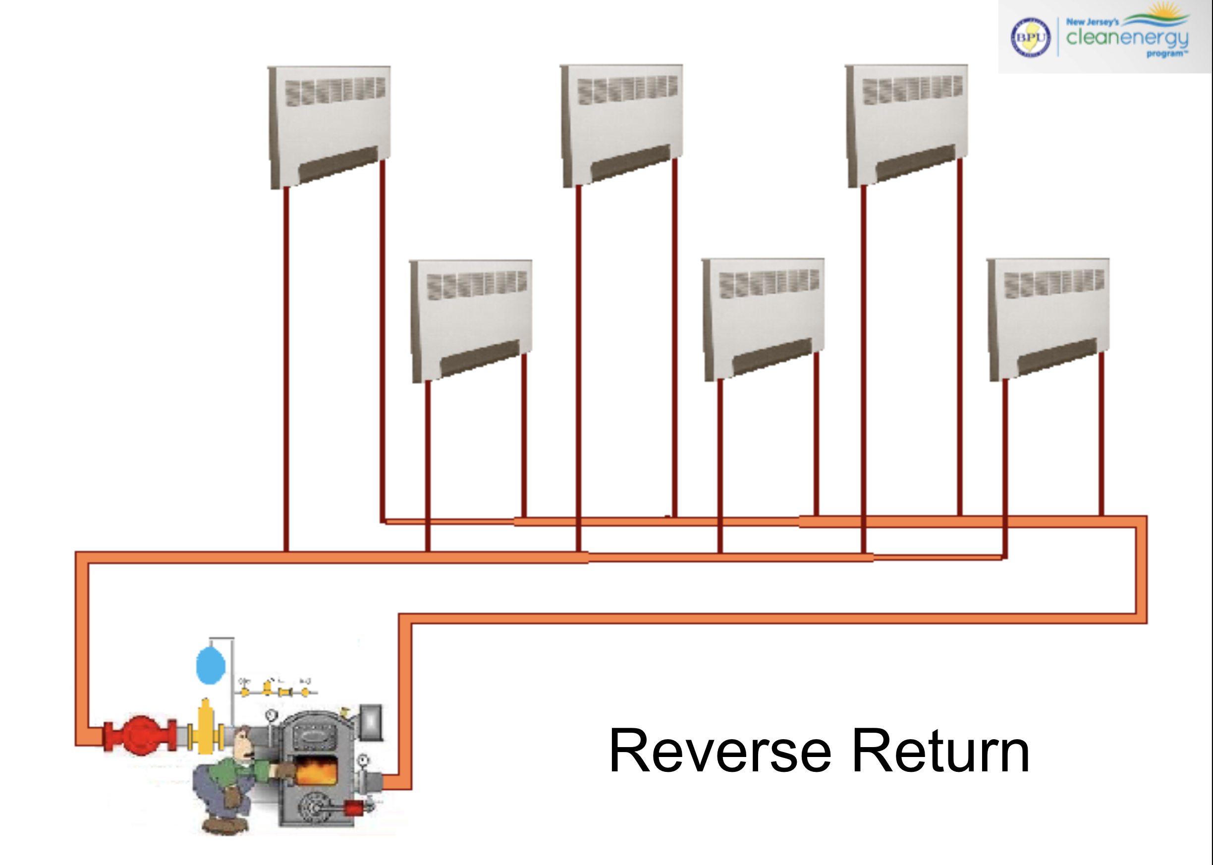

    I have been in your situation so I would recommend the following:
    • Try to get your customer to agree to a less expensive radiator like euro panel radiators
    • Once you have the radiators selected, do a room by room heat loss calculation and select the proper size radiator for each room.
      • They will most likely be in the same location as the previous radiator but a little smaller
    • Determine the riser and return pipe size for each radiator
      • Since the old system was most likely gravity and the new system will be using a circulator the pipe sizes will be smaller
    • The least amount of piping work will be to use a Reverse Return parallel design.  That looks like this: Screenshot 2025-09-20 at 4.37.27 PM.png
    • You start at the boiler with 1” or 1¼” copper, depending BTU requirements of the zone.
      • 1” piping will move 80,000 BTU of heat to the radiators.
    • You can then select the pump required to move that much water thru the radiators.
    • At some point you can use a common return for both zones and increase the shared piping as required

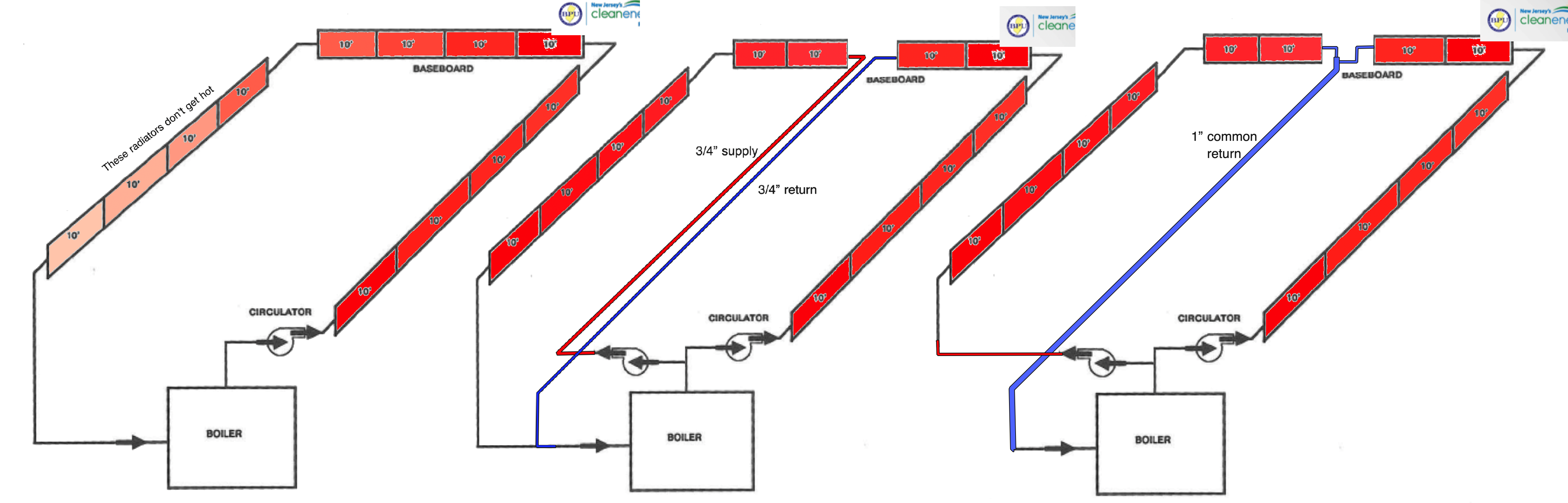

    These steps will keep your cost down so you don't need to spend more $$$ on oversized pipes and extra pipe runs that will be doing the same job right next to each other.  Example below:
    You can see in the first diagram on the left there is not enough heat in 3/4" copper to get all the baseboards hot
    You can fix this with two zones as illustrated in the center diagram, with two sets of ¾” copper running the length of the house to accomplish this task.
    The left diagram is a less labor and less material cost is illustrated by using a 1” copper shared return from the far side of the house.
