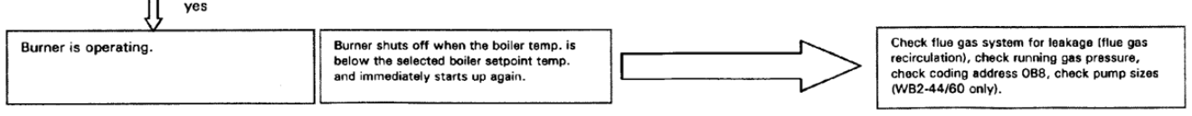

hello all I am having a problem where the boiler starts ,lights up,and shuts down right away
This will happen a few times and then it will light
There are no codes but viessmann manual says this symptom is due to flue gas system leaking
I have cleaned out in between radial heat exchanger with tool and flushed thoroughly with water
There is not a glue gas smell
Any help would be appreciated

    Fuel pressure ?

  • follow up on my viessmann
    Turned out to be the gas valve
    Fortunately I bought a complete used boiler for $550 and had the spare part
    Thanks for the help

    Thanks for the feedback. With changing the Gas Valve you may want to have it checked with a combustion analyzer.
  • probably a good idea before I changed gas valve I changed the lgm29 board thinking that was the problem the board works but I notice it more short cycles itself to reach boiler temp limits and dhw settings
    With original board in it would crank out on max to reach these settings now it kinda short cycles its way to the settings
    I may put original lgm29 back it to see if behaves as it use to
    I rember that I did not Mach up dip switch settings on replacement board so maybe that’s the problem
    But am super happy it’s working now

    The donor control board may have been configured differently (DIP Switches and electronically stored parameters).

    this is the instlal sheet that would come with a replacement lgm29
    https://www.viessmann-us.com/content/dam/public-brands/ca/pdfs/doc/wb2_rep/vitodens_200_lgm29.pdf/_jcr_content/renditions/original./vitodens_200_lgm29.pdf
    I am pretty sure they still had an older form of what they call lambda pro today, on those boilers. so the gas valve is most likely non-adjustable. but you would want to make sure both units were set to the same fuel type. Also there is a water pressure sensor inside the unit which can shut it down if water pressure is too low.
