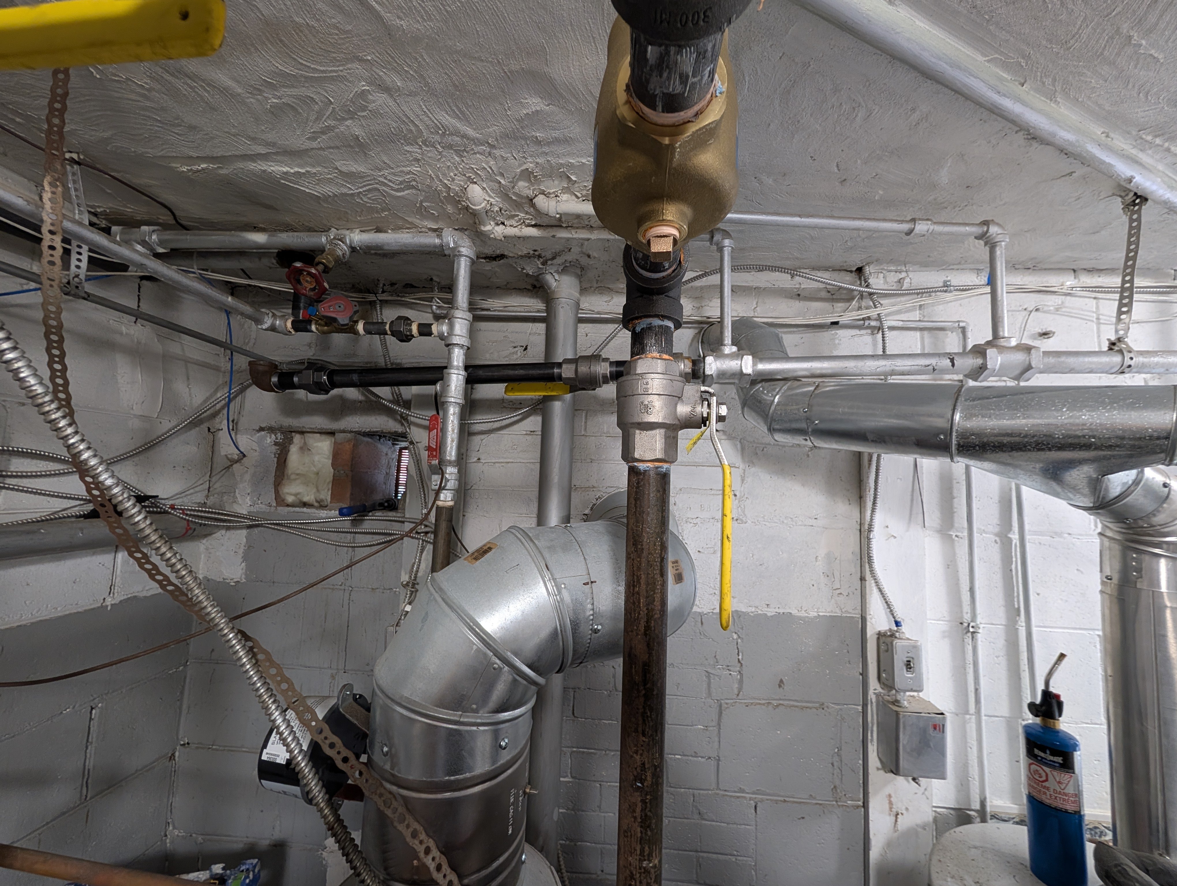

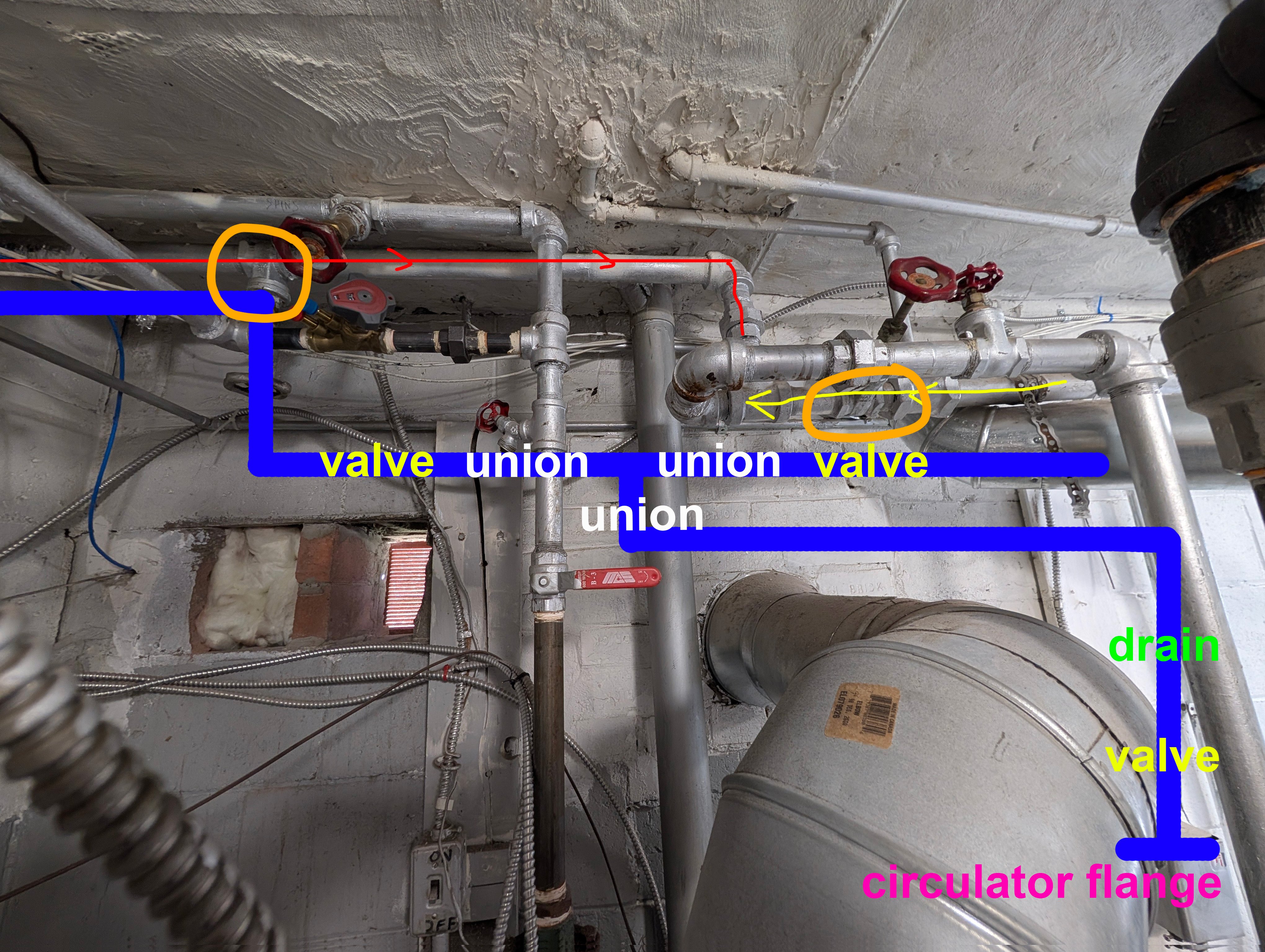

Finally got around to replacing bad gate valves that isolate two monoflo returns to allow individual purging.
I have minimal experience, does this look like a decent way to do it to make it easier changing those valves in the future or should i keep it as it was? Open to suggestions.
Biggest problem is that the slopes on return marked RED and the return marked YELLOW are different, no easy fix for that without additional fittings which aren't good for monoflo. Somehow they were able to connect everything though.

    I would use ball valves for the replacement of those valves so you can balance the system with them. The gate valves I guess were just isolation valves.
    You can use copper for the replacement, it doesn't have to be black iron, be a lot easier to do all those fittings in copper although black unions and nipples for the final connections to the system will be cheaper than copper unions.

    1. Both of those (circled orange) gate valve are bad, one has a detached gate, both leaking from the stem.
    2. I didn't know monoflo cannot be purged but not surprised. However, it DOES work in practice to some extent with my 70psi city water supply, at least to get rid of some airlocks from the main in this system, and certainly to clear out some built up magnetite.
    3. The two returns are not 100% balanced, will tinker with it with new working valves.
    So i want to replace the valves, and re pipe it in a way i can replace the valves in the future or just keep it the way it was if you guys think it was fine.

    I am doing it with black steel. My hole place is schedule 80 iron. I can't solder larger copper well, and don't have a press tool. I do have a threader and a tristand.
    Already took the old stuff off, it was seized completely, had to notch and cut off the valves.
    Already got Apollo stainless ball valves for a great price.
    Progress picture (just checking alignment using random parts)

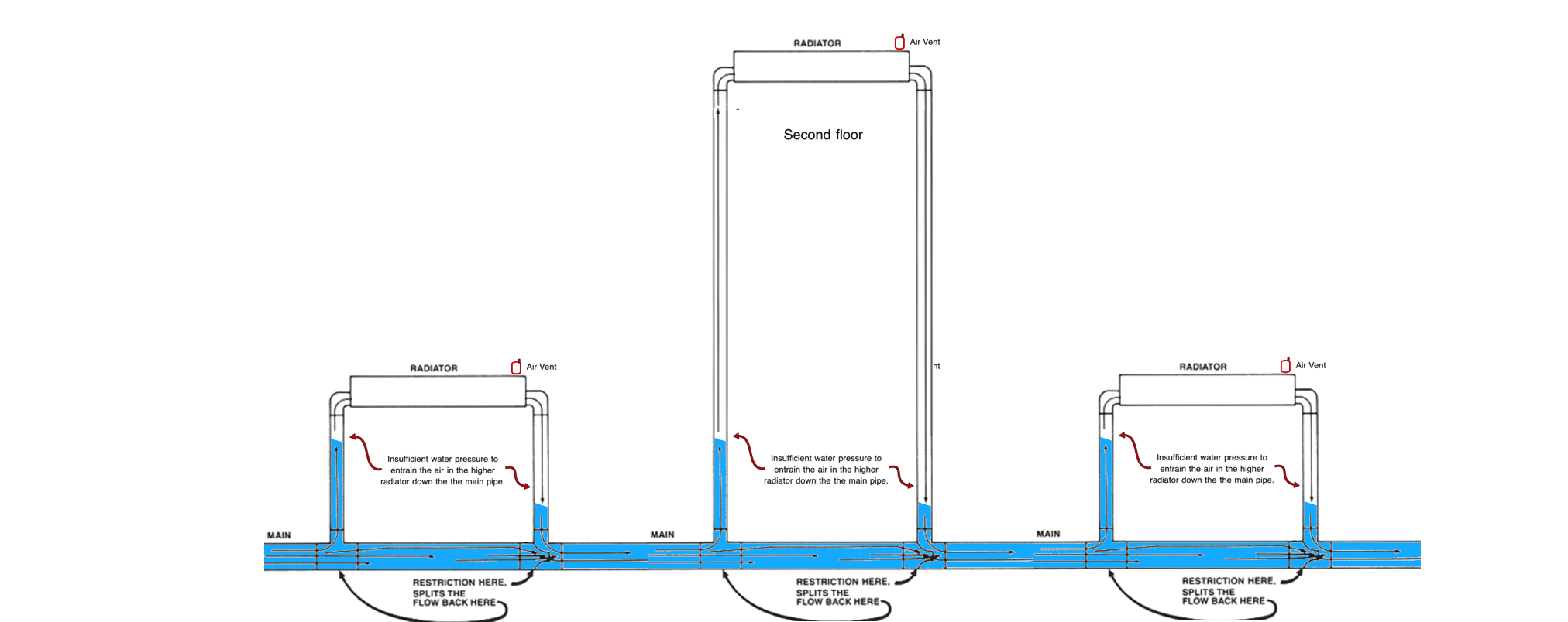

  • This is what purging might look like in your Monoflo® system:
    You will be able to get air out of the main pipe however the risers, especially to the second floor,
    will be impossible to PURGE…. they must be VENTED.
  • Ball valves are a great choice for replacing those old gate valves. Remember to exercise them a few times a year to keep them usable in the future. If you are using them as balancing valves then mark the spot where the handle is after you get the system balanced. One should be 100% open and the other restricted (partially closed) at the point when both returns get hot water back from the supply within a few seconds of each other. It's not rocket surgery, so don't stress on geting it exact. 15 to 30 seconds from the time loop "A" returns hot from the time when loop "B" returns hot is good enough for government work. So it should be good enough for you.

    This is a point that @DanHolohan mentions in his story about how the book Pumping away came to be. Dan states that our work is dirty and we want to stay away from the clean white walls and white convector covers upstairs. By pumping away from the expansion tank and raising the pressure, and letting the pump run at the higher pressure to get more air dissolved in the water, you may be able to avoid going upstairs to vent convectors in a MonoFlo® system.  My experience has been mixed.  I needed to vent the convectors on systems that were not piped as instructed in the Pumping Away seminar I attended, and the book I purchased.  But when it is piped just as Dan explained, the system purged the air itself over a 24 to 48 hour period of constant pump operation and cycling the burner only on the thermostat. It only worked on a single floor system.  If the radiator risers went to the second floor, I needed to vent the radiator.
    You need to understand that when purging, you are causing the air bubbles to be pushed by the velocity of the water through the pipes in order to force the air bubbles to flow downward against the force of gravity.  When using Pumping away to remove air, the air actually gets dissolved in the water due to the higher pressure and lower temperature of the water.  This is Boyle's Law of dissolved gasses.  Think of it like relative humidity in reverse.  The air molecules actually dissolve in the water, just like water vapor is dissolved in the air all around us.  Temperature and pressure make the amount of air that water can hold change. Just like temperature and pressure change the amount of water vapor the air can hold.  That water is invisible until the temperature drops below the due point and we can see the water vapor as fog.  You can see the water but you can't fill a glass of water with it.  It just floats there as micro droplets of water.
    The air in the water when pumping away gets absorbed in the radiators and then when the boiler heats the water and the pump inlet’s low pressure acts on that water, the air leave the hot water as micro bubbles. (fog in reverse) But that air will just get redissolved again, unless you have some way to separate those micro bubbles from the water before they get to the pump and get pushed back into the higher pressure of the discharge side of the pump.  That is what the different air scoops and air separators do.  This process is using the physics of water to remove the air and it is not instant.  Purging and venting is instant.   It may take several hours or several days depending on the flow rate and the amount of air you are trying to remove using the pumping away idea.   I can guarantee you, the you will need to vent any radiator that has very long risers from the basement to an upper floor.  Pumping away will take too long to do this center radiator on the second floor.

    The way you drew it is fine. I would put a vent at the end of each monoflow return before the ball valve (vent upstream). You will be able to get the air out of the main. Then venting up at the radiation will be less

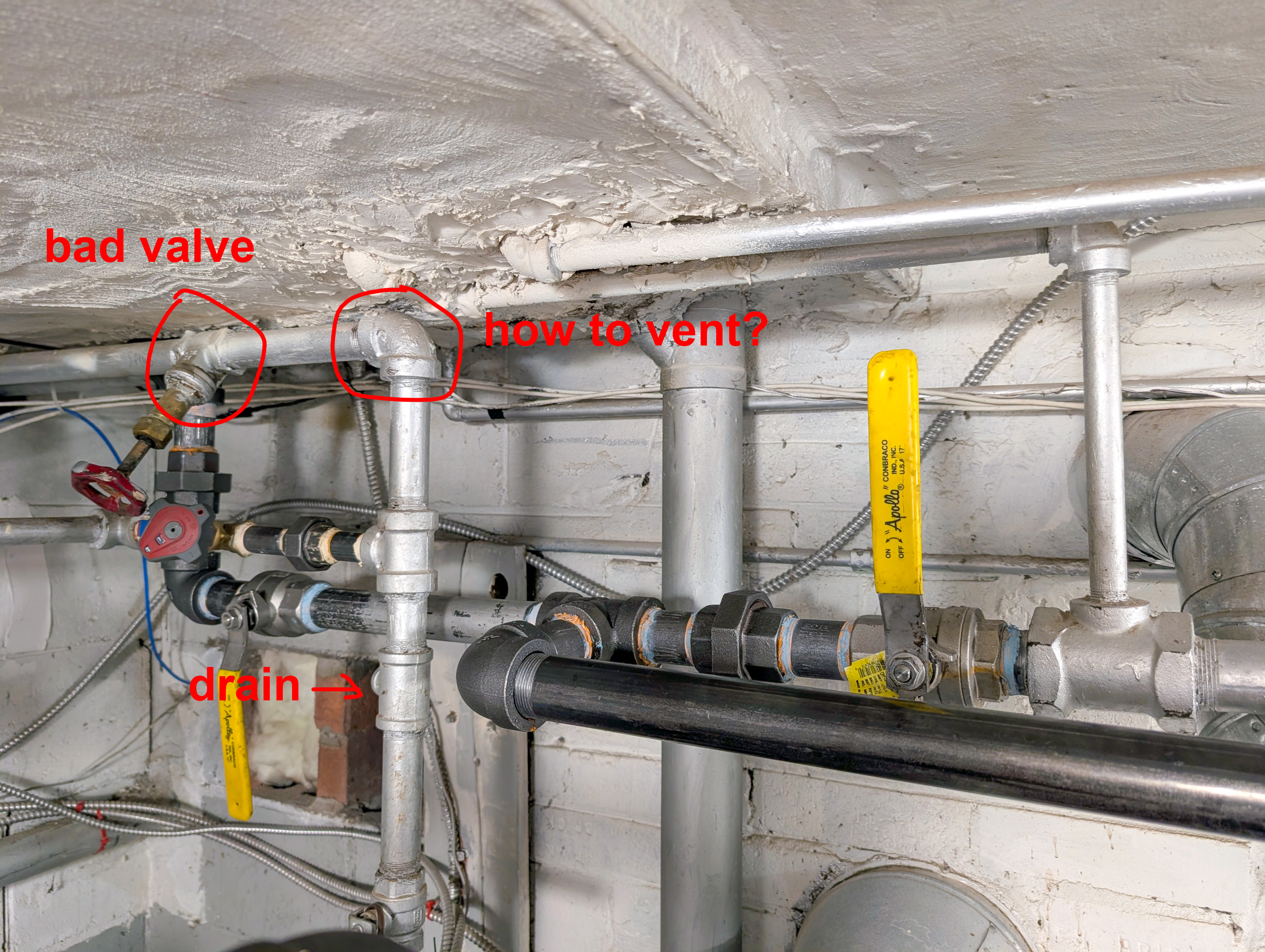

    want to do a bit more work on the return feeding basement rads,
    a valve there is also bad and it really needs a vent at the end of the run, but no way to add it, because if the ceiling.
    anyone has any ideas how to do it?
    a horizontally oriented hygroscopic vent would fit, but not sure if it would be effective enough that way.
    Use a tee and a manual vent or boiler drain. Are all the emitters on that section below the main or does it go down before it goes up to emitters? If you put in purge valves you can purge the main. you'll still have to manually vent each emitter but you should be ale to purge he air out of the main to deal with thing like offsets that go up then back down and things like that.

    That return only serves emitters that are below it.
    Anytime the system is drained and refilled that line is air locked, purging it through the drain shown on the picture pushes the air out.
    Should I not even bother with a manual vent if I have to do it manually anyway?

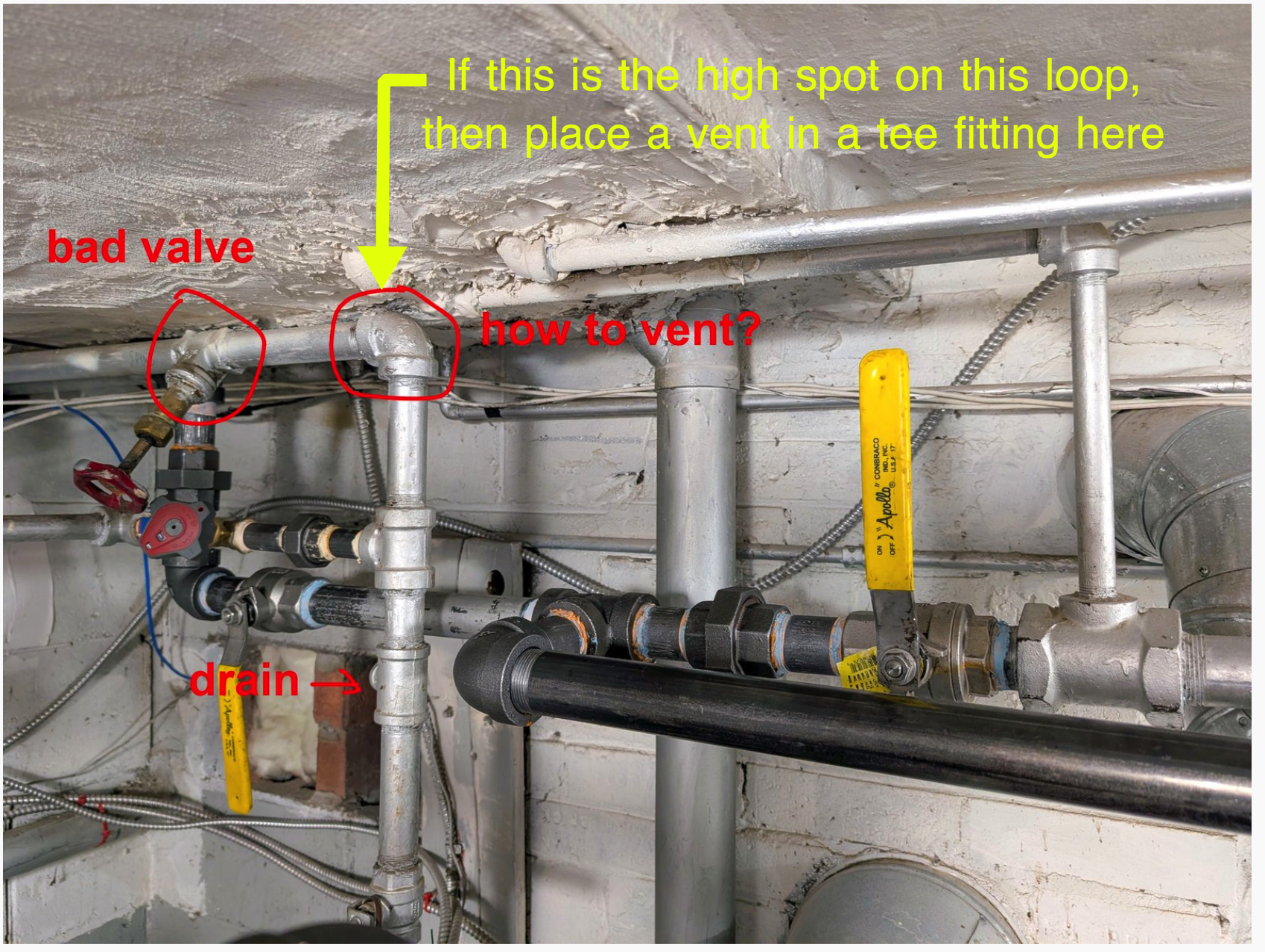

    EdTheHeaterMan Posts: 12,948
    edited September 2025
    You mentioned that this is a high spot on the loop and all the radiators fed by this pipe are on the basement floor. You need to get the air out initially so place an air vent in a tee fitting that you install while you have everything is apart to replace the valve.
