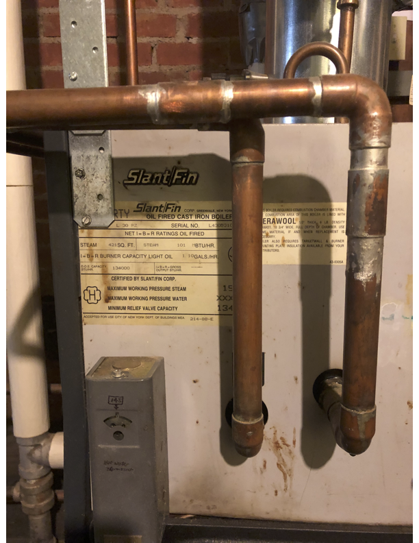

The indirect water heater is connected to the tankless coil of Slant Fin Liberty 30 steam boiler, as shown in the picture. I am going to remove the indirect water heater and put in a stand alone water heater.
The installation manual shows the tankless in relation to its inlet and outlet. Thus, draining water from the indirect’s coil cannot remove the water below the inlet/outlet level of the tankless coil. If the two vertical pipes are cut a couple of inches above the inlet/outlet and capped, whether partially filled water inside the tankless coil would be ok when the boiler is in operation?
How would you disconnect the indirect from the boiler?

    If the two copper pipes in your picture are going into a tankless coil in the boiler (looks like they do) just cut them off. no need to cap them unless the tankless coil has a leak in it.
    In fact if the coil does not leak you do not want to cap those connections as the coil could build up pressure inside it.
    To be sure can you post pictures of the indirect and the piping between the indirect and the boiler?
  • @JDE said: "How would you disconnect the indirect from the boiler?"
    Answer: Sawzall.
  • Now when you are finished using the Sawzall, you don't want to cap/plug the coil openings, or only one of the pipe connections can be capped/plugged. If you cap/plug both openings, you will produce a closed pressure vessel inside of the boiler. When the boiler makes steam and that closed pressure vessel has some leftover water in there, you may find that water will expand into steam at some point creating an over pressure situation that could cause those caps or plugs to blow off under excessive pressure. That can be quite dangerous, so leave at least one side of the tankless coil open to the atmosphere.
    If you find that the other opening starts to leak boiler water on a regular basis, that would indicate you have a hole in the coil. Said hole is allowing boiler water or steam to pass thru to the tankless coil. At that point you can cap the other opening because the tankless coil is no longer a closed vessel and is connected to the boiler system and the boiler's relief valve.

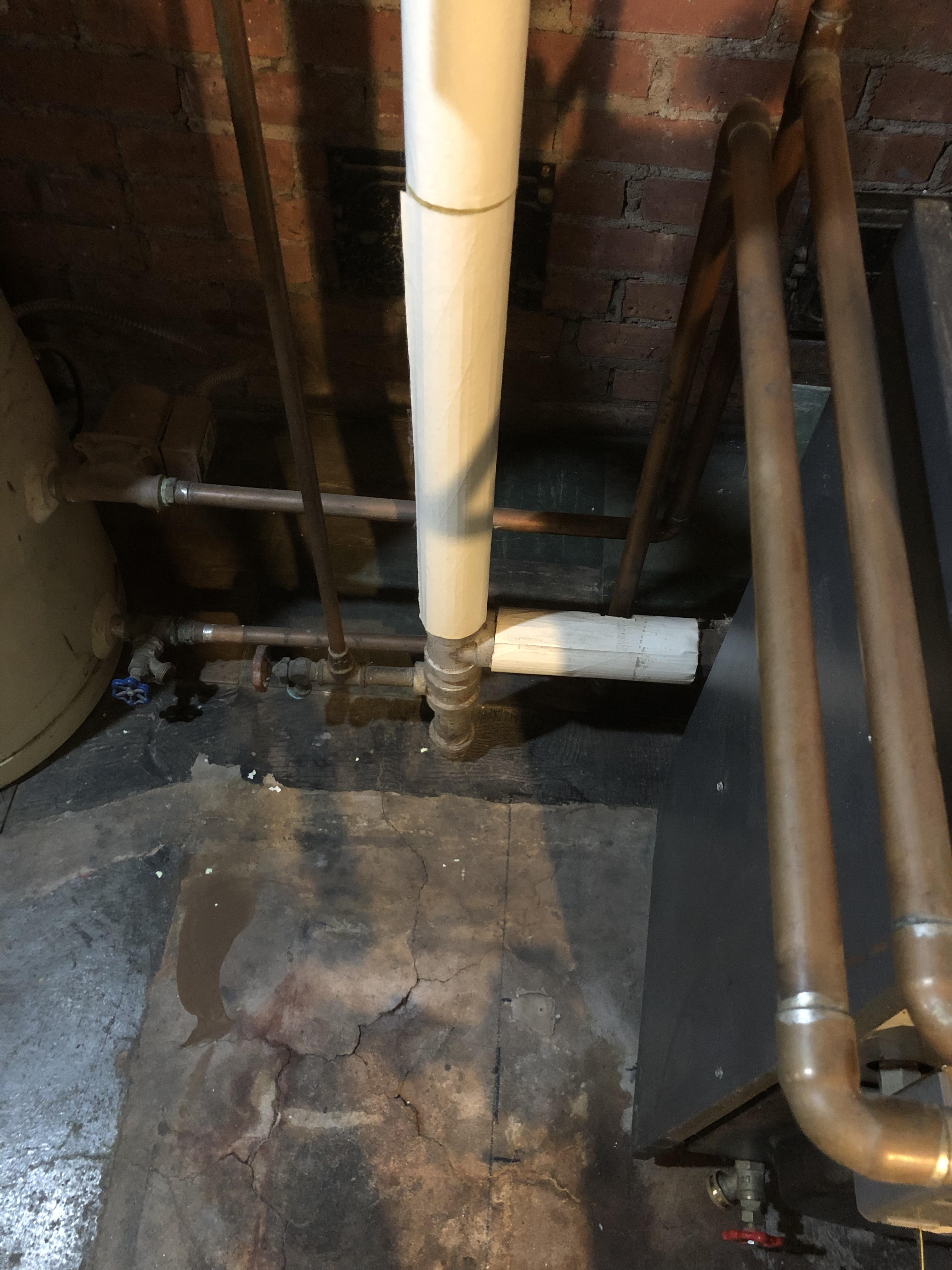

    The picture of indirect piping.
    Jack

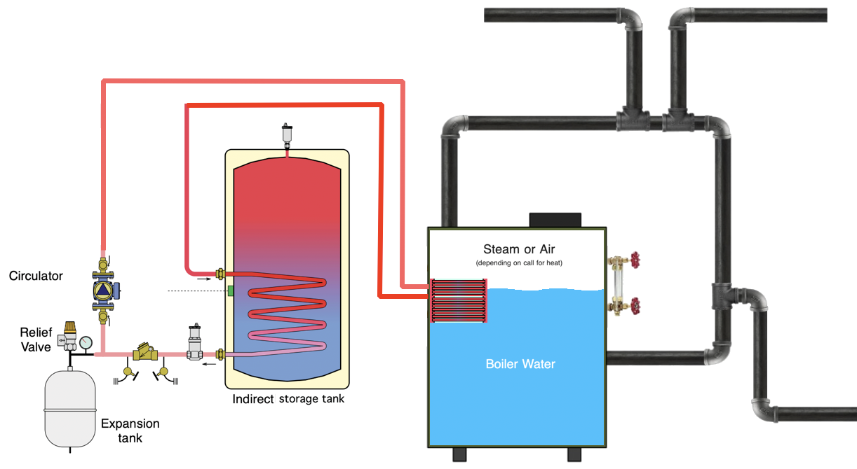

  • Looking at your piping… I don't see a circulator pump on the boiler water piping from the boiler to the indirect. Without a circulator to pump the hot water in the tankless coil, to the coil in the indirect, the recover rate for heating the indirect must be very slow. Here is a diagram of how you should pipe the tankless coil to the indirect. Missing many of those parts will cause poor performance of the water heater.
    It may be less expensive to get a circulator, relay, expansion tank, and relief valve, so the indirect can operate at full potential. It would be a shame to discard a perfectly good water heater with years of life left, just because some uninformed handyman installed the water heater wrong.
    HVACNUT Posts: 7,784
    What water is in the HX loop? It looks like a Taco 006, so is it domestic pressure in the loop, and the tank? Or is it set up like a one zone boiler at 12 psi?

    Yes, it is Taco 006, but I don’t remember what exactly follows, probably “-BT4”. The max pressure is 120 psi and the set up 10 times lower at 12 psi, if I remember correctly. Now, everything associated with the indirect water heater is gone. Tomorrow, a new gas fired water heater will arrive.

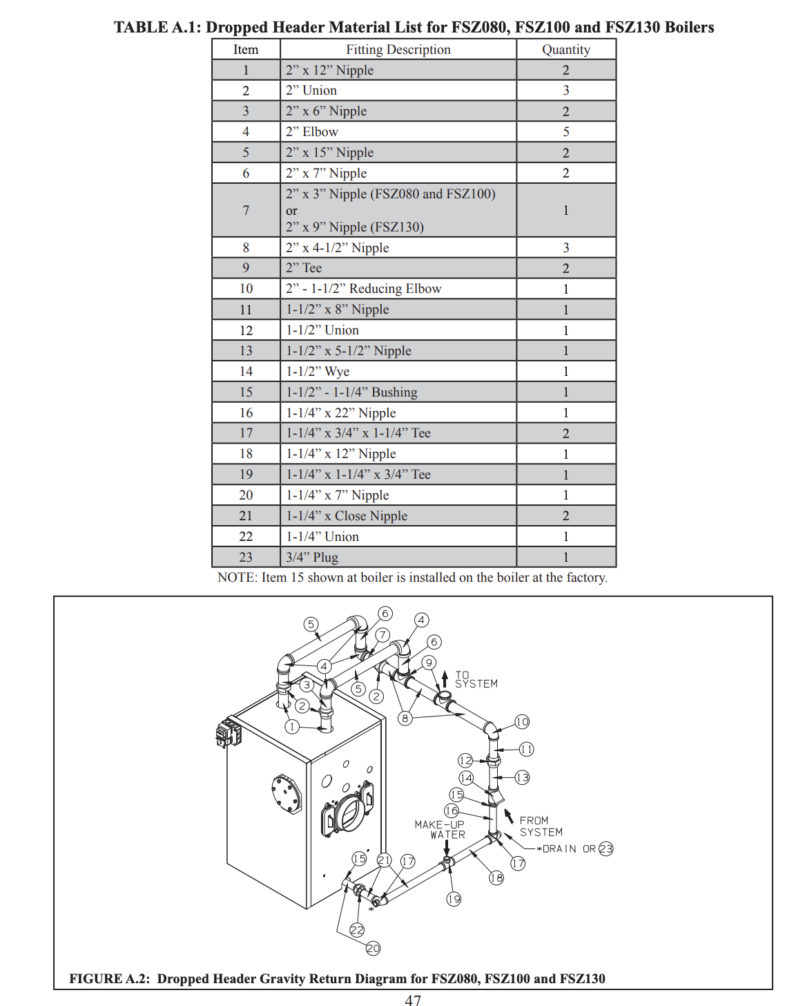

    @JDE. You will want to look into Crown by Velocity Boiler works. The folks there are great to work with and you can get them thru Johnstone supply of you have one near you. There are other distributers also. The best thing about Crown Boiler is thay have the near boiler piping kit with all the nipples and fittings to get the installer to install the boiler correctly.
    If your installer has the ability to read and follow the diagram, you will have a properly installed steam boiler.
