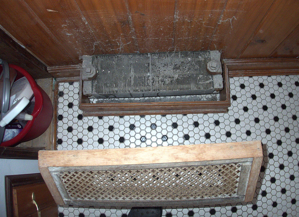

    Here's a rough web page with some pictures:
    https://rjl.us/house/hydro-heat.htm
    The gas burner says '50-200,000 BTU, adjustable. A few online 'calculate your boiler size needs' websites give ~90,000 based on some combo of house age, footage, climate zone, insulation, etc.
    Ca. 1890 house, ~1800 ft2, blown-in cellulose wall insulation ca. 1985, attic insulated & vented properly, wood windows with wood storm windows and as I get to them, spring bronze weatherstripping. Solid & well-built. In a village (as opposed to on some windblown treeless mound like so many houses). I don't plan on ever moving, all house maintenance toward making it last another 130 years (boiler cost may hit the limit). I've done a lot to decrease heat loss in the 5 years I've been here. Normal winter lows are 5f a coupole 2-3x/winter, -10 or so for a day last winter. Usually only a few days too warm in summer, with combo of windows, shades, & fans (no AC).
    Existing setup heats house more than adequately, I usually have the thermostat down low & (if I can recall correctly) it only cycles on (burning) maybe 2-3x/hr; in other words I never have had to push it in 5+ years here (down to ~10f).
    I found a copy of 'form 1504h' but haven't done it yet, but have got sizes of all radiators, room sizes, etc.

    is it all one zone? balancing those convector cabinets and cast iron radiators on the same zone will be very difficult.
    the circulator is an old 3 piece circulator. you could have replaced it with a much less expensive wet rotor circulator. probably not a bad idea to add a magnetic dirt separator to the new system with all the cast iron radiators and steel piping.
    unless you go with a mod con, which would work great on that system if you split the radiators and convectors in to 2 zones, you will need return water temp protection on the new boiler because of the mass of that converted gravity system.
    that convector inside the cabinet missing its cabinet isn't going to heat well, it gets its output from the convector cabinet drafting air through the elements.
    especially in the up you may need the pipe insulation in the crawl space to keep it from freezing.
    that broken cap is the cap to the curb box for the water service. it is a tube that goes down to the curb stop on the water service.
    the copper tube on the convector missing its cabinet is so that when that automatic vent inevitably leaks it leaks wherever that tube goes instead of under the cabinet.
    this one looks like it is sealed in a box where it isn't going to do much of anything, it has no way to pull air in and the chase to form the draft isn't tall enough

    Thanks. The pix are from when I just bought the house in 2020, posted question here as was new to HW heat, changed out a few of the ones higher on page for this question.
    .. So some lower questions I figured out, even though the village works didn't seem to care that there'd a hole in the water shutoff!, and those dusty little fin/tube rads were discussed then, incl. drilling holes in the wood of the one for convection; I haven't done it yet nor even screwed/glued it together properly, that bathroom's never too cold I guess or haven't gotten to it.

    All one zone; I 'discovered' last winter that if I keep the french door closed that separates the front door area & stairs up, the temperature not only stays a lot warmer down & not as hot up (= more even), but also lowered my 2-3 months of high bills from $400 to $300 (may be in part from adding window seals, etc. last year also). The area near the front door seems particularly poorly insulated, probably because of difficulty drilling & blowing in the cellulose back when (but door is properly bronze-weatherstripped!). So closing that door I guess keeps that cold from pouring in & displacing the downstairs hear up.
    Also should add that in normal winter evening of ~20-30f the circulation/heat may only come on once every hour or 3 or so at night when I turn it down a bit.
    the reason that the convectors don't heat so well, they heat and cool quickly so they want several cycles per hour, the cast iron has a lot more mass both in the iron and in the water inside so it takes linger to heat but radiates that heat for a while after the boiler shuts off so it wants fewer cycles per hour. if you either put the convectors on a separate zone or replaced them with some salvaged cast iron radiators it would be more even. the piping through the crawlspace really doesn't lose a whole lot of heat.
