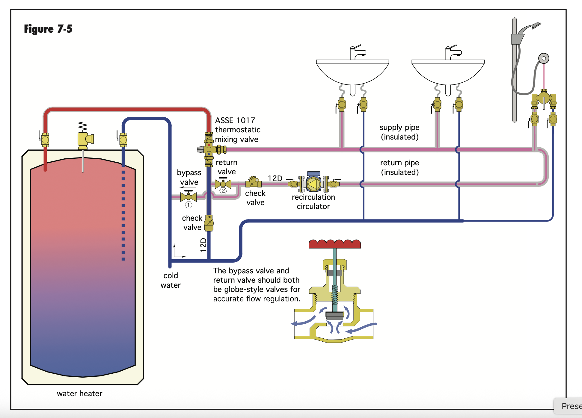

    so I like what you’re saying about putting the on the cold side and the tank on the hot sideof the mixing valve plus you need a mixing valve on a Combiso it makes sense to put it there so in that situation would you put the recirculation pump with crossover valves on the outlet side of that mixing valve? I’m guessing that is the only place you can put it in that situation
    hot_rod Member Posts: 27,904
    There is a specific way you need to pipe a thermostatic valve with a recirc system to prevent temperature creep. Check valves and bypass particularly.
    Explained in Idronics 11
    https://www.caleffi.com/sites/default/files/media/file/Idronics_11.pdf

    This is not your tampering mix valve. That has to be a separate valve as it needs cold water to do its job.
    The mix valve here is just used as an automatic 3 way valve that selects where the hot water comes from based on temperature.
    Say you set the mix valve to 110F, combi to 120F and tank to 140F. As long as the combi is putting out 120F, the mix is switched all the way to the cold side and you get 120F water out. If the combi starts loosing steam and only puts out 90F water, the mix valve will now start using the 140F water from the tank to mix it up to put out the 110F setpoint.
    Since you are using a thermostatic bypass for recirc, the return water is warmish, so the hot water creep @hot_rod mentioned is not usually an issue.
