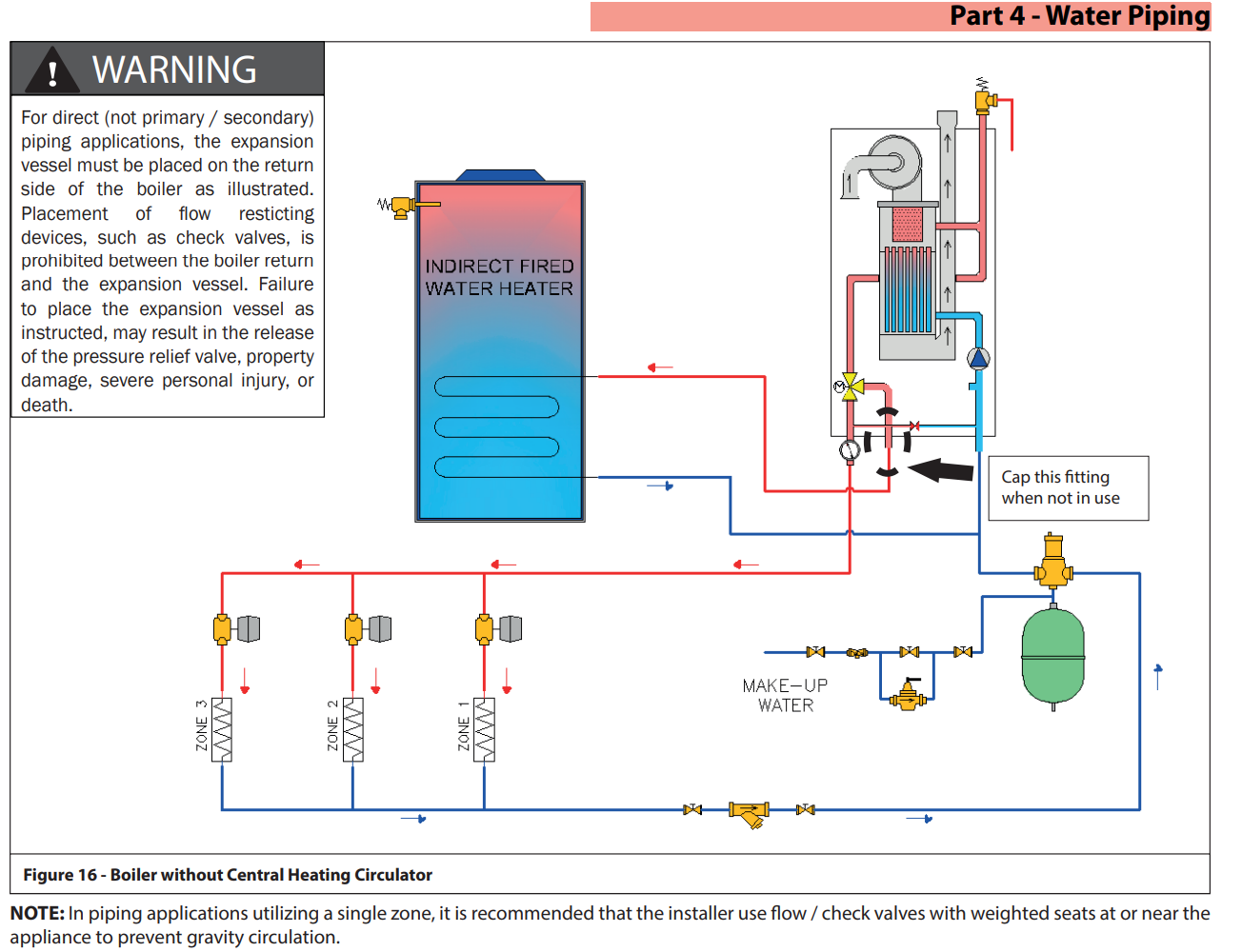

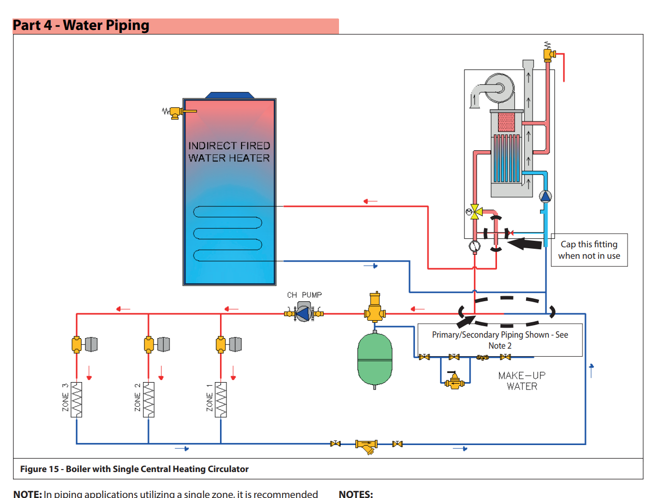

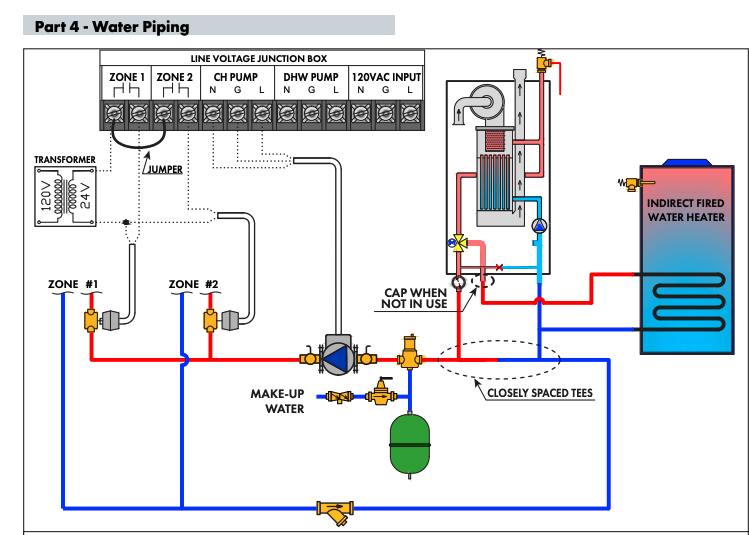

    I would look at the install manual. It shows two common ways of piping this up. If your smallest zone's flowrate is around 2GM, you can go direct to load (kindof what you have sketched, but the pump is built in so you don't need an external one).
    If your zones are smaller, you can go with primary secondary piping. Unless you a very large system, the 0011 is overkill.
    In either case, as others have said, you need a separate pump after the mix valve for the low temp zone.

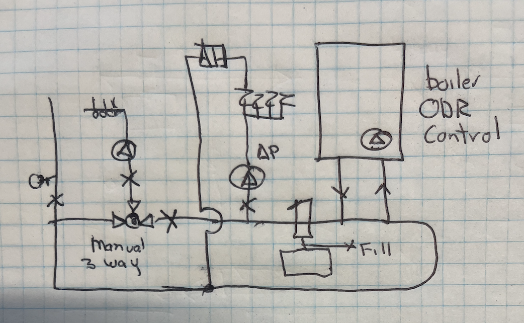

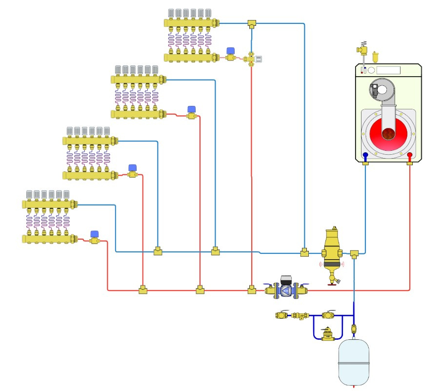

    Here is a piping option that I have used.

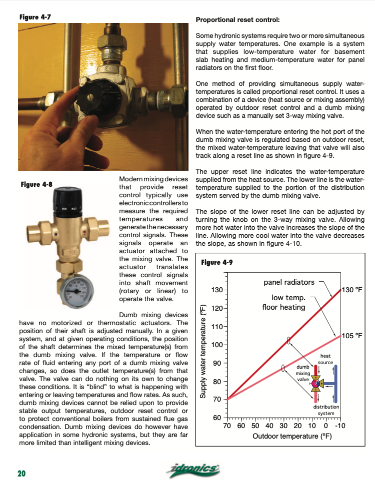

    It uses a manual 3 way mix valve with a proportional reset logic.
    Basically the boiler runs on outdoor reset control, adjusting to the temperature needed for the radiators.
    The radiant is fed through a basic tekmar 3 way mix valve. It's output temperature floats along with the boiler temperature adjusted by ODR
    I believe that boiler has a pump inside? Check the manual online.

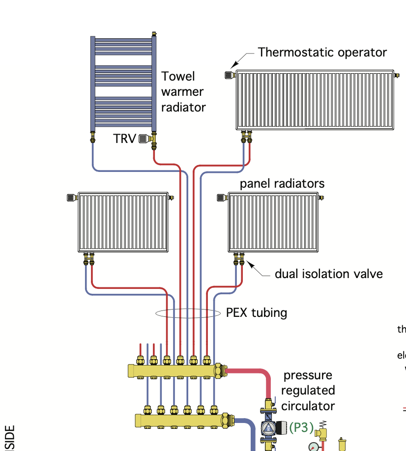

    I would use a delta P, pressure regulated, circulator on the zone valves, and also on the radiant manifold if it is zoned?
    Radiators could have TRV individual controls also.
    Attached is a page from the NTI manual showing primary secondary piping.
    Piping showing TRVs on radiators
    A sketch with the 3 way

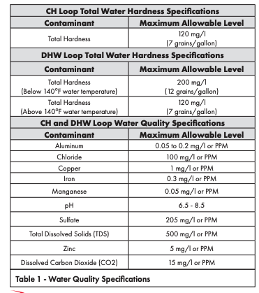

    Water quality page
    Details on proportional reset control from Idronics 4
    I'm partial to Caleffi components :) but what you describe will work;
